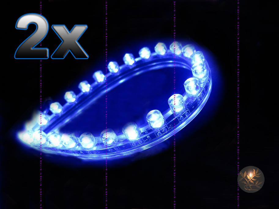

I would agree that some mesh, illuminated (blue LEDs, anyone? or better still, standard filament bulbs in parallel, light up when the bass is being cancelled.) would look extremely cool.
Chris
http://cgi.ebay.com/ebaymotors/2x-2...ptZMotorsQ5fCarQ5fTruckQ5fPartsQ5fAccessories
