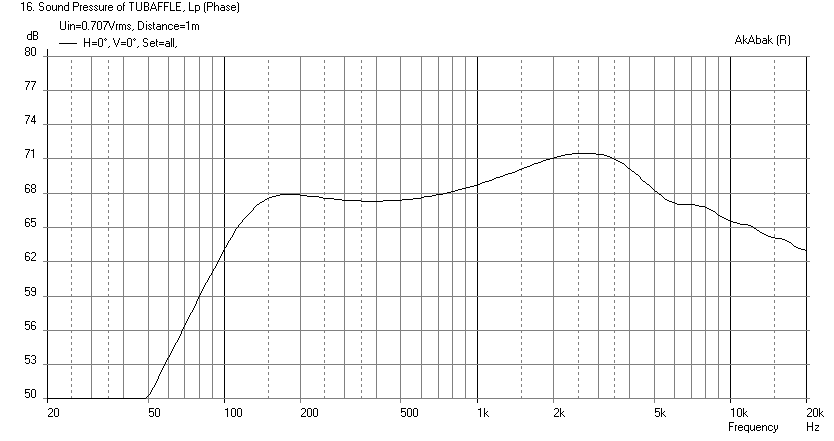

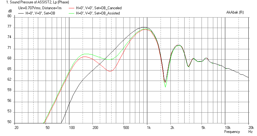

In the first attached graph:
The black curve is the response of the standard OB.
The red curve is the combined response of the OB with "cancel box".
The green curve is the response of the "cancel box".

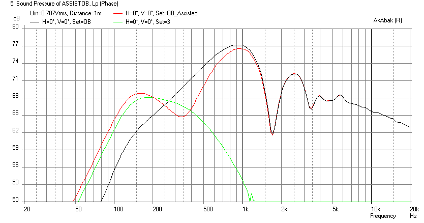

In the second attached graph:
The green curve is the combined response of the OB with "bass assist". This could also be called a "1.5 way" design.
My conclusions:
The standard 1.5 way design with both drivers facing forwards will perform better than the "rear canceled" design. Optimisation of box volume, crossover frequency and driver spacing on the front baffle will produce even better results.
Attempting to cancel the OB rear wave is pretty much futile. At the frequencies of interest there's not enough coupling between the drivers to be useful. Any significant cancelation will also reduce the radiation resistance of the OB driver, and thus reduce its efficiency and frequency response. You can't afford to do that with a 3 inch driver.

Physical speakers will have a little less raggedness than the simulation, but all dipole speakers are like that. Linkwitz explains it very well at Linkwitz Lab - Loudspeaker Design.

Increasing the box volume didn't help much - a little more bass from the sealed unit. Once you get the box volume over 5 to 10 times the driver's Vas value, you're pretty much into infinite baffle range and futher increases in volume (or stuffing) make no significant difference.

in that range. In the low bass there is a disadvantage compared
to "OB and closed box on same baffle".
For experimenting it could be interesting to search for configurations
and baffle dimensions which have smooth response from upper
bass to midrange, mabe there is still a chance for the cancellation
approach. Combining "Cancellation" approach with U-Frame will
introduce resonant behavior into the midrange and destroy
the last chance for that approach in having any advantage.
As can be seen "Tekton" designers are consequent in using BR
for low bass augmentation ...
They are also consequent in offset mounting the driver on the
baffle, which gives consideraby less ripple from bass to midrange
when the position is optimized.
