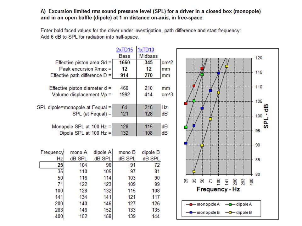

I used Linkwitz's SPL spreadsheet to estimate the maxium SPL from the two TD15Ds on an H-baffle, and the nude TD10D midbass. The 10" TD10D with 12mm Xmax can produce 109db in the 100Hz-128Hz fEqual frequency range.
Smaller diameter and lower Xmax speakers will require either a higher Xover frequency or a much larger baffle to reproduce 100-110db SPLs often required for transients.

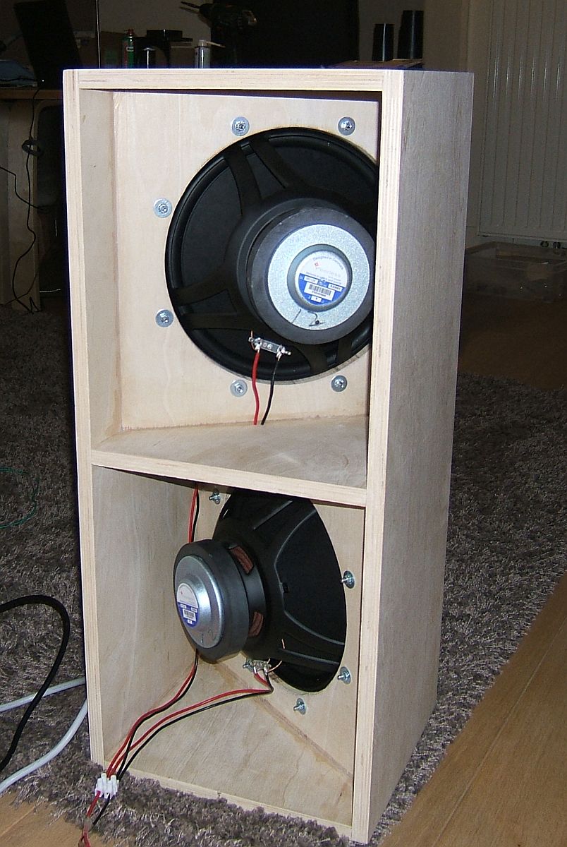

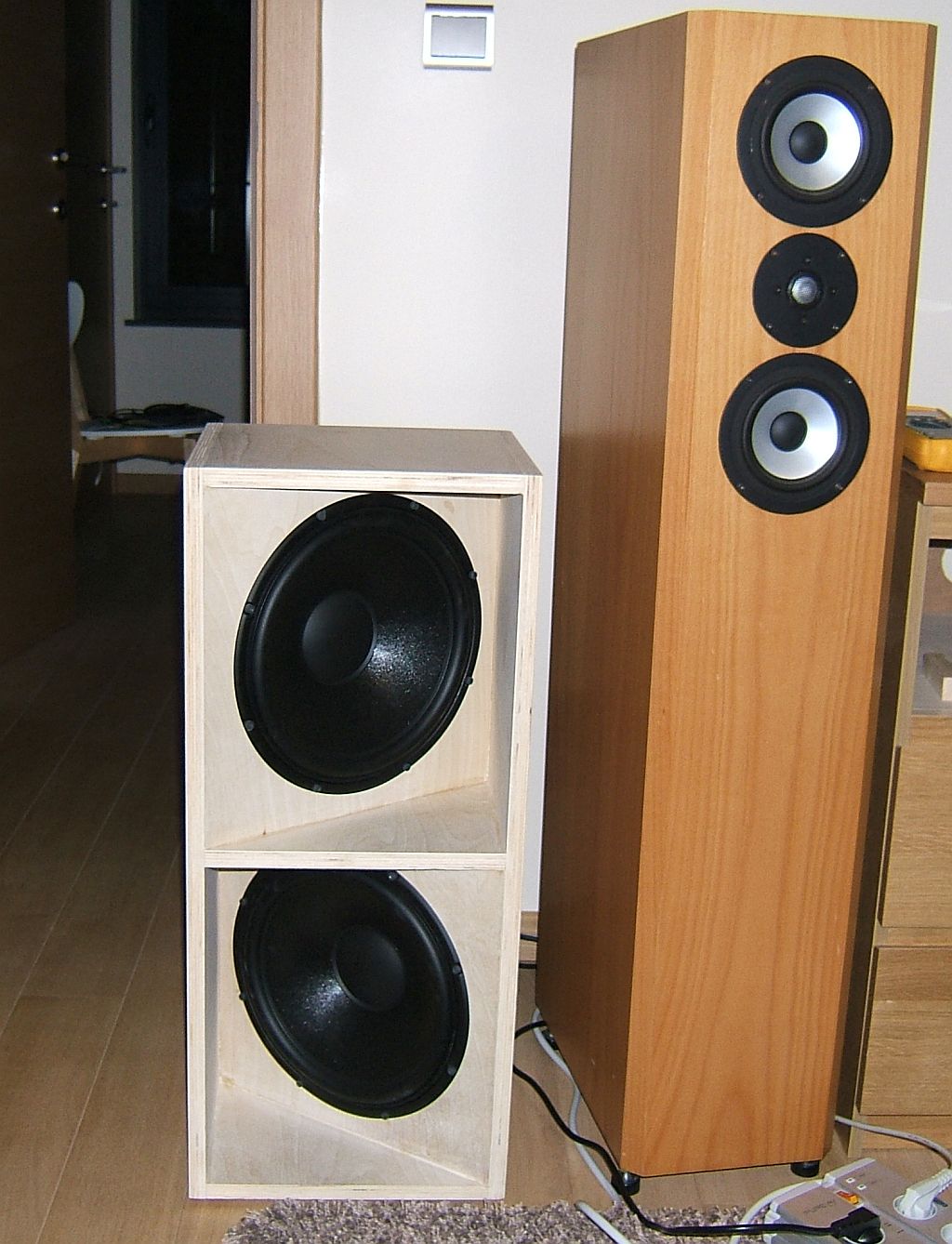

Here's what I did for my dipole woofers.
I installed the drivers at a 35 degree angle. This structure gives me two advantages:
- the structure in itself is stronger than just one front plate
- the woofers are at a 70 degree angle to each other, so the vibrations that they both create are in different directions and are not summed together.
I first planned to install the drivers at 45 degrees, but the magnet structure would touch the sidewalls.
The idea for this comes from GR research, their V2 is similar but with 45 degree angles.

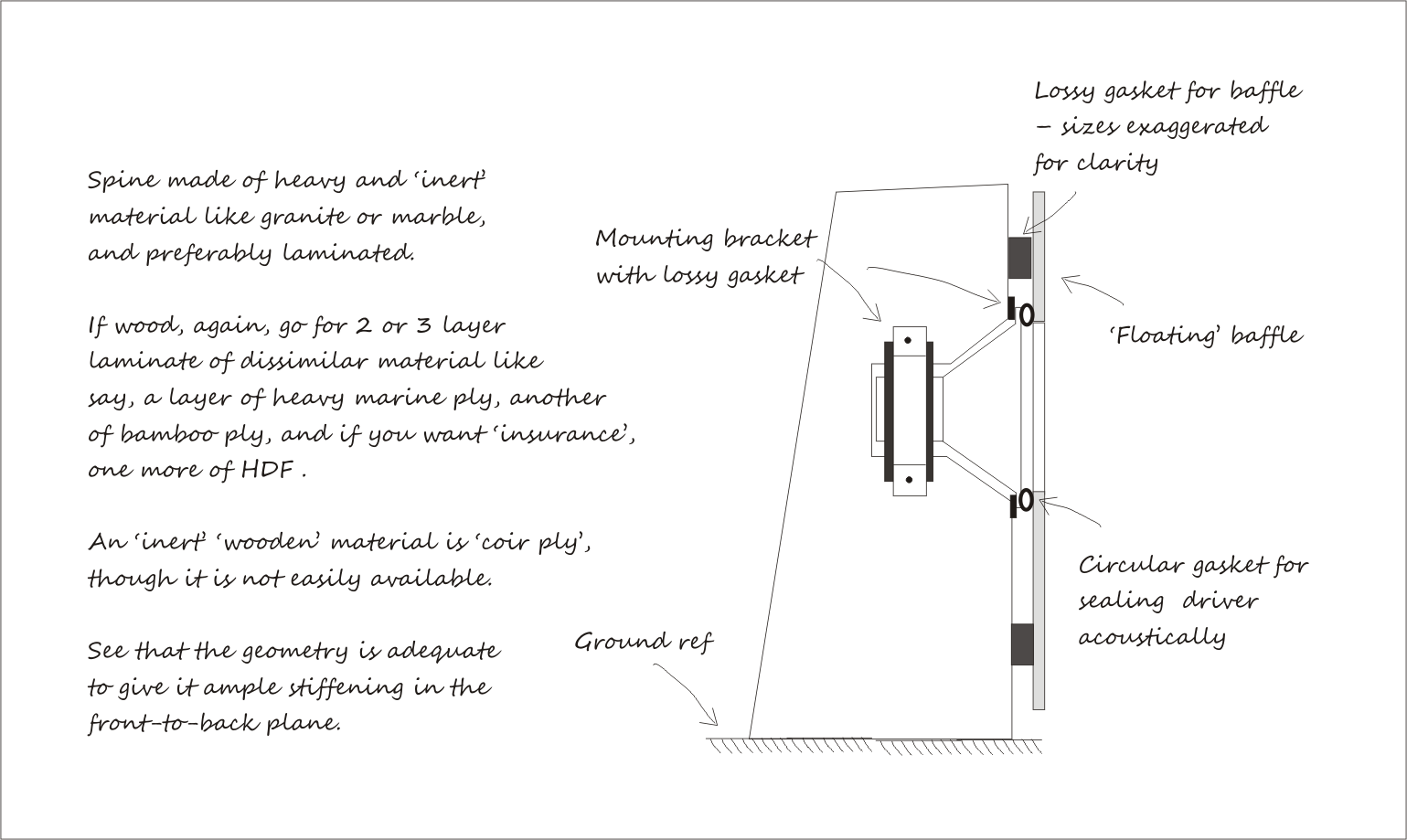

In fact all of us 'builders' knows that baffle vibes are greatest at the lowest octave that we can reach. When we are using a full-range, the ill-effects of baffle vibes become all too readily 'hearable' as the contribution made by the baffle becomes comparable to that of the drivers, and often colours the outputs at mid and high frequencies. This leads to what we often call 'muddiness' and ultimately to aural fatigue when the listening sessions are long and the levels high. Hence the need for banishing baffle vibes at all costs, before everything, and dealing with it before it raises its ugly head.
I have a feeling (to Nuuk) that you might reap better results if your spine was in one piece and made out of a more 'inert' material, and with its geometry offering front-to-back stiffening. In my experience this was what offered the best results. The sketch makes it clear, I guess.
Danny, your 35+35 degree idea is great--with your permission, I might also try that ;-) --, but here again I guess if you go in for a spine and then magnet-mount the driver, with the spine 'grounded' to the cabinet top and bottom, and also have the driver rim decoupled from the front baffle plate with rubber gaskets, the results could be an order better.

DJN, by all means try your aluminium angle 'iron' idea. Surely the L shape will give it good stiffening. My suggestion: use a couple of Ls on both sides of the drivers (16 holes each ), then stiffen the top of the L's with a slanted back support. Use a short piece of L as the base, so that the whole assembly looks triangular looked sideways. Pour some concrete to make the base heavy. And last, but not the least, 'float-mount' the baffle in front of the drivers. I hope my sketch from the previous post helps you.
Let us know about the outcome and post some detailed pics too, please.
Best vibes to all!

The wood I used is birch multiplex, stronger than the usual MDF and nude it looks great, no need to veneer or paint.
Nice idea of you to add a spine, a spine will also act as bracing.
Danny
