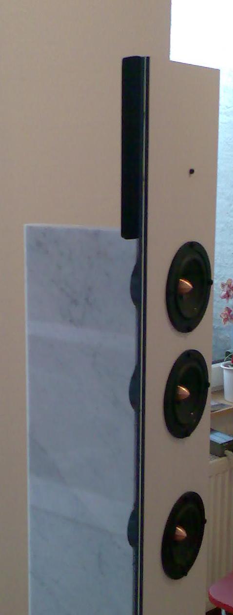

have a feeling (to Nuuk) that you might reap better results if your spine was in one piece and made out of a more 'inert' material, and with its geometry offering front-to-back stiffening.
The problem then is that you are coupling the two drivers with vibration from the woofers able to affect the higher frequency drivers. I do understand that the effect will be somewhat lessened by the high damping value if the spine is granite or similar. As ever, it's all a matter of compromise with anything hi-fi!
I should have said in my original post that the woofer magnet mount is bolted to a 50mm thick slab of granite.
