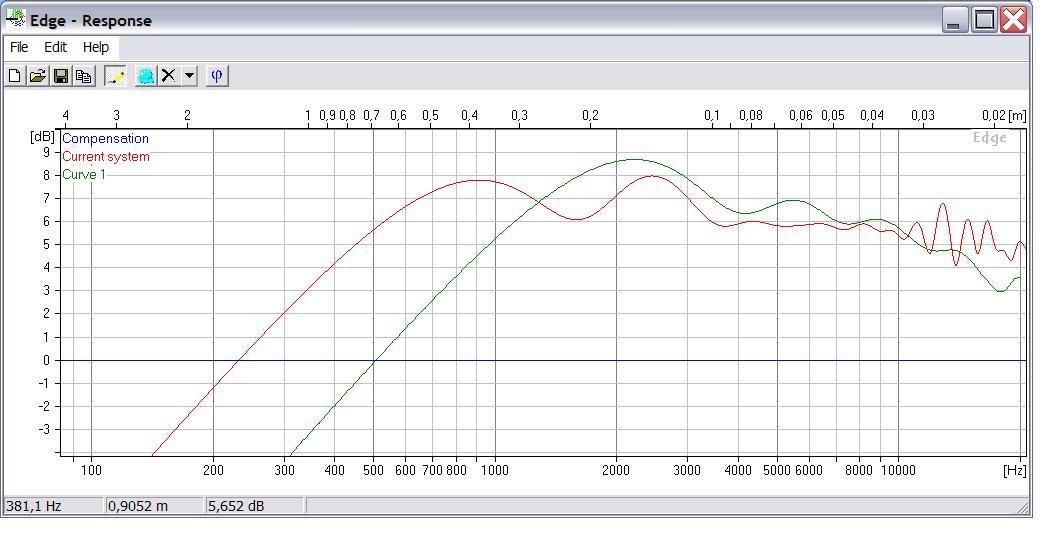

Hi there,
me thinks one thing is "swinging" and "nobaffle" is another.
Swinging is cool concerning vibration and nobaffle too.
But the situations where you can afford loosing a whole
octave bandwith or more are quite limited.
Pic shows a 100mm diameter driver without baffle and
on a tiny baffle approx 22cm x 35cm.
Should i reveal which is which ?

I'm not sure what exactly you were trying to say (a technical writer you do not seem to be) but I disagree with your contention that one cannot find a driver for most any given passband that doesn't require a baffle. Quick example: a baffleless 12" driver works great up to about 500Hz, with low end limited to excursion/distortion.
Wouldn't hurt for the folks who aren't familiar with dipole peaks.Should i reveal which is which?
Baffle versus no baffle is really a tradeoff between mechanical equalization, electrical equalization, maximum SPL, and the engineering complexity and directivity tradeoffs of producing a baffle which provides a significant amount of mechanical equalization. Personally I've not hit any situations in which I couldn't afford to raise the dipole peak; in my experience where baffles start to become attractive is around 95dB SPL. It depends on the music and other details, but that's nominally an average SPL 5dB above the OHSA threshold for permanent hearing loss and 10dB above the EU threshold. So if you find you can't hit a desired SPL in home audio without a baffle it's probably time to step back and ask a few hard questions about just how important that last octave really is.
Granted, if you're locked into passive crossovers then you're probably reliant on using baffles to provide mechanical equalization so as not to kill the crossover's efficiency. But in the past few months I'm only recalling one passive dipole build (mige0's) here on DIY; the rest all use digital crossovers and equalization.
Same here. Selection can be a bit limited in 18s and is quite restricted at 21 and above. But for 15s and smaller the problem's usually filtering out all the drivers you don't want to use to find the ones which you do want.I'm not sure what exactly you were trying to say but I disagree with your contention that one cannot find a driver for most any given passband that doesn't require a baffle.

454Casull,
Your quick example is all right, but have you considered its 'strengths' vis-a-vis directionality/beaming etc?
A better and a flatter response can be realized, I guess, with a much smaller driver on a small baffle considerably smaller than 12 inches--and that too without making any compromises on the polar pattern and beaming.
And have you tried comparing the sims of a circular and a rectangular baffle?
I am anticipating the evolution of an 'ideal' design for a good OB (or even a 'nude' baffle-less model) as a result of the knowledgeable interaction here. I certainly am NOT a pundit who knows everything. 🙂

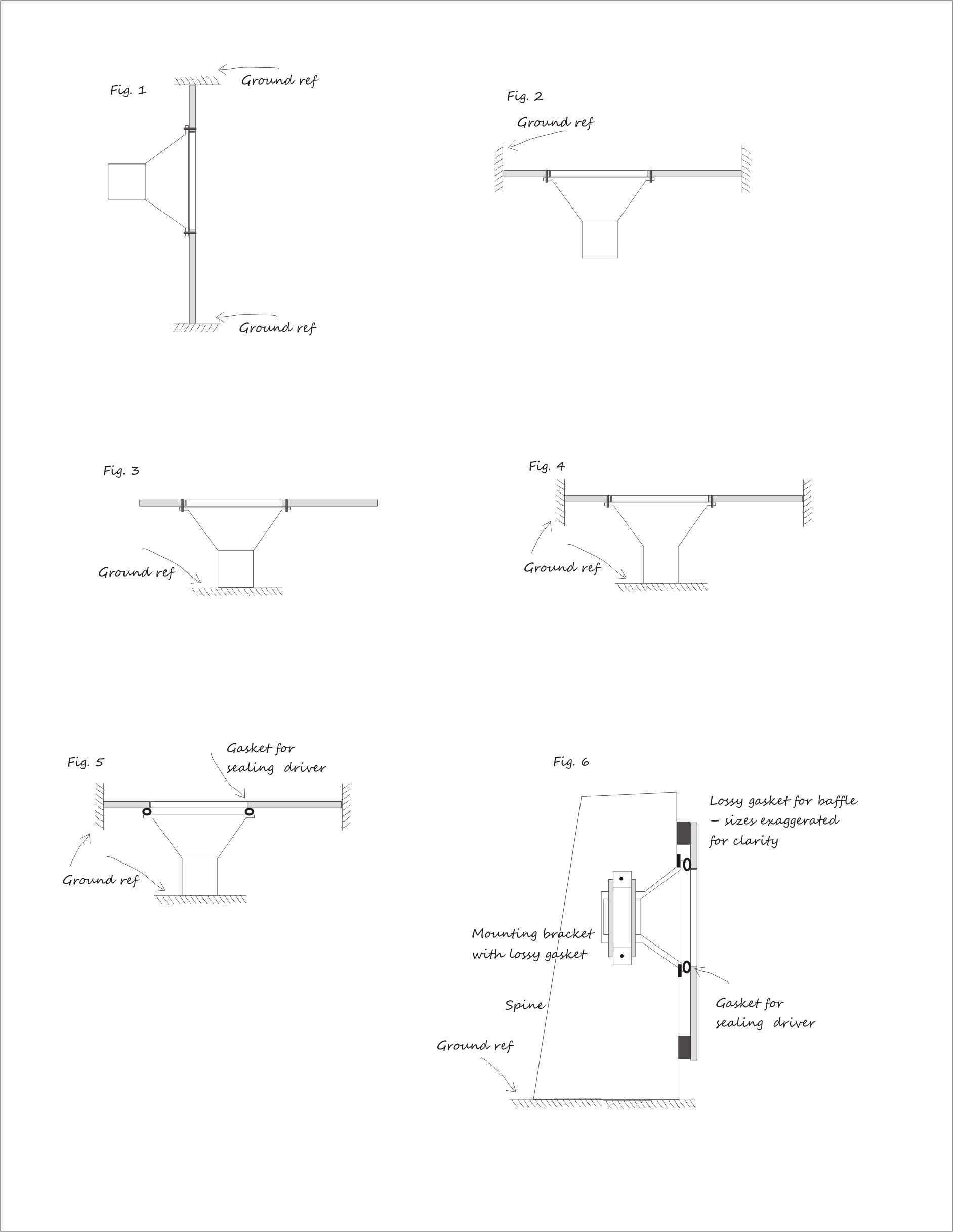

OB vibes
Dear all,
Sorry for the gap of a few weeks. Busy with many things, but with the investigations too in the meantime.
Permit me to present the results of some baffle vibration investigations. These are empirical results. The intention is to share it with you so that the more knowledgeable among you might choose to pursue it further in a more scientific manner so that all of us would benefit.
The test gear was simplicity itself-- a good low power amp with lo-cut and hi-cut filters and a pair of good, 'known' speakers, fed by the 'probe' made from an old LP piezo cartridge. Be warned though, that it is easy to generate high amplitude transients with accidental knocks etc and fry the amp or the speaker. Always mute the amp/turn down the volume while you adjust the setup.
My plan was to look for ways to minimize the baffle vibrations at its core. As we all know, large baffles and boxes do contribute a lot more than the drivers do, the more so at lower frequencies. But even at higher frequencies, the 'smearing' produced by unwanted panel vibrations do spoil the imaging, which I believe is the basis of enjoyment in reproduced music.
Please note that the 'ground reference' is the fixture which connects the system to ground. The judgements are highly subjective, though every attempt is made not to be biased. The quantity and nature ('sound') of the unwanted vibration is rated on a scale of 1 to 10 and each setup is judged and rated.
The conventional mounting practice is to mount the driver rigidly to the baffle. So a rectangular baffle with various mounting options were tested and rated. The baffle is 20 mm ply and the driver used is an average 8" woofer. Please refer to the sketches attached.
1. Conventional setup. The baffle is upright and 'ground referenced' at its edges, with the driver mounted rigidly to it.
Very powerful vibes emitted by the baffle. The complexity of the vibrations is also high.
2. The same mounting as above, but with the baffle horizontal and ground-ref at the baffle edges.
Vibrations reduced, probably because of the weight of the driver and gravity contributing to some panel stiffening/damping.
3. Same as above, but with the system ground-ref at the magnet structure. Much lower vibrations, shifting to slightly higher frequency ranges -- a change in baffle material is likely to affect the 'quality' of the vibrations.
4. Same setup as above, but with the baffle edges ALSO now ground-referenced.
Great improvement overall. Still residual vibrations are there.
5. Same as above, but with the baffle decoupled from the driver basket by lossy and elastic gasket that offers an air seal.
Almost no unwanted vibrations from the baffle.
6. Upright setup, with the driver mounted and ground-referenced at the magnet structure. The mounting is made lossy by hard rubber gasket. ( A thick inner tube strip will do.) I could notice that wherever there was an 'interface' between the vibrating metal (driver, its basket etc) and the baffle, an order of improvement was obtained when there was a layer of lossy material in between, rather than when it was directly mounted.
The mounting mechanism adopted is a 'spine' of rigid material--stone, concrete, sanwiched glass etc is ideal, but at a pinch, sandwiched ply or mdf will also provide good results. The baffle is mounted in a lossy manner to the spine, with an elastic and lossy round gasket providing air-seal to the edge of the driver basket and at the same time offering a high degree of decoupling.
Almost no vibrations even at high drive levels.
7. Same setup as above, but with a baffle that is now made up of glued sheets of 12 mm and 8 mm ply and mdf. Much better results.
8. Same as above, but the baffle is now a sandwich of two sheets of ordinary window glass, with one side plain and the other side textured, naturally, with the plain sides glued together with a smear of Silicone.
Virtually no detectable vibrations.
These are the observations that I have been able to make. I present it before my more knowledgeble and research-minded peers with the hope that this could lead to better solutions. Thanks in advance.
Great vibes to all !

Very thorough study indeed!
To give me (or us) a better understanding of what you did, some questions:
You fed the loudspeaker-induced vibration of the baffle back into the loudspeakers, right? What kind of input did you use? Noise, sweeps, music?
I am not shure whether this "resonance-feedback" would get focused on a few distinguished frequency peaks or would it be rather broadband? Could you tell more about it?
Can you tell us where you placed the pick-up on the baffles? Near to the driver or at the edges? Did the baffle size and the pick-up position stay the same for all tests or how did it vary?
Thanks for more information.

I opted for nobaffle, since I wanted to operate all drivers below the dipole peak, where the directivity is constant, and frequency response is very smooth. Problem is that the baffle can be no larger than 15 cm for frequencies up to 1700 Hz where I XO to the tweeter. The choices were a nude 15 cm driver or a smaller driver on a 15 cm baffle.
In the low frequency range nude drivers are just plain stupid, I definitely agree there.

Thanks Rudolf.
I am sorry I didn't elaborate on the test setup. It was all kept very simple.
The test baffle was set up in the open verandah and the piezo probe fitted to a gooseneck was touched to the baffle. The monitoring took place in the adjacent room. I played a low-range sweep tone from the computer and an amp feeding the test speaker and listened to the sounds that were coming out of the baffle via the pick-up, monitoring amp and speakers.
It is a 'odd' experience listening to what the baffle can produce! You can also play some ordinary music with bass content and be amazed at what comes out of the baffle. It is an 'ear-opening' experience, I should say!
Try it by all means.
Great vibes to all!

You missed my point with XO below the dipole peak. A 15 cm baffle has its peak at approx 1700 Hz, and using small drivers on a 15 cm baffle will not change that. Asymmetry might be good for on-axis response, but off-axis response will get worse - my other point is that the nude driver offers very very even off-axis response below the dipole peak.A small 15 cm baffle (in your case, Stig) with an asymmetrically mounted small driver is going to sound far better than your nude larger one, I guess. With a small driver you could go way up too before you needed to XO.
That being said - excellent sounding results can be had from baffles even when XO above the dipole peak, but in my opinion it is less optimal.

I like your strong, slim 'spine'. But from the pic, the mounting details cant be seen.
My take is that floating the baffle independently of the drivers is going to give you great dividends. Just try it on one channel and hear the difference!

Stig:
Point taken; I shall keep that in mind when I do my own listening tests. No, I haven't yet tried a nude driver yet. Shall do so at the earliest opportunity so that my bias goes away. Yes, I am also interested in off-axis 'purity' as I have a feeling that it affects imaging-- and I am sold on imaging as I have all along believed that imaging, and not absolute 'fidelity', was the key to reproducing the recorded reality with some semblance of the original.
I have seen some of your work, Stig, and let me just say that I envy your craftsmanship. For that matter I know I am in the midst of great DIYers in this forum!! Yes, I can understand your take on those boxes, sand-filled or not; boxes, ah, that's what we have been having difficulties about remembering ever since we went OB. Sometimes amnesia can be so good!
Loren42:
Sorry to disappoint you- I am not an engineer collecting data. ;-)
I explained my set-up, I think--I was listening 'live' to the baffle output as fed to the monitoring amp by the LP cartridge used as a mechanical 'probe'. The output of the 'normal' baffle was enough to wake the deaf. I was comparing the degree of loudness and roughness of the picked up vibrations, but all I was interested in was to see how could get rid of ALL those unwanted vibrations, whatever their amplitude or mode was. I stopped when things turned out to be pretty silent!! When the piezo pickup was on the decoupled sandwich wooden baffle, there was just a trace of artefacts with above average drive to the test speaker. The driver was an 8" unit with a rating of about 25 W. With the sandwich glass baffle plate, the silence was really uncanny.
My point is that the vibrations were reduced by several orders and I was able to reach a point of very good acceptance. The mounting methods clearly were able to reduce the unwanted vibrations and they were reversible too. Just removing the speaker 'mouth' decoupling, and putting the baffle in close contact with the driver was enough to change the situation to worse. I trust you get my point.
I am happy that with a less than optimized setup, if I was able to achieve such a degree of reduction of unwanted artefacts, a properly engineered setup is sure to be THE solution for such ills.
The drivers were mounted with two aluminium semi-circular brackets on both sides of the 'spine', with some lossy rubber in between, and bolted together. Mechanically also this appeared better as the mounting was close to the centre of gravity of the driver.
Maybe a more mechanically-minded person will analyze correctly the vibration movements here. Earlier when I had mounted the driver with the back of the magnet solidly abutting the spine, I thought at high drive levels, there was some vibration transmitted to the spine, despite its solidity in the front-back plane. (actually I did not 'probe' the spine at this time.) When finally the driver was mounted as above there seemed to be a perceptible improvement. My feeling was that the front-back movements of the magnet structure were being absorbed as heat within the lossy packing without getting directly passed on to the spine. I think I obtained better results all over with a lossy mechanical 'interface'.
I trust that clears the air from my side.
Great vibes to all!
