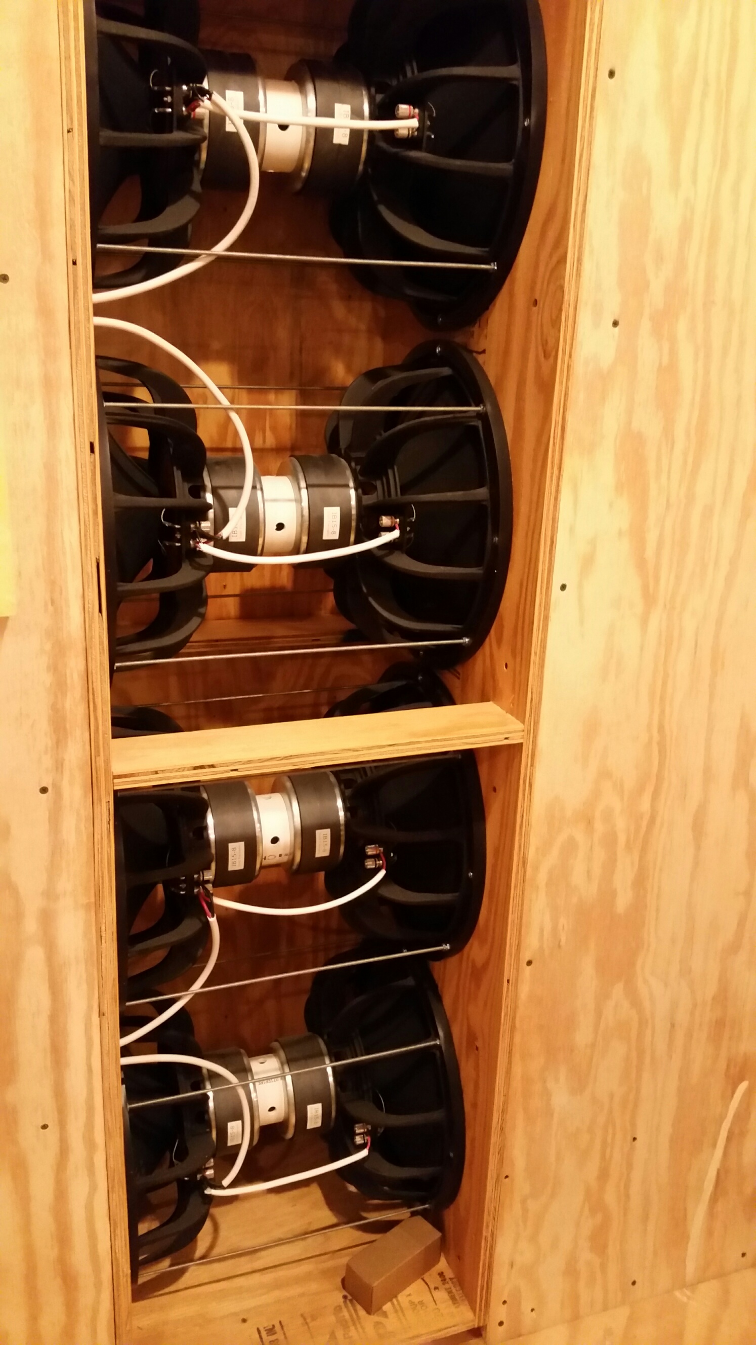

How big is 80Hz ?
FYI: i consider the 18FH500 very surprising in ''nude'' (tested it fixed on the top of said sealed box), but was testing it mostly 80-500hz, not for the first 2 octaves.
Just how big is 80Hz ?
1140
_____
80 ........... = 14.25 feet.
So, let that wrap around your baffle for a while !!
peace out... I'm gone to do some listening 🙂
(to some real bass)
