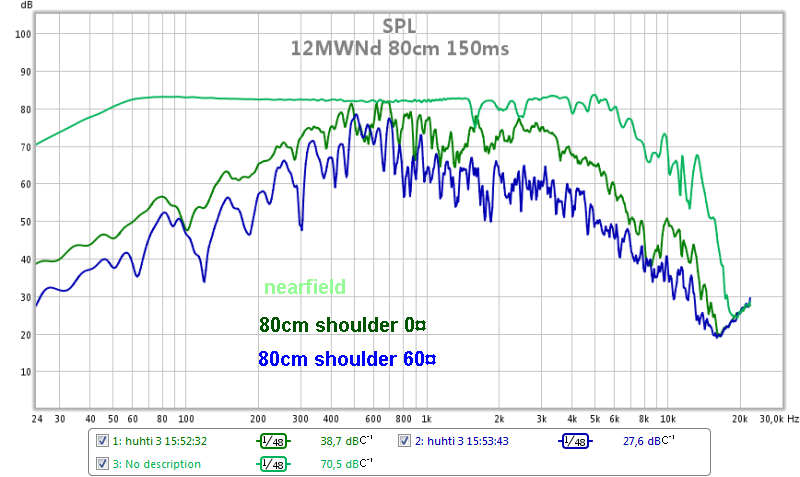

Well, I don't suggest a baffle-less (aka nude) driver system for the woofer but it works well for higher bands, e.g. above 500Hz. Up to 500Hz you can have a 12" driver in a modestly sized planar baffle and that will provide sufficient output to support an 80Hz or 100Hz low end to the passband.
I know this because I have built a couple of OB systems following this principle and it works well. I use a 12 inch diameter woofer in a 17 inch wide, 30 inch tall baffle and with boost to compensate for the OB losses the response reaches down to below 100Hz. The mid and tweeter are "nude" on a stalk projecting above the baffle.
OB "bass" below 80Hz or so requires some different approaches, but down to 80-100Hz it's not a big challenge at all as long as you choose the driver and baffle size correctly.

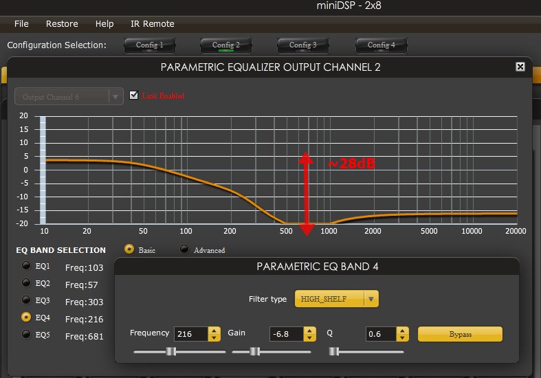

Here a nude 12" driver's unequalized response and correction curve from minidsp, 150W power available. xo is 170Hz LR2 to a closed-box subwoofer, I don't want to try to get low bass from OB.
My experience suggests that MartinLogan hybrids' xo LR4 around 300Hz must be problematic. Too high and too steep xo to get smooth integration of different radiators/polar patterns/room response.

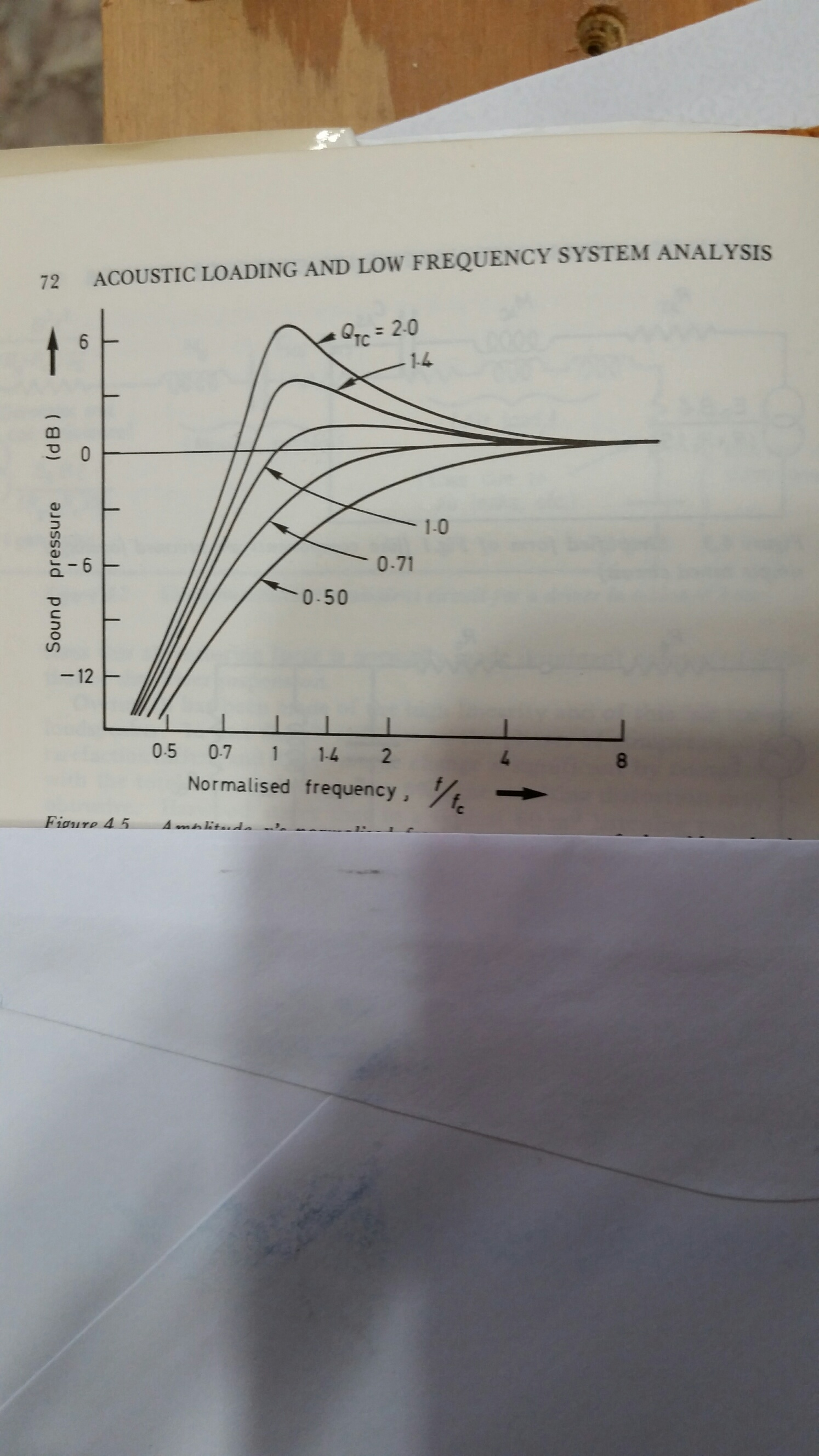

There's the Qts of the driver, that you start with. Depending upon the application, said total system Q will increase by a certain degree. If there is
NO LOAD on the driver, the Q stays the same.
Final system Q is a matter of taste.
A Q of .707 is considered maximally flat, and desired by many.
A nice sealed box system has a Q of .707, bit others prefer .588
Vented systems may be considered to have a Q equivalent of 1.0
In the Carver AMAZING loudspeaker, Bob started with drivers having a Q of about 2, which otherwise would have this HUGE bass bump, but the acoustic short circuit of the open baffle, cancelled it out.
System Q
Various System Q on a comparison chart.
