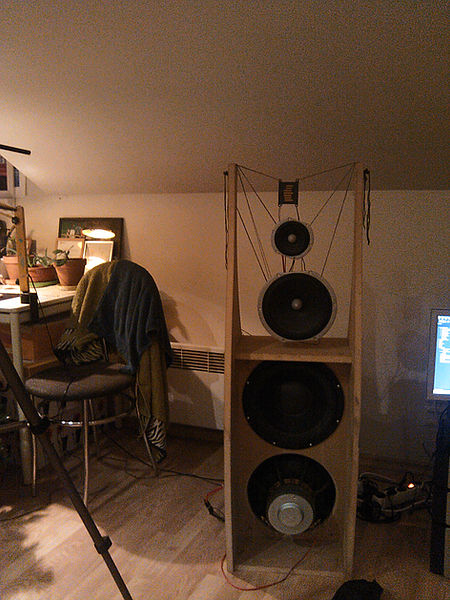

Then, the ''no-box-is-better'' started to show up (as expected), then i tried the 18FH500 baffleless ('cause i couldnt do better tonight) and now i'm asking:
IF the produced bandwith fills my needs (80hz+ as of now)... Is any added baffle is useful/wanted, or the ''baffleless'' or ''minimalistic baffle'' is a approach worth considering ?
I'm simply thinking about reducing as possible the unwanted reflections & resonnances that i felt/heard (that comes usually from an enclosure in the 80-500hz region) and also to reduce the baffle material and size of the ''enclosure''
I think baffle less is better than open baffle with some large baffle. Just make simple prototype with drivers suspended on strings like this
