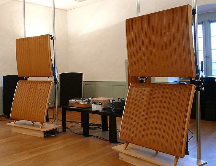

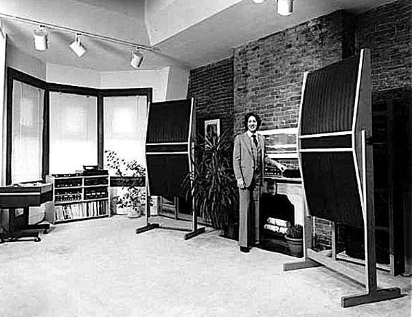

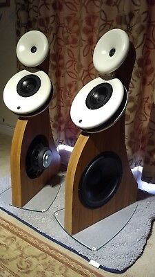

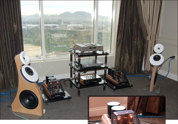

Interesting design. Is the other sidewall (where the woofer baskets are visible) missing or maybe clear? Two woofers aligned 90deg like that would make about zero bass on the speaker mid/tweeter axis due to OB cancellation.
I believe its not missing any cover. Perhaps just a grille.
No, bass would not cancel each other. Remember Helsinky?
Interesting design. And it works. I heared it at the show long time ago.

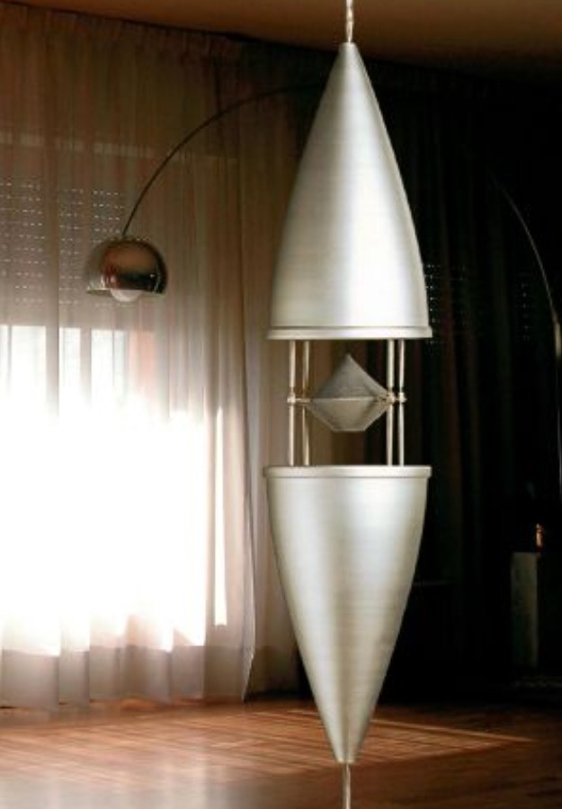

I've always been curious about the so-called pendant speaker. Hanging from the ceiling, there's no competition for floor space. Unsure if anyone has made a good sounding one; sealed, OB, electrostatic, DML, CBT array, etc. This picture from the web clearly shows an attempt at an omni unit, with a reasonable aesthetic appearance.

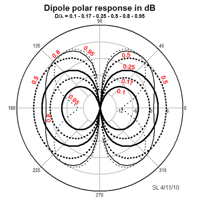

It’s not that I don’t believe you but I know that when I am directly to the side of my OB speaker, the sound is very soft. Here is the polar pattern of a dipole:
At 90 and 270 deg, the output goes to zero. I suppose if you don’t toe them in and you are 30 deg of the minimum axis, it’s actually the peak vs 0deg or 180deg.
Perhaps very nice, looks cool anyway 🙂 I guess it is rather rare thing try and get very good stereo sound with practical family space and 99.9% resort to all kinds of soubdbars and home pods and be happy with them. As any system would benefit optimal positioning I haven't been able to figure out better than some on wall solution, which leaves only the listening position at the mercy of practicality. Luckily my *** moves easier than any loudspeakers 😀 Walls are almost empty anyway.

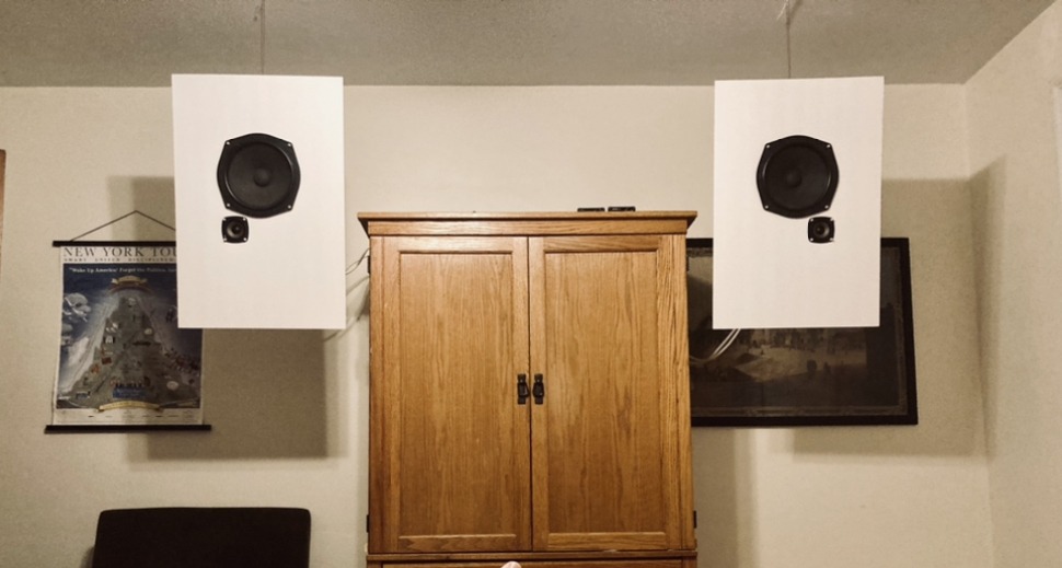

I'm imaging those in clear plexi! How do you keep them square to the room? Not seeing so many guy wires.
They are balanced just right by 18 gauge magnet wire wrapped around the… magnet. There’s about a 10 degree tilt downward toward the listening position. I have the coil and cap for each speaker resting on the cabinet to keep the suspended weight at a minimum. Every once in a while if I bump into one of them I’ll rotate it at the screw in the ceiling back to the proper alignment. Otherwise they stay put well on their own.
I tuned them by ear with piCorePlayer’s ALSA EQ. It’s very low brow but turned out great. I may measure their response for the sake of curiosity.
