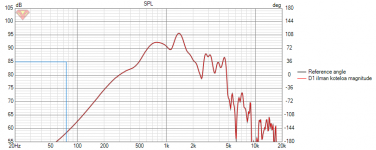

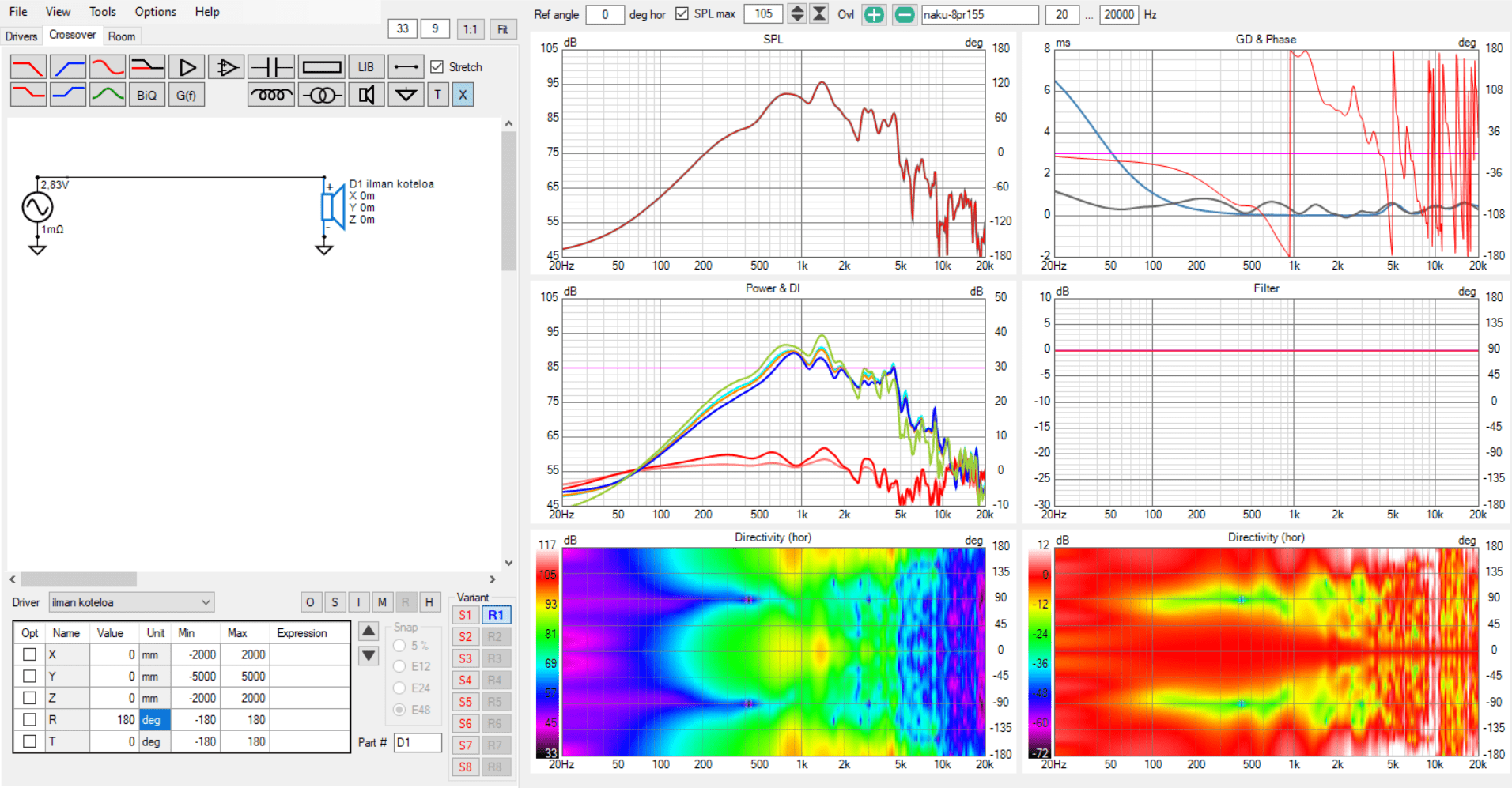

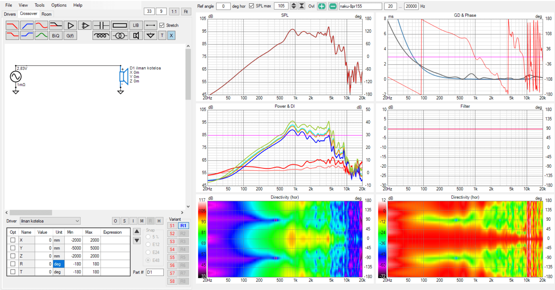

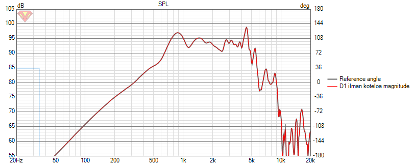

Is there any highs on the back side off a fullrange driver? No whizzer cone for example and more or less closed structure creating acoustic low pass.

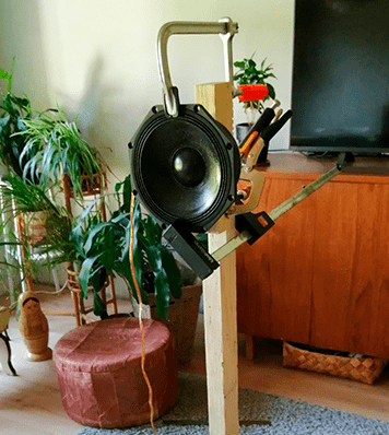

edit. remembered I had full polars measured of naked 8" mid driver. It is not particularly a fullrange driver, and has quite a closed back. Goes south from 2kHz up, although the hash ~10kHz stays roughly the same. Not sure if that is already some background noise or what. Anyway, would be interesting to see if anyone has measurements of their naked drivers 😉
Whole thing rotated, interesting. DI shows the system is going omni on the back past few kHz. Quite a nasty response all around, some of it is from the rig.
