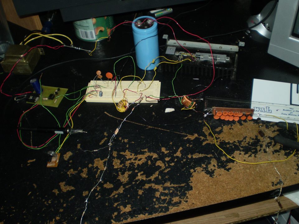

I bread boarded my version on a Protoboard to see if it would work first.
Then I drew it up the schematic in Circuitmaker2000 as it was before I tore it apart so that I could rebuild it later and work with it some more.
It is such a simple design that you should be able to breadboard the whole thing if you don't have a Protoboard and just have pigtails running to the output devices that are bolted to a heat sink of some sort.
A very big heat sink wouldn't be needed for testing purposes since it will be only about 10 to 30 watts of power and a piece of aluminum plate will suffice.
If it starts to get to warm then throw a small fan on it, You would be quite amazed at what a difference it would make.
I did that while I was designing my Variable HV power supply while I was in the designing stage and was running the FET's as high as 100c and just a little fan kept them cool below about 65c to 50c or less and they were just mounted on a piece plate aluminium at the time.
Here is a picture of how rough the layout was and I used the same heat sink and protoboard for the amp as well.
