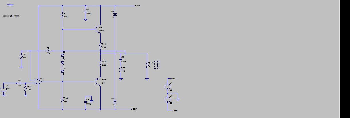

opamp plus driver stage and output stage with its own supply, what could happen?
Odd, I can see the images - but let's try it on a proper reply rather than a quick reply.
It worked great it is a classic configuration from National Semiconductor from many years ago !!
I will be working with it again soon and show some Scope test's.
At the moment I have been in repair mode fixing and re-arranging monitors and setting up another machine for some PIC programming.
Once my bench is cleared off again, I will be getting in to testing the new opamp samples that I have been collecting for the last 6 months.
jer 🙂

I started an answer for you last night, But I hit the back button and lost the whole mess!!!
The value of the pot was just something that I had laying around and I have not taken the time to find the optimum value.
It does give me a range to work with down to zero and the resistors are what set the actual high current limit.
I was able to get up into the 2 to 3 amp range per device using my unregulated 26v single ended supply.
But as expected the voltage swing was limited.
I didn't want to go much over 1.5 amps with the test as they got rather warm.
The Pd of the BD911/912's are at only 90 watts that was good until I build a version with more of them paralleled.
Due to the very high current gain (Hfe) of the darlington configuration, I figured that only about 5 to 10ma. is all that is required to send the output devices well into and past their Pd limit.

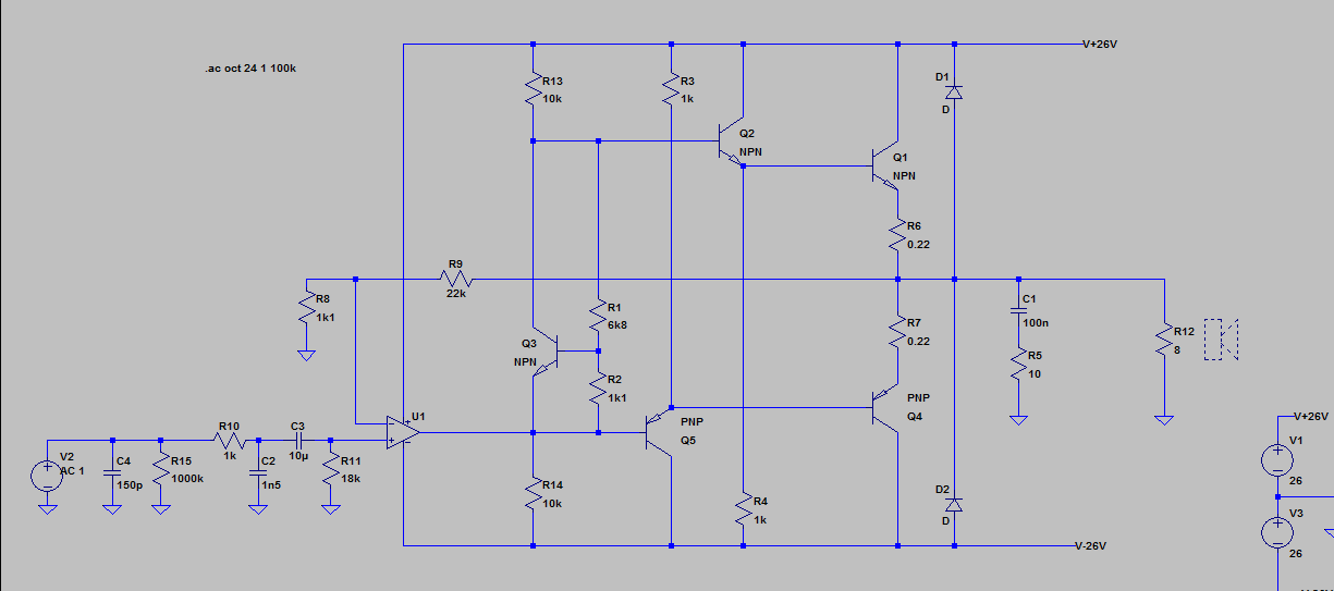

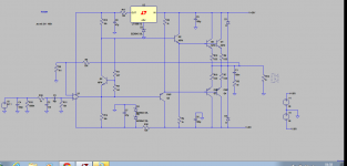

The way the biasing works is actually very simple. We know that we have one diode drop from base to emitter, 1 x Vbe, so we know the current down that arm (the one with the other resistor in it, or resistor and pot) so we know that the voltage across that resistor will be proportional to its value x 1 Vbe. So if it is 3 times the value, you will get 3 times the drop across it, making 4 Vbe drops in all.
The way this ends up as bias current is that it pushes the bases of the two transistors apart, so increasing the voltage across their emitters and turning them on more.
It is interesting to mention that collapsing the bias is one method often used to protect an amplifier or speakers in fault condition. If there is no voltage across the emitters then there will be no conduction. It doesn't tend to work very well in practice but it could save your transistors in a short. Quite a number of 70s amps had it.
Incidentally I did reply to you earlier, but the msg seems to have got lost.
But I should mention (again) that if you do it with just diodes, which will work fine, then you won't be able to adjust the bias, let alone push it properly into Class A. So the Vbe multiplier is your simplest option for that.
What I said on the missing reply was that the problem with the schematic I'd put up was that you only get 30dB of power supply rejection due to R13 and R14 and that at least an RC, or a zener would be needed to bring this down. Ideally you'd regulate it properly and get 70dB on the lines plus the 30dB you had. There's oodles of voltage to play with so something like a couple of 20V zeners, preferably feeding a pass transistor, should see you through.
I hope you follow that.
Not sure I follow this board at all and I'm very uncertain about putting pnps at one end and npns at the other. You need to be able to follow the temperature, and you only have one transistor to do that with (the one in the Vbe multiplier) and you have to keep them all at the same temperature or their conduction will be different. I imagine that will show up as a DC offset.
But I do like the idea of paralleled output transistors (or is this trying to be stereo) and paralleled REs is a good idea too. If you are doing paralleled output transistors then you will need emitter resistors for both sets, not one resistor (albeit paralleled) doing both transistors. This helps hugely with current sharing between the devices.

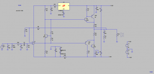

This is the sort of thing I would be aiming for.

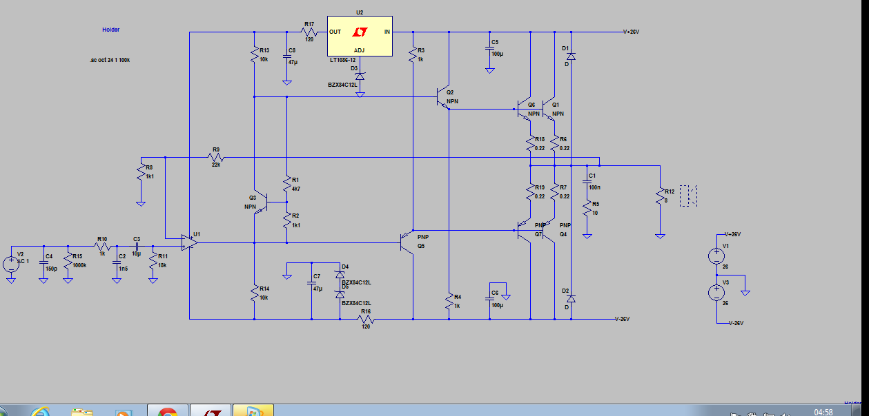

It should all be laid out so you can't make any mistakes. I have put in a proper regulator on V+ (that can be a 317), but I don't have the model for it) or you can leave it out and just use what I have put on V- (conveniently because I don't have a model for a 337 either - at least not easily to hand), or you can leave out the zener diodes (you only need one, but the std library comes with very few so I have put in two 12Vs rather than one 24V.) Or you can leave that out too and just have a resistor and cap. Or even leave those out!
This should show you how to do the power transistors. I still say you should have all of them on the same strip of heatsink, with the Vbe transistor in the middle. So NPN, NPN, Vbe, PNP, PNP.
You do not need your 10,000 uF caps on this board. I have put in a couple of 100uF caps where they should be, near the transistors. You'll have to take a bit more care over your Ground(s). You really want the power to your op amp away from the hefty currents that will shuttle between those big caps. For all sorts of reasons. And you really need a spur to take off the main ground, rather than have it just somewhere between their + and -.
If I remember from the last time I thought about this, the way to lay out the paralleled power transistors, when they are sitting side by side, is to have track going behind the pins (imagine if they were standing up). Make those track lengths the same for each transistor, or same resistance.

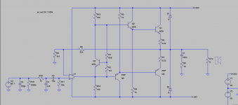

I've also done a CFP version - note the change in R1 as we now have only two diode drops, approximately.

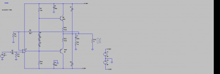

If you use something like the MJE15034/5 as your drivers, you could actually make a very simple power amp out of them alone. I have put this in as the third schematic. You could then build up from that to a CFP, from diodes to a Vbe multiplier, adding decoupling and so on. It's up to you. By and large, though, I think this is the range of your choices when doing it this way. (Well certainly for this level of complexity.)
Error - On the CFP the base of Q6 should go to the collector of Q5. There seems to be a wire missing. I lost my first effort at this for some reason, so I just lashed this up quickly.
Also note that I have used 3 diodes on the bare bones amplifier. It wasn't quite switching on with just two. This leaves it with about 150mA of quiescent, which is probably quite generous. You'll find out what it really is when and if you build it!

I've just had a quick glimpse, but don't have time to study your board thoroughly. But don't use 6.6k in the Vbe multiplier. That gives around 4A and is not the best starting point. You will not need (or perhaps be able to get to) more than 2A anyway, I shouldn't think, depending on the load you are driving. But start low, and/or put in a preset.
I will have a better look later.
