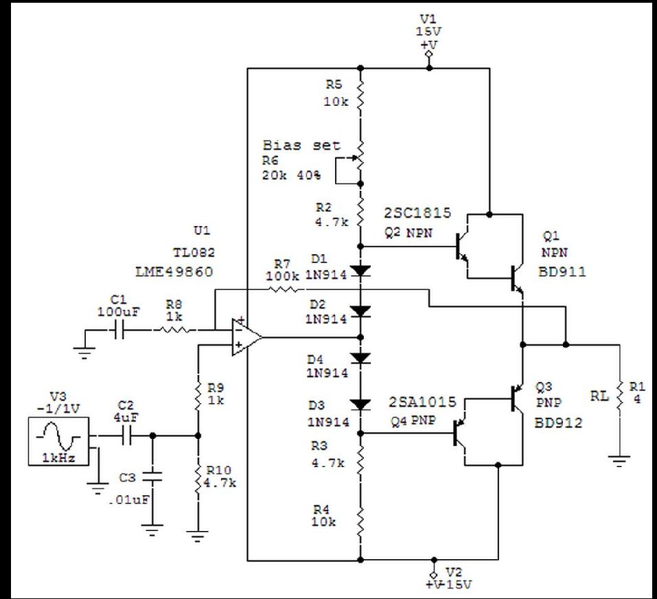

Here is the schematic of my version of a Current Boosted Opamp power amplifier circuit that I couldn't upload the other day.
I did try offset feeding the diodes from the center and I don't recall any major differences in performance but I will investigate this more when I rebuild it and work with it some more.
But you do need the diodes in order to minimize the crossover distortions.
This is something that has been failed to be recognized in the other thread using the TDA729x designs as a driver opamp.
The 1N914 or 1N4148's are fine providing you don't exceed their current ratings, else any common diode will suffice as it is only used to keep the voltage the on the base of the transistor high enough to keep them in conduction mode.
The 40% bias setting is not the true value it was just the default setting of the schematic editor in Circuitmaker2000.
As I had mentioned I don't remember why I had the .01uf capacitor in there.
I thought that I used a 100pf across the + and - inputs of the opamp to damp the parasitic oscillations and it may have been just left over when I was switching the configuration between singe ended and Bipolar supply modes.
