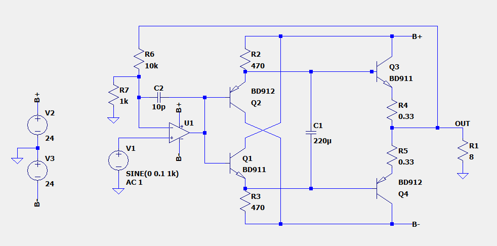

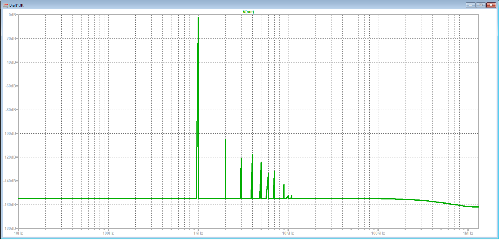

Did you ever build a prototype of this? I'm experimenting with a slight variation of it in LTSpice and it looks really promising!

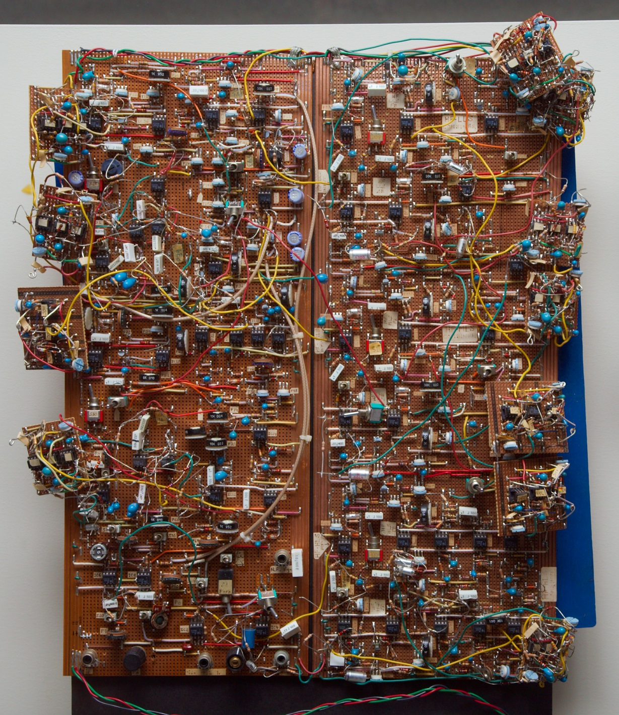

Try (looking at) the Dolby SR prototype (courtesy Wikipedia), now that's the spirit of perfboard prototyping !!that looks complicated but nice
I just tried it with a modest NE5532 and it performs like a champ. Sadly, I don't have any BD911/912, otherwise I would have build one on perfboard this weekend. Maybe I have something similar sitting around. THD at 0.0005% isn't bad for such a simple little thing.
My dad was analog IC designer. I remember visiting his job back in the 80s and his bench looked exactly like that. He had the whole frontend of a carrier phone exchange built on perfboard.Try (looking at) the Dolby SR prototype (courtesy Wikipedia), now that's the spirit of breadboard prototyping !!
Actually... I have a whole bunch of old Sanken MN2488/MP1620 in my junk box. They might work for a quick test. If I have nothing better to do, I'll build this puppy for fun.

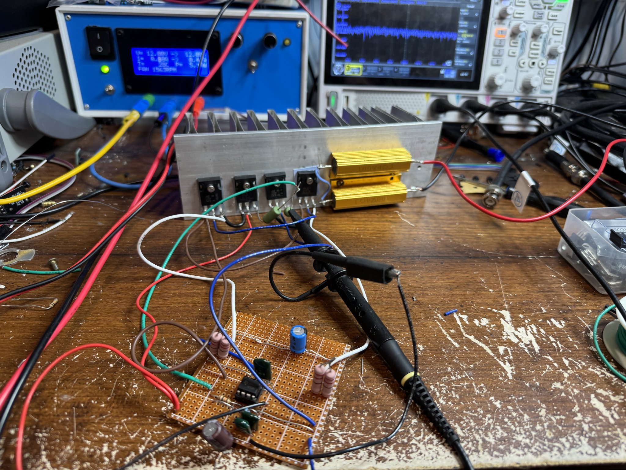

View attachment 1441345View attachment 1441346
Be careful with this. NE5532 have max. +/-22V supply voltage. Those BD911/912 seems to be well available here .... could be interesting later.
I'll probably run in on +-18V. I just noticed my sim had +-24V. Yeah, that would have been an issue. 🙂

This is what a prototype is supposed to look like. A total mess. 😀
So, not surprisingly, you design works. At least it amplifies a signal at >0.1% THD (probably much less) without letting out the magic smoke. So far so good. A few more sanity checks and then we’ll see how it does driving a speaker!

I declare my Sunday experiment concluded. It plays music and actually sounds quite nice. I'm using a NE5532 and a 47p Miller capacitance. could probably get away with less. It might be fun to try a few other opamps, such as the TL072 and LM4562 that I have laying around. The output transistors are TIP35/36 which aren't exactly known to be great audio devices, but it works fine. Such a high power transistor is overkill for the first stage. Maybe a BD911/912 instead?
I'm running it at +-18V and it pulls just about 2W at idle and barely gets warm. The bias current spikes for a few seconds after power on, but settles nicely.
I might build one for my patio speakers, but I'll probably add some overcurrent protection and reverse polarity protection.
