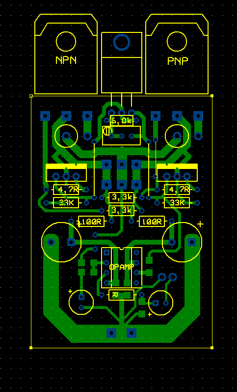

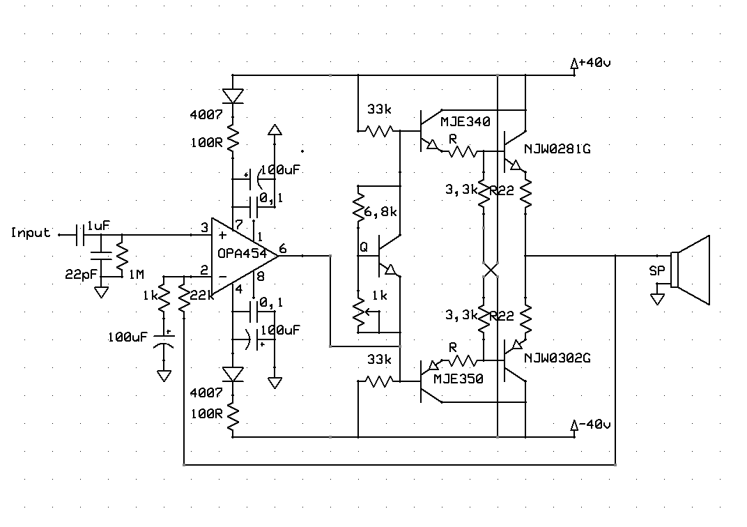

Heres one of the simple designs where pretty much everyone will understund how it works...
Ive built one and I think its a very good amplifier. Ive been running mine for over a month now at 4 ohms.. Yes 4R... :tilt:
But never ran it with single pair at maximum power because I dont want to blow them up 🙂
Its quite efficient and sounds better than any chipamp there is.
The only problem with this design is that you need "HV OPAmp" because the voltage swing is limited to opamps.
http://s6.postimg.org/do70qhbtd/image.png
http://s6.postimg.org/dyldowg0h/image.png
http://s6.postimg.org/avdt6gbgx/pcb.png
Special thanks for Mr geraldfryjr for sharing hes circuit .
post75.
The top link does not lok right to me.
The crossover feeding into the Vbe multiplier is trying to arrange a voltage of 3k3/(33k+3k3) to the top of the Multi.
The other is feeding an inverted version.
i.e. about 18.2% of 40Vdc across the Multi.
But the Multi is trying to regulate that voltage back to the Vbias set point.
Does this arrangement work?
Please attach the pics.
Im such a dumbass sometimes.
Fixed schematic... :h_ache:
That PCB I made that day was prototype. I just wanted to try if its possible to dye PCB's with just ink and boiling... Seems to work.

Its fine if you have preamp..
But 445 seems to be a better device and has FET input .
Ive tried this amp with OPA551/2 OPA27 sounds great, has no pops on startup and is silent when idle.
But Id rather run them with regulated power supply. The mains can vary as much as 5% or even more...
