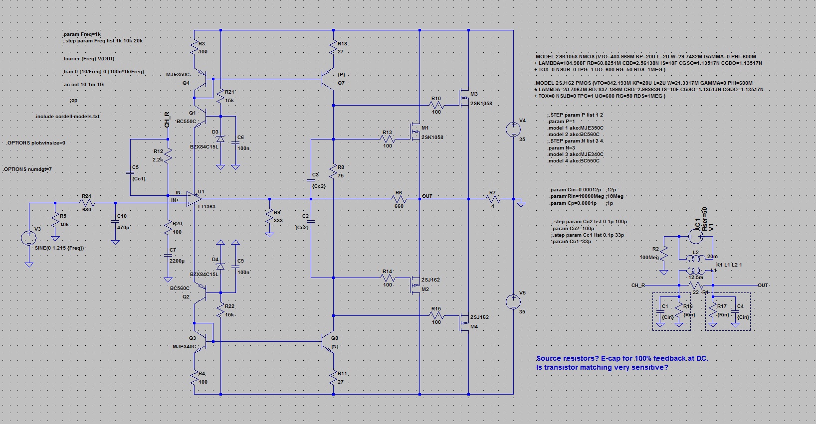

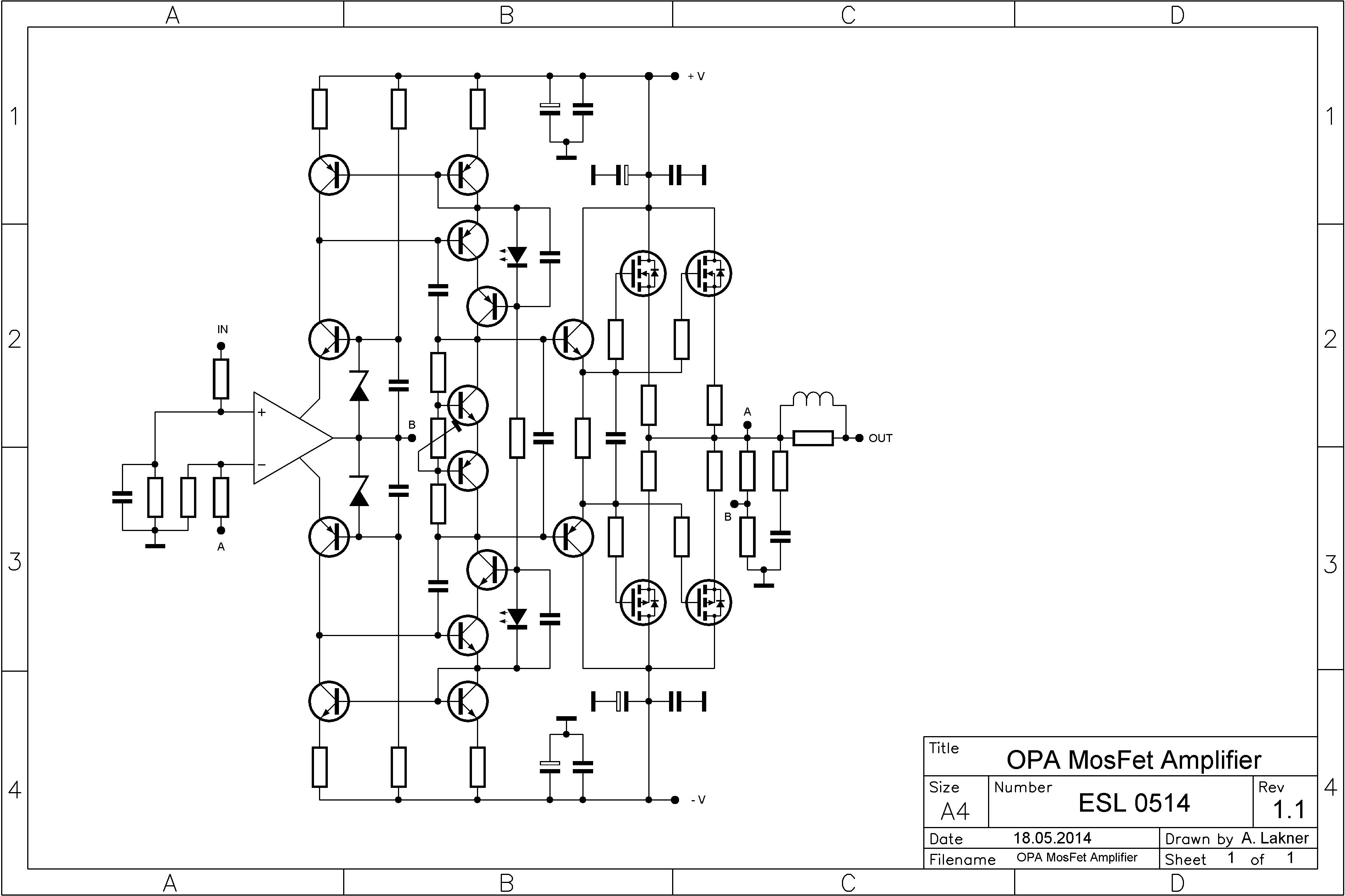

OPA MosFet Amplifier 1.1
Hi guys :wave2:
Calculation brainwork. 😀
Have fun. :cheers:

HI LC
Thanks for this scheme ! I will simulate.
I just intend to try with a cascode on the VAS or in compound and possibly with a buffer before mosfet.
Maybe quasi complentary mosfet 🙂 I have more 2SK than 2SJ
What is the second cascode purpose ?
Cascode or double cascode should be better than compound ?

Hi Guys
What about BJT outputs? They seem to run a bit better at lower bias current...
The peformance is already impressive.
At this moment i prefer running the sim with only lateral mosfet.
I will return to the use of bipolar later
Do the sym at 20kHz and you will see that it just has truck loads of
OLG at lower frequencies with steeply rising distortion at higher frequencies.
Generally this is not a great thing for sound quality. You are better off having
a flatter distortion versus frequency curve, even at the expense of increased low freq distortion.
Yes at 20Khz we have 10X more distortion due to the 10X less gain ... maybe due to the HF compensation ?
However, I will I'll grant more attention and try to decrease
place a 5.1 volt zener where the 75 ohm resistor is. That should keep the HF distortion in check.
Yes I've seen several times on the zener mosfet as the VSSA
LC, no need ZENER with the schematic you just gave ?

R6, R9 are buffer local feedback, but actually serves as load.
In fact you suggested me to use a local CR instead of global?
I'd like 🙂 It will come later

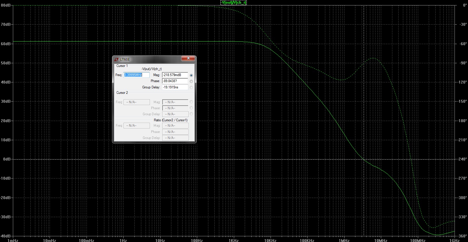

Based on the circuit in post #6. The opamp is replaced by high-performance LT1128 audio opamp. Feedback resistors are changed to 1 k and 22 k to avoid heavy loading to LT1128 (low values have not tried for min. noise).
LT1363 THD
1k = 0.000071%
10k = 0.000850%
20k = 0.002485%
LT1128 THD
1k = 0.000024%
10 k = 0.001617%
20 k = 0.005159%

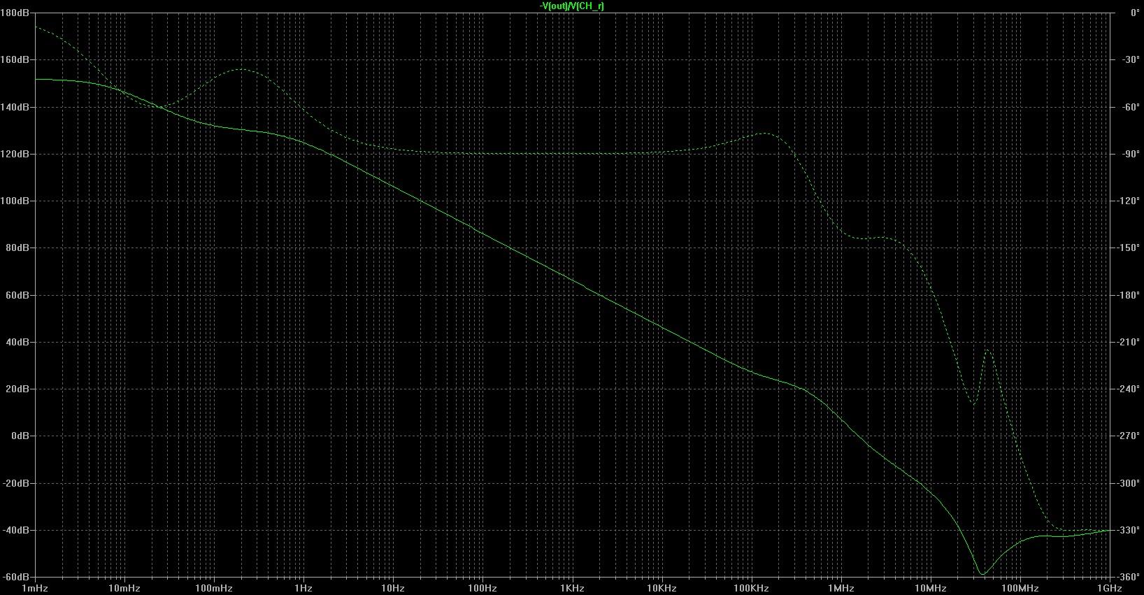

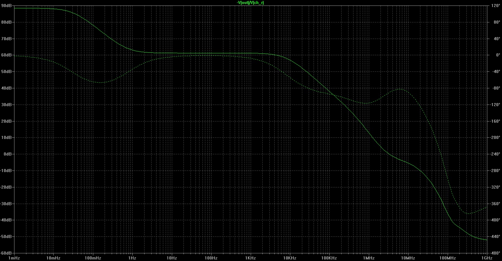

Let take a look of loop gain of the two circuits. LT1128 has very high loop gain in low band. On the other hand, LT1363 is a low open-loop gain wide bandwidth opamp. The circuit has a "flatter" loop gain. This explains lower THD in high band.
Loop-gain (dB) of the two amps.
(LT1363 based amp) (LT1128 based amp)
2k 62 60
3k 61 56.5
20k 52 40
30k 49 36
40k 47 34
50k 44 32
60k 43 31
LT1128 based circuit is traditional dominant pole compensated amp with a roll-off of -20 dB/decade. In contrast, LT1363 based circuit roll-off is ~10 dB.

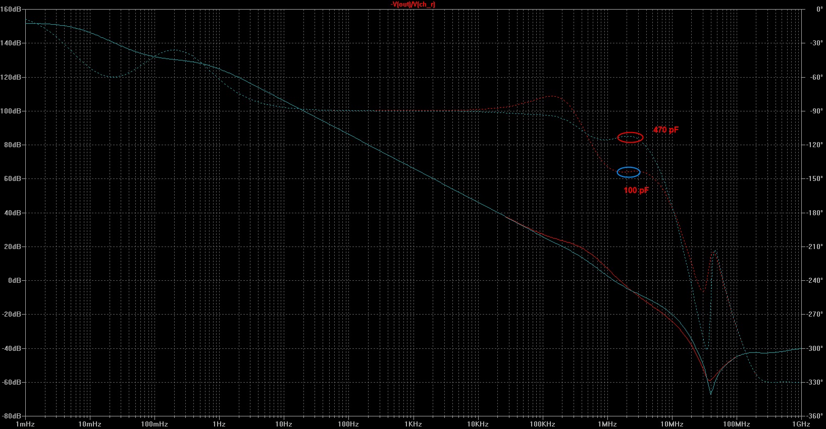

We can improve phase margin (PM) of LT1128 amp circuit by using larger output to gate caps. Example below uses 470pF to improve PM from 36 deg to 66 deg. Crossover frequency is practically unchanged.
PM of LT1363 amp is 90 deg.

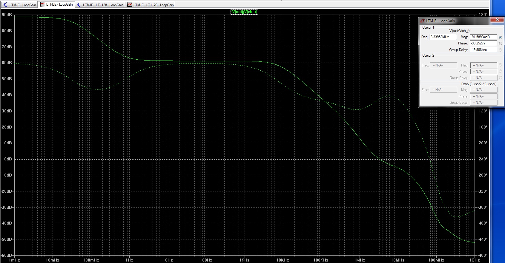

Good stuff Panson!
Yes agreed, looking at your results, the current FB OPA LT1363 does have
very flat open loop gain in audio band still holding 50dB at 20kHz. I think this
is very good performance. What OP voltage swing is this at?
How did you do the loop gain bode plot on Ltspice. I'm not entirely sure
what the best approach is with this mixed feedback circuit.
