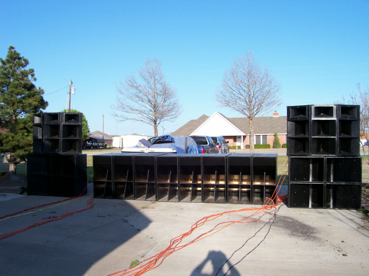

Some people hold parties. Some people have 75 db 1w1m speakers and listen to 72 db dynamic range music. That is CompactDisc max. I've heard more dynamic range in band performances I played in. If there was a recording media that could reproduce that. MP4? Besides 126 high school students on stage blowing away there was an antiphonal brass section in the balcony of ~20 college students. Procession from Parsifal? My LP of the performance was stolen.Question is if anybody needs 100 Watt or more.
My designs almost never go beyond 25 Watt.
I own 98 db 1w1m speakers but have carried them out on the front porch for 4th of July before. 1812 Overture. Turn it up! Speaker limit 500 w AES. Amp limit 240 W/ch RMS. Inside SP2 are fine for solo flute at 1/8 watt. Input op amp was NJM4580.

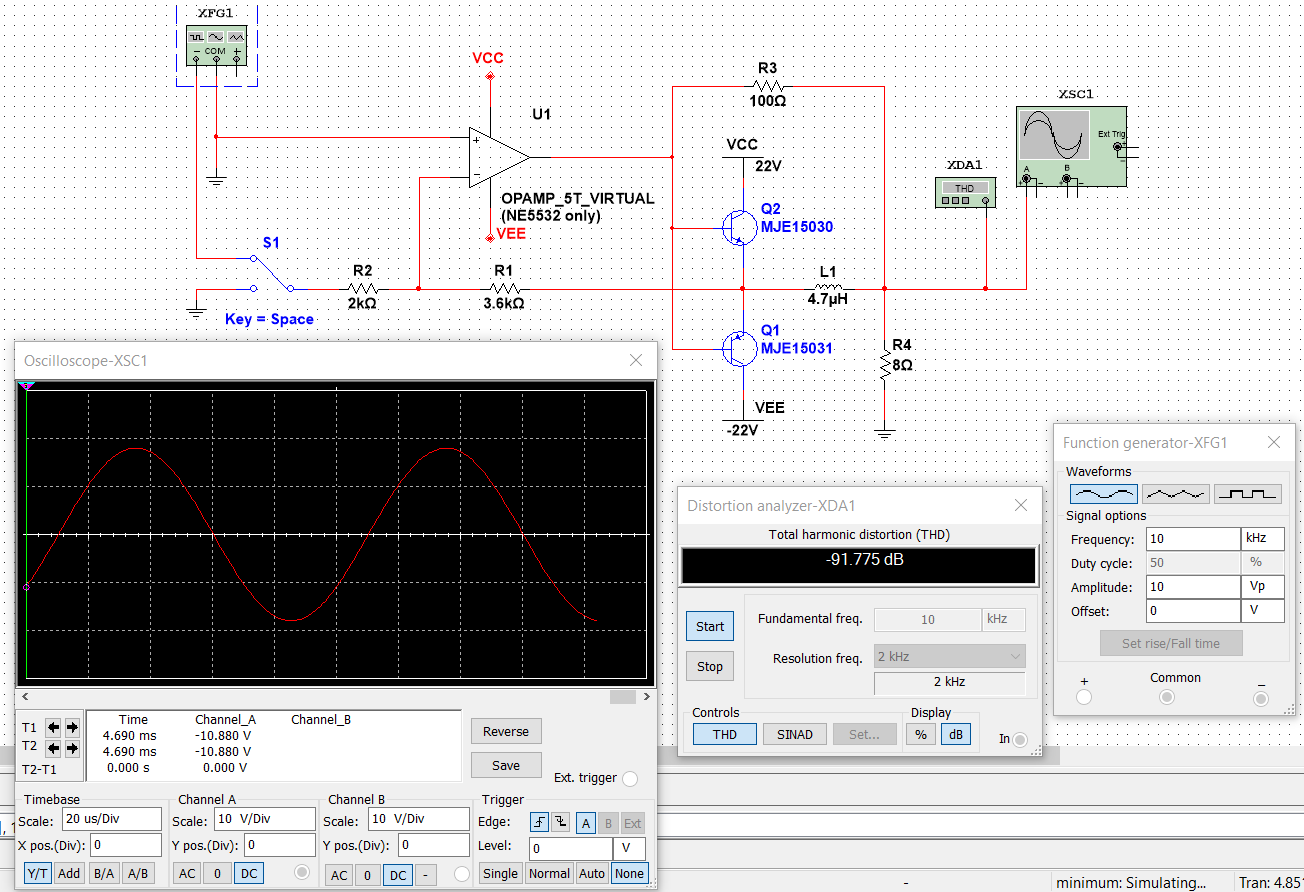

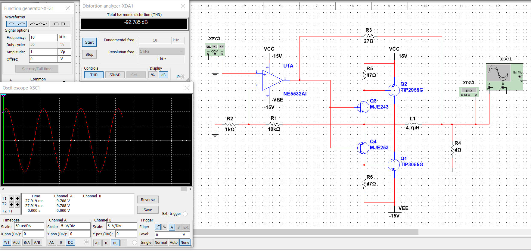

Who wants to try this?
Current Dumping with OPAMP. All the resistors and inductance are tuned for NE5532. Those values just happen to cancel out all the distortion, WITHOUT any bias current.
I can't find my breadboard. 😕
I might try this in the upcoming holiday.

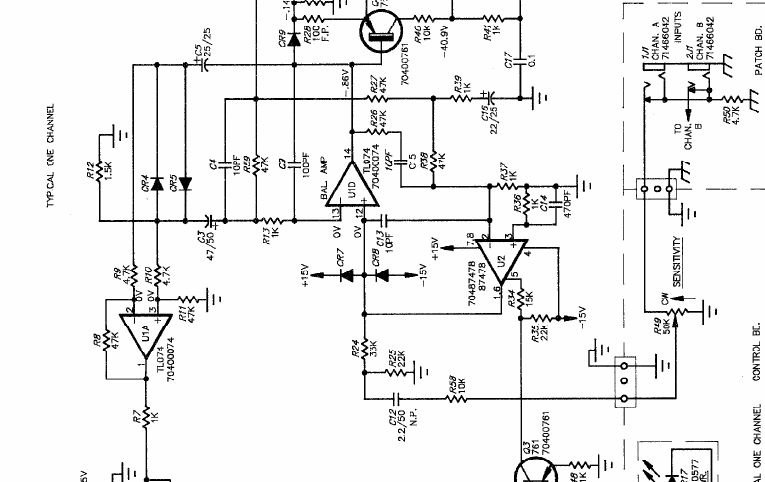

Actually the TL071 is one of the more well behaved types for input stage use. Keep the input current under fault conditions under 4 mA and all is well. I’ve tried more advanced versions (OPA2604) that sound just fine - but the first hint of amplifier clipping blows the op amp. TL071 will take being run to clipping all day, generating large differential inputs, and smile. My go-to is the LF412 for amps with abuse potential. The second op amp in the package is useful in other ways.
You really don’t want any power amp input stage potentially exposed to guitar amp output jacks or mains voltage. It will blow non-op-amp amps just as easily, or wreck your precious hand matched input pairs even if it survives. So how do you prevent that? Use another op amp (totally separate package) to do the balanced/unbalanced conversion, and it’s output will never exceed +/-13V. Even in you manage to blow it the worst that can happen is sending 13V to the speaker.
The only real issue with the 071 is it’s lack of drive capability. It works well driving a common emitter small signal stage. Not quite well enough driving common base, and won’t directly drive big power followers. It will drive EF2’s just fine, up till you need more than 10 mA of base current. There are times when that’s just not enough.

Here is an input structure that will prevent that. R28 is 1/10 watt resistor to burn out if a roadie plugs a 75 w bass amp in the input of the M-2600. Excess current goes through diodes to power supply until burnout. Most of the feedback is through a 25 uf e-cap. There is a 4.7k direct feedback resistor. U2 is a CA3094 operational Transconductance amp. Overdrive compression. Listening to this now.In practice it won’t reverse if the feedback resistor is large enough to limit the input current to +/-4 mA when/if the speaker output goes to either rail.
