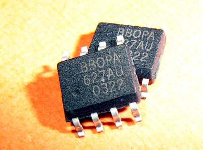

SOIC fake?
How about these? I couldn't get OPA627 from digikey or mouser, so I tried eBay.
Couldn't comment on the sound because I soldered them into adapters then plugged them in reverse polarity after not enough sleep and fried them.
The SOIC ones that I received didn't have a pin 1 marking.
Topside marking:
BBOPA
627AU
0322
Bottom marking:
TWN
