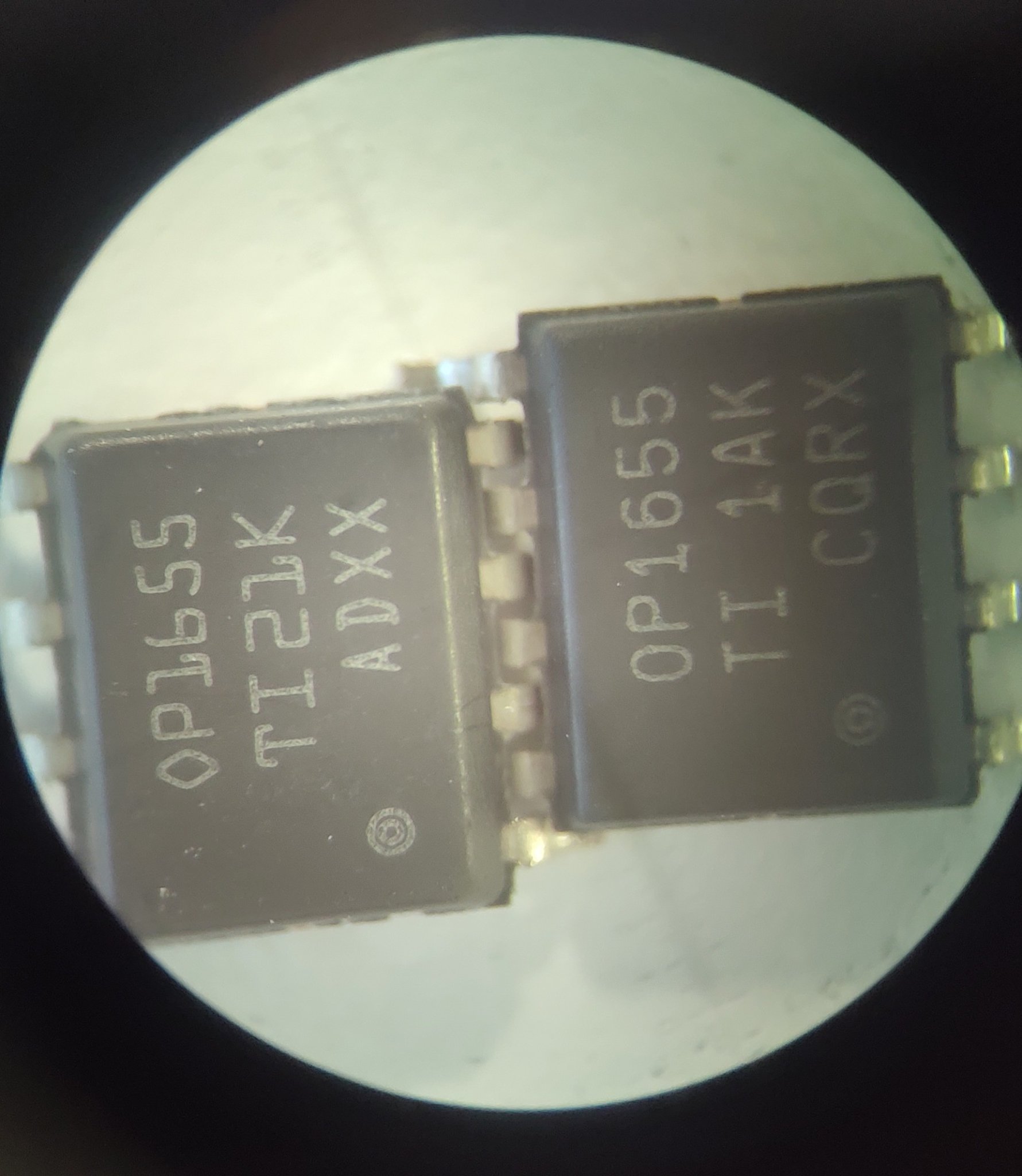

I can not see why anyone would go through the bother of putting a fake part in a sealed tape format. Look at the TI spec, they show info on the part marking scheme. Looks genuine, if not doing a damn good job at making fakes. There are a few simple tests to verify it’s real.
I do wonder how these parts get into Russia however, I thought the country is sanctioned. Oh, now that I think about it some more, Russia is in tight with China and China don’t care about sanctions, so ask your China source if they are real or they are stealing your $.

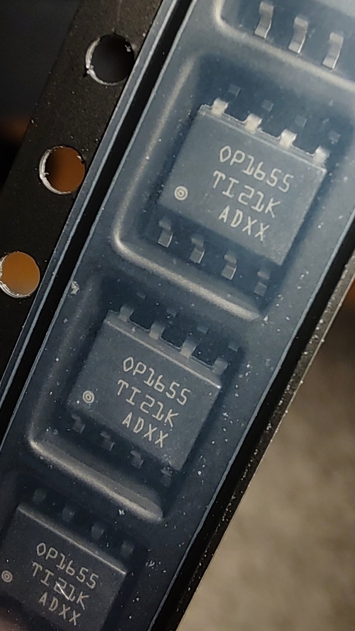

My OPA1655s from Mouser have similar style of markings.Hi everybody! Anyone know is it original opa1655 or fake?
May be it is new marking style )
Thanks a lotMy OPA1655s from Mouser have similar style of markings.

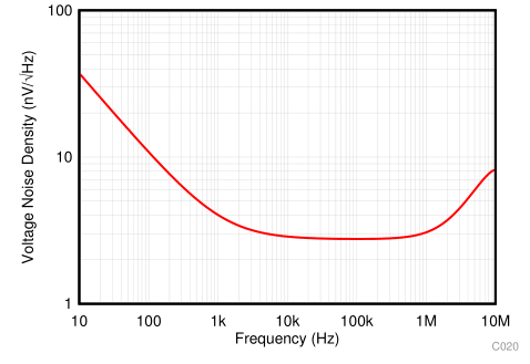

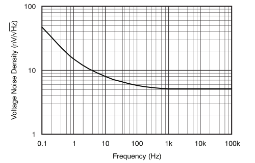

Actually MOS, not junction FETs. This isn't merely an academic difference, check the noise behaviour of 1656 (top) vs 1642 (bottom).
View attachment 1100451 View attachment 1100452
These graphs show have different scales. Lower one goes to 100k top to 100mhz. Look very similar in the same range.
If you accept almost 2 orders of magnitude higher distortion, maybe.

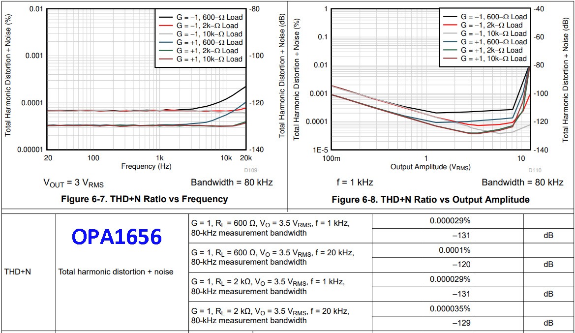

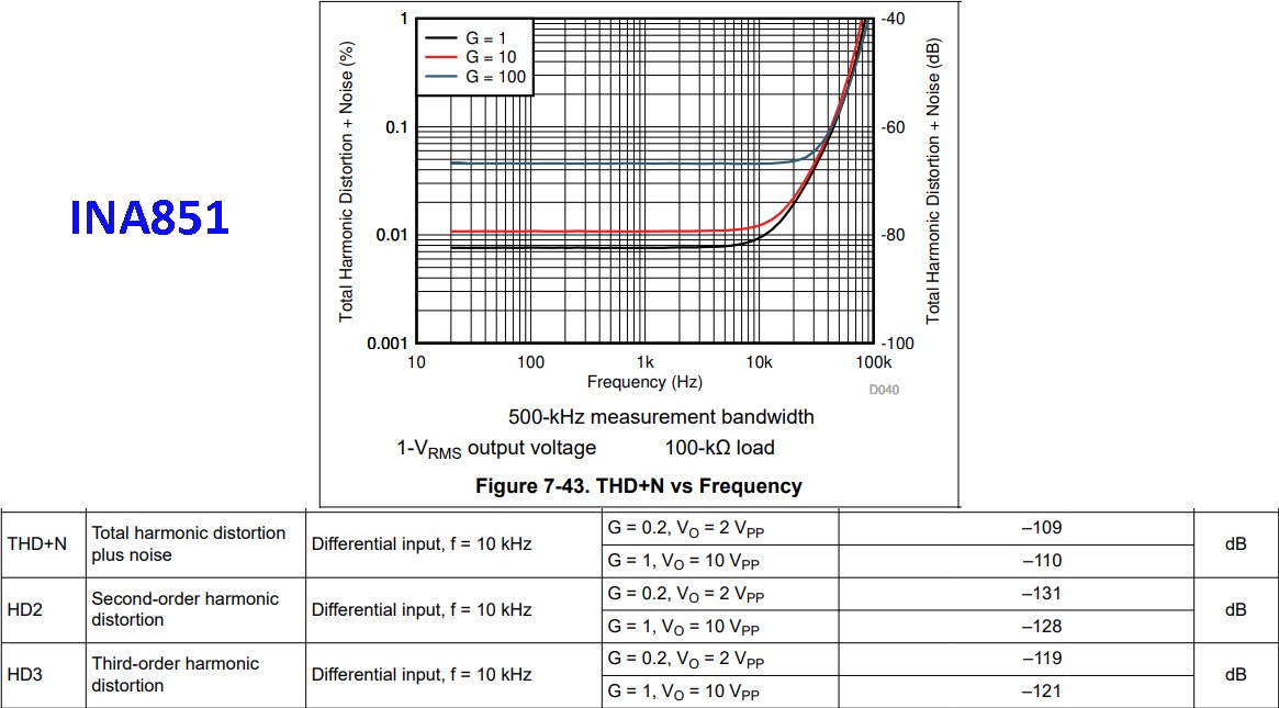

I´m afraid the specs make it a bit difficult to compare.
When both amps at Vout=3.5Vrms, Gain=1 and Load=2k
The INA851 specifies THD+N at -110dB @ 10Khz and at a BW of 500Khz.
The OPA1656 specifies THD+N at -130dB @ 10Khz and a BW of 80Khz, why is that, how does the spectrum look beyond 80Khz ?
Also take into account that when using three opamps, distortion will increase accordingly.
I would be surprised when the INA851 can't match it.
