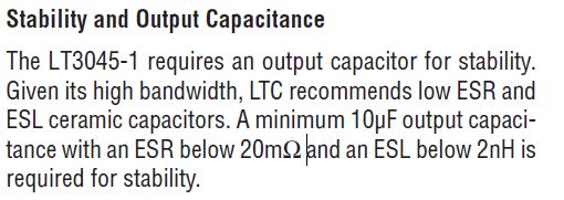

Maybe you should study the datasheet. It states that 10uF ceramic is the minimum output capacitance for stability.
Also this should explain why larger capacitors (e.g. elkos) do not work:
The last sentence is actually why I was surprised that lower values got me better sonic results. With the LT3045 on the AK4493 it has been confirmed that taking out the 100nF close to the supply pins measures better. So much for Data Sheet recommendations.
That minimum capacitance is not a recommendation but a requirement for stability.
As a developer working on LDOVR boards, I can confirm the necessity of the output capacitor to ensure stability. Insufficient capacitance can lead to ringing and introduce output noise (although the correct output voltage may still be maintained). However, the required capacitance is also contingent on the output voltage. Lower output voltages can function with reduced output capacitance. Based on our experiences, LT3045-based boards with 10uF XR7 output caps (Murata GRM series) haven't encountered issues. Nevertheless, if the output voltage is below 5V, a lower output capacitance may suffice. Additionally, it's worth noting that larger output capacitors do not pose any adverse effects.

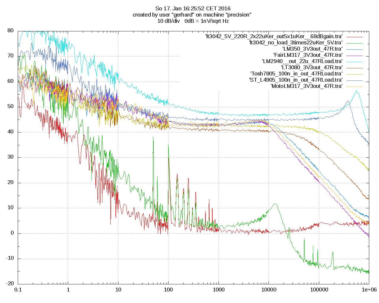

Excessive output capacitors will be punished by an output voltage noise peak.
Output impedance of opamps and regulators looks slightly inductive, a consequence
of their 6 dB/octave gain drop. Still, the LT30xx family is in a class of it's own, but
if you are after minimum noise, you should damp at least the large capacitors.

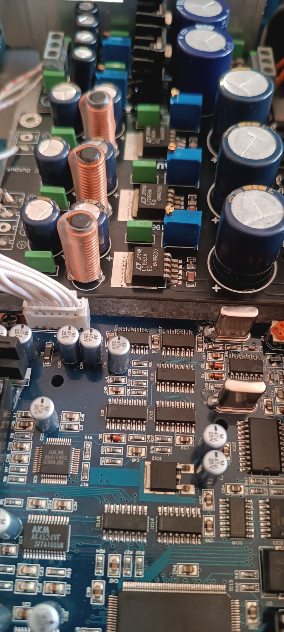

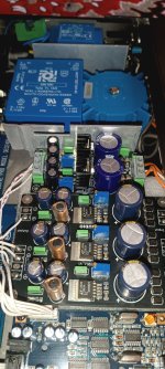

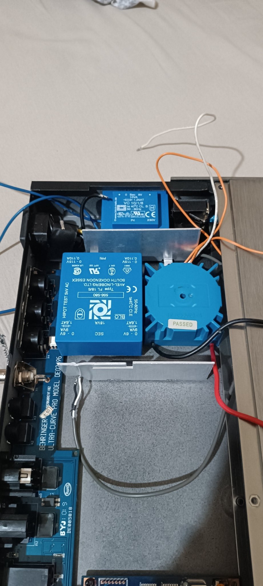

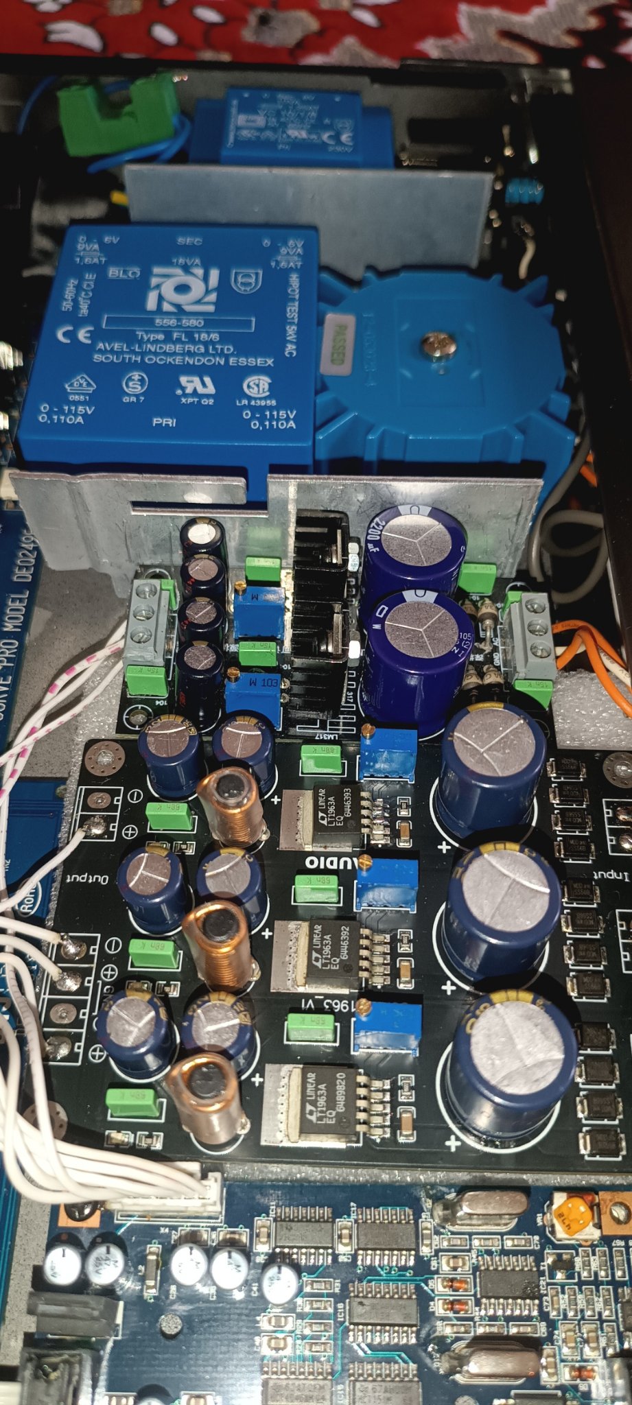

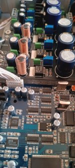

Hello, I will install 11 opa1656 in deq2496. Is 2x15 10va transformer enough?
