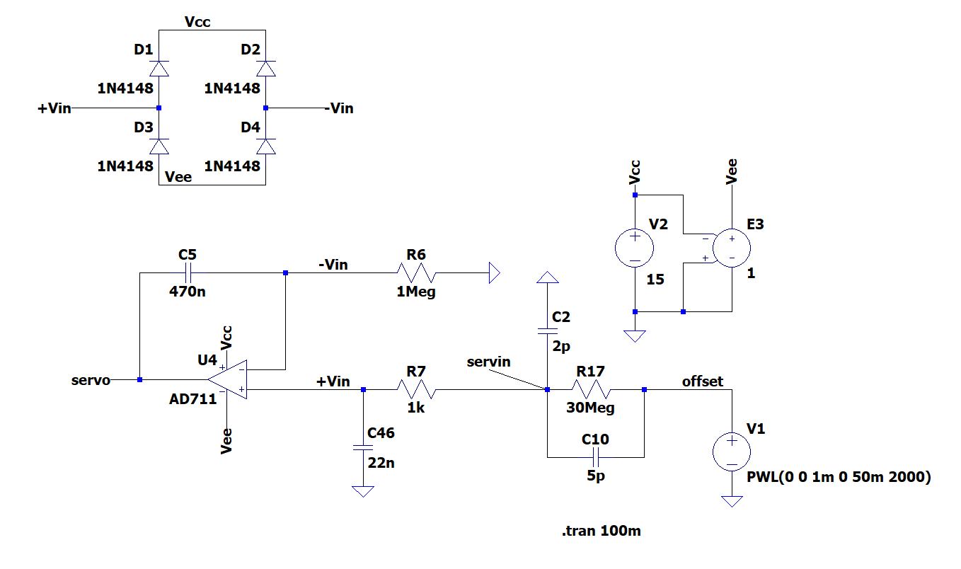

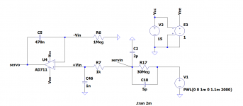

One idea I had was look at the servo operation in itself. Its an integrator and will quickly exceed all max specs when fed with a DC voltage - the output keeps on climbing, unchecked. The saving grace is that it is supposed to throttle down that input offset through its feedback loop.
But, if it takes too long for the offset to be reduced by the feedback, the servo opamp is in trouble.
The throttling down can take too long if the time constant is excessive, or - if the initial offset is very high. Like 2kV.
The attached shows what happens when the feedback loop isn´t there, and it is clear that if it takes more than a ms or so to reduce that initial offset, something has to give. The opamp output slams into the rail, but the input differential goes through the roof. (I know that some of the values are probably not exactly right - it's the principle I want to expose).

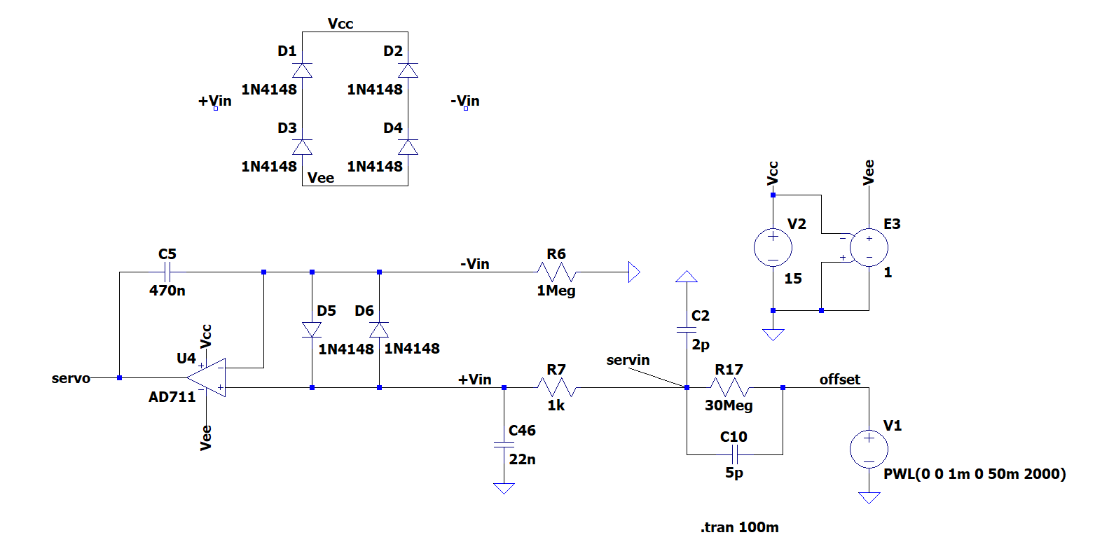

Are you sure that op amp spice model includes back-to-back diodes? The input differential voltage can only increase if there is a substantial amount of current flowing through those diodes.
The place-holder opamp in the schematic does not have input protection diodes (DM input specced at +/-20V).
BTW The Vcc/Vee are totally separate and applied before the HV is enabled.
I did notice that with antiparallel diodes on the inputs, it takes a second or so for the offset to go down to zero. Without those diodes it goes much faster.
Sounds logical.

At the end of the day, your problem went away with the OPA1641. I was just trying to make the point that with an OPA172 in that circuit I don't think the op amp would ever experience a huge input differential voltage. The internal back-to-back diodes would clamp the voltage and the huge resistances in series with the inputs in your circuit would limit the current flowing in the diodes. Hence why I was thinking you might have a supply condition causing a latch-up of the op amp on power up. 1641 would be more resistant to this issue as well due to the dielectrically isolated process it's built on.
There are protection diodes to the rail as well. Again I don't think you could get anywhere near to 10mA through them in your circuit.
