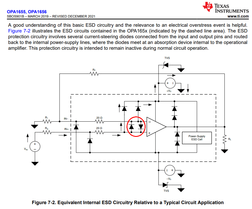

Guys, this may have been addressed before, but do the OPA1656 and OPA1655 allow differential input voltages up to the supplies?
The data sheet is ambiguous on it.

Vcm means that the inputs, which normally at almost the same voltage in operation, can move up and down to within the supply voltages, as a pair.
If the DM includes the rails, that means that one input can be at one rail and the other input at the other rail without breaking anything.

According to post #710 that I linked to, there are antiparallel diodes between the inputs, so you can't go further than 400 mV...500 mV without the diodes turning on.

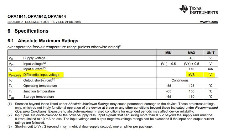

The OPA1642 has protection diodes from inputs to the supplies, so probably can accomodate supply voltage DM inputs, although not specified.

If you take a look at the Absolute Maximum Ratings table in the OPA1642 datasheet it specifies the input differential voltage can reach the supply voltage. As you point out, this is pretty common for JFET-input op amps. The gate oxide of the input MOSFETs on most CMOS op amps can not handle differential voltages up to the supplies. Some CMOS op amps have special protection circuitry which does allow for it though, some examples are OPA192 and OPA189.

As Marcel pointed out, the '16561655 has input protection between the inputs so the DM input is limited to the diode tresholds.
This makes sense for audio applications of course and in no way detracts from the stellar performance.

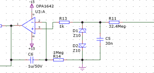

In my case, there can be a large DM input signal at startup. I blew a couple of OPA172's before realising it ...

We (the OPA1655/6 designer and myself) experimented with a number of different input architectures, and decided to just keep it simple and stick with the input antiparallel diodes. I'm surprised your signal at startup is able to destroy the OPA172. I had previously found that the CDM ESD resistors (in series with the inputs) on that device made it fairly robust against input differential voltages.

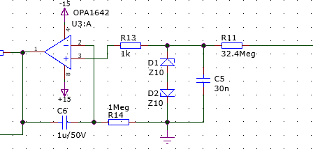

Initially I had 10V zeners in series (opposite polarity) across the inputs, and lost a few OPA172's.
I then replaced the zeners with two antiparallel 1N4148 diodes and had no more issues.
The diodes did impact the distortion of the circuit though so I deleted them again and went with the OPA1642 with no more losses.
I didn't prove that DM input signal at switch-on did destroy them, but the evidence points to it.
It is a non-inverting servo circuit fed through 32.4Megohm from a circuit running at several kV supply ...
(Zeners are no longer there).

Maybe it is a good idea to divide that 32.4 MOhm resistor in a few resistors and also 1 resistor parallel over C5.
I don't see how this circuit can push more than the rated 10 mA through antiparallel protection diodes between the op-amp inputs, unless several kV means > 324 kV.
Depending on your requirement, maybe apply a resistor between +- opamp inputs in the same way as noise gain is increased for measurements? It shouldn't take much to swamp likely capacitive leakage paths.@marcel: I know. I was looking for some capacitive paths for transients.
For transients, the output connects directly to the inverting input.
That could make the diff input voltage high. I think.
Maybe put a resistor directly in series with the inv input?
