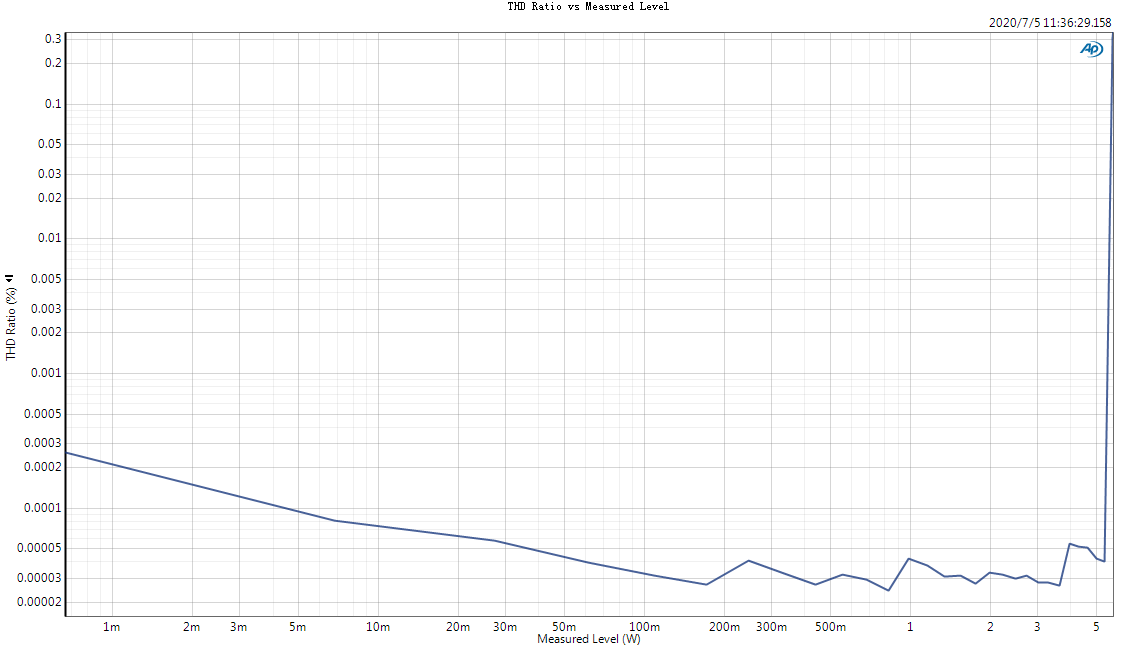

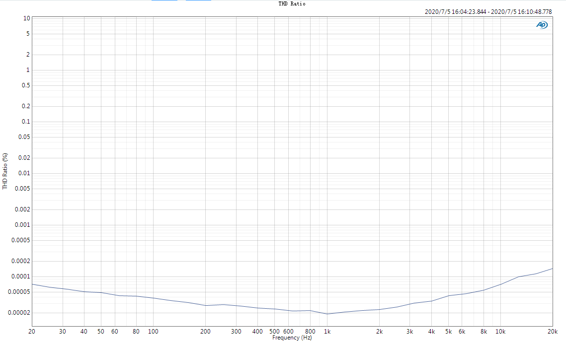

opa1612+opa1656*10 composite with flying /bootstrapped supply
1A peak output current 🙂
5.5W at 32ohm and 870mW at 300ohm single ended is pretty extreme ei? As THX calls 3.9W at 32ohm extreme.

Appears to be slewing johnyang1997
Doesn't appear so.
Doesn't appear so.

A 100mVRMS @ 100kHz non offset (+/- 70mV) square wave response for the people?

How so? There's no indication in his graphs for any large signal non-linearity. Quite the opposite, he's basically measuring the AP residual.

That's pretty remarkable. However I would take care of the noise a bit more. Mine is less than 0.3uV 20KHz BW. But really really really good design especially being a finished board that actually measured that way. There are also some differences from my design. I didn't bootstrapped the first opamp because I want the first opamp to be as stable, simple, predictable as possible. I added a bit of gain in each opamp at the output stage to utilize the RRO of opa1656. 900mW(<1% THD) at 300Ohm single ended with +-24V supply is very nice imho.There was a similar design in this forum not long ago:
