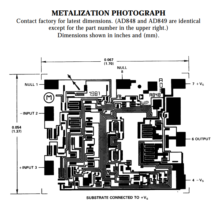

That's roughly 300 x 52 x 50,000?
I'm sure TI builds their analog ICs on 12 inch diameter wafers; each one has a surface area of 113 square inches. We can assume the opamp die size is roughly comparable to the competitor device "AD848", namely 0.067" x 0.054" = 3.6E-3 square inches per die. So there are approximately 31,200 die sites on a 12 inch diameter wafer --- if we pretend there are no partial die around the perimeter, where the wafer's curved edge cuts through the middle of a rectangular die.

I was just remembering that the 8 inch wafer Stuart and I got was supposed to have 50,000+ OPA1656's ...
But yes there's the yield.
Jan
A bit of a clarification, there should be something closer to 25,000 OPA1656s per wafer.
Not all analog processes have moved to 300mm (12 inch) wafers. Regardless, OPA1656 is on a fairly mature process that has been around for over a decade. The successor process, which is on 300 mm, was not ready at the time I was working on OPA1656.
