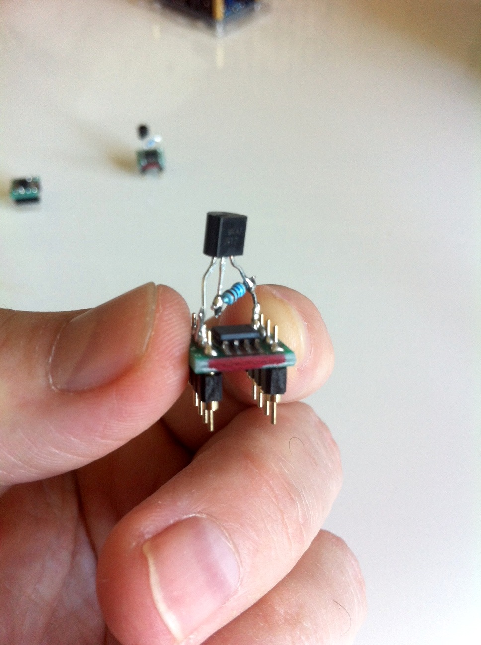

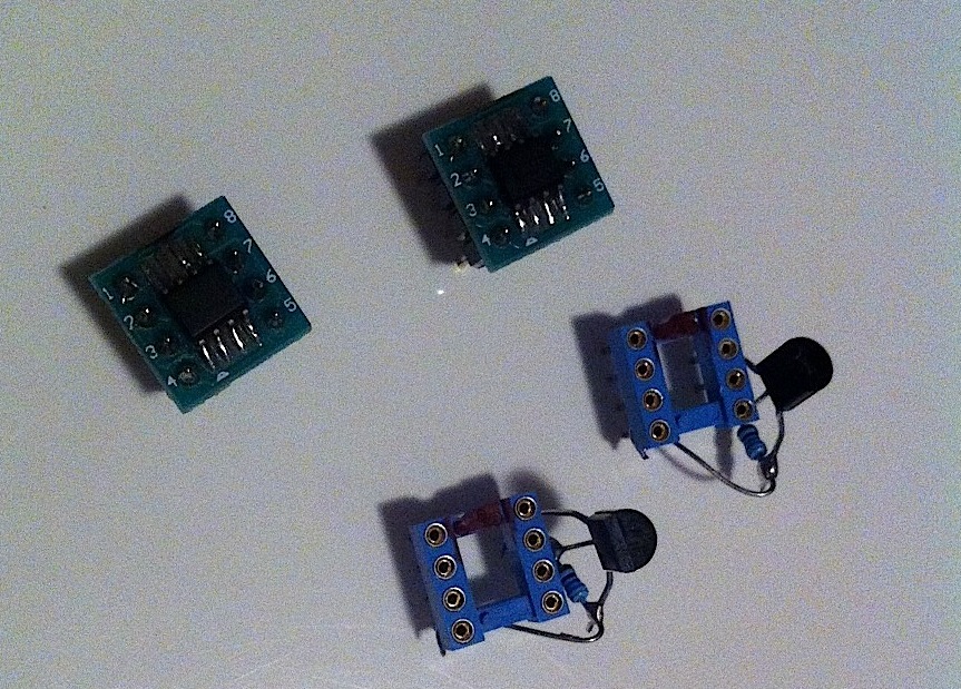

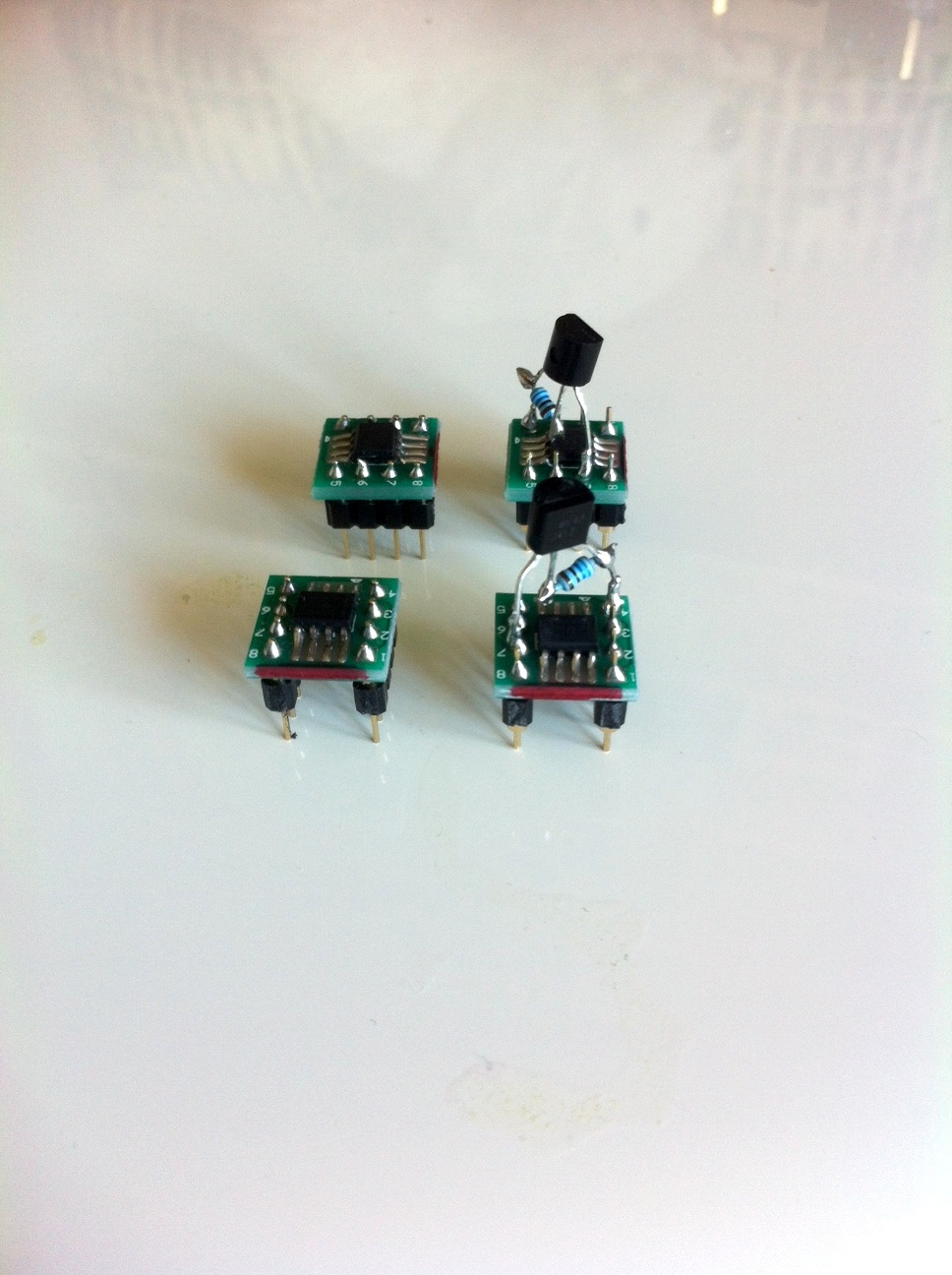

Some progress on the Class A bias…
I did a very dirty build just to decide if it would be worth investigating this potential tweak further in depth or not, before going for the a proper set up, especialy as John said modern chips wouldn’t benefit from this tweak… And I have no reason to doubt him. But as time allows it…
This is a crude test rig in form of an additional socket/ adapter (I know it is not intended to be used like that !) containing 1 transistor and 1 resistor for the Class A biasing of one op amp (single or half a double, output stage). Any (double or 2 x singles) Op amp can be quickly inserted so that allows quick comparisons of the exact same device with and without Class A bias. It also enables biasing or not different op amps nearly on the fly. Downside is I end up with a pile of sockets, that one being sandwiched, but well, just to have an initial flavour of the sonic direction, quick and dirty…
I only tested the 3 contenders I liked best. Bias is 2.6mA: enough to stay in class A with my high impedance, high efficiency HP.
AD825
I am using it in Class A bias since 2001, that’s my long time favourite that way. I do know Class A really trenscends this part. However, finding out if the same magic would work is a good test to know if my additional Class A socket works and does more good than harm, as not a proper « directly sordered on a board » solution. And the magic worked exactly as expected. The sound began to flow, was airy, very much addictive with a lot of drive and a nice integration and consistant fusion of all registers inclusive treble. A very nice representation with a great soundstage, IMHO that Class A bias has here no downside. That sound is very likeable with nor real flaw or sharp corners. It improved a lot, but despite its Class A bias it doesn’t quite reach the level of a simple OPA1656 : it still lacks a bit of precision/transparency, low level noise, 3D soundstage in depth, and a non rolled off treble for that. In fact, it is not entirely neutral and reminds me of (good) old tube implementation – now that I played thanks to Papa with H2, I wouldn’t be surprised if AD825 has a lot of it and once biased in Class A it makes the most of it while diminishing its weakest points (due to its age).
I use AD825 in my 20y old DAC and it will stay there as it is still very good plus it rounds off the weaknesses of older DAC chips while flatering their sound. My guess is OPA1656 might not shine better (or be even too performing) in a weaker devices… while on the other side being the new king of the modern age as far as I am concerned.
ADA4627-1
It did not benefit at all from Class A biasing in my case. It lost completely all its magic and subtelity, sounding somewhat congested, muddy and flat / distorted. This one is IMHO best left alone.
OPA1656
I have no clear cut yet on this one and would tend to say I prefer so far this op amp not biased, so left alone. Note it is an excellent performer as it is, so no harm. IMHO the bias I used does quite affect the sonic signature of this op amp. On one hand, I did like the better bass, with more drive and impact while still managing to be less dry, but also the extra speed so nothing sounded washed off. In fact bass and speed across the register were what I liked. But on the other side I found some of the airyness and 3D was gone, sounds were less flowing and ending sharper, the entire representation had more density and was based on the bass, all was more to the ground, so some magic (subtlelity, agility, air) was lost and it is quite a different experience. I also found the extra speed and sparkle in the treble a tad more tiring long term. All these are nuances, not as big a change as for AD825, but still there. Hmm, I wonder if it asn’t all extra distorsions that I heard ? It also « seemed » to sound a tad louder…
So far OPA1656 benefited in some aeras of the bias, but IMHO in general it lost more than it gained. Now the big question is: did it lost due to the Class A bias… or due to me piling up sockets for this quick and dirty sound check ? Somewhere, I hesitate between leaving experiments as they are / using OPA1656 « stand alone »… and building a proper board this time without additional sockets, having the transistor and resistor directly soldered on the board (no extra adapter), to allow an apple to apple comparison ‘same board with and without Class A bias’. Just to see if what I missed wasn’t due in fact to the chip’s excellence… and possible sensitivity to non sense builds like my test rig (extra contact losses, extra stray capacitance…).
If you guys now better, just let me know, it could spare me some time although I will build another OPA1656 board anyway and adding a few parts directly on its top isn’t difficult… nor irreversible.
Claude
If you use a 2.6mA current source next to the output stage of the Op-Amps I’d say that you force them more into ClassB operation than ClassA.
The OPA1656 has a 3.9mA (typ) quiescent current per channel and per rail : by deducting the input/driver stages’ current consumption, the output stage Idle current will be somewhere around 2.5mA per rail. This leaves a maximum of 5mA peak available current for ClassA operation.
So I think that your 2.6mA current source will decrease the peak available current from the Idle for ClassA operation by more than 50% if you consider the OPA1656 instead of increasing it.
If I didn’t understand something, please explain.

Hmm... where to start...
You may want to read this, I guess it explains it pretty well:
Biasing Op-Amps into Class A
There are of course also other sources to explain the difference between Class A and Class B.
In short (and probably badly explained as my time and ability are limited), the idea is to make sure there is always a "current call" at the output stage eventhough music modulation would (in a ususal set up normaly) lead to 0V, hence never 0 crossing at the output stage. As for what the Op amp can deliver (its current delivery), that is far more, so we are far away from its max. / no saturation etc., so probably not the prob either
But at the end of the day, I don't know what is inside that chip (protections, limiters) and may force things, and don't know any other way to tweak it: so I just try it and if it sounds better, than fine... and if not, well... then I just tried 🙂

Yes but that's not really relevant for our purpose - they could have biased the output buffer if they wanted aswell.
It is just this article was handy (quick link for you instead of explaining it all) albeit indeed just an extension to comment an existing product (PIMETA). There are other articles on Class A bias, I believe the oldest I read was from the 70s...
Anyway, whatever we do and however it works (I guess I should switch off the engineer in me), all what matters is: does it sound better or not. In the past it did rather improve the op amps, maybe also because it helped their power supply rejection on the connected rail (look at other articles on the subject).
Anyone else trying this?
I may just spend my time doing the proper board and trying it out one last time instead of thinking and typing to try to fgure out, LOL
