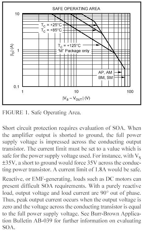

What rails are you using?
If you look at the following chart, I'm not shure how safe you are....:bawling:

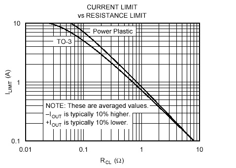

Here we see what Rcl to use after having studied the SOA:
Seems I also read the datasheet a little too fast before, as I adviced someone to use 0R1/0R15 with the opa541 am/ap respectively. Consulting the SOA chart and the graph below we see that with 35V rails we have to use 0R4 to be safe (1,8A limit)...:dead:
edit:
(Note that I'm not using any resistor at all in mine, nor does MatttCattt either I believe) -We're "fearless DIY'ers". ;)
This makes you think about the other chips, with pre-programmed protection (eg LM3875), and how safe they really are. I've read several places about people having fried their chips with shorted outputs/other nasty habbits. After all, why should we bother with CL in a chip, whilst we don't with the other (discrete) amplifiers we build? I say; leave it out, enjoy the fat sound, and don't do nasty things to your amps! ;)
