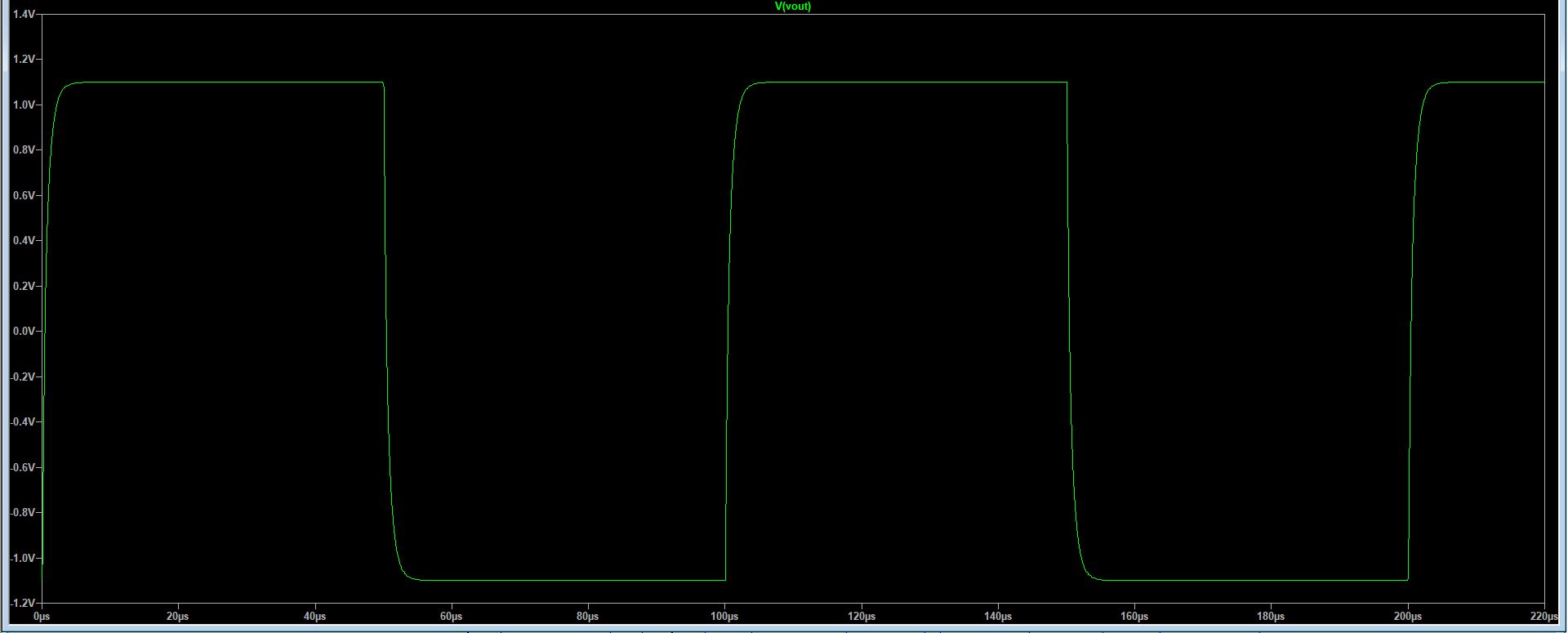

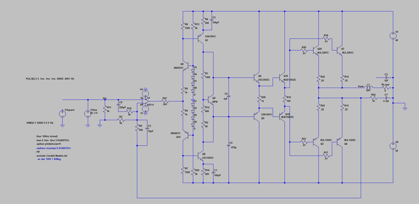

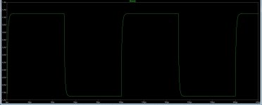

For your entertainment, a version with the common base level shifter. Looks better than I expected, quite honestly. Distortion is improved slightly over the previous version at the cost of 2 extra small-signal transistors. The schematic is unchanged enough that it should be easy to add an extra footprint in the PCB to allow for the other version with the capacitors, which could make for an interesting real-world comparison.
Two 100 pF capacitors, C1 and C2, were added as it seems to help the phase margin. It now has 50 degrees of phase margin as opposed to 35 degrees of phase margin- an improvement.

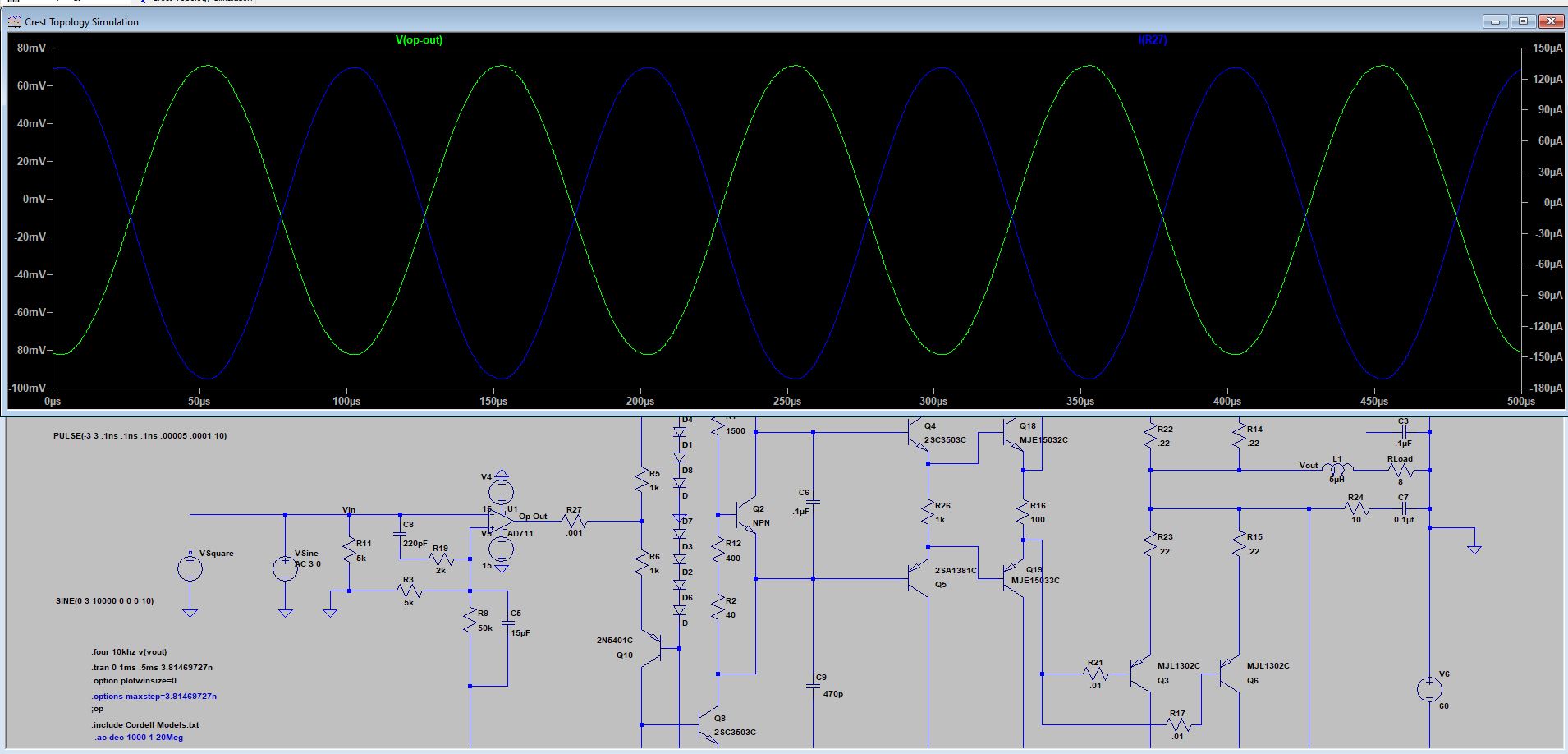

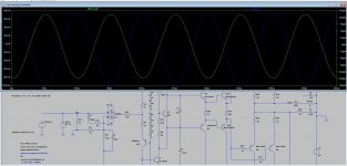

As can be seen in the image monitoring the current through R27, it shouldn't require too much from the op-amp to drive it. I calculated an input impedance (as seen by the op-amp) of roughly 500 ohms. While not low, even a TL071 should have no difficulties driving this, since it doesn't have to swing much voltage.
When I have time, I'll play with a common emitter version and see how it compares.

If you do that you need to increase the emitter resistor value or you’ll burn 14mA in the level shifter transistors. Then you start losing gain without adding any linearizing local feedback. Pick your poison. Mine would be the diodes.
With the common emitter version, I’ve never found reverse breakdown to be an actual problem. It runs beyond Vbeo rating, but that can be “almost” fixed by using the C1008/A708 pair, rated at 8V. They don’t break down till much higher - I use them for audio signal clamps because of the vbeo rating and the low on resistance. Cascode with a high voltage type on big rail voltage.
Another improvement is to clamp the op amp output with 5.1V BTB zeners with 1k to limit the op amp current. Detecting current thru that branch is a perfect way of detecting clipping to activate a soft clip or compressor circuit. Of course there is always the option of 5V op amp rails - but that limits what you can do with the supply - on real world implementations there is often a myriad of protection and support circuitry operating off those supplies. When you start adding all THOSE components, a bit extra complexity or BOM cost is lost in the noise.
At least from the simulations I've done, under no conditions would the base-emitter junction in the level shifting transistors be reverse-biased. The output of the op-amp is incredibly small.
