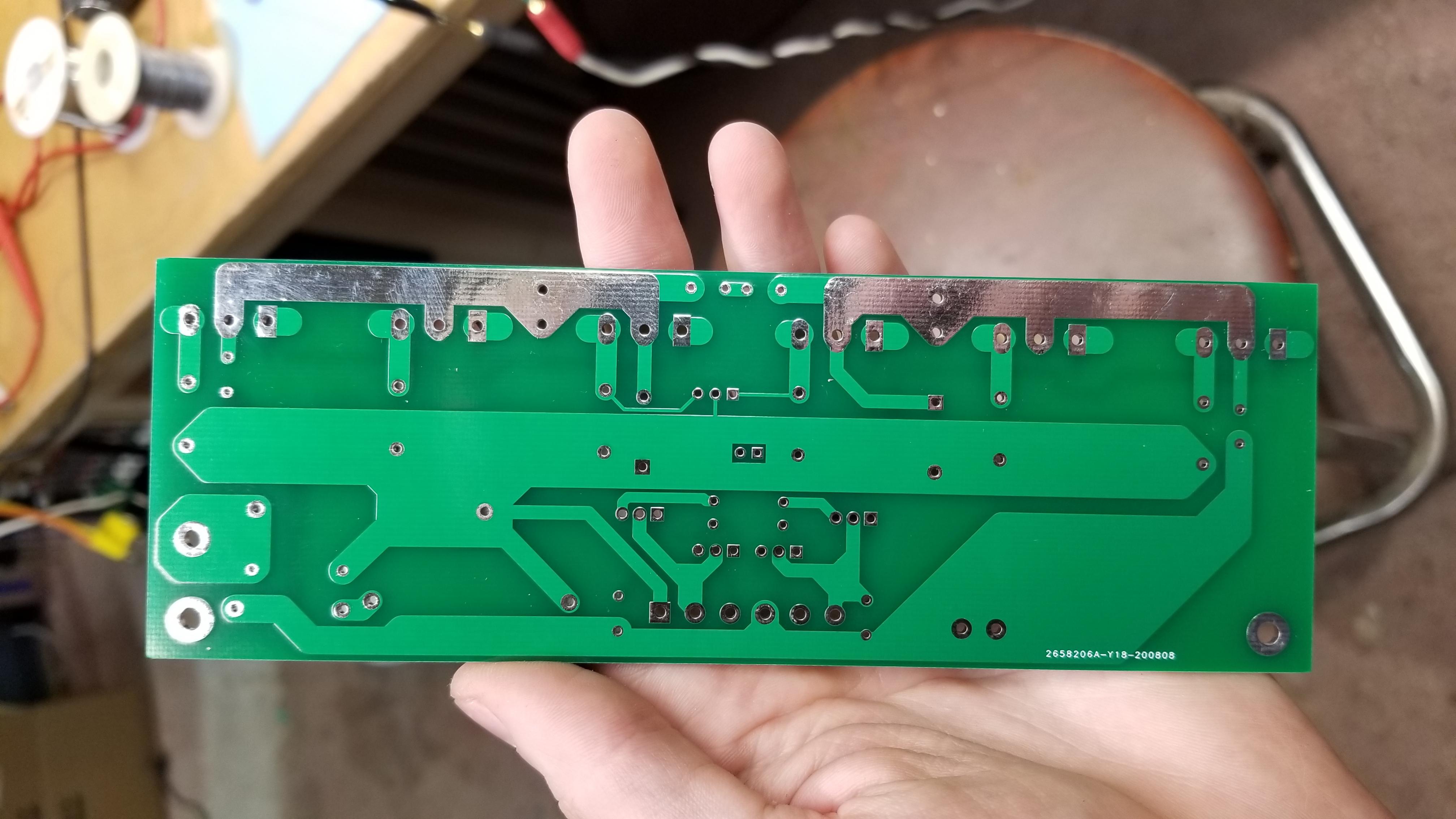

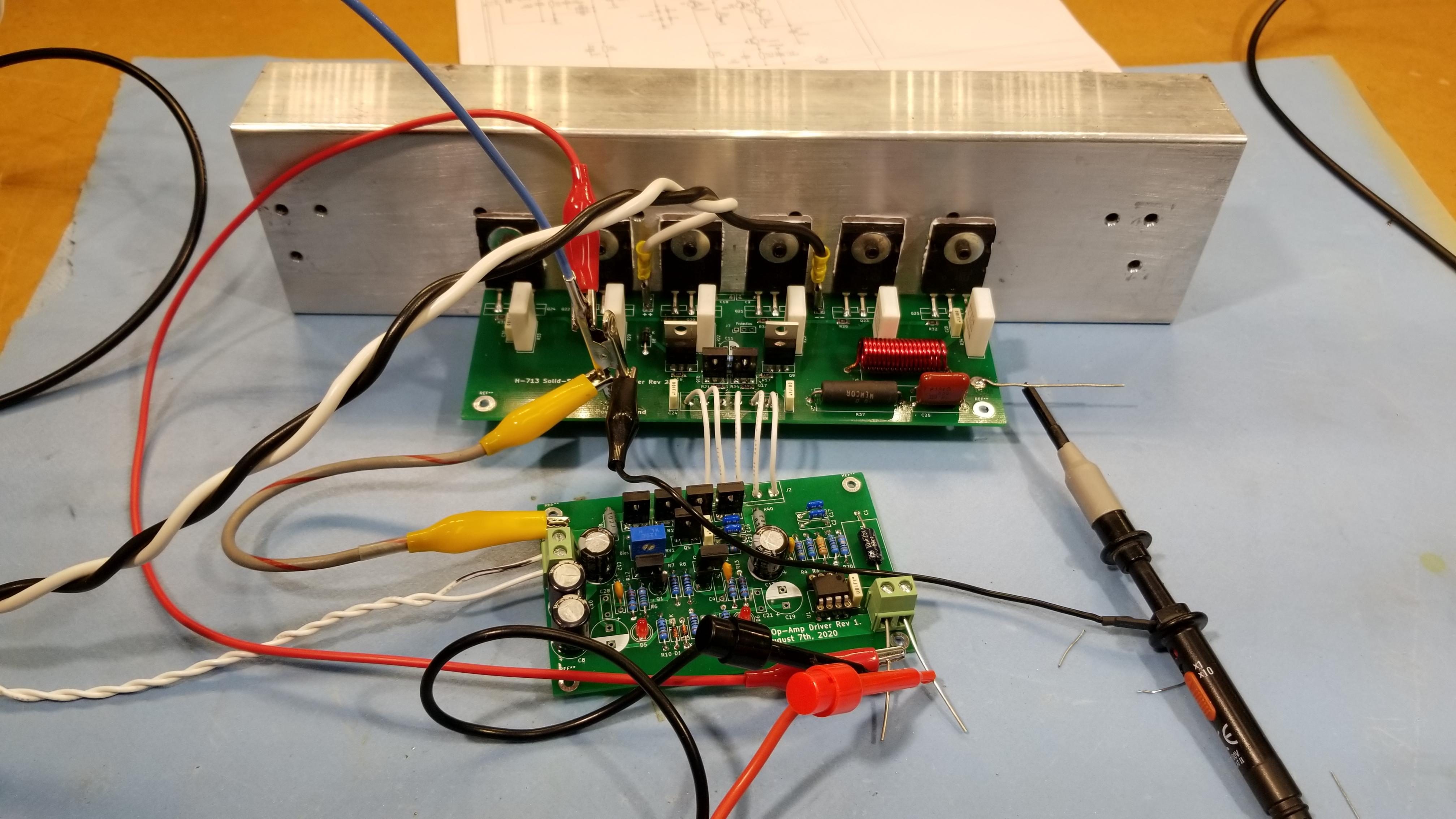

For this project I decided to try separating the output stage from the rest of the power amp. I'd say it was for "grounding reasons", but in reality it was to simplify the process of testing new input / VAS stages without having to deal with the output stage every time. This saves cost and time.

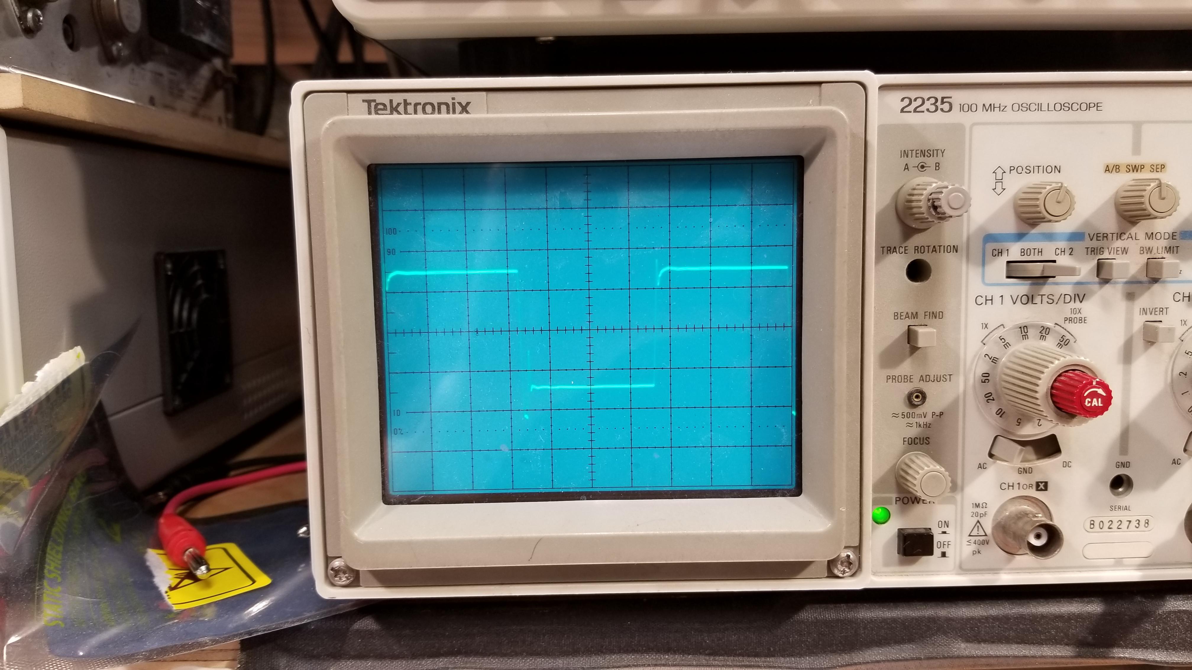

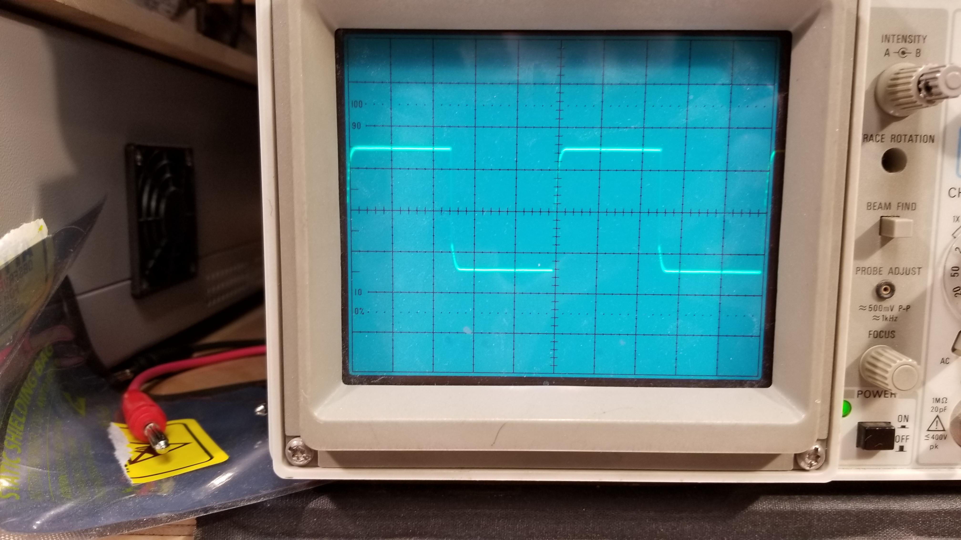

Distortion looks fine, probably limited by my measurement setup and test configuration, but even into a 4 ohm load it never got worse than .007%. That is using an OPA604 and some spaghetti grounding. Stability isn't great, see attached images. After tweaking a few cap values, I was able to get it considerably better. I also added the compensation cap to the new PCB layout that will hopefully allow a 5534 to work in this circuit without making everything go ballistic. Other suggestions for through-hole single op-amps are welcome.
Since the shipping from china usually costs more than the PCBs themselves, I also ordered output boards that use TO-220 MOSFETs. I know the SOA of the TO-247 FETs is much better, but the FET version will be used with around +/- 35V rails anyways.

The square wave response of the amplifier in the second pic looks quite stable, the 5534 is a good opamp but remember to add at least 22pF of compensation if using gains lower than 3, if you add feedback resistors (not using it as a buffer) you will definitely need to add some pF's across it to improve stability, if you can afford it, the AD797 is loved by many in case noise is an issue, apparently THD is also lower than the 5534, but I don't know what your source impedance is or what you plan to connect to it.
I thought about the AD797, but the big advantage that it holds (extremely low noise) is really not a big deal here. THD is improved over the 5534, but IMO not enough to justify an almost ten fold increase in cost. I really wish TI would release a single version of the LM4562, but alas, I don't think that will happen.
