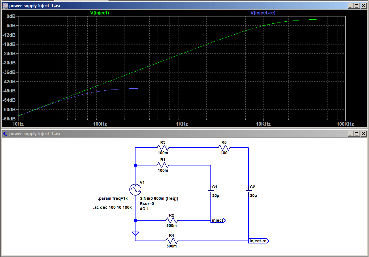

The practice of rail-rail decoupling only or avoiding local decoupling altogether (aside from 100 nF or smaller) stems from the days when power and signal grounds would be shared and return resistance alone could be far from negligible. (Lots of constructions would use multiple single-layer PCBs joined together by connectors, for example - from the 1970s well into the late '90s at least.)
Under these circumstances, power supply source impedance, decoupling capacitors and ground return impedance will form a complex voltage divider with a highpass filter characteristic. Effectively, highpass-filtered power supply noise is added to the signal much like you would see with a ground loop. The magnitude of this effect easily degrades effective PSRR below what you would expect from circuit performance once local rail decoupling gets into the double-digit µF.
Under these circumstances, adding extra series resistance markedly reduces the problem, even if it does introduce the possibility of crosstalk between circuits if inherent circuit PSRR is modest. A simulation to play around with is attached. (If 500 mOhm of shared ground return seems excessive, try 100 mOhm.)
Much of classic audio engineering revolves around dealing with things like these.
It should come as no surprise, perhaps, that some classic audio equipment can be quietened down substantially by reworking and reinforcing the grounding. In the past I had a bit of an oopsie when the introduction of local RC filtering to get native circuit PSRR up (which had been very low stock) resulted in injecting too much power supply noise, and a dedicated power ground return was needed to fix the issue.

Many classic audio op amp circuits are floating. The AC signal only references ground at the input. Active tone controls are an example. The only ground goes to the + input of the opamp and you want it to be a quiet ground. Capacitors to the rail can and will inject local noise into the ground.
For stability, you need to have a low impedance at high frequencies between the power supply pins. A single 0.1 uF high Q ceramic capacitor accomplishes this. Connecting one from each leg to ground will increase the impedance between the pins, as well as risk introducing noise locally into the ground. It is both counterproductive and detrimental to circuit performance.
The local electrolytic bypass capacitor(s) are different. If the circuit is floating, referencing ground only for DC bias, then use one electrolytic capacitor between the supply pins. If the circuit drives a ground referenced load (like a headphone amplifier or line level output) then use an electrolytic capacitor from each pin to ground. Use a separate "dirty" ground for this.
That's what I've always done, and it's always worked for me.
