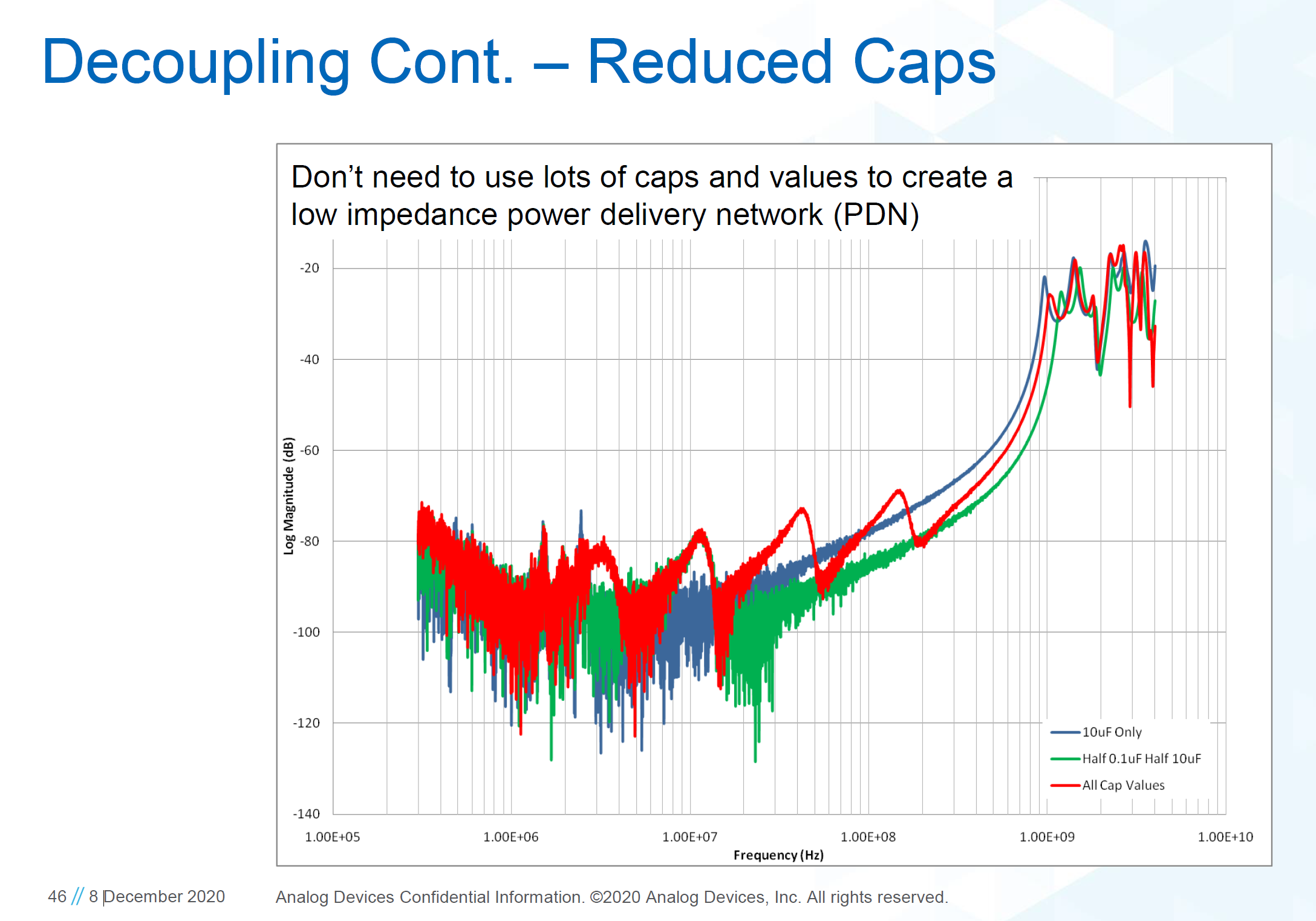

Chris,
I look at your impedance plots and get a different take.
Here is another example attached, actually measured, from an ADI webinar last month.

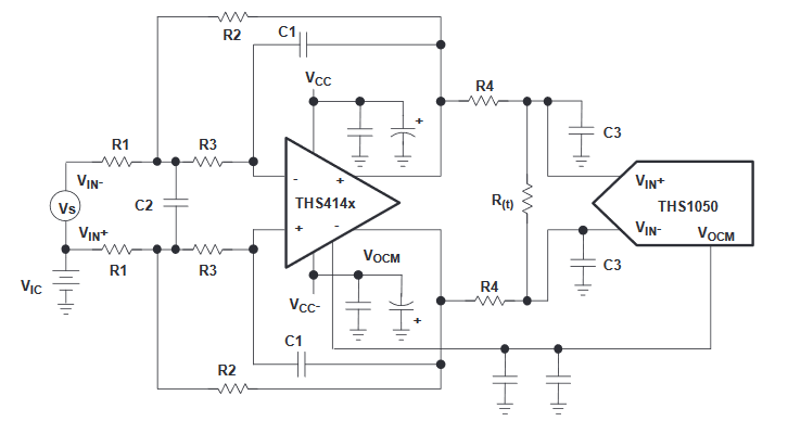

Unfortunately this is not rail-to-rail decoupling, you may need to re-read that schematic. That's a standard FDA with a VOCM pin.
Absolutely, the rest of my post got lost
I already showed before that there is no use of C between rails for decoupling purposes and another guy wrote fully diff amps need to be decoupled with only one cap across the rails. It is not so.
That graph shows what I was saying. Cool.
Actually, if you read the caption, it does not in spirit. But hey, you are free to believe whatever you wish.
