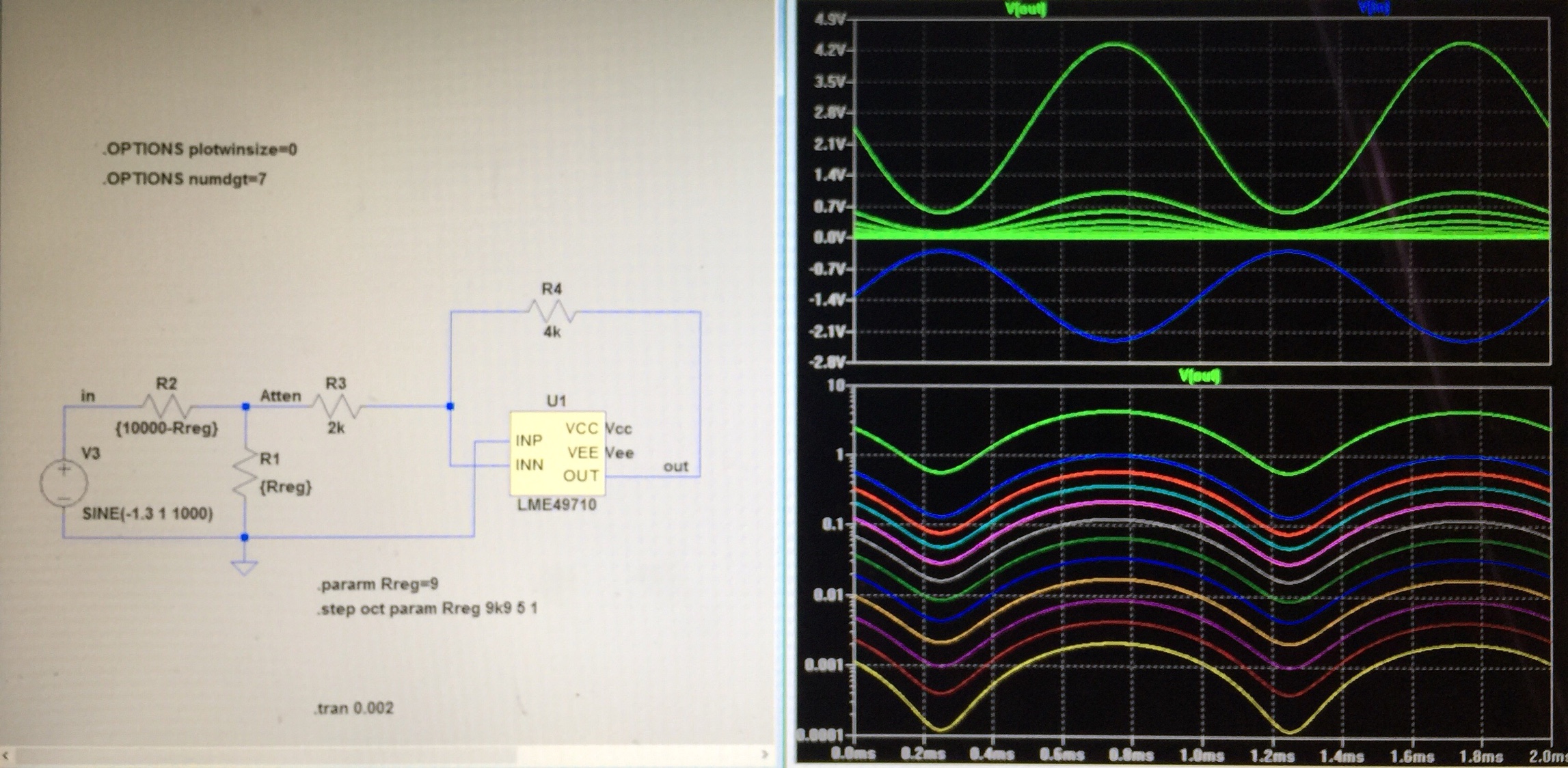

Actually, this might be interesting for a topology suggestion. I like the linear pot providing a log slope trick. With a bit of design work (even virtual with LTSpice) it might be adjusted for 0-20dB, rather than -20dB-0dB. That, and a higher rail opamp, and you're good to go... Too bad TI isn't selling boards for this, pretty simple layout though...
http://www.ti.com/lit/ug/tidu034/tidu034.pdf
You can achieve pretty logarithmic regulation a step better than best log potz could achieve with only linear potz.

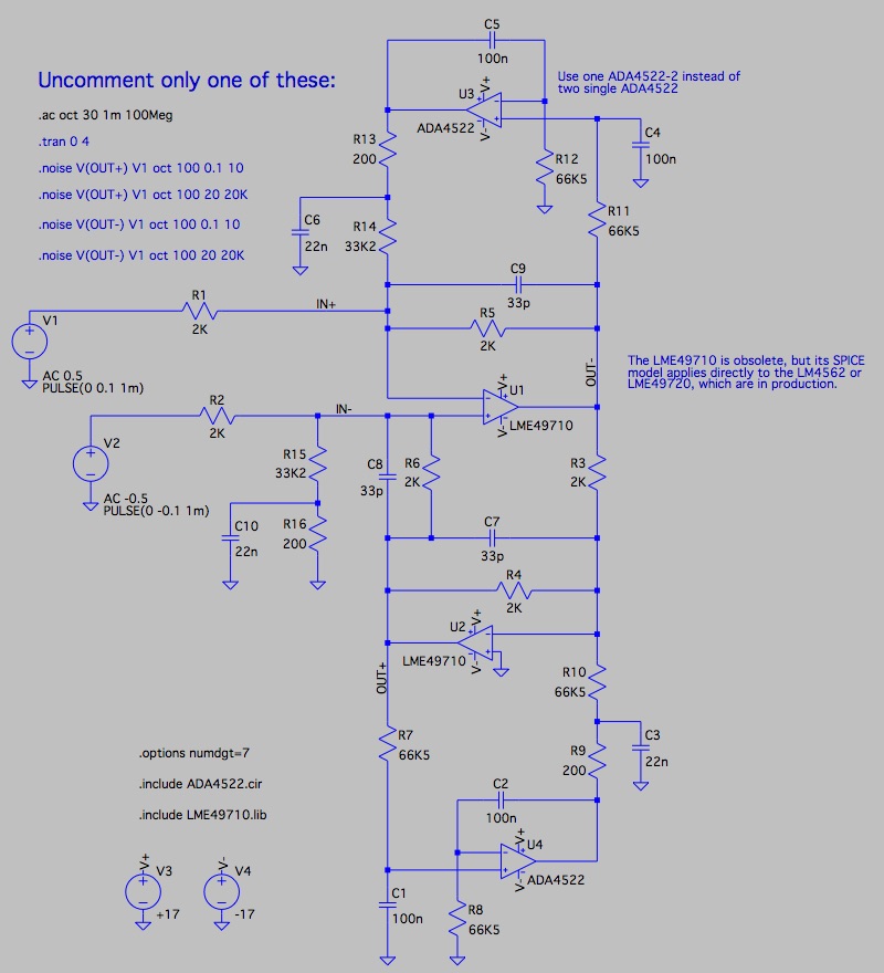

I too dislike coupling caps, and have found that DC servos can be made to work well and provide a 'one stop' offset control solution, at the expense of a lot of extra parts and a good bit of design. They can be made to work well, but there are also a lot of ways to make pretty awful servos. I'm using the lower voltage version of the LME49860 (the LM4562) in a project and I've found that an Analog ADA4522-2 can make a really ideal servo with a total 'end of the day' offset of around 6-10µV, with little added noise or distortion. You have to do some tricks to make sure that the amp won't contribute noise or distortion to the output, or mess up the passband response, but this can all be done. The typical decades old servo designs seen on the 'net using a TL072 or other sloppy BiFET amp as a servo amp won't cut it. And, a trimpot gets adjusted once, and remains there forever, despite temperature, time, and input DC offset - a servo is a far better plan.
............... have found that DC servos can be made to work well and provide a 'one stop' offset control solution, at the expense of a lot of extra parts and a good bit of design. They can be made to work well, but there are also a lot of ways to make pretty awful servos. I'm using the lower voltage version of the LME49860 (the LM4562) in a project and I've found that an Analog ADA4522-2 can make a really ideal servo with a total 'end of the day' offset of around 6-10µV, with little added noise or distortion. You have to do some tricks to make sure that the amp won't contribute noise or distortion to the output, or mess up the passband response, but this can all be done. The typical decades old servo designs seen on the 'net using a TL072 or other sloppy BiFET amp as a servo amp won't cut it. And, a trimpot gets adjusted once, and remains there forever, despite temperature, time, and input DC offset - a servo is a far better plan.
Could you post the DC servo schematic that you use?
Are there any guidance/rules we need to follow to get the same good performance you achieve?
As requested, here’s a servo offset controlled amplifier I’m using. Everything but the models is zipped up in the file public-servo.zip. The servos (U3 and U4) can’t meaningfully be separated from the amps that they control, so you get the entire circuit, which is a balanced Superbal stage (U1 and U2).
The basic Superbal amplifier stage uses U1 as the difference amplifier, along with R1, R2, R5, and R6. U2 is the inverter amplifier along with R3 and R4. C7 and C9 stabilize U1 and U2, and C8 is added to re-balance the HF common mode input impedance at nodes IN+ and IN-.
The DC error at node OUT- is sensed by R11 and sent to U3, a non-inverting integrator with R11 = R12 = 66K5Ω and C4 = C5 = 100nF. This integrator lowpasses the OUT- signal with R11 and C4 before U3 sees the signal, minimizing the potential for HF distortion from U3.
The ADA4522-2 is known as a ‘zero drift’ amplifier, since it uses HF switching inside of the amplifier to cancel its internal DC offset. In doing so, it also eliminates its internal 1/f popcorn noise, which can be a problem in a servo stage using typical FET input amplifiers. The penalty is that the switching action creates small but detectable output switching noise at 200kHz and above.
Using the dual ADA4522-2, this switching noise will be synchronized between U3 and U4, preventing difference tone ‘whistles’ that might actually be audible. To eliminate the rest of any such noise, R13 and C6 form a lowpass filter. This filtered servo drive signal is sent to the Superbal IN+ node via R14, whose value is scaled to define the overall highpass frequency. Again, even though this noise is low magnitude, it varies from chip to chip, and it’s easy to add an RC output filter to practically eliminate that noise at the expense of a few extra passives.
The network of R15, R16 and C10 is added to the IN- node to re-balance the input common mode impedance, which is upset by the U3 servo’s filter and force resistor. Practically, one can replace this network with a single resistor R15 to ground with only a small CMRR degradation, but the ‘correct’ circuit is shown for clarity.
The other half of the circuit is essentially the same, except that the U4 servo force resistor R10 is twice the value of the U3 servo force resistor R14. This is not an error, and this alignment results in an extremely flat differential passband response with essentially no peaks or dips, common to many servo circuits. In a balanced circuit like this, the two Superbal amplifiers can be thought of as in series, so their DC servo stages are also essentially in series, making their frequency responses influence each other. By staggering the time constants and gain factors with this 1x - 2x force resistor scaling, an ideal differential passband response results.
If you use the simulations described below, you’ll find that the V(OUT-) and V(OUT+) are less flat than V(OUT+) - V(OUT-). However, V(OUT+) is about 0.0014dB down at 20Hz and V(OUT+, OUT-) is 0.001dB down at 5.6Hz, both of which are essentially flat, and probably not obtainable with imperfect tolerance real world components. V(OUT-) has a LF peak of around 0.48dB at 1.2Hz, but is only off by 0.004dB at 20Hz, making it suitable as a single ended output if needed.
I’ve included LTspice IV simulations but out of respect to the vendors, you have to provide their models for the op amps. In the actual device, I use the ADA4522-2 and the LM4562, but the models you want are the ADA4522 and the LME49710. For the simulation to work, download them from LICENSE AGREEMENT | Analog Devices and http://www.ti.com/lit/zip/snam001, unpack the .zip file from TI and place LME49710.lib and ADA4522.cir in the same folder as the provided public-servo.asc file.
There are several simulation commands to view the overall frequency response, the time response, and the noise performance of the overall circuit. Uncomment only one of the .ac .tran or .noise files to run the simulation. I’ve also included a file public-noservo.asc file, which is just the Superbal and no servos, so you can see the effect of the servo on the total noise of the circuit.

How stable is it?
