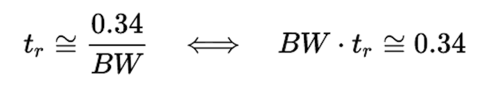

Have some fun: apply the bandwidth-risetime equivalency principle (link to Wikipedia)
attachment.php
to the LTSPICE plots in post #21. Risetime from the transient analysis plot, and bandwidth from the AC analysis plot. This circuit's closed loop gain, in decibels, is
  • Av,cl = 20 * log10(R3/(R1+R2)) = +30.6 dB

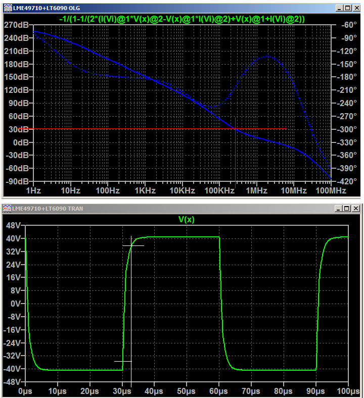

Joined 2011
Have some fun: apply the bandwidth-risetime equivalency principle to the LTSPICE plots in post [#20]. Risetime from the transient analysis plot, and bandwidth from the AC analysis plot.
Bandwidth at the closed loop gain is 250 kHz by eyeball (red intersection)
10% - 90% risetime is 2 usec by eyeball (white abscissa).
BW * RT product is 0.5, pretty close to theoretical prediction (0.34)

it isn't for a noise gain of 2 (inverting -1) but fruther away from that gain it should get better behaved
beware trying to sim, most macro models don't correctly show PS pins affecting compensation when in real 5-pin op amps the Cdom is connected to one of the PS rails
