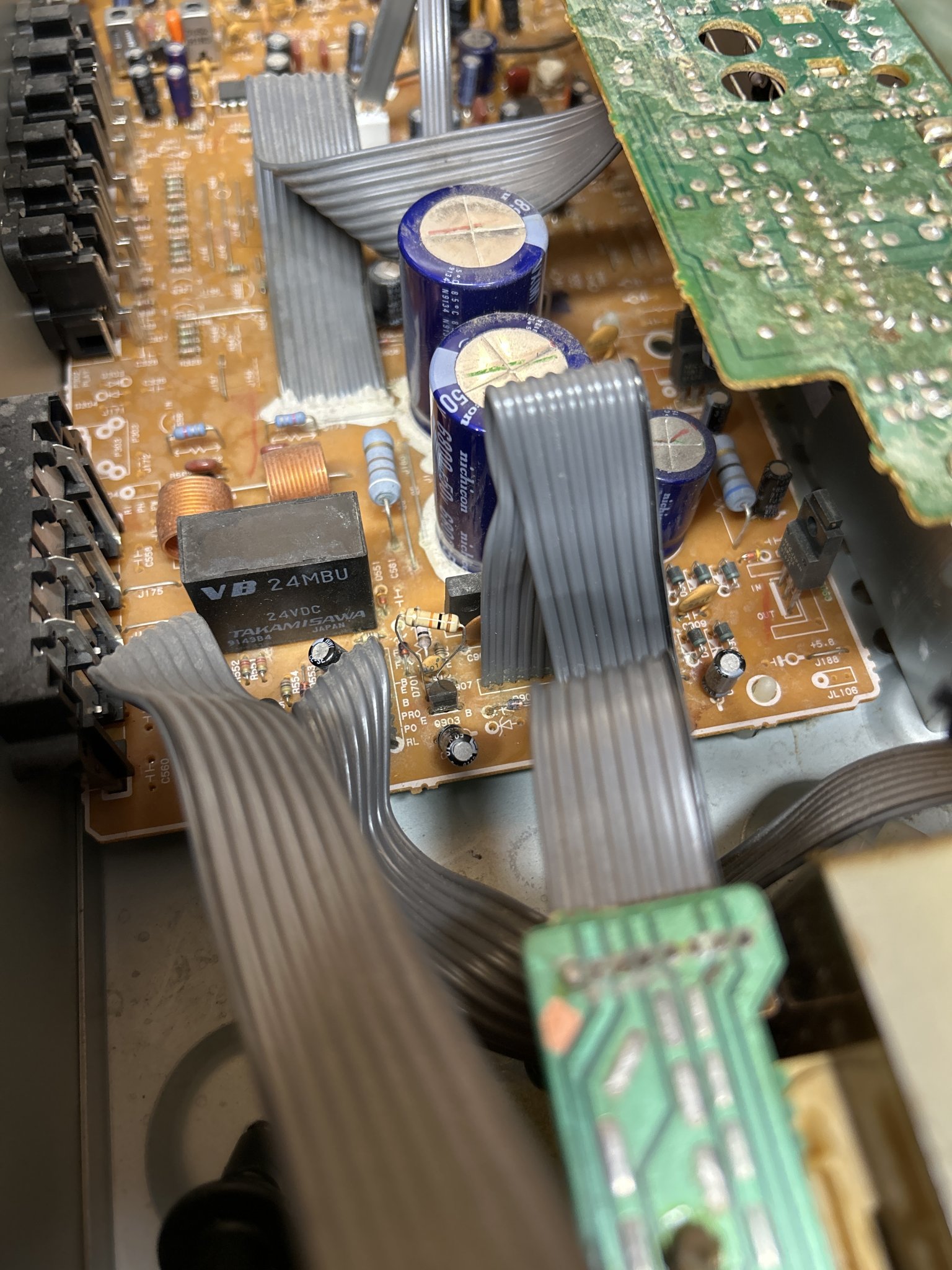

Here's what I just measured:
I have -38.6V on one side or R907, and -1.7V on the other side
On Q903 it's currently reading:
B = -1.75V
E = -1.17V
C = -1.72V
At D909 I have -1.72V on one side, 0 on the other
Shouldn't I have -38.6 V on the base of the transistor if I'm reading the wiring diagram right?

You should have nearly -40V on collector, about -27V on the base (established by zener diode D909), and emitter voltage reduced about 0.6V re the base, i.e. about -26.4V. If there isn't ~-40V at the collector, that might be the sole problem, but there are many possible culprits.
Edit: I'll be more emphatic--- if there isn't almost -40V at the collector (sourced from that 10 Ohm), the circuit can't work. All the other voltages may be byproducts of the missing collector supply voltage.

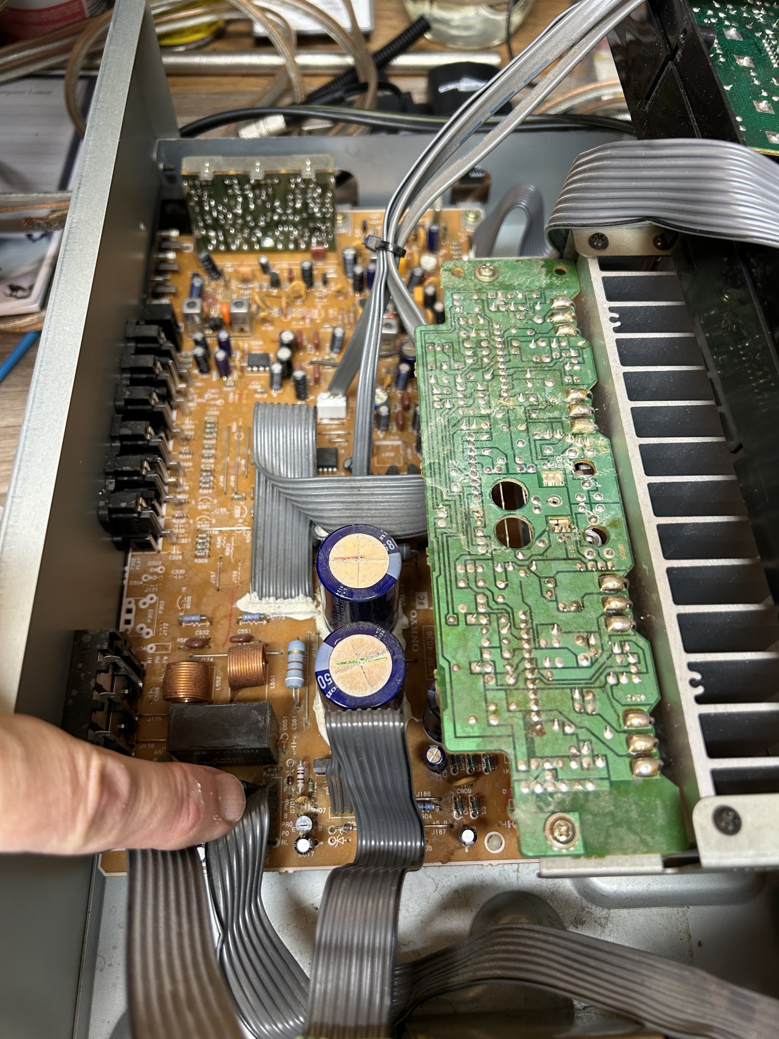

OK my resistor set arrived.
Is there any harm in trying different resistor values across the existing R907 and see if the voltage at the emitter come up closer to 26V?
Or do I need to pull the board and pull that 10k resistor out and replace it?
And if I replace the 10k resistor and it still doesn't work is the Zener diode the next culprit? I guess at this point I could also remove it and test it.
I was going to try to do some math but I have to run out to an appointment and I'm more a "let's try this" vs. calculation kind of engineer. LOL.
In the photo I'm pointing to the circuit we have been diagnosing. It doesn't look too hard to pull that main board up.

Just dab another 10k across the existing resistor. If nothing happens we look further.
If you pull the transistor out the voltage across the Zener should come up to -26 volts. That is the best way to test the Zener.
