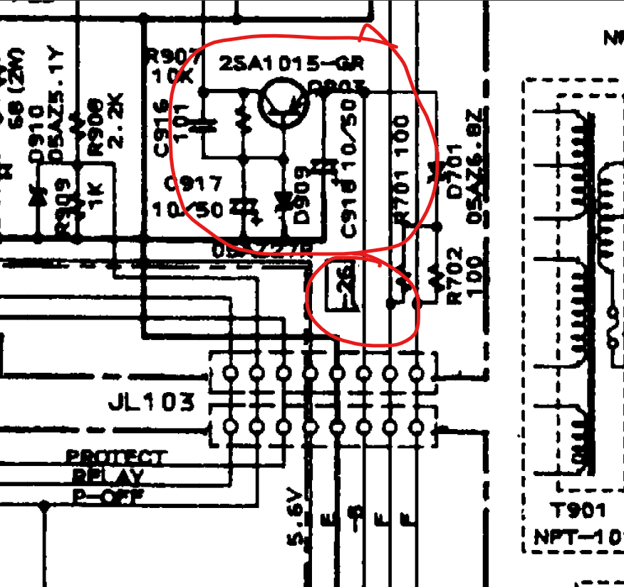

This transistor is the -26 volt regulator for the display. Check this voltage is OK.

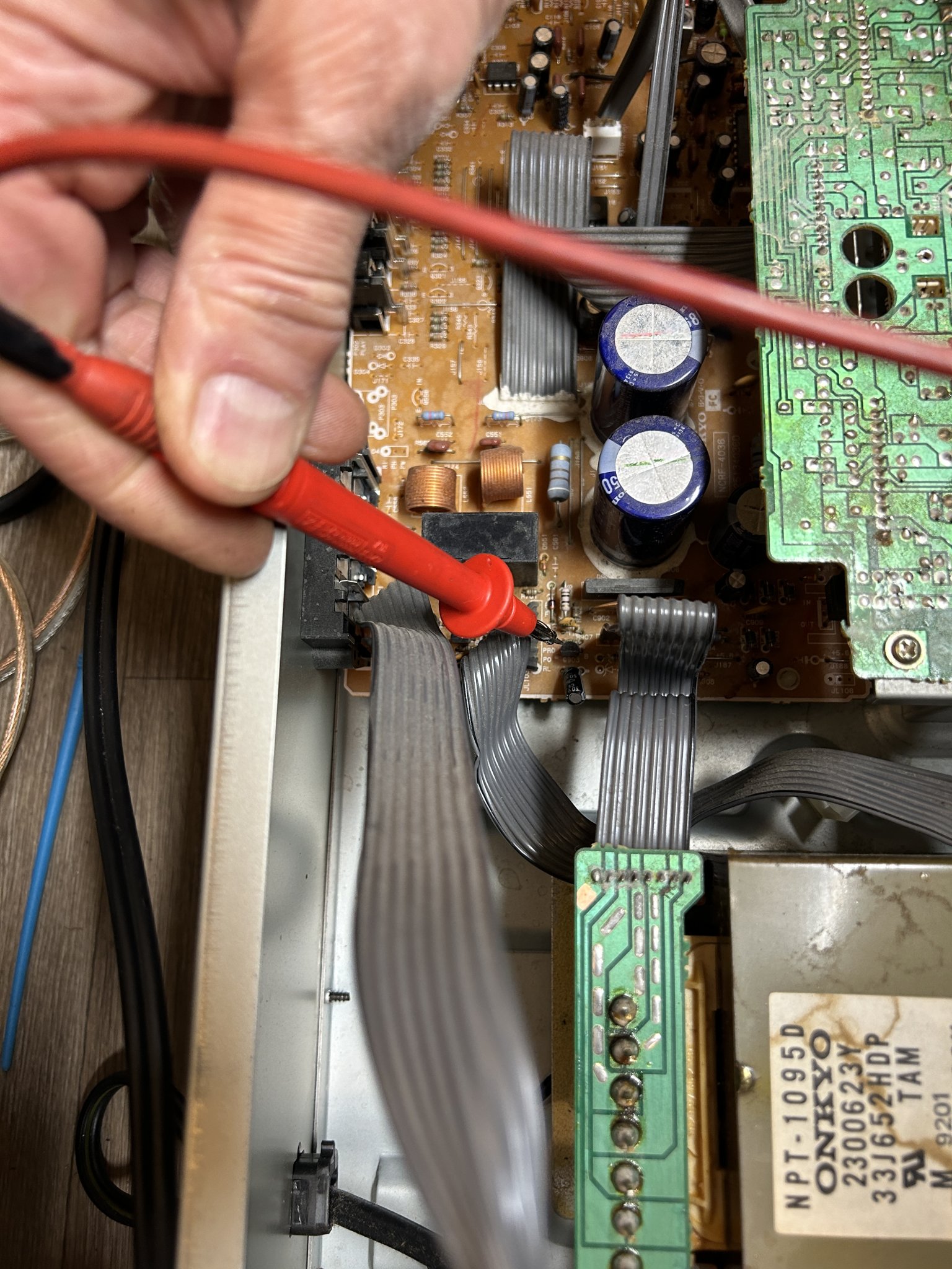

I found the transistor but it’s hard to get to. I need to go get some chores down outside while it’s dry then I will try to measure the voltage there.

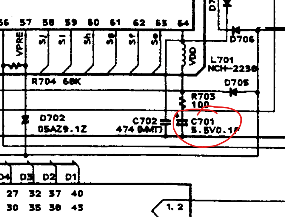

Hugo, the memory cap voltage drops to 3.8V withe power off. Should I remove it and see if anything improves?

Just measure the voltage on the pins of the display. Any of them apart from the end pins. If it is on one it will be on them all. Do you have that -26 volts?I found the transistor but it’s hard to get to.

The 3.8V on the cap is too low and the capacitance is 0.1 Farad, not 0.1µF.
At the moment that is the only component that for sure is not in good shape.
The -26V is on pin 56 of the µP if that helps.

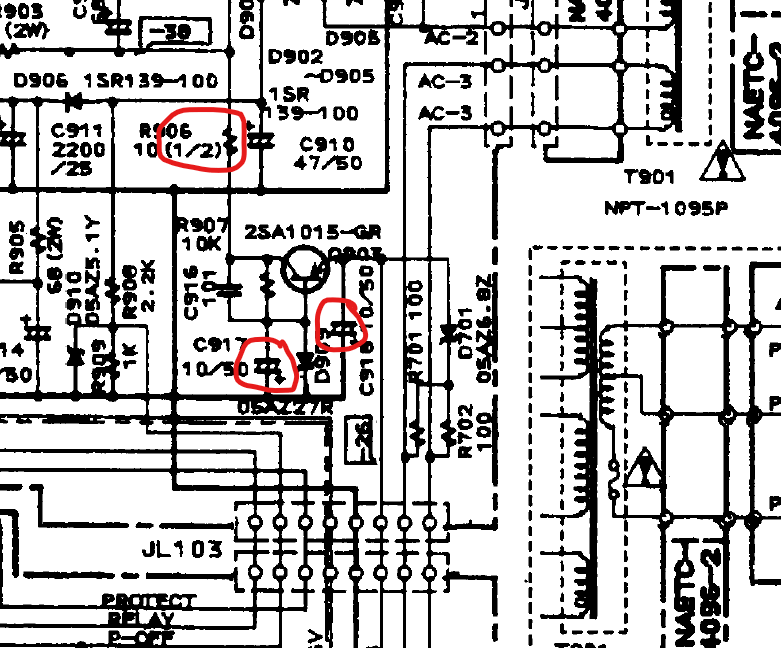

I only measured -2.78V on pin -B (on connector JL103. So I'm thinking that something in the voltage regulator circuit is bad. In one of the videos I saw a capacitor in that circuit had leaked and blown a resistor. When he jumped the resistor with a good one it came back to life.
I measured the resistance across R907 and get about 1.2 kOhm to start, then it slowly increases. Is this due to being in circuit with the other capacitors etc?
I need to pick up some resistors and I can try jumping that resistor and replacing it.

The voltages on the JL103 don't look correct to me. As I read the schematic, B- should be -26V (from emitter of Q203, can't read Q number with confidence) and the filaments should be biased at about -20V via D701, R701, R702--- but of course they won't read that because of incorrect -26V.
I've yet to see anything definitive for processor failure. The 0.1F cap is suspect, but that won't prevent operation. Processor seems to be enabling relay. Switching waveforms on tube pins would be an excellent sign.

I need to buy some resistors. Will 1/4 Watt resistors work? Or 1/2 Watr? or do I need something with a higher rating? R907 is pretty small.
The 10k could be faulty but it wouldn't be a first suspect as it is very lightly stressed 🙂 1/4 watt is fine for that one. You really need to isolate one end of the resistor to check it as in circuit checks on high value resistors is often inaccurate due to interactions with other parts.
Is the 10 ohm, R906 OK? That can be checked in circuit.
If it is open then replace the resistor and also these two caps. The way the caps are located on the diagram looks a bit odd to me but that doesn't matter, if that 10 ohm is duff then replace the caps.
Also if the 10 ohm has failed then its also possible the failure could be also be caused by the transistor becoming leaky and conducting into the Zener diode on the base of the transistor.
I measured R906 and it was right at 10 ohms.
What does the (1/2) signify after it? 1/2 watt? Or is that 1 of 2?
Given that I got a reading on R907 should I start by replacing the two caps in that circuit? And measure R907 once the caps are out?
That's good then. The 1/2 is half watt.
Next up then is to do as BSST suggests and measure the voltage on the transistor. The 10 ohm being OK means you should have -40 volts or so on the collector (middle pin). It might be safer to measure the voltage on the Zener diode for the base volts as one slip with the meter probe would cause damage.
Not at this point... lets see where the voltage trail leads.Given that I got a reading on R907 should I start by replacing the two caps in that circuit?
It is good to find a fault by measurement rather than just changing parts but ultimately I'm probably going to say that unless the fault is 'just' the 10k having gone high (which it might well be) and which would be a genuine 'one off' fault then I would replace the caps and if the transistor or Zener proved faulty then I would do a blanket change of the caps and both the transistor and diode as well.
First lets try and find the fault and then analyse what might have happened to cause it.
Awesome guys thanks! Let me see if I can get in there and safely measure the voltages without pulling the board loose
