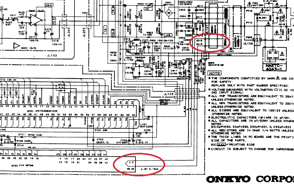

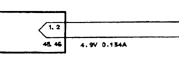

Ian,
I assume you have the service manual?
Measure AC voltage between pins 1,2 and 45,46 of the display. Should be 4.9VAC
Alternatively you should see the same voltage at the power transformer pins marked AC3.
There are no resistors involved.
Hugo

I have the same manual.
Does this help?
The display is actually a tube and the 4.9V is supplied to the filament.
Hugo

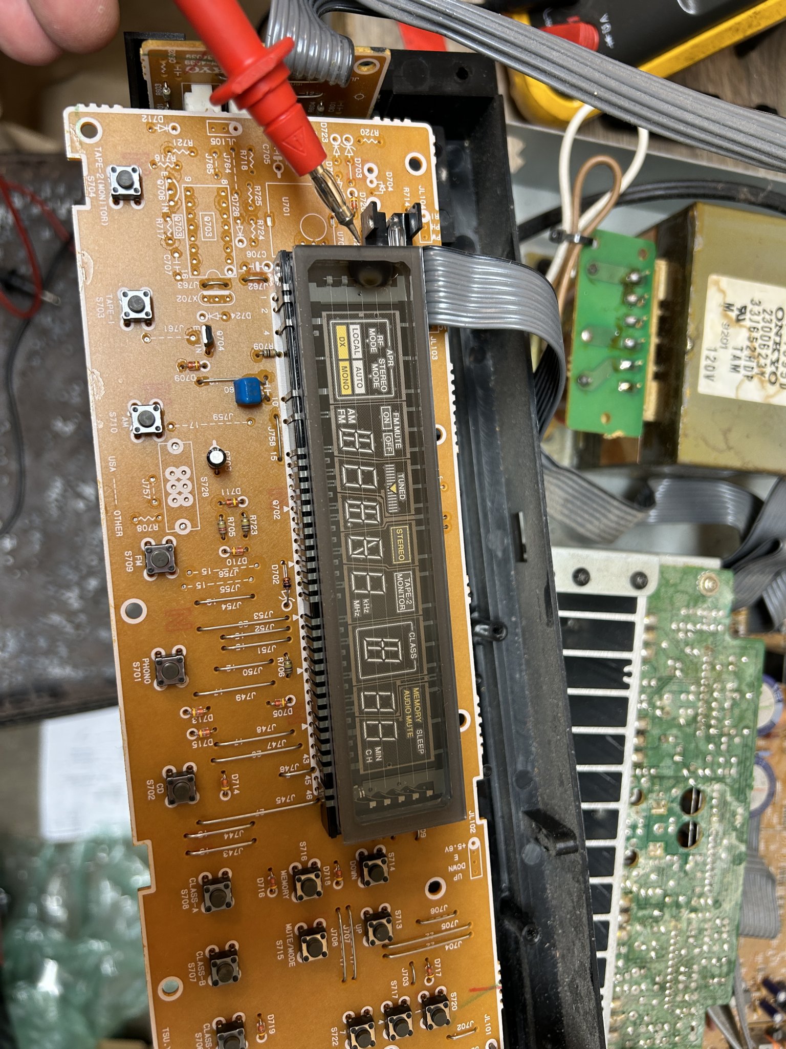

OK I got the display board off and was able to measure the voltage across 1/2 to 45/46 and it's zero.
There is also this spot of the display which has me worried. That looks like a spot that blew to me, but I'm far from an expert.
Is the display shorted and dead?

I think the spot is normal. What do you measure at the transformer pins AC-3?

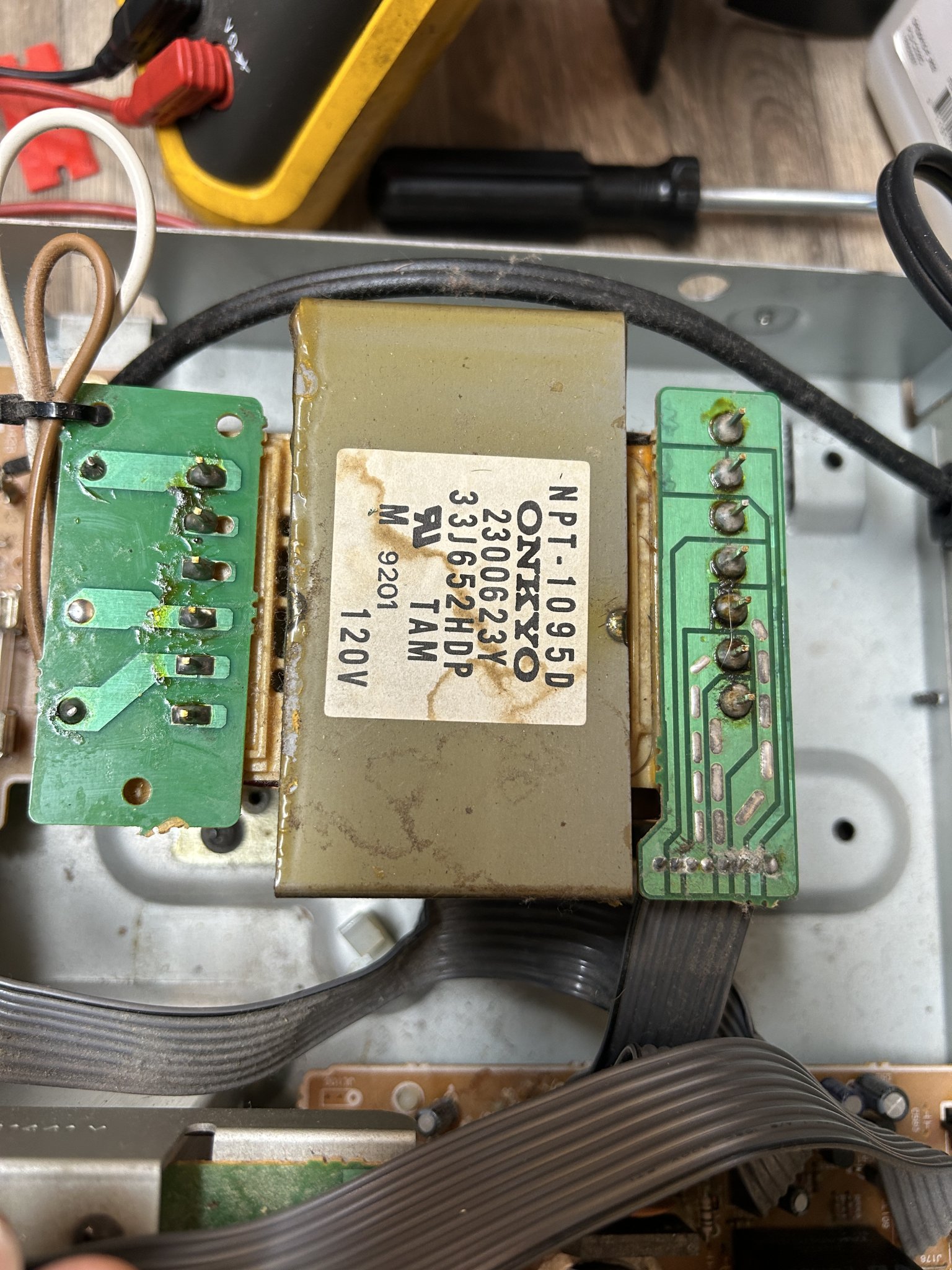

It's hard to tell from the picture but these look like bad solderings:

That side of the transformer is most likely the primary.
The other side will have the 4.9V, or better, should have.
Hugo
Hugo
I have 123.7V AC at those two pins.
And I was switching my DMM to DC on the other side. I have been playing with car stereos recently. Oops.
So if I measure AC Volts I get 4.99 V across 1/2 45/46 and 5.04V across the top 2 pins on the transformer, which I assume is AC-3.

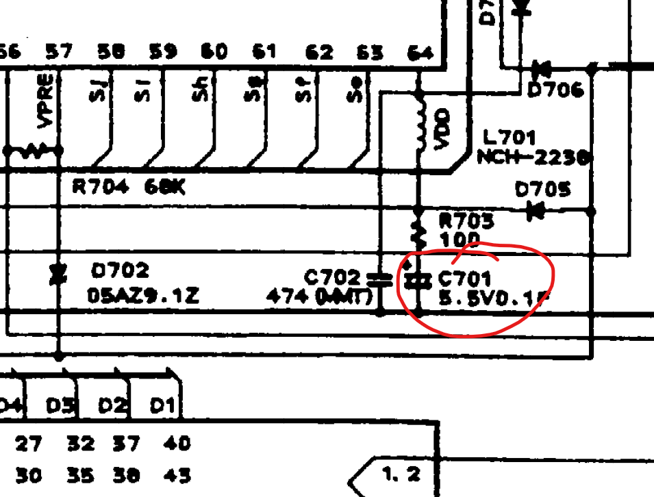

Well, either the display or the microprocessor is toasted I guess. That's page 14 and 15 of the manual.
You could measure if there is +5V DC between ground (pin 32) and pin 64 of the microprocessor.
Hugo
Hugo

I remember an Akai video recorder with no display and we needed to change a small cap on the +5V.
In your case that would be C701 just underneath pin 64 on the schematic. (5.5V 0.1µF)
A 10 or 20V cap would be fine as long as it's 0.1µF.
Hugo
Hugo

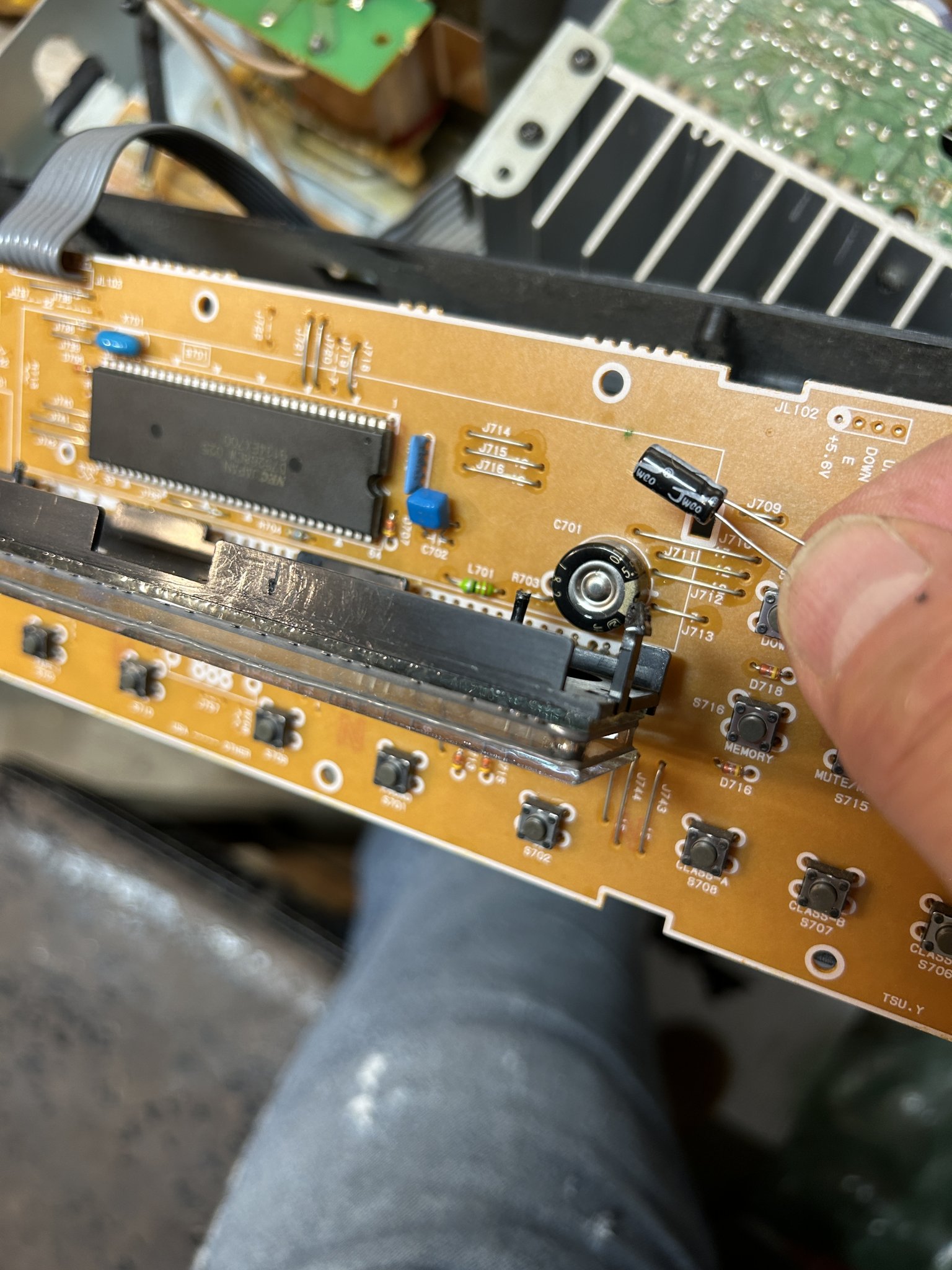

I had to pop the display loose to get to it.
I also see the capacitor under the display. It doesn’t look bad but I will remove it and test it.
I have a 50V 0.1 microfarad capacitor. Will it work? It looks like a different kind or at least a different form factor.

The rest of the receiver seems to be working but I don’t see any signs of life on the display. I just measured and I do have 5V across it.
The 123V is the line in voltage from the power cord and at the transformer.
The filaments of the display are the end pins at each end of the display. Pins 1 and 2 are electrically the same as are pins 45 and 46. The filament voltage is measured between pin1/2 and pins 45/46
In the dark you might just make out the filaments glowing a very dull red and the display should feel slightly warm after a few minutes.

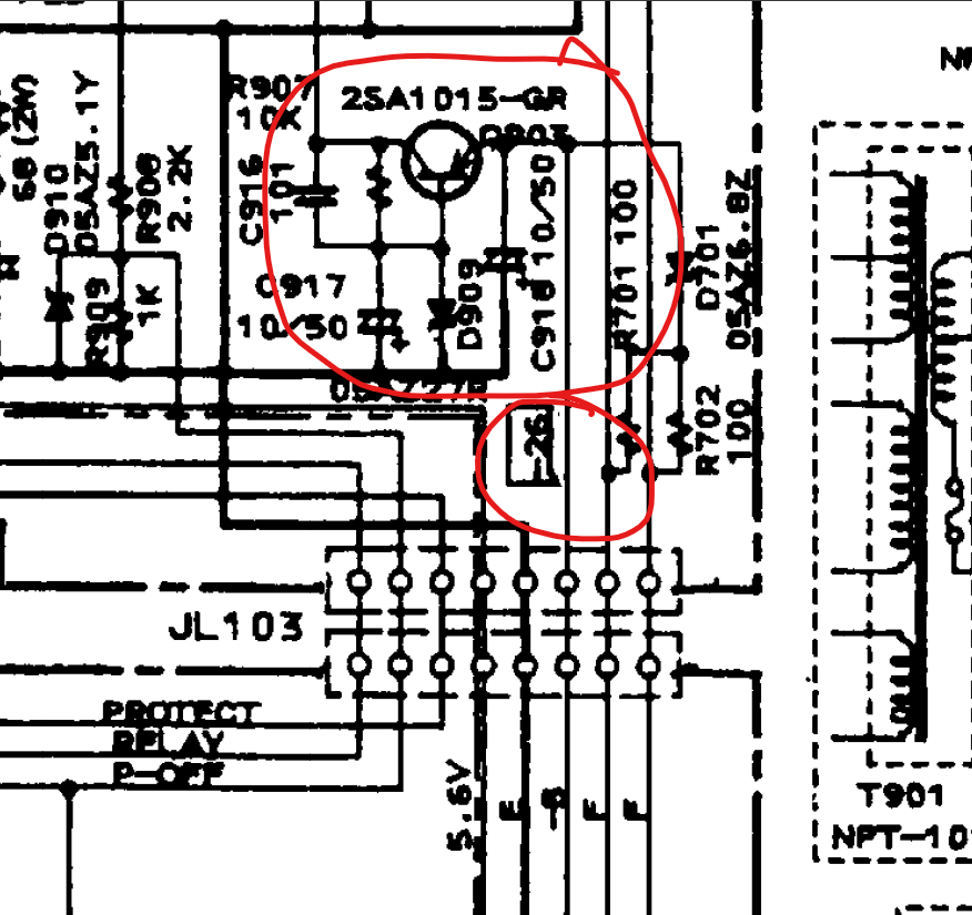

All the other pins should have a negative voltage on them, perhaps as much as -25 volts. If you get a resistor (say 4k7) and connect one end to ground and brush the other end over all the pins of the display (apart from the filaments) then different segments should illuminate really brightly. If that happens the display is OK.
If you suspect the uP is faulty then try removing the backup cap and leave it all for an hour or two with no power applied, then with the cap still removed apply power and see it the fault has changed.
This transistor is the -26 volt regulator for the display. Check this voltage is OK.
The backup cap.
The backup cap.
Oh yes, that's a totally different thing. It's a memory cap and you can't replace it with the cap you have.I have a 50V 0.1 microfarad capacitor. Will it work? It looks like a different kind or at least a different form factor.
With mains power off, you could measure if it still holds 5.5V.
Not 100% sure but that most likely won't be the display's problem.
It is there to keep the processor powered with 5V when the receiver is off.
Hugo
