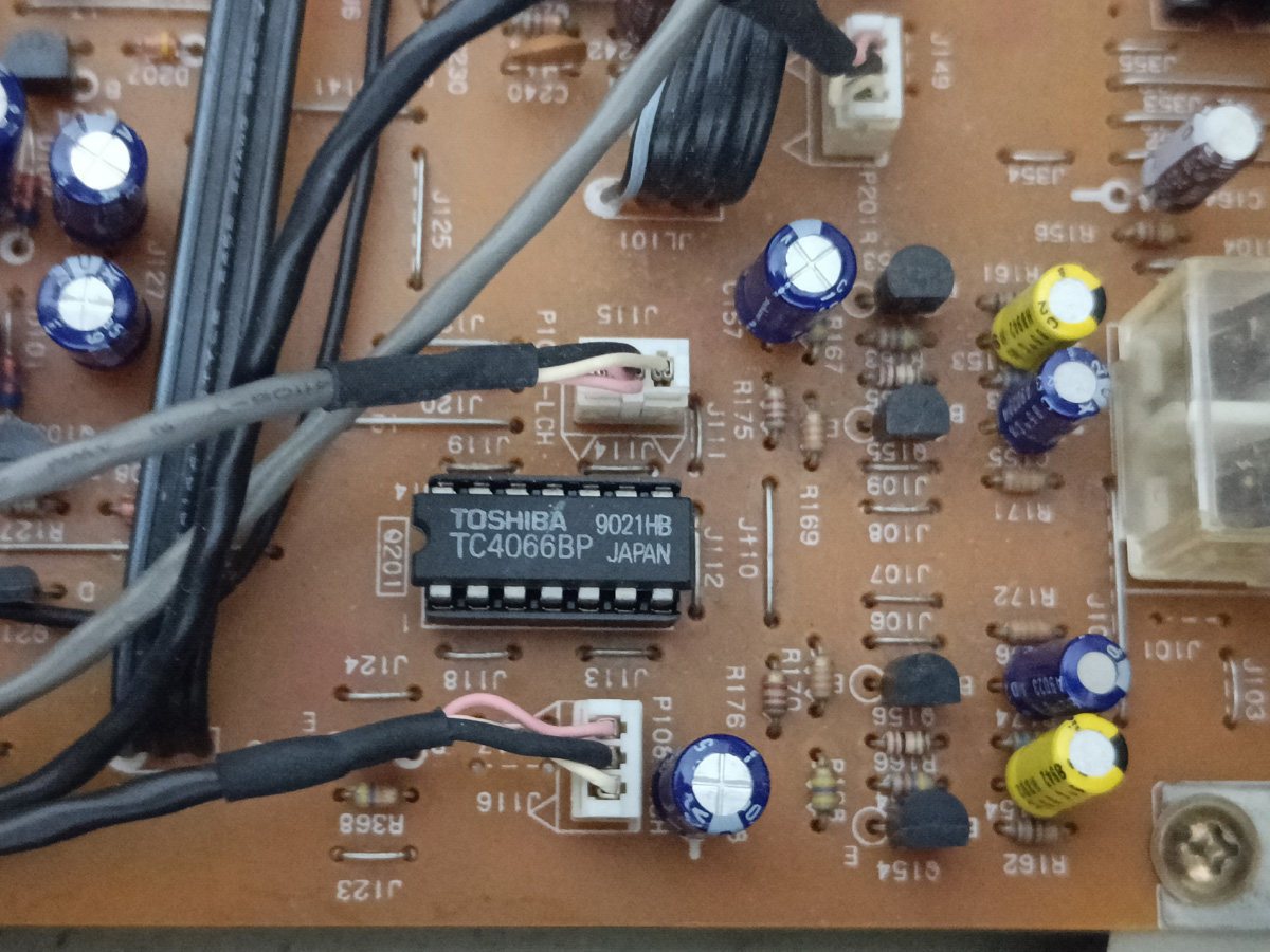

The Maxim MAX4066 quad-switch CMOS IC survived three years of abuse in the Onkyo. 17V absolute max spec chip and had 16.75V across it (Q201 in post#1's schematic). Yesterday something pulled two DC power lines down (+5V -12V) blanking the display and cutting off sound output. I removed and measured the 7805 and 7912 regulators (still good). Then I suspected the CMOS switch because I knew I was running it precariously. It was in a socket so I quickly replaced it with a Toshiba TC4066BP 20V absolute max, 0.03% THD chip. Everything came back to normal.
Lesson is don't run a MAX4066 on more than 16V DC between pins 7 & 14 for real long term reliability. 15V is even safer.

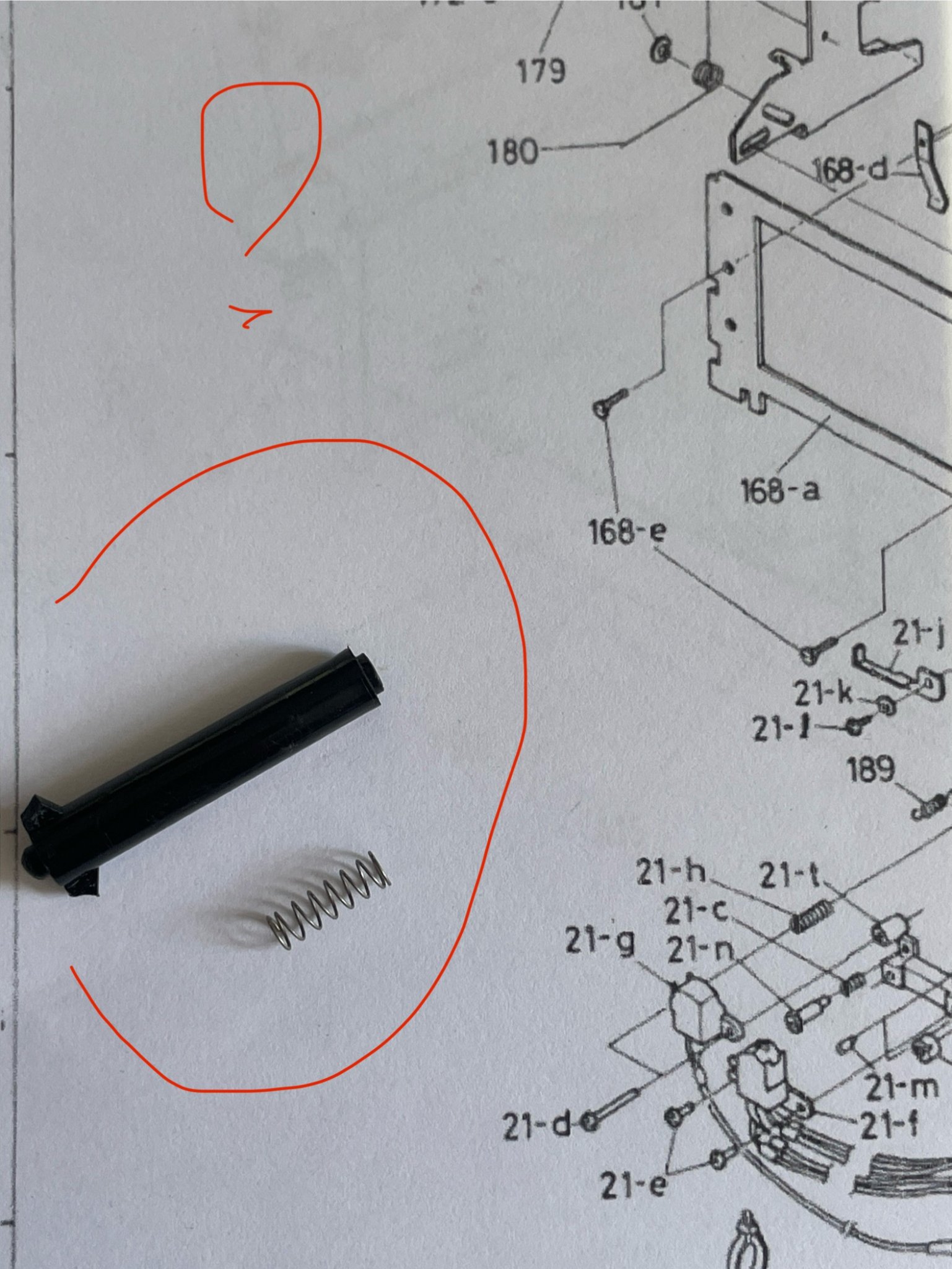

Hi, long shot maybe ... but I just finished repairing my TA-2600. Replaced the 2 belts. As of my usual habit .. I have 2 spare parts left over 😎... They must be from somewhere around/on the tape desk mechanism. I consulted the exploded views but can't seem to locate them. Anyone has an idea ? Btw .. The deck is working perfectly without them !
That's a nice 3-head Onkyo deck you got. Don't know what to think about the mysterious leftover parts. I hope the spring doesn't belong to a head's mounting screw.

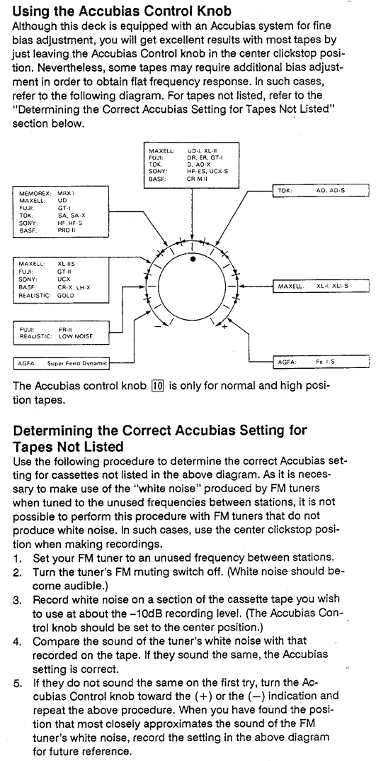

Your TA-2600 is family to my TA-2570 (TA-2800) but simpler i.e. no test oscillator but no CMOS switch chip either, lower output level but less associated circuitry (volume pot, wires, op-amp etc.). Sometimes simpler is better sound-wise. Possibly having bit lower spec heads also, not sure. This is the bias knob tapes map from its instruction manual.

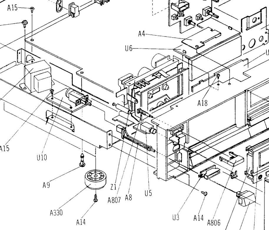

It seems to be the shaft of the eject botton, A807, in the picture.

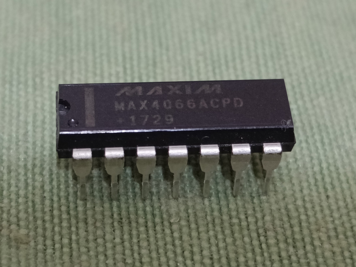

Q201 TC4066BP CMOS switch replaced with MAXIM MAX4066A

That one is present and working .. So it must be still something else but something that doesn't seem to prevent the unit from working !
Maybe but doubtful .. I have a history of "extra" parts after I repair something. The plastic thing probably is an extra support for the frame with the motors. Just can't find it's location in the exploded view. The spring ? No clue ! Everyting works just fine ... and again, can't locate a spring like that in the exploded view.
If it was a PCB snap in support, those are usually white on the other hand... Anyway... keep the mysterious parts in case they ever become clarified. Afterall how do you like the deck? Does it replay and record well?
