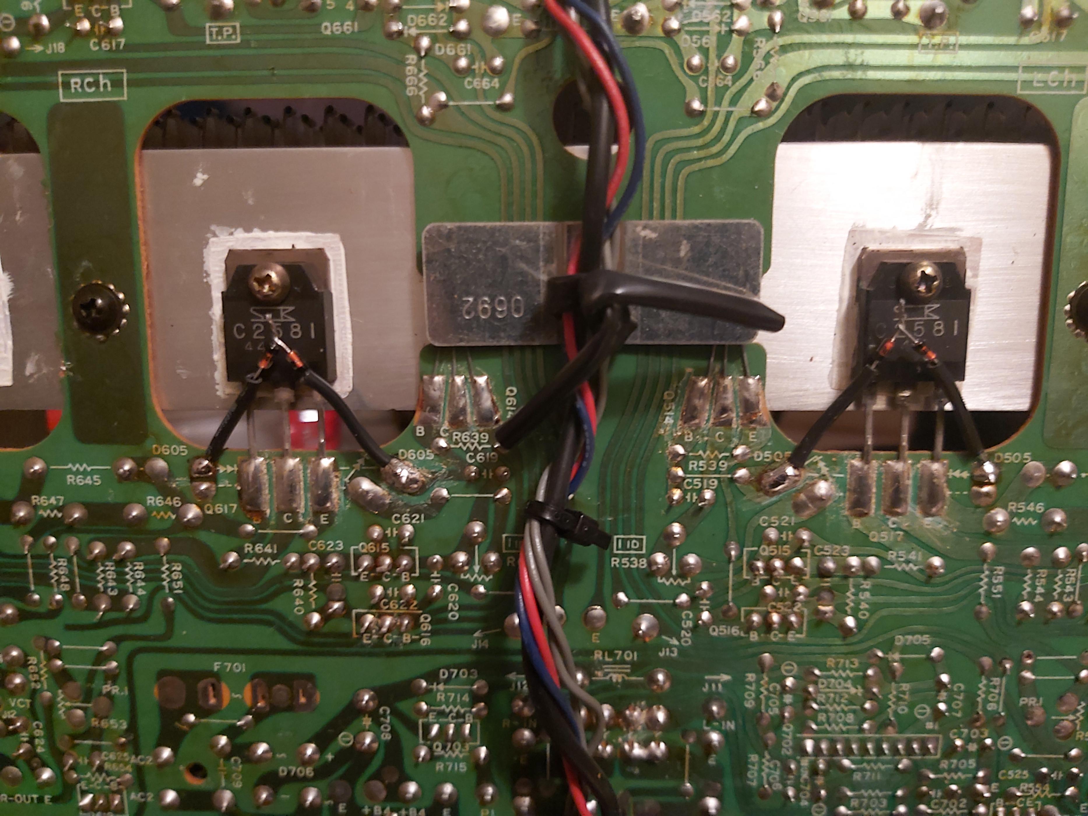

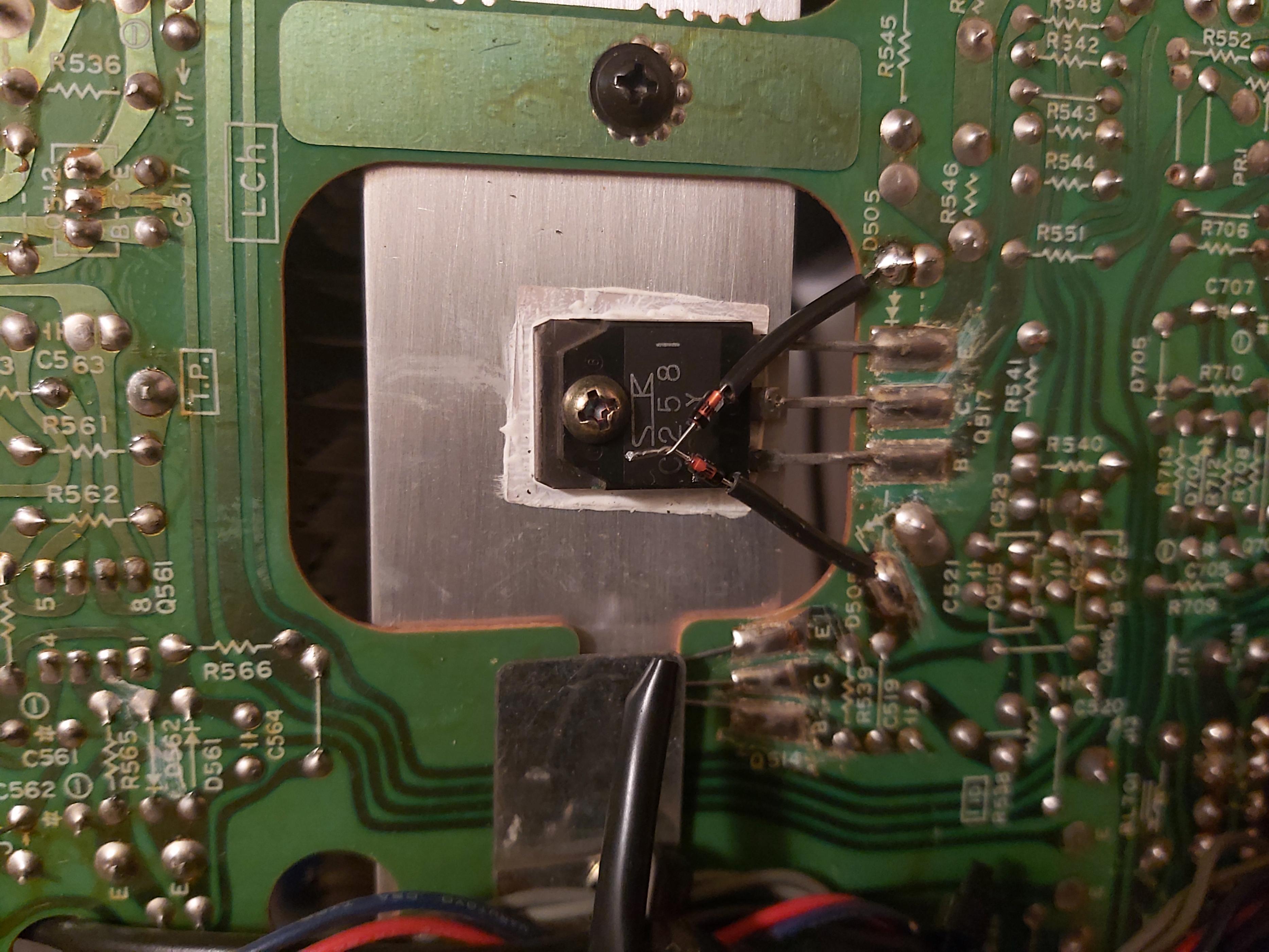

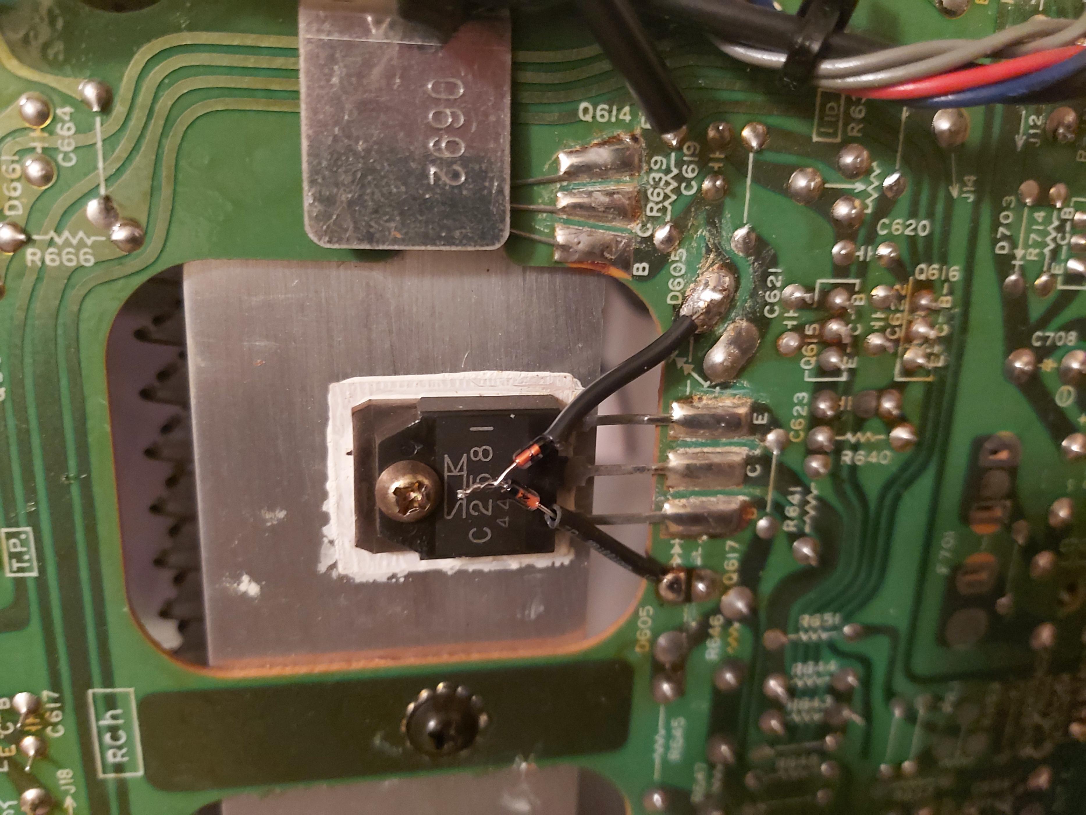

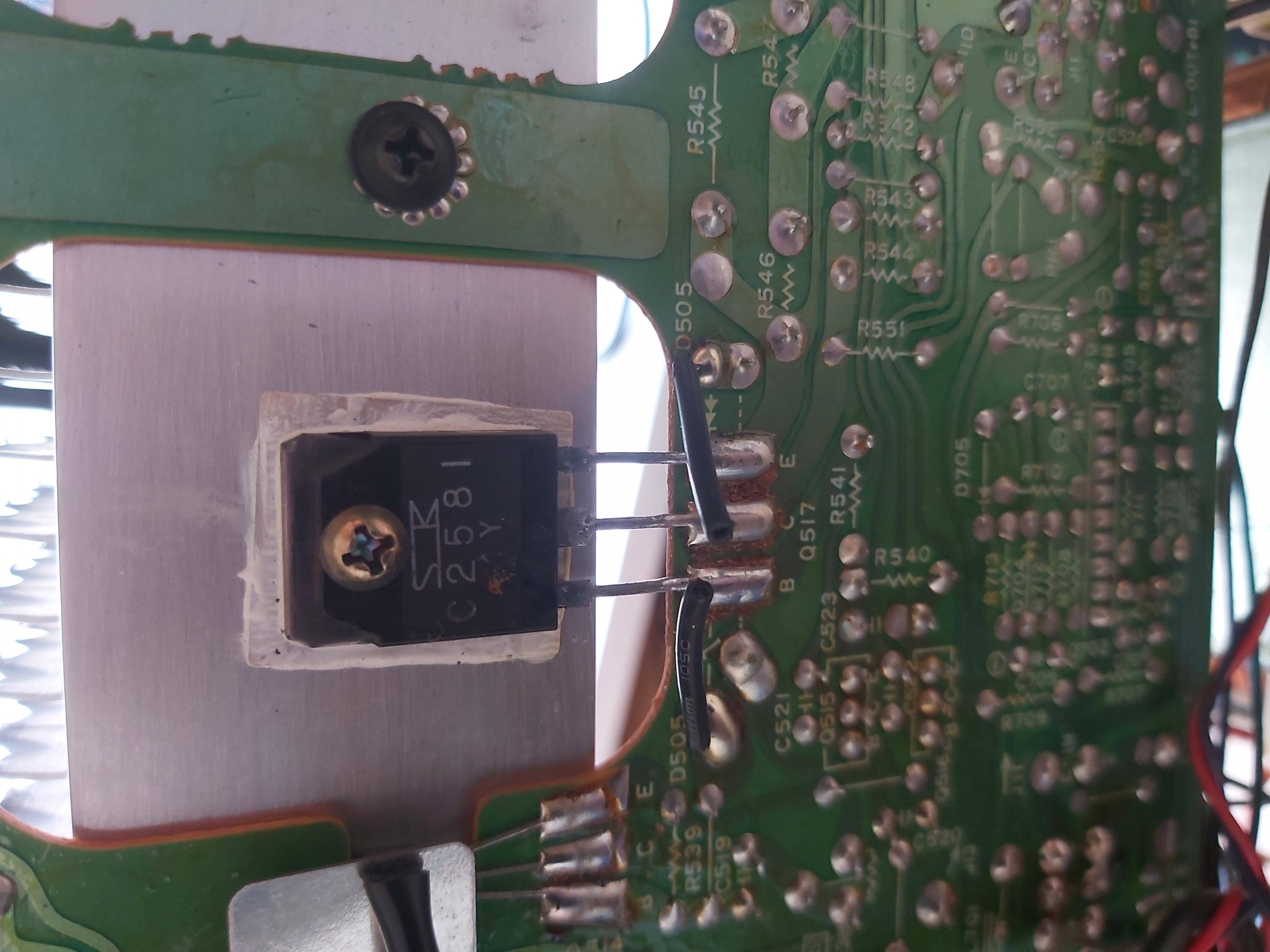

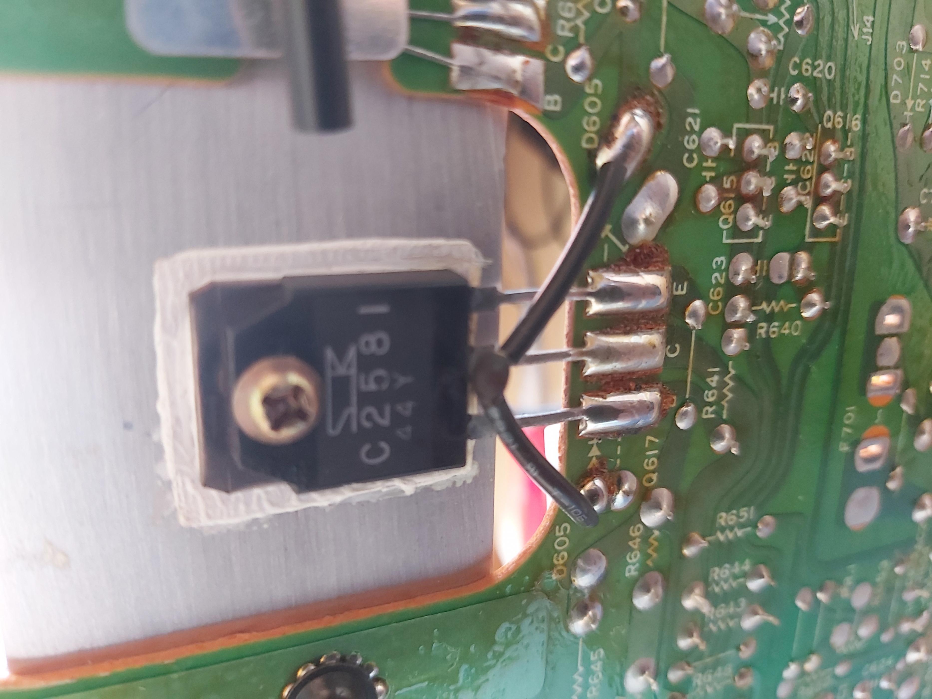

hi everybody!
I have discovered that a diode, D505 in the schematic has been burned. an other one, D605 isn't in good shape also. This will probably cause the problem, for they are situated nearby the power amp section. the only issue is, that they are type VD1222. I have heard they can be repalced by two type 1N4148 who you have to solder in series, according to this atricle:

That seems reasonable, they are rated as between 1.24 and 1.34 forwards voltage at 1.5mA with -3.6mV/C tempco. They are to stabilize the bias as they are thermally coupled to the output devices.
You will need to re-adjust the bias after installing the replacements.

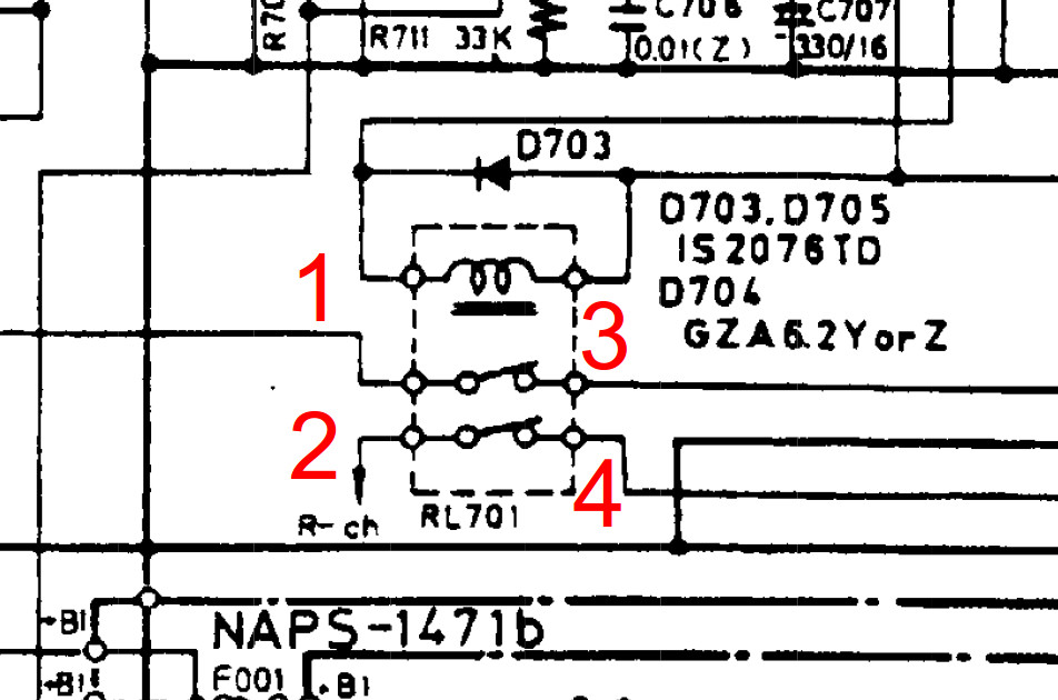

When I press the power switch, the amplifier switches on. All lights and stuff working. only the speaker relay does not switch on, you don't hear the click that switches on your speakers....
That sounds like the amplifier may have a fault such as high DC offset on one of the channels and the protection circuit is therefore deliberately not connecting the speakers in order to protect them.
Just measure the DC voltage on the speaker feed to the 'input' side of the relay contacts. It should be near zero for both channels.
I'm not sure between what points exactly I have to measure.
Can you tell me between which points where exactly to measure?
Between point 1 and ground and point 2 and ground also?
See picture of service manual..
All four points should have zero volts DC but assuming that the input side is at the left then that simplifies to points 1 and 2.

between point 1 and ground (left channel) measured 0V
between point 2 and ground (right channel) measured 10V negative!
So the problem should be in the right channel.....but where???
Experience says probably an output problem... you will have to get measuring. If any low value 'emitter resistors' have failed open circuit then its possible the driver stages (which may also have failed in response) might be creating this negative 10 volts. Other possibilities could be a local supply within that channel that is missing, something like a Zener derived bias voltage.
