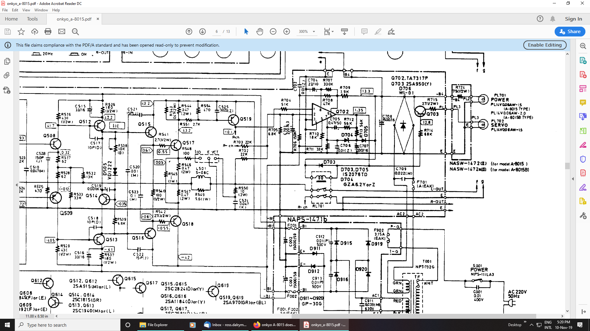

Have a look at the schematic, there are test points with voltages. This should show you in two minutes in which stage the fault is located. Be sure to have the amp set as the manual describes at the end of page 4! Otherwise the voltages may not be correct. Measure the voltages at the test points and report. Onkyo has easy to follow layouts.

Turbowatch2, thanks! I've found the voltages in the schematic and the testpoints also.
seems I completely overlooked it. Now I can go ahead and measure some. I assume LOAD open means with no speakers connected.

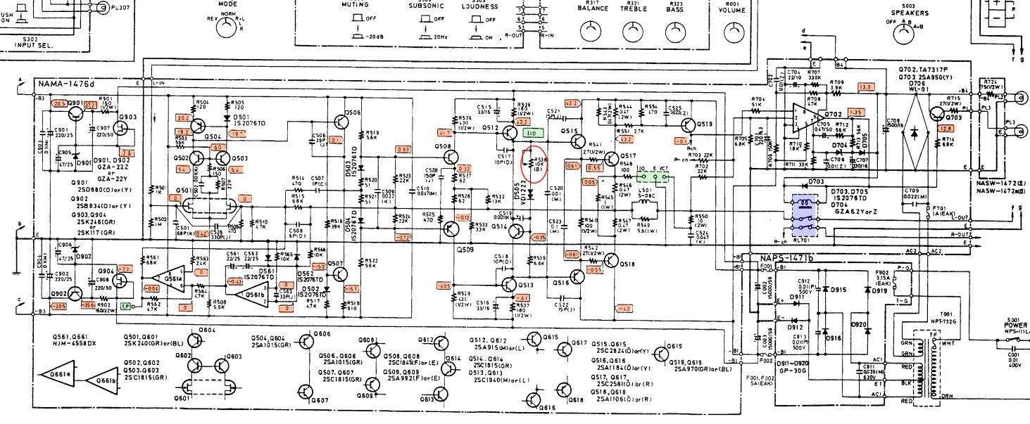

I have made it more clearly in the schematic. Think I'll print it out tomorrow.

Something I missed earlier and that is that there is a third 0.47 ohm feeding the supply to the collector of the upper NPN output transistor.
Be sure to check that there is +42 volts on each end of this resistor.
Turbowatch2, I've measured both points, for L and R channel as explained on page 4 of the manual.
R channel could be set to 12V, but L channel is and stays 0V, whatever I do with the varistor.

The left channel stays at 'zero' volts because the normal voltage and adjustment range is so tiny... it is MILLIVOLTS, not volts.
If you have disturbed the good channel setting then you MUST reset that correctly or risk having that channel fail as well.
Being able to set the right channel to '12 volts' has confirmed that the 0.47 ohm resistors are open circuit assuming you really have got 12 volts across those test points.
Page 4 of the manual says to set the value to 12 millivolts -/+5 mv.
