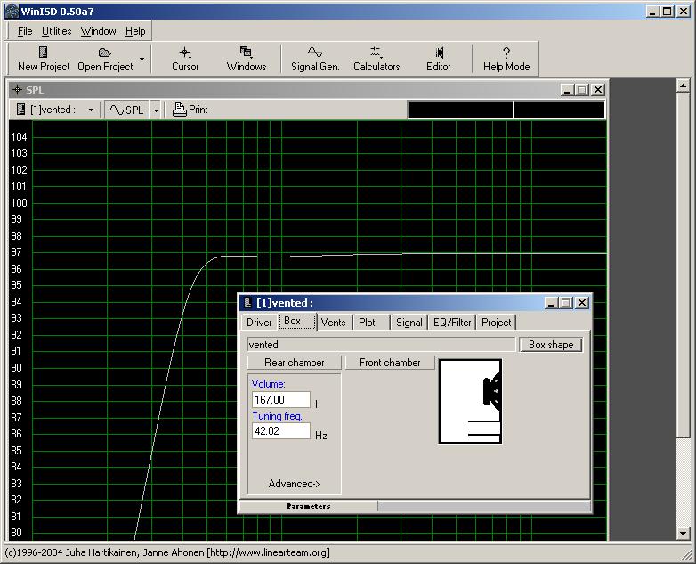

I'm trying to calculate an onken box for a Celestion FTR15-3070C
http://professional.celestion.com/pro/products/pdf/FTR15-3070C.pdf
using ONKEN_CALC.XLS
With regards to Svent and Sd, the best I can get is Svent 40% less then Sd. One of the condition for an Onken design is that Svent should not be less the 15% of Sd.
What would be the consequence of ignoring that point and allowing the Svent to be 40% less then Sd. What the sound would be?
Would a vented box more a better choice? (eg 167litres Fb 42 Q=6.93
I'll appreciate any comment from anyone.

This is probably a clear indication that the Onken box design is not a good match for the driver in question. Post the values you used in the Onken calc so that we can see what assumptions you made - if they are reasonable ones then you should probably consider another box design for this driver. My suspicion from a quick glance at the specs is that qts is a little on the high side, and there may be other issues I did not see. (Do you have the drivers or are these just a potential choice?)
The cone mass (Mms/d) seems on the high side for the Onken. Also your Rg seems unrealistically low unless you direct drive the woofer and have no inductor in the X-O. A more realistic value would be on the order of 0.5 - 1 ohm. Clearly you planned on using this Onken box with a solid state amplifier, because if you were using a tube amplifier you would have to add its output source impedance (could be several ohms or more with an SE amp) to that of the wiring and X-O components DCR. In my Onken Rg is slightly over 3 ohms which has a substantial effect on qts. (Deliberately I might add)
The lower Vas seems to be a stumbling block for more modern divers. The original 416A had a Vas of over 1000L, the 416-8A about 700L. They seem to be the best dirvier for the big Onken box.
That said, I've heard the petit onken (12" driver) and the mini Onken (10" Focal) and the Fonken (small Fostex) and they all sounded pretty darn good.
Maybe just reduce box volume to suite Vas? Tune ports to taste?

I think I'll give up with the Onken and I will design a Reflex box. It looks like is the safest way to go.
By the way I saw a project where an Onken design is still considered valid as published with Svent 40% less then Sd.
IMO I don't think we can call it Onken and I doubt it can be a good one.
Any thought?
