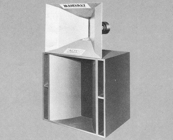

Onken / Altec 817
It is interesting given the history of asian interest in older design of speaker / pa cabinents....which came first, the onken or the Altec 817...? They seem to be related...
http://www.altecpro.com/pdfs/vintage/SpeakerAndMics/cabinets/817A LF Speaker Cabinet.pdf
http://www.altecpro.com/pdfs/vintage/SpeakerAndMics/cabinets/817 LF Speaker Cabinet Plan.pdf

AFAIK, the Onken dates from '73 and the 817 was originally a Stanley Screamer cab that came along shortly afterward and added to the Altec line around '77, though not sure if Altec designed it or not. Regardless, they were offshoots of the 'early '50s Jensen Ultraflex cabs which in turn were just a variation of Thuras's original BR patent cab. I have a pic of an early '50s Altec duplex cab with Ultraflex vents, so plagiarism among the manufacturers was a live and well back then.
An interesting footnote is that in Thuras's BR patent he states that Sd = Av was used strictly to simplify his electrical equivalent ckt. equations, but somewhere along the line it became 'gospel' as the ideal.
