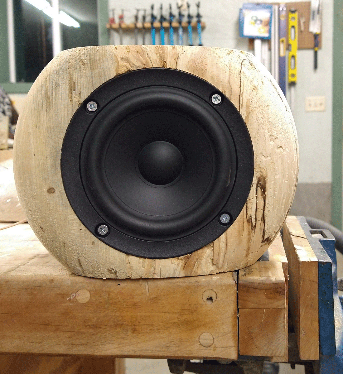

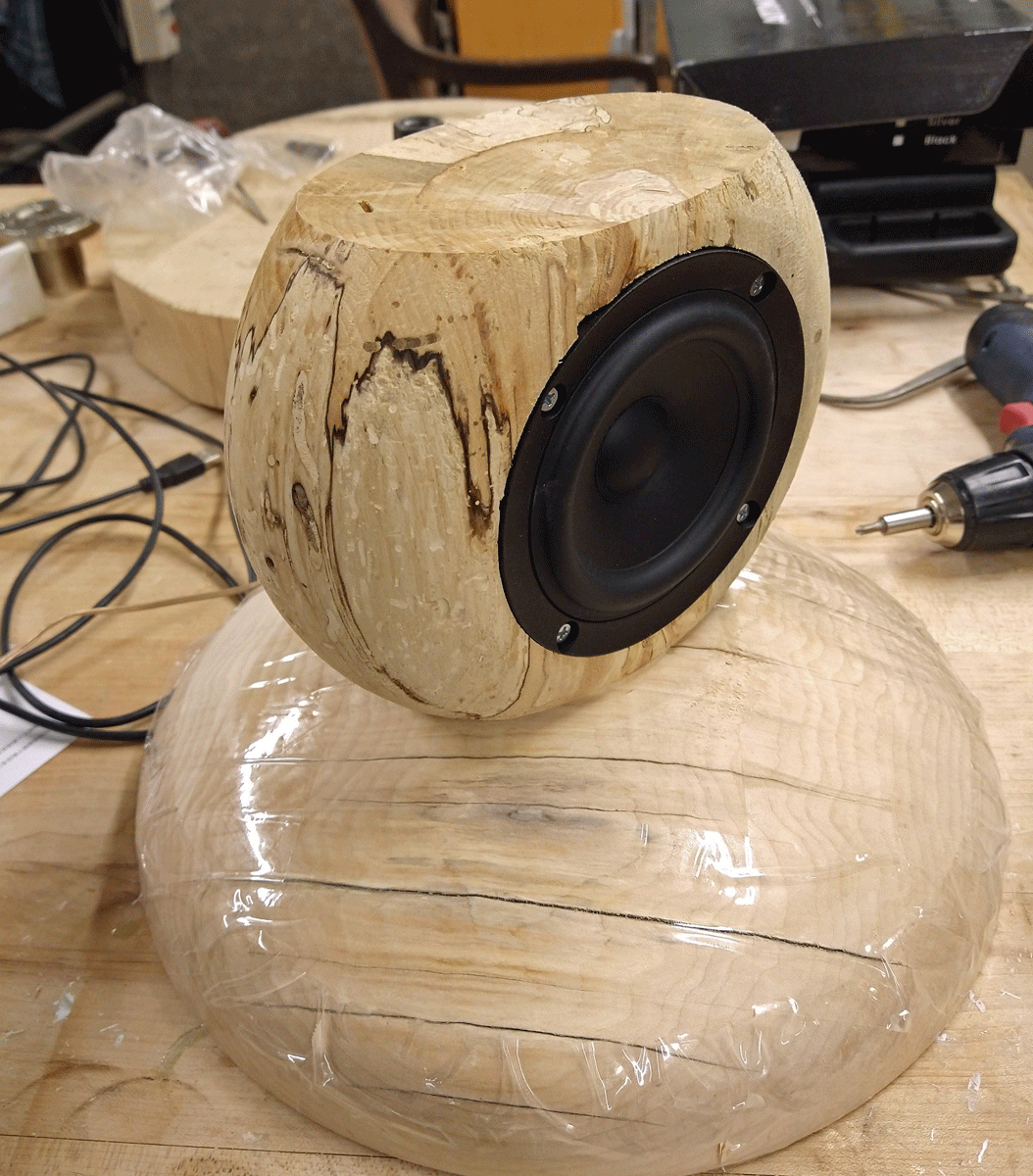

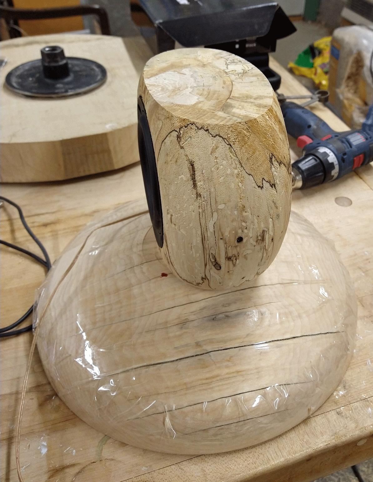

I'm happy I took these sb12 out to listen to them instead of throwing them in a drawer with the rest. This is the largest driver I've liked full range, the sd is just about double the scan 10f, but the back is not open enough for a dipole of my liking. I'm thinking I'll use them in a small sealed system with 8" woofers, likely 2 in parallel to keep the spl up there with the sb12, which is another great thing about this driver that I can easily hear. I'm going to turn the baffle for the sb12 on my lathe, so I can make niiiice big roundovers. I want to make a toroid and a sphere to measure, so I'll probably build two systems at once.

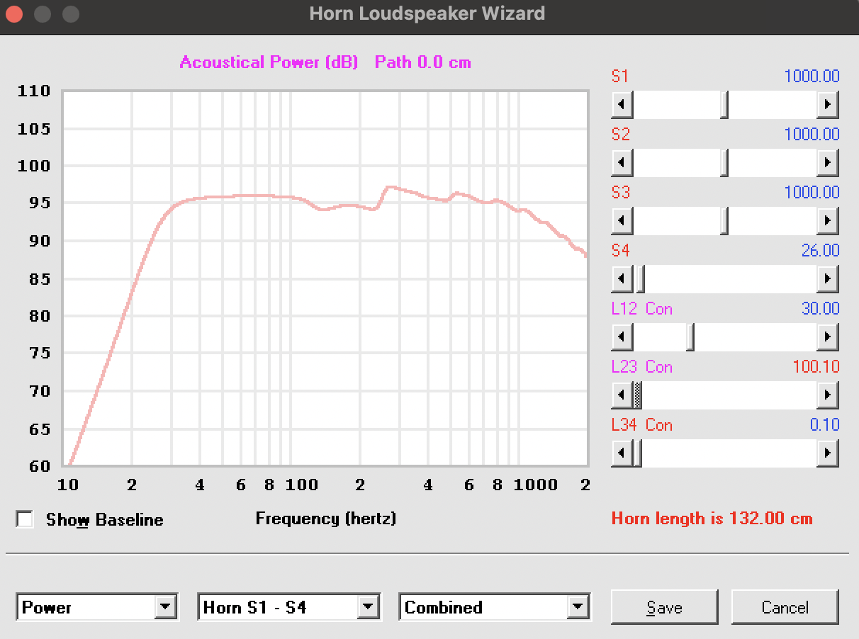

Hmm... I am a beginner but I have read the Tabac thread a few times and it seems that it prefers drivers with a QTS of about .5. I think that it was said that it gives you a shallower roll-ff. The SB12 has a posted QTS of .27. Should this be a concern?
As a general rule of thumbs... yes.
But as with everything audio, there is always more to it, and in doubt (or I should say "always") use a sim app to see how it turns out.
I have done so on page 1, post #12, and that's why I think it looks mighty good in that design.
The SB12MNRX2-25-4 OHM I have is the newer round version and has a Qts of .32
How much does the air mass load of a tabac type enclosure raise the Qts? A peaky bottom end must be an intentional design element that helps to extend the bass response.

It's the weekend and I don't have much time, but I plugged in the "rue of thumbs" numbers for a driver like that (1000cm2, 145cm line, a hole in the baffle as a vent). It's not stellar, but I didn't have time to play around. Right now, I see a 10dB hump between 40 and 100Hz, which would not be great, unless you are a bass head.
Unfortunately, you'd run out of XMax at 50Hz, so not good.
Give me a couple of days and I'll see what I can do.

Perceval, I dont mean to derail this thread but I have a pair of Tang Band W8-2145 that need a home. Could you do a sim, please? I realize that it would be quite large and I may have to fold it. Thanks.

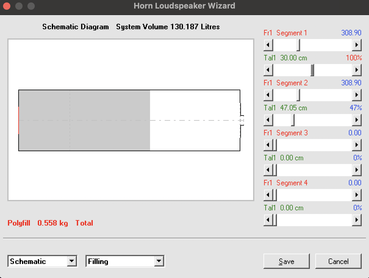

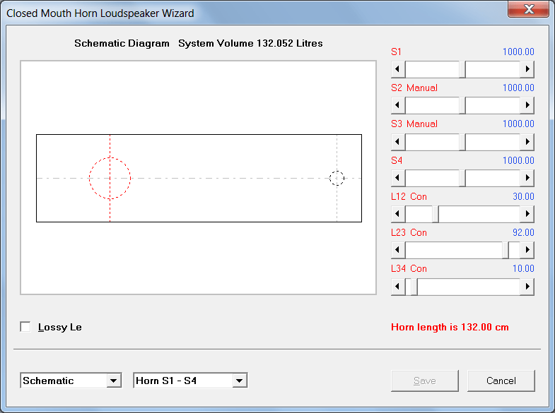

Take 2!
It was a rainy afternoon it kind of threw out our plans.
And never mind the first post... I had some wrong figures imported into HornResp.
So... a 1000cm2 cross section, line is 132 cm long, driver placed at 30cm from top, vent at the bottom being a 26cm2 hole in the baffle. Filling as shown. Looks good to me!
