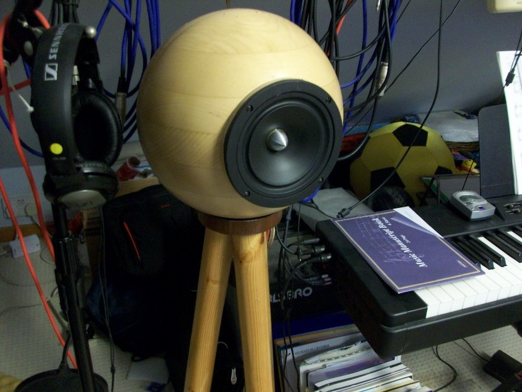

it reminded me of these I made many years ago with the tangband w5-1612
the baffle I took from Harry Olson's book, and it really does make a difference.
