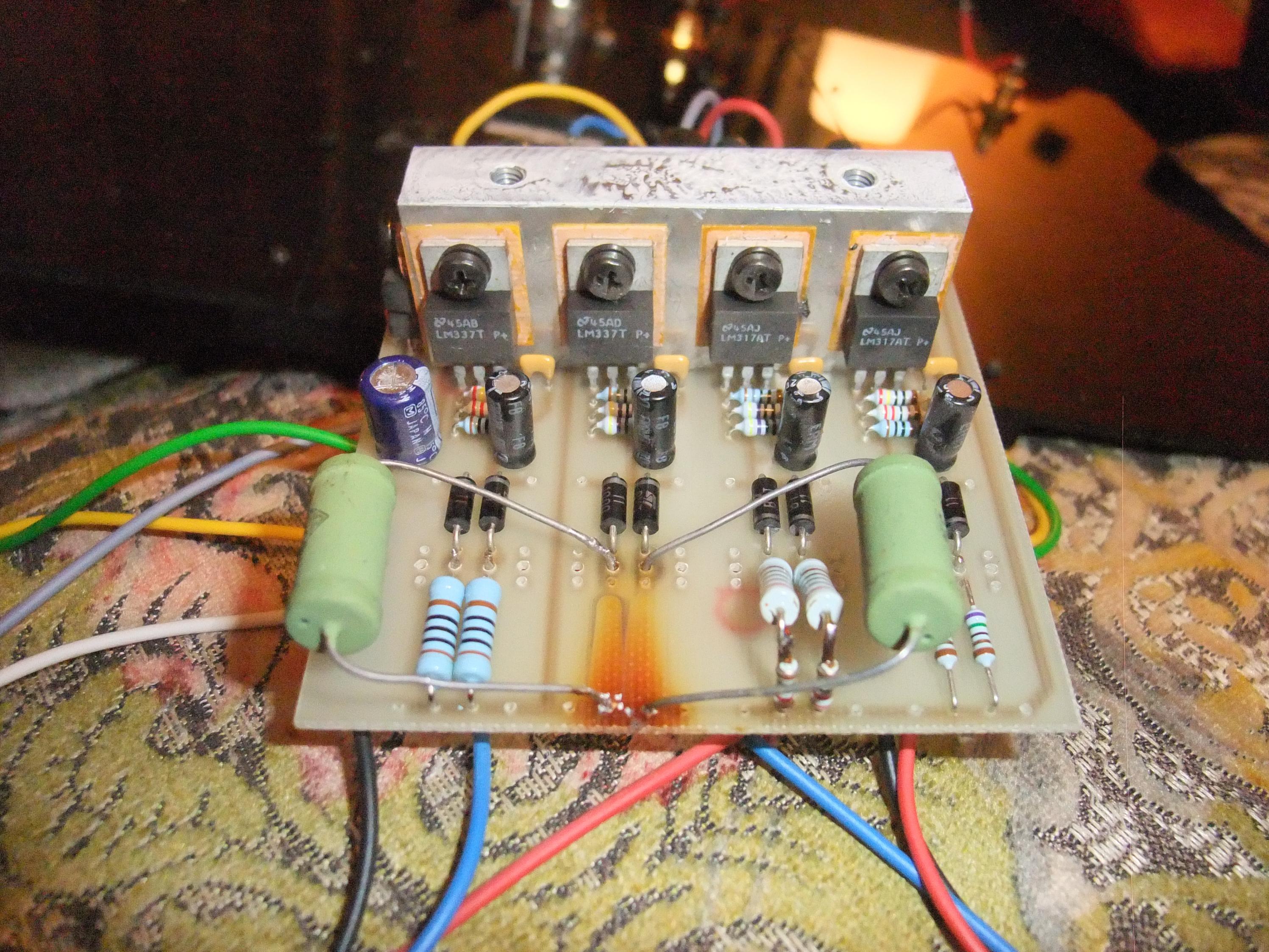

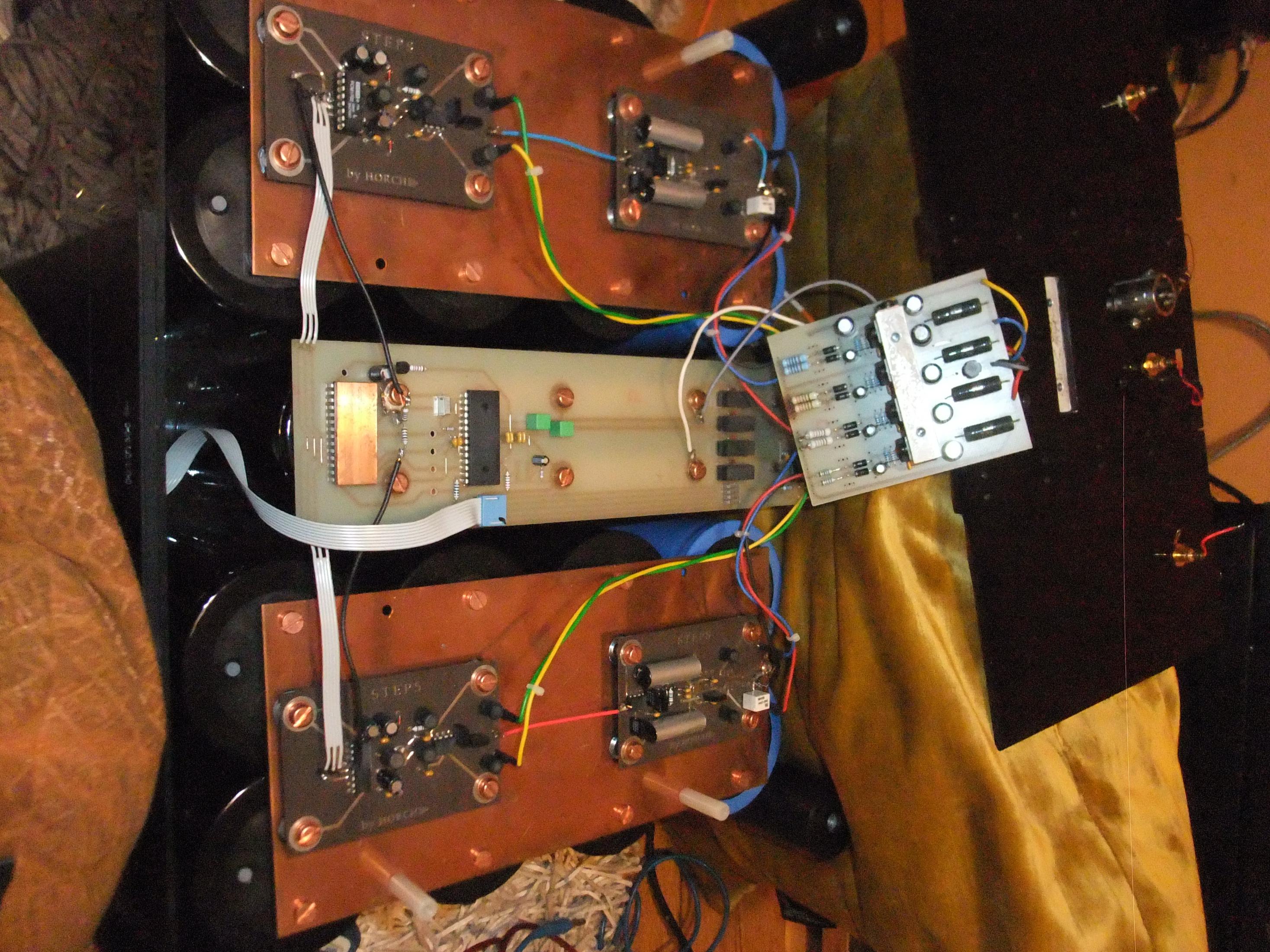

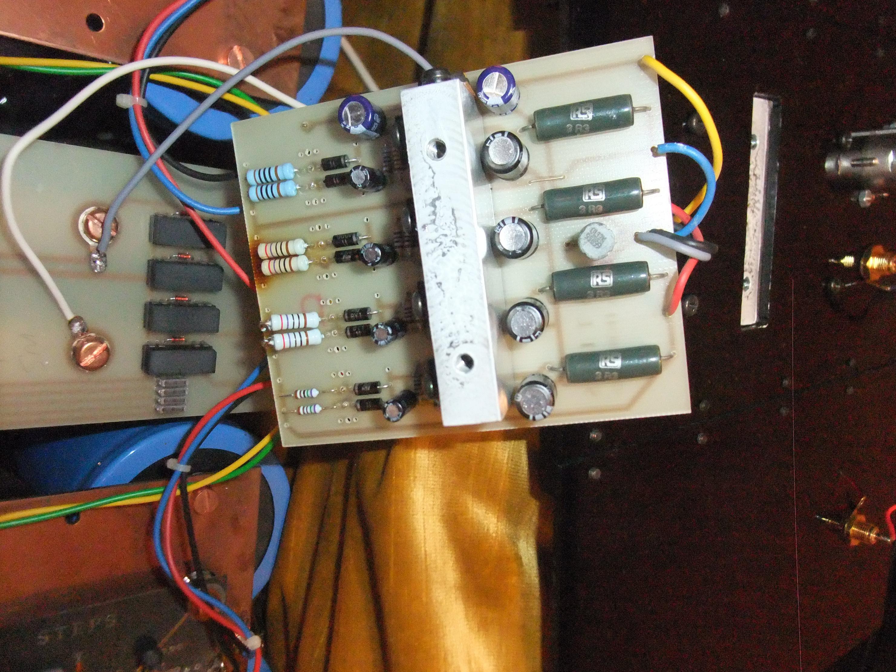

I have never seen before this approach of voltage regulation - it confuses me. Basically, there are two series regulators connected in series. The second series regulator generating a stabilized voltage that is below the desired values - go to the attached circuit diagram.
The desired values are obtained by connecting resistors of a certain value in parallel to the second voltage regulator, which are adjusted to the individual power consumption both of the DAC and high pass filter/buffer modules.

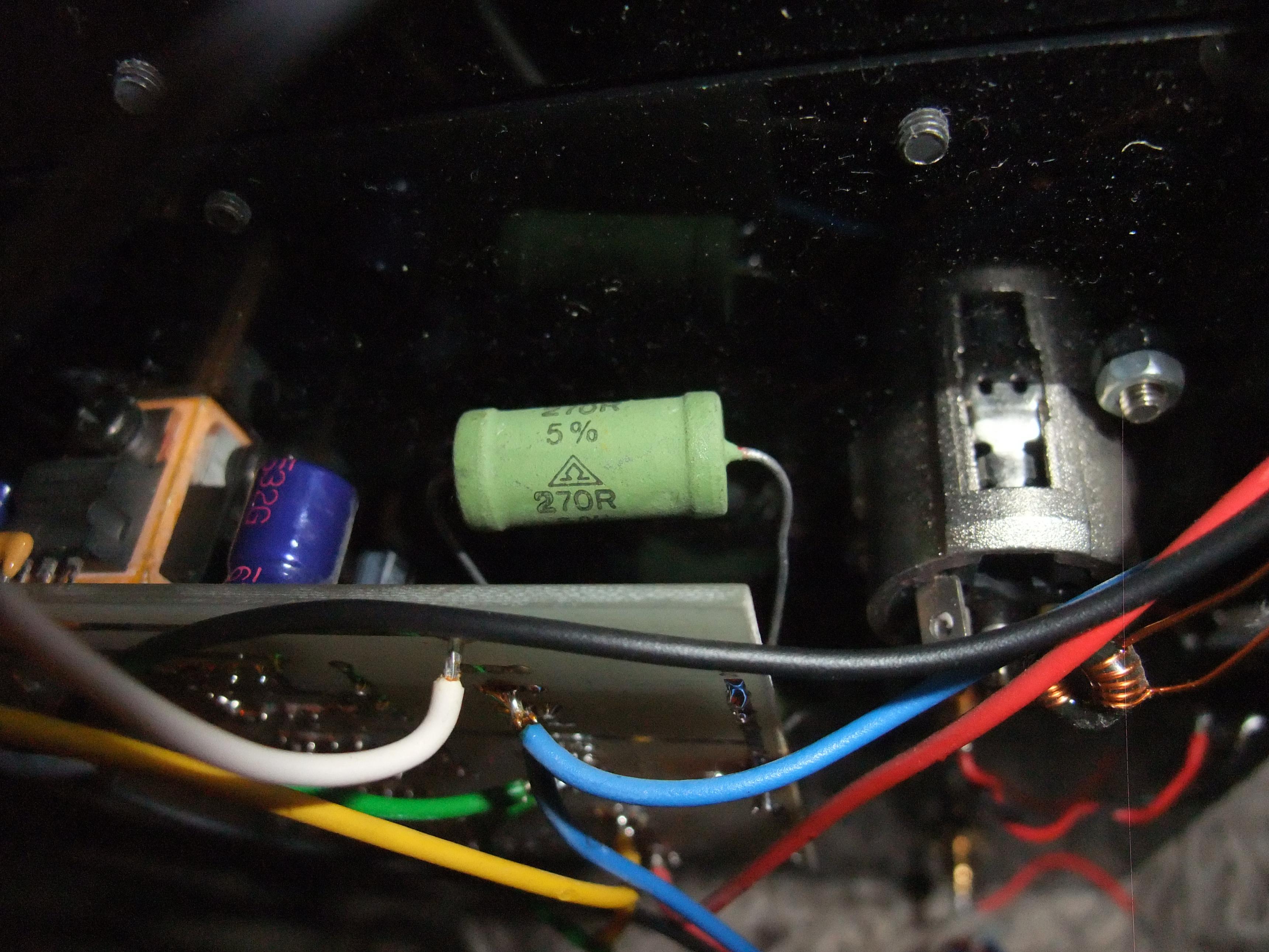

The marked 270R resistors are overheated but not defective.
The series diodes prevent voltage from flowing back into the output of the second regulator, unfortunately not in the first regulator because of the resistors connected in parallel to the second regulators (please note - behind the output of the second regulator stages are connected very large capacities of approximately 400.000µF/each rail - outside of the capacitors are nothing to read).
I want to create a parallel regulator resp. shunt regulator concept.
What needs to be considered here ?
Thanks for an advice and calling the appropriate topics here on diyaudio.

I'd 1st measure the current draw and then calculate the total power dissipation in each rail. I'd regard these bypass resistors as a crutch as they surely affect the PSU's performance in terms of regulation and output noise. Maybe you can try to mount all four LM's at a bigger sink and toss these resistors? Or to increase the series resistors at the LM's inputs?

The power consumption resp. idle current is easy to find out due to the measured voltage values.
for the pos. rail of 5V it is ~ 28mA (14000mV : 490 Ω) and
for the neg. rail of 5V ~ 55mA (14700mV : 270 Ω)
It would be interesting to know where the difference comes from.

If you were right, the diodes behind the second voltage regulators would be defective (internal shorting) - then these regulators would supply part of the total current.
With diodes in perfect condition, only a slightly higher current flows through the 3R3 resistor (higher by the amount for voltage regulator's own power consumption corresponds to).
Which can be neglected, and after reaching 5V, the second voltage regulator stages do not contribute anything to the total current consumption for the DAC and IU board resp. the +/-15VDC filter board.

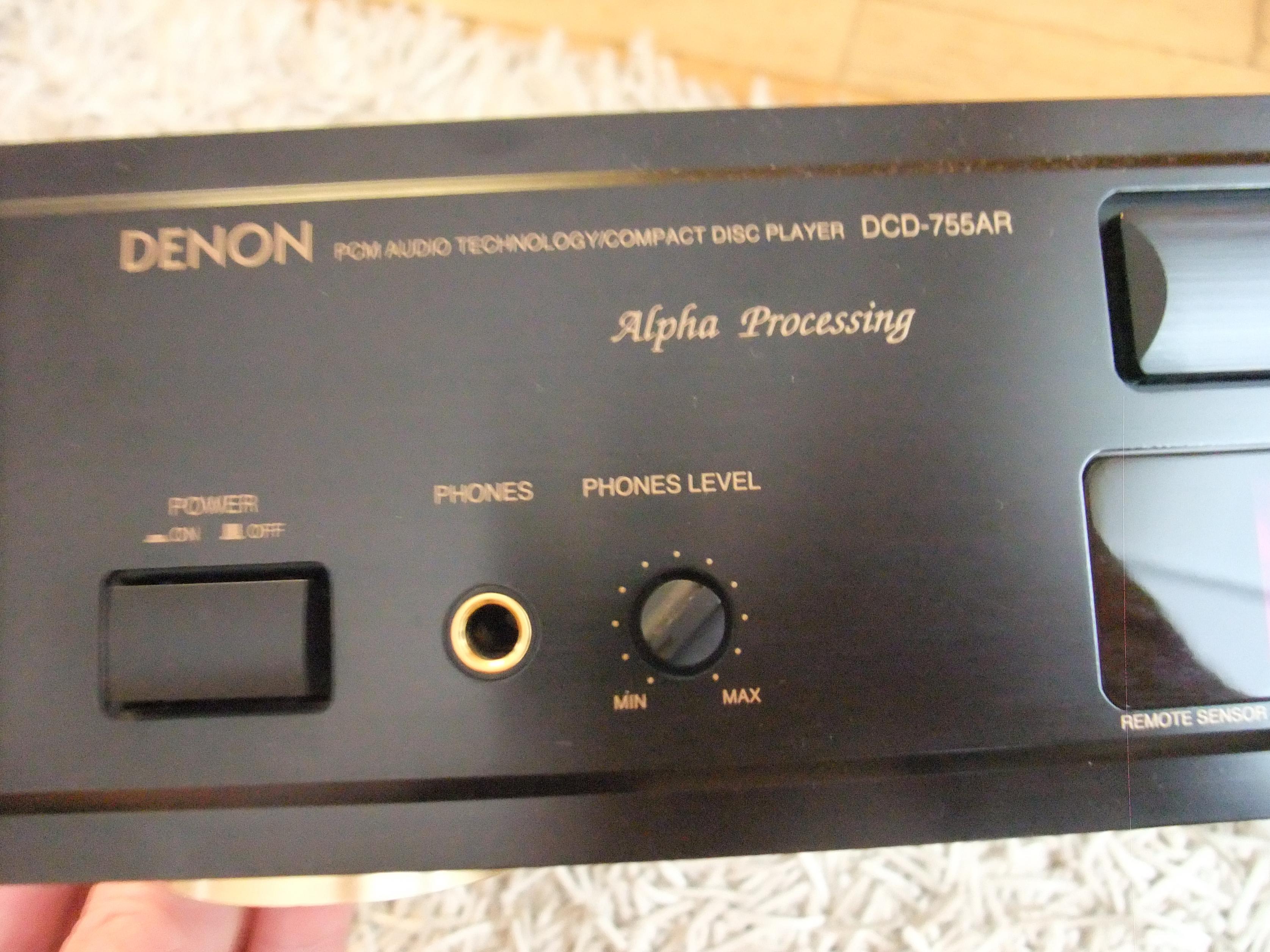

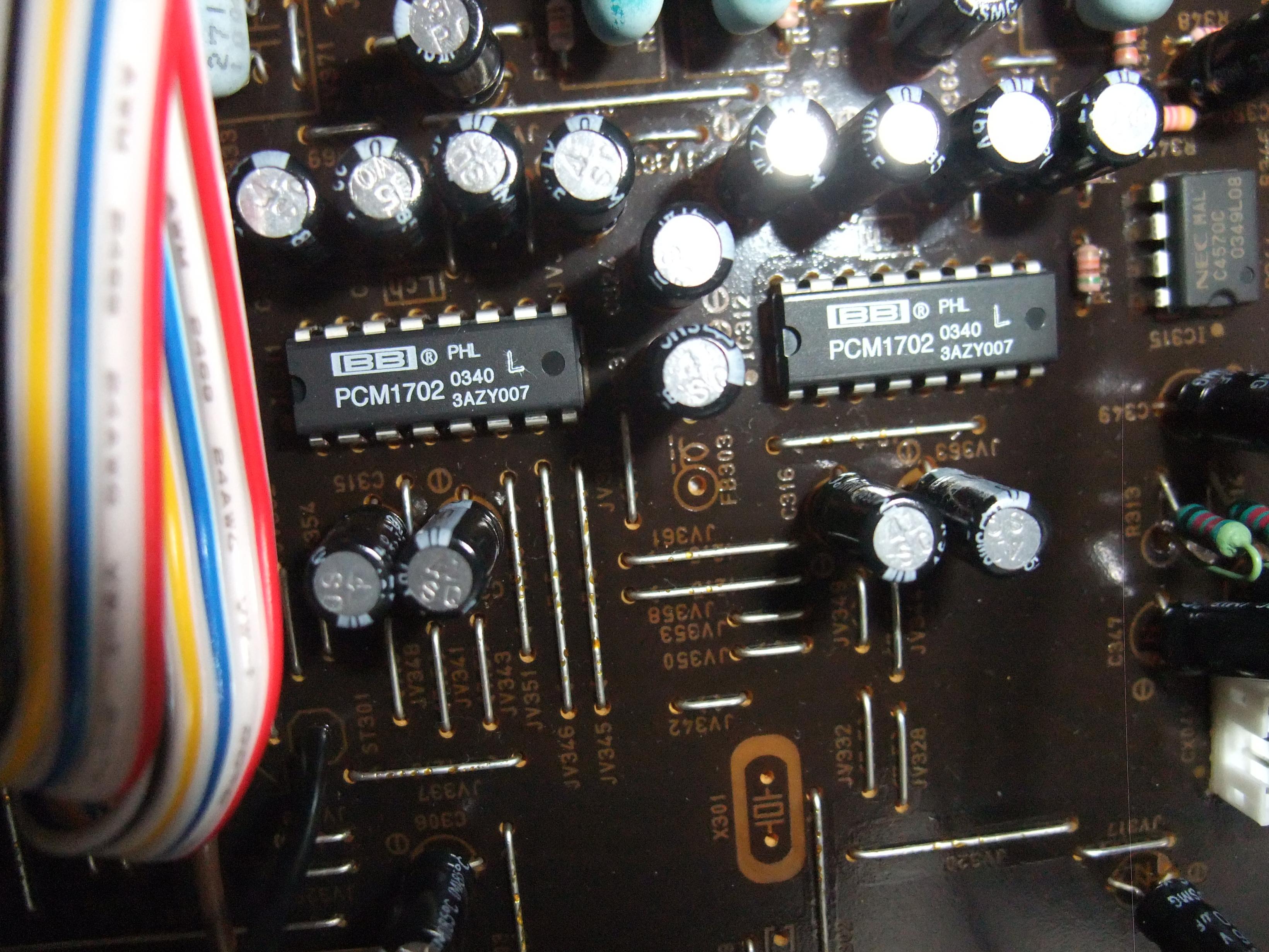

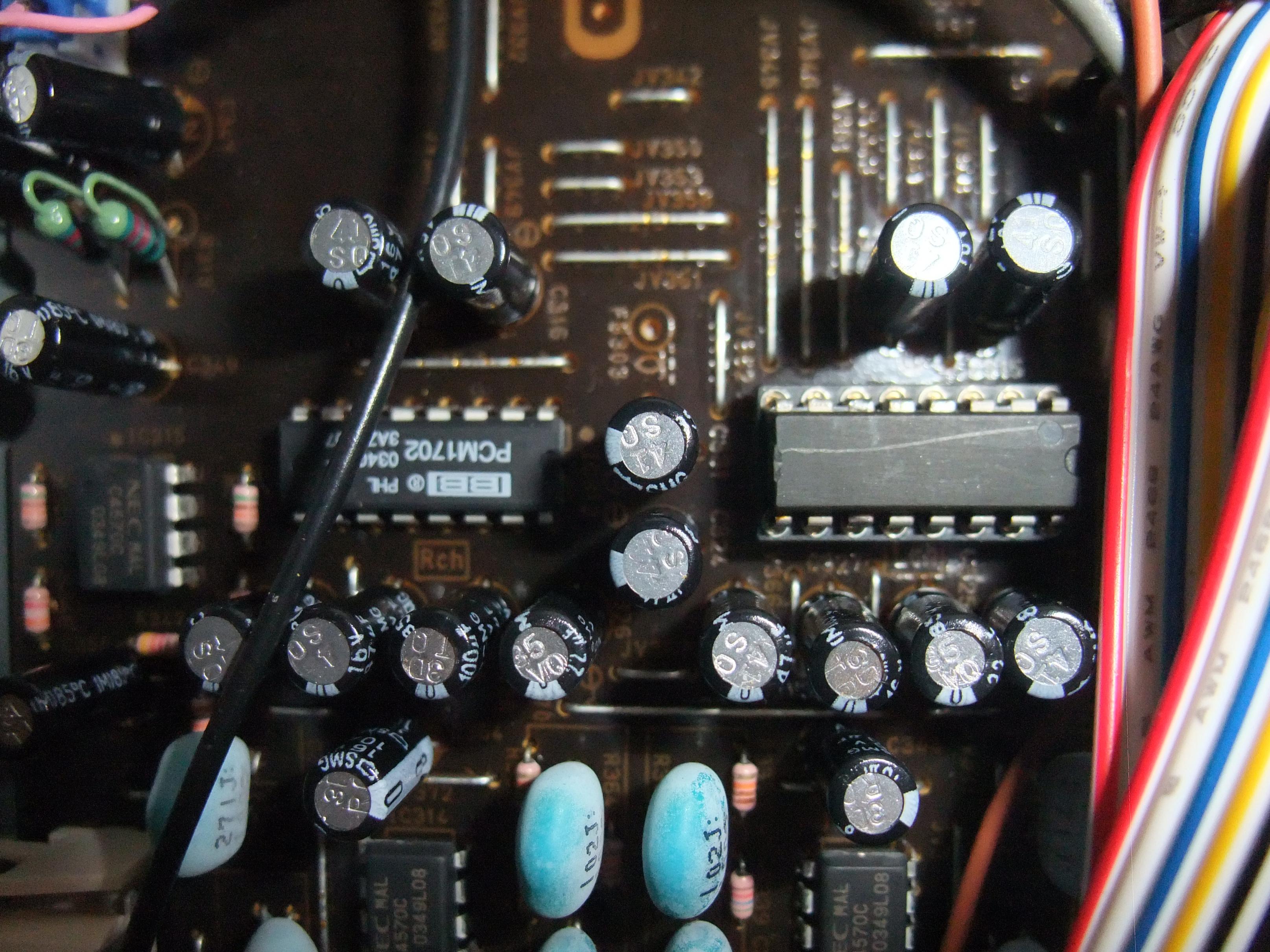

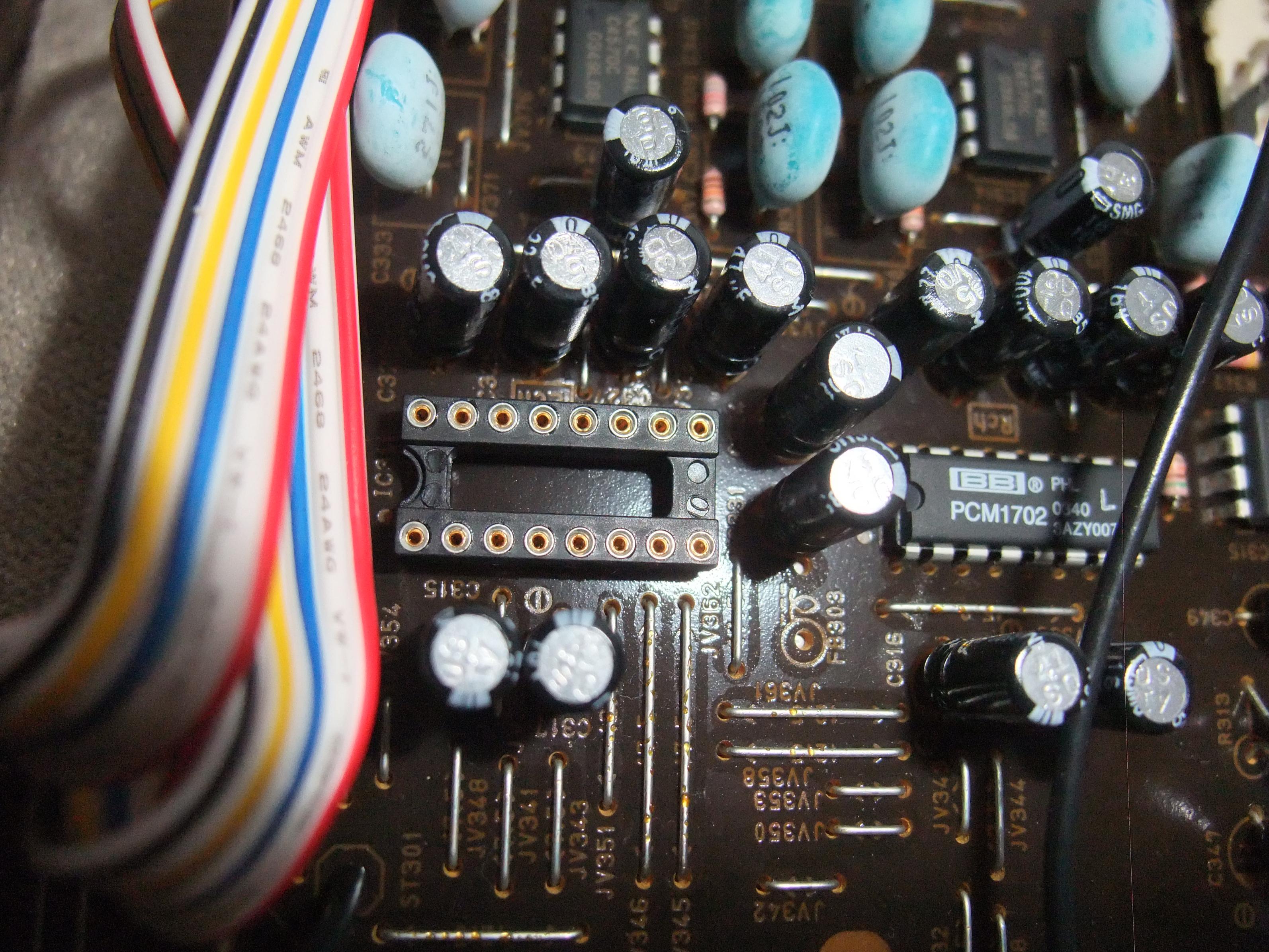

The last pictures show the prepared DENON cd player for testing the PCM1702.
The question whether the difference in the values of the voltage between + Vcc / +Vdd and -Vcc / -Vdd should only remain very small during the start-up phase and during discharge process after switched off is still unanswered.
I guess, this doesn't matter (otherwise the DAC-IC in cd player devices would always fail if one of the positive and negative voltages wasn't present due to a fault in the associated power supply), however, I don't know exactly.
One thing I have discover: there are diodes anti parallel between each supply rail and GND.

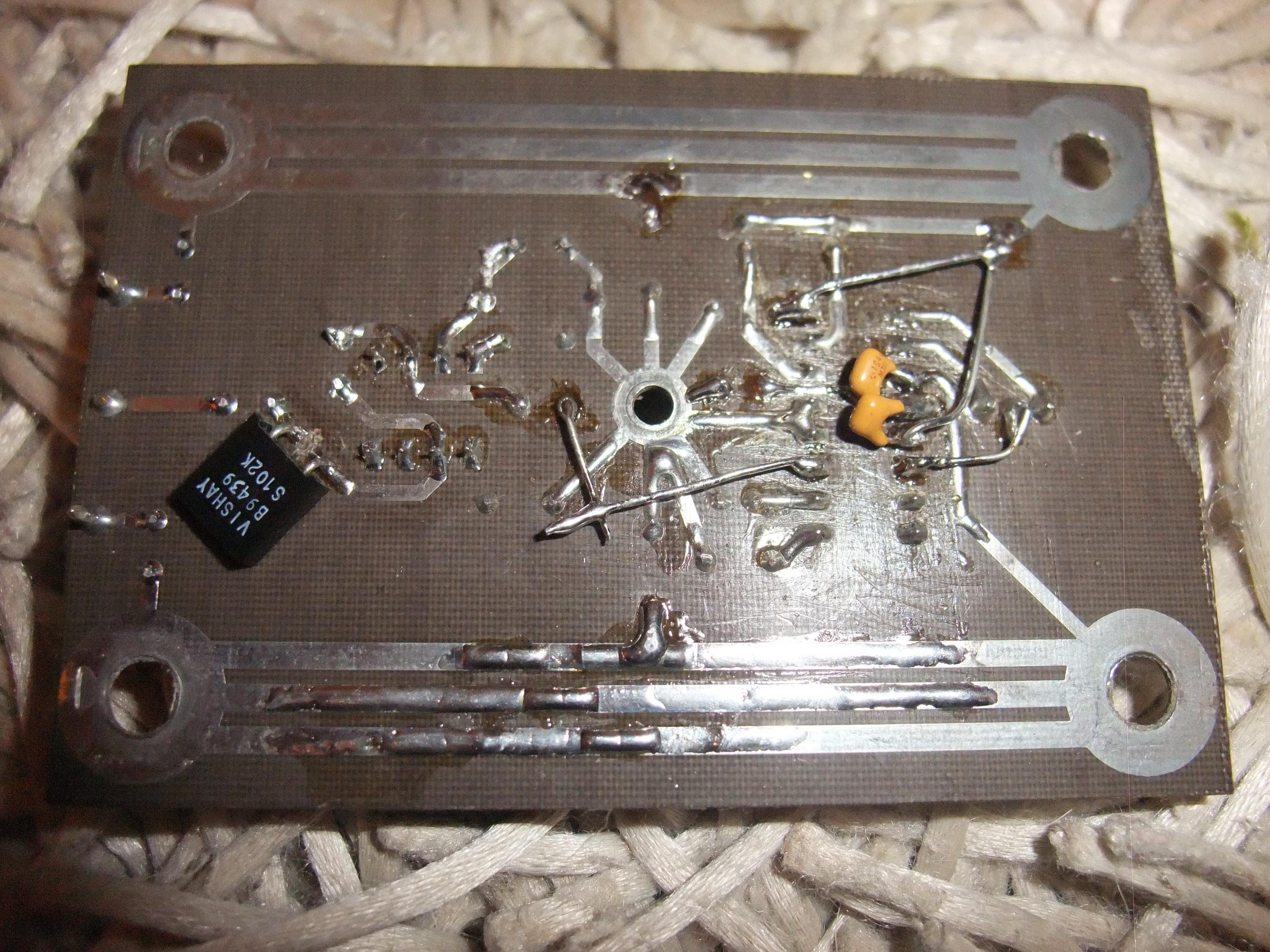

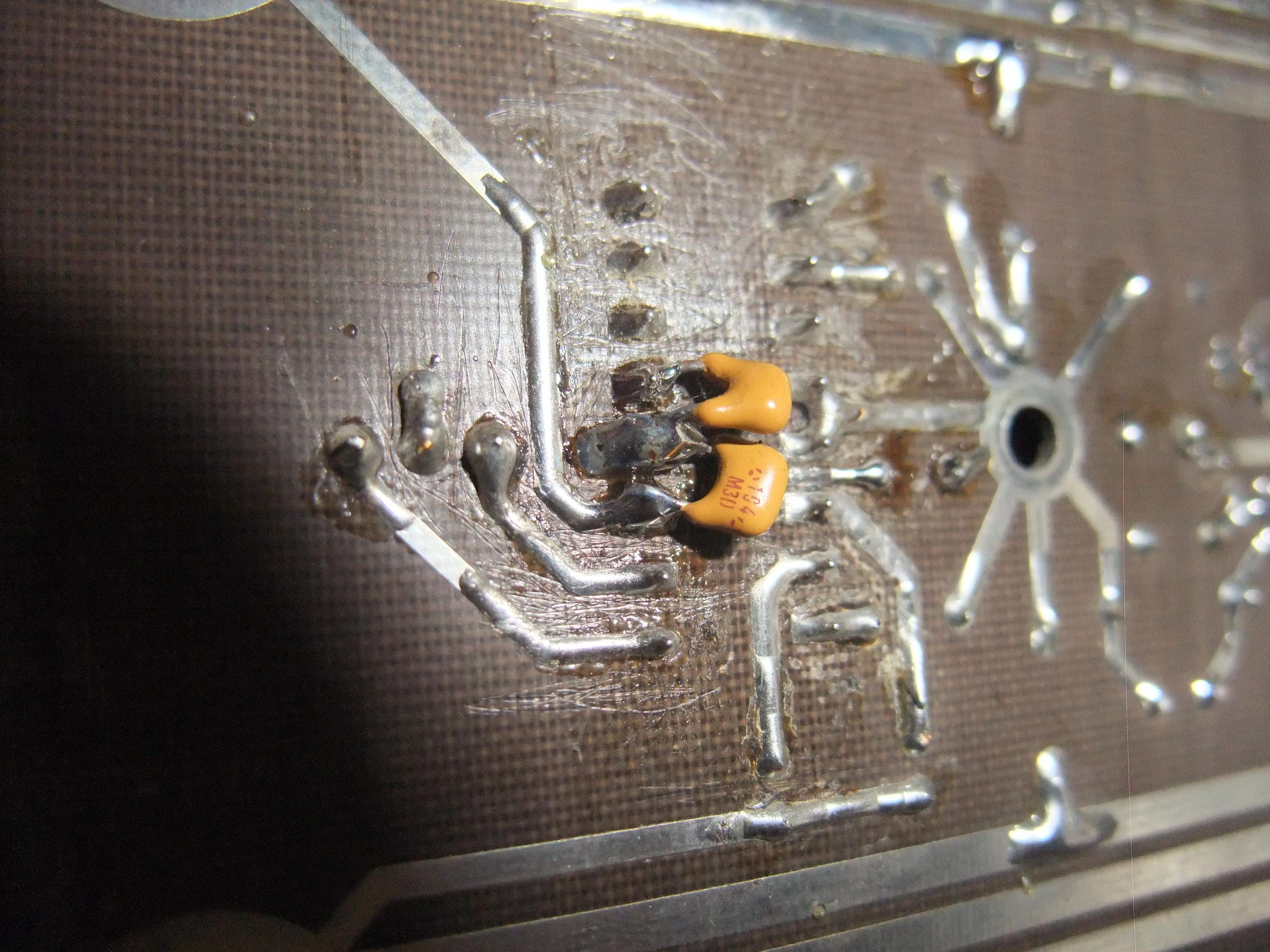

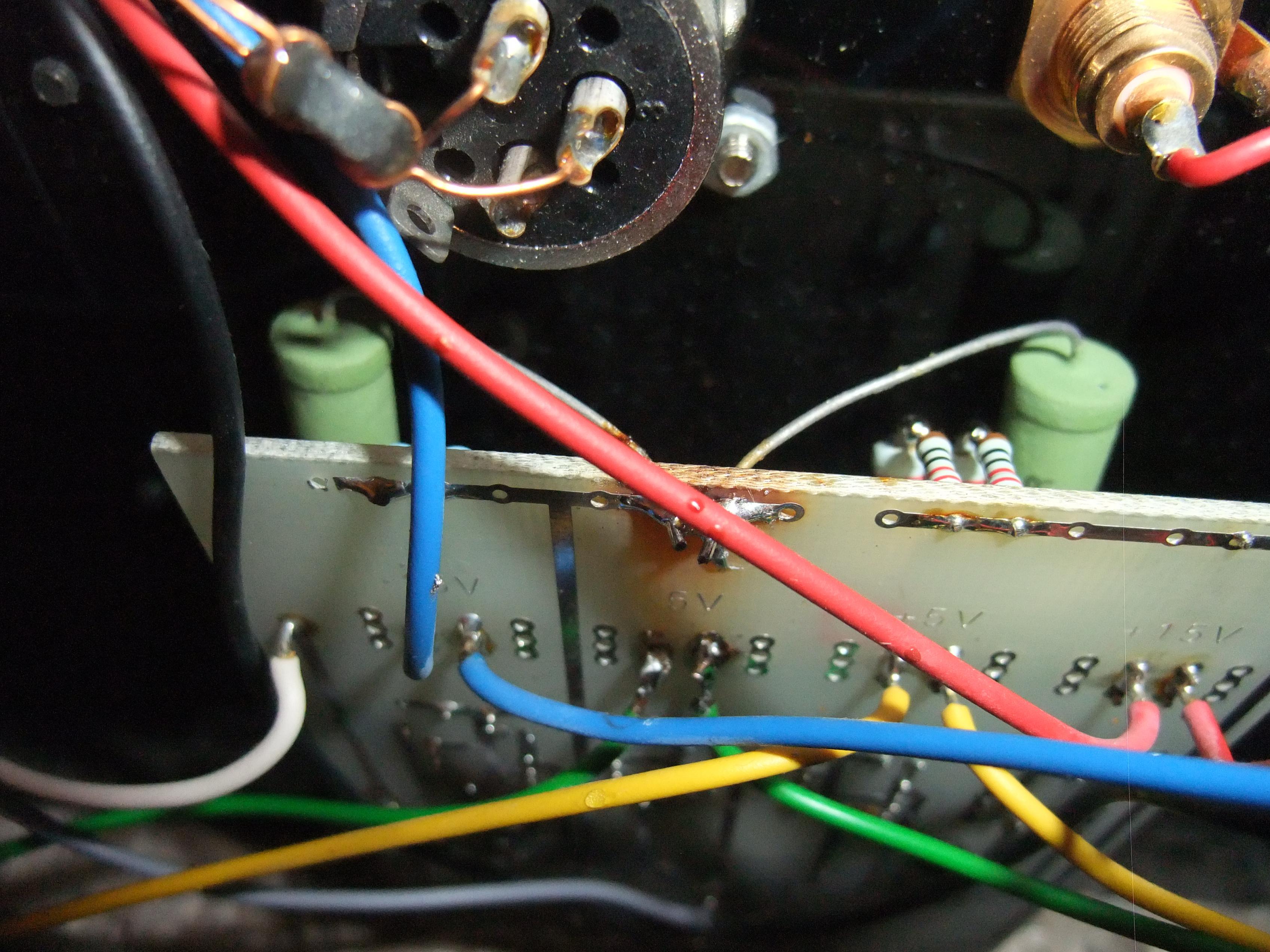

BTW - the burned resistors are not interrupted but too small for the power loss (please note, the current flow in the neg. half is much more than in pos. half.) The basic operation and the fact, that the second voltage regulator doesn't matter after start-up phase I had already mentioned in post # 46.

Due the relatively low cost of the DENON cd player equipped with PCM1702

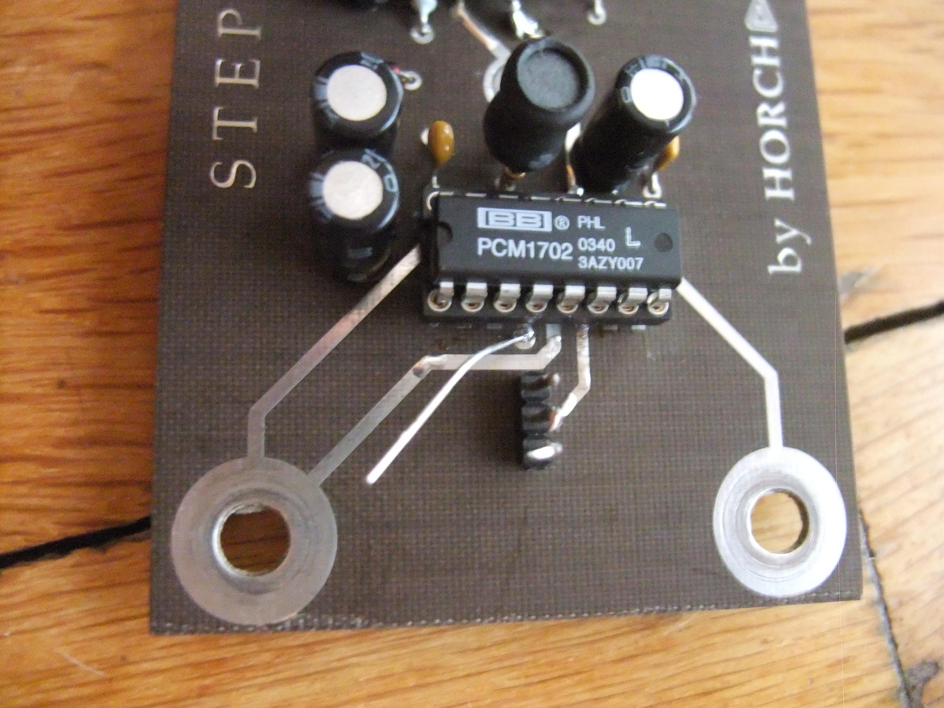

I risked switch-on the DAC device with the desoldered PCM1702 from those used Denon.
But the left channel still don't work.
After I put it back into the Denon CD player, where I had already inserted a 16-pol socket, I note, this PCM1702 still works perfectly.

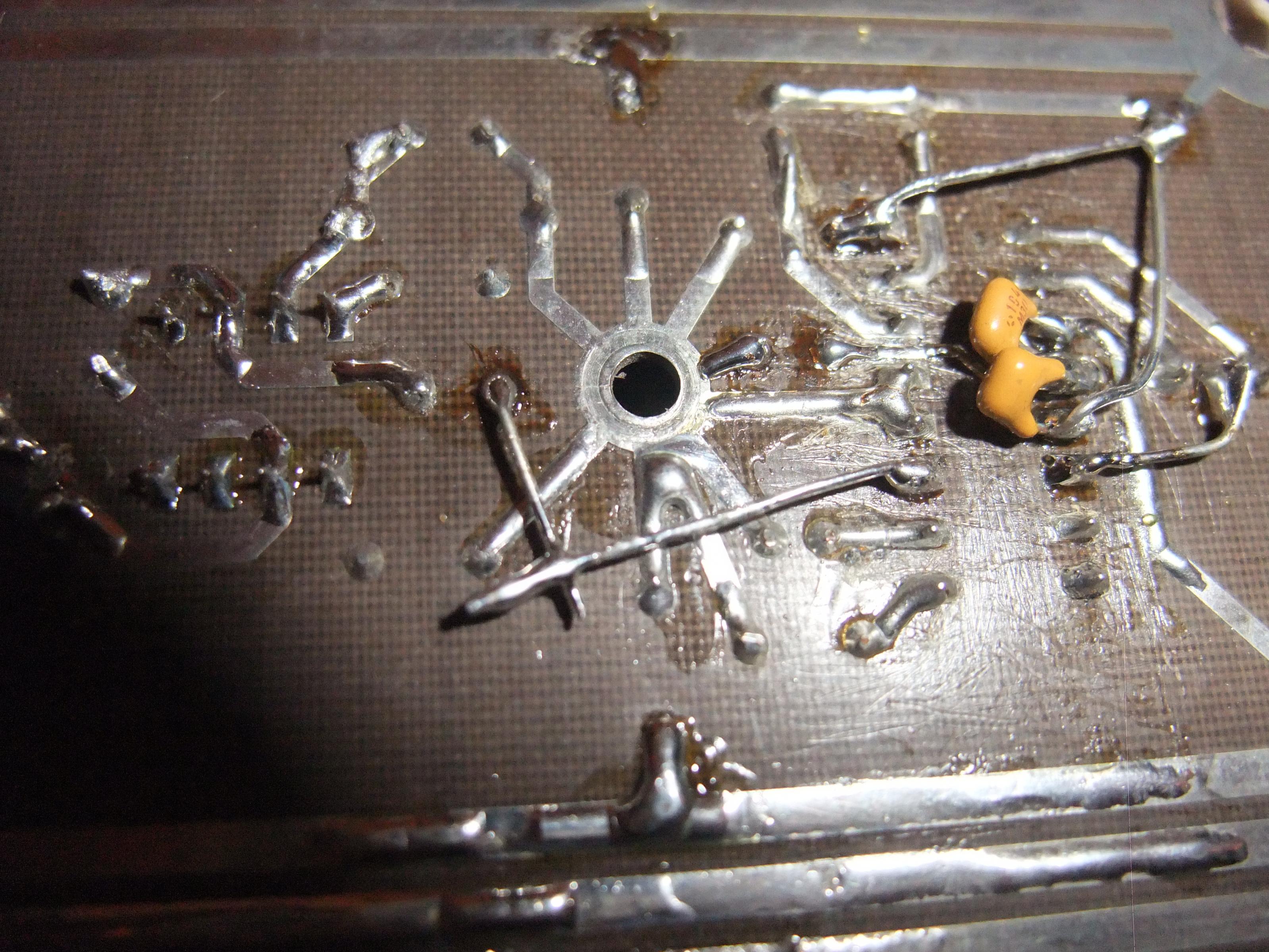

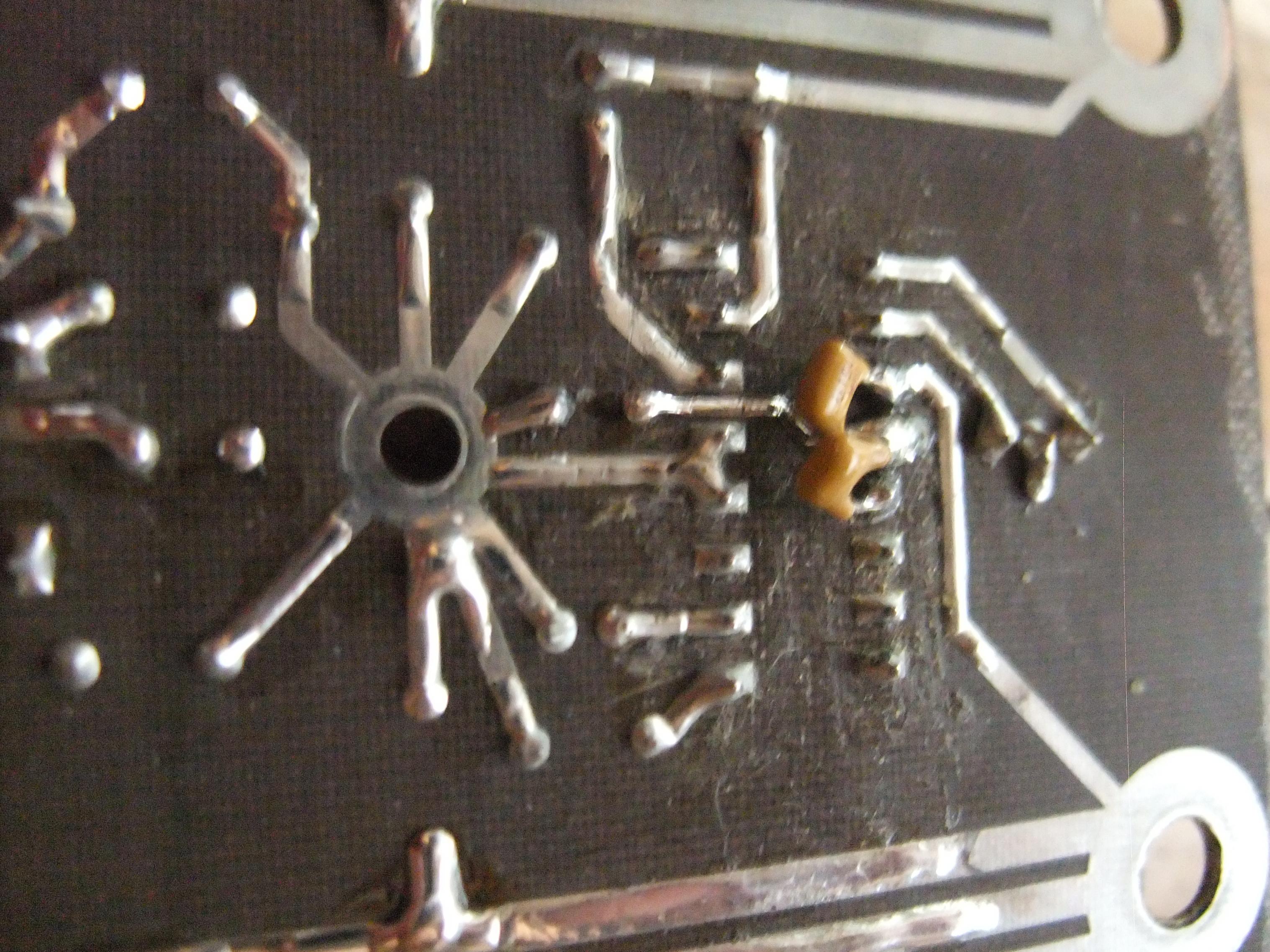

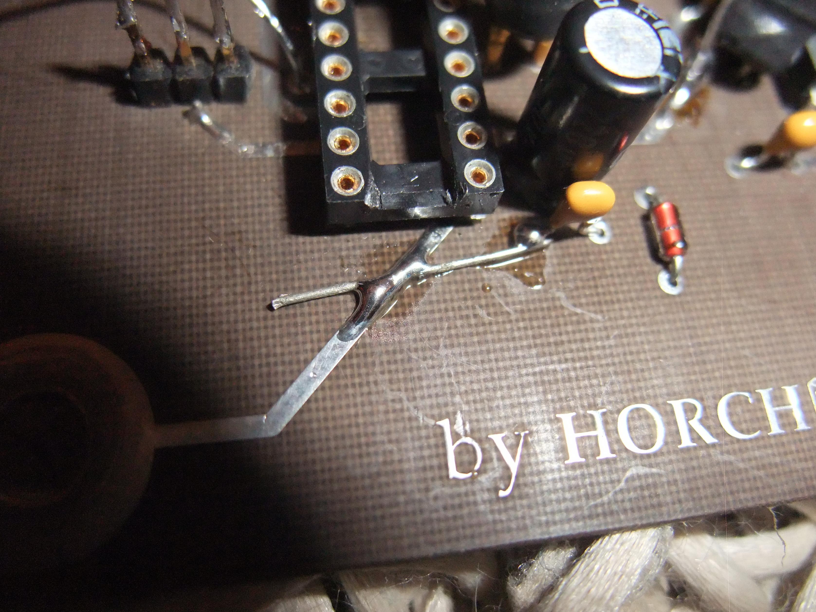

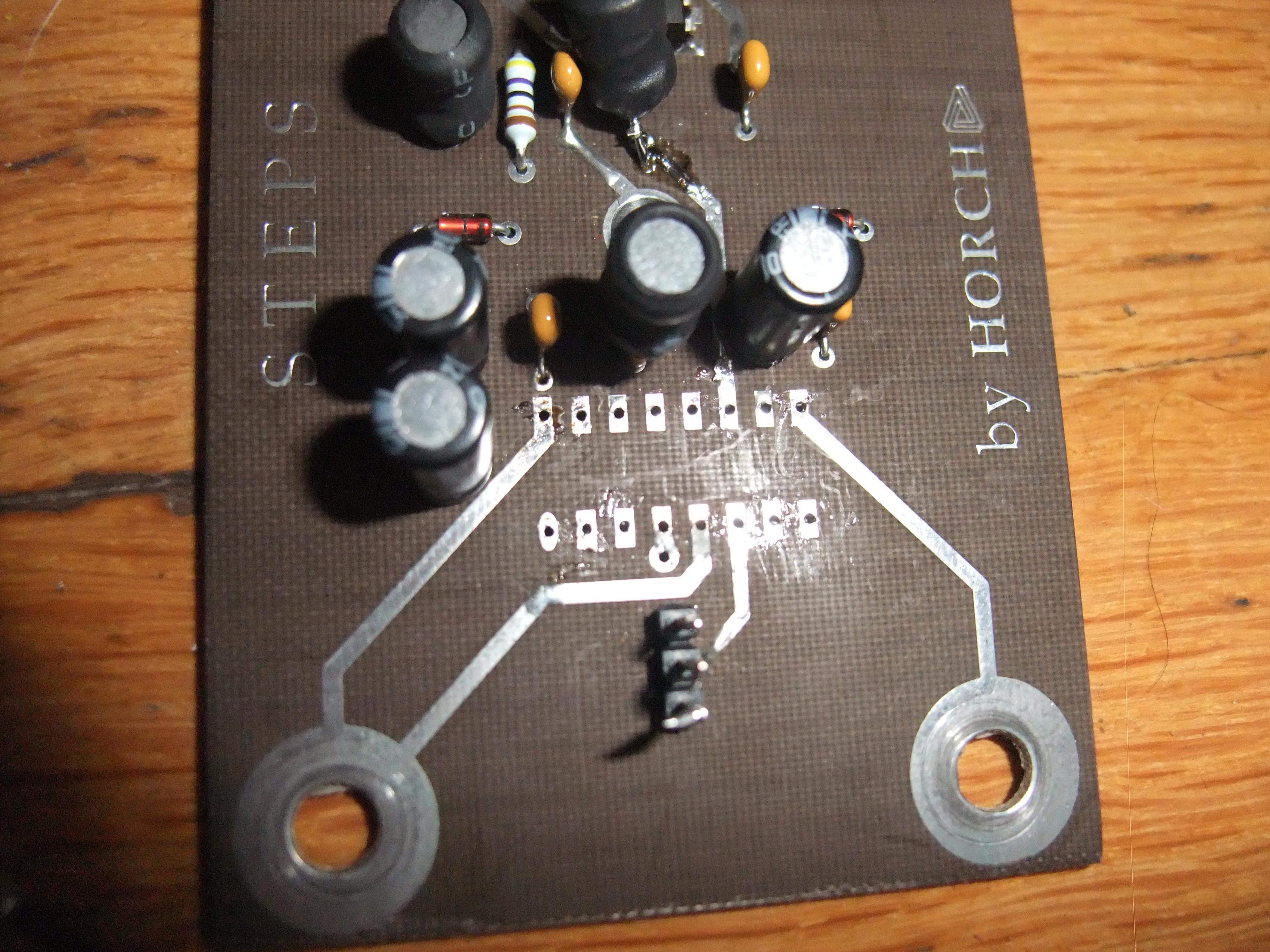

After some measurements it turned out, that on the Horch DAC-PCB is no conductive path from solder side of the board to the component side. I. e. no plated through holes are present. Consequence was the need to introduce additional wire bridges due the additional introduced socket for the PCM1702, which couldn't be soldered from the component side (go to the attached images).
After doing this and replace the burned 270R resistors by 5W versions the Horch DAC device work perfect since several days.
However, I note, that the time is very long after switch-on (approximately 30-35 minutes) until the+/-5V has reached its final value.
