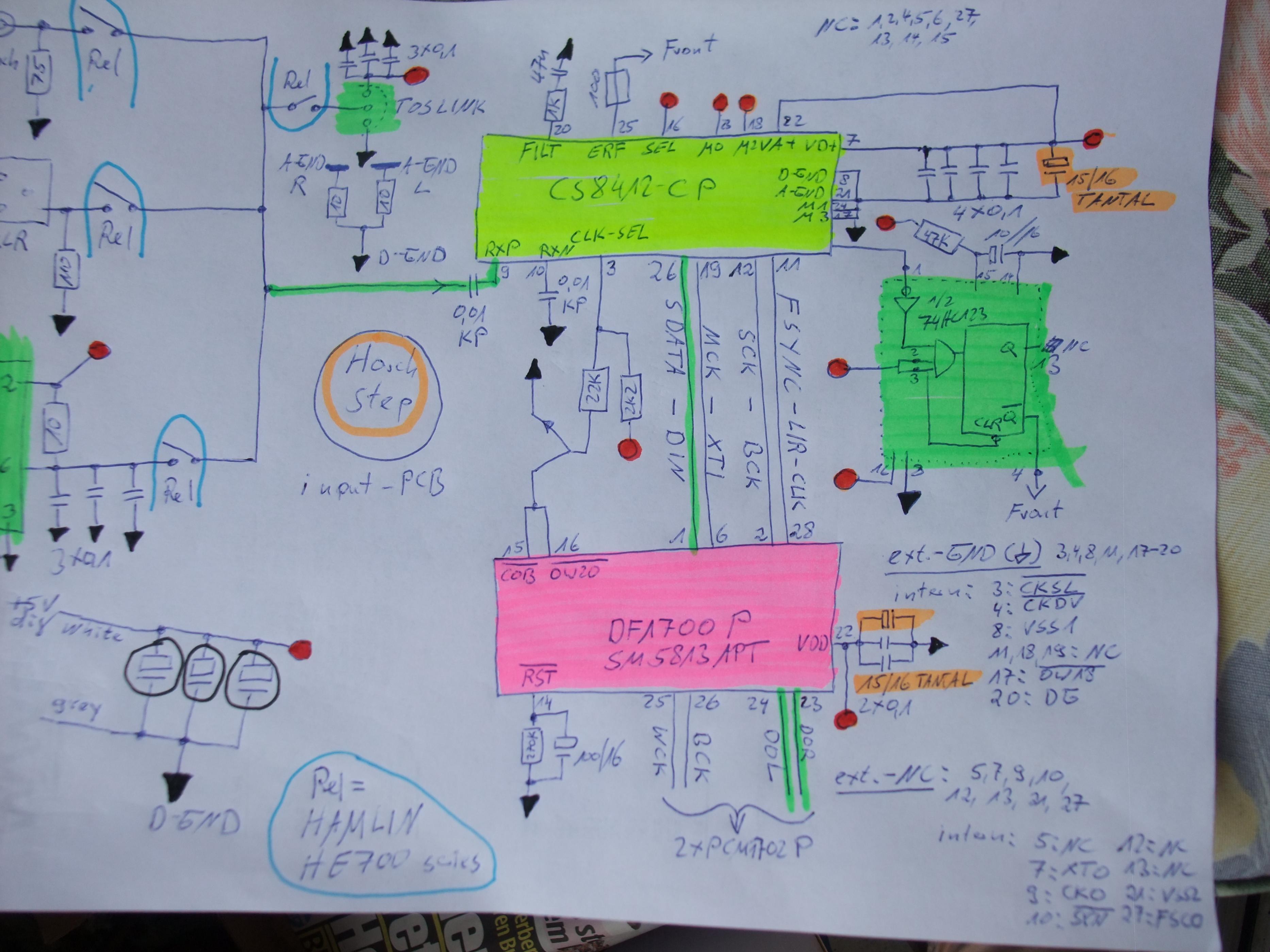

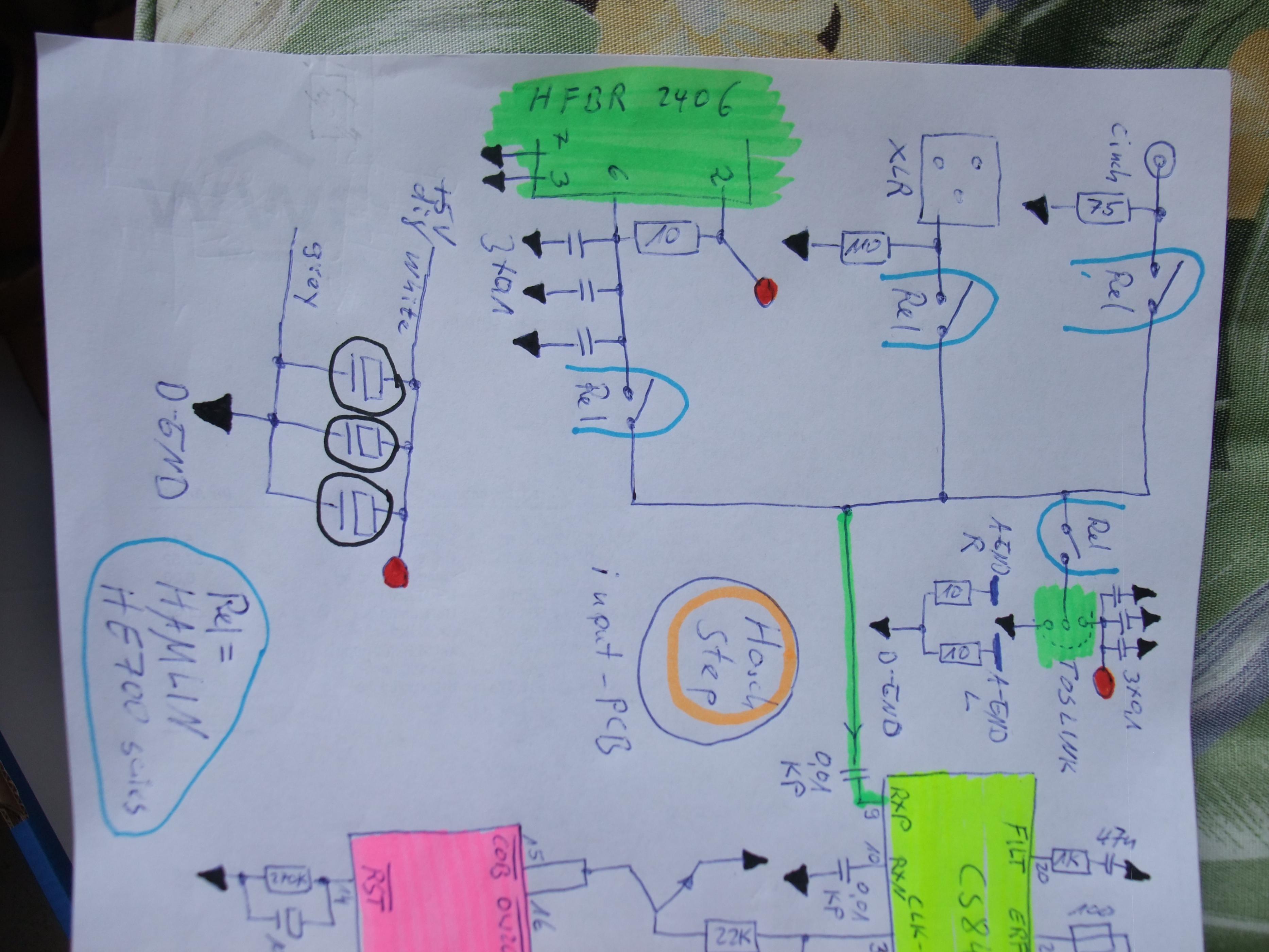

Horch D/A Converter Model STEP - Input Board Schematic

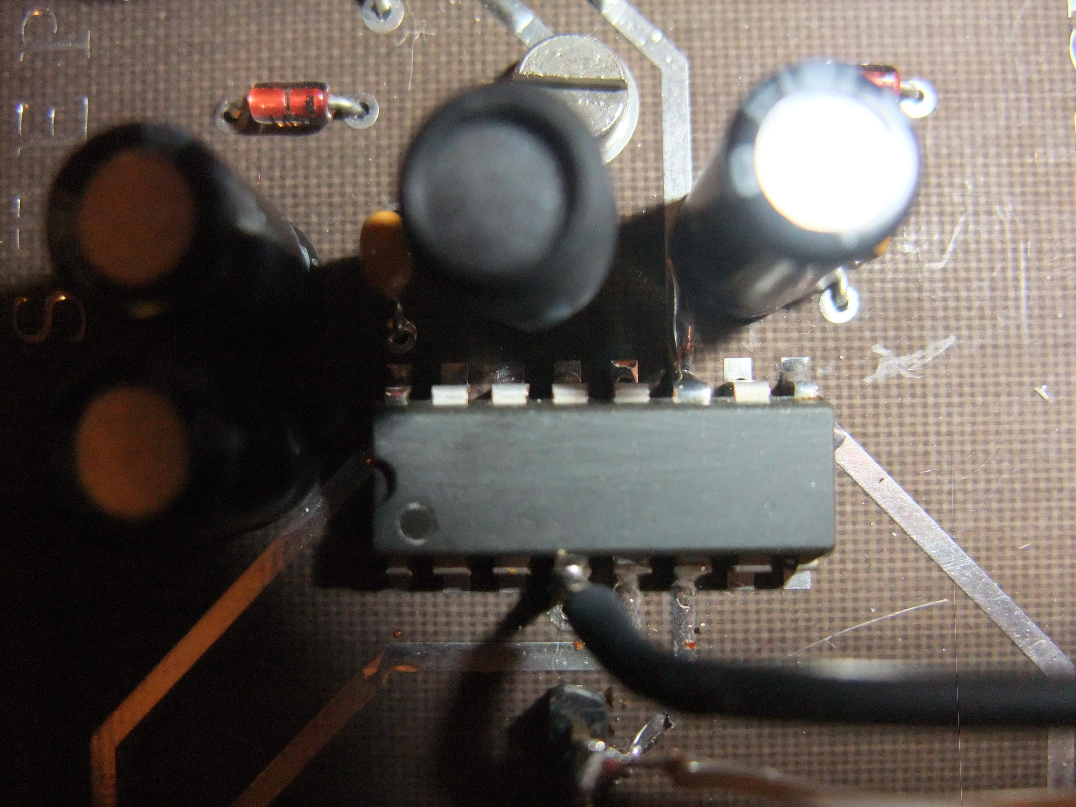

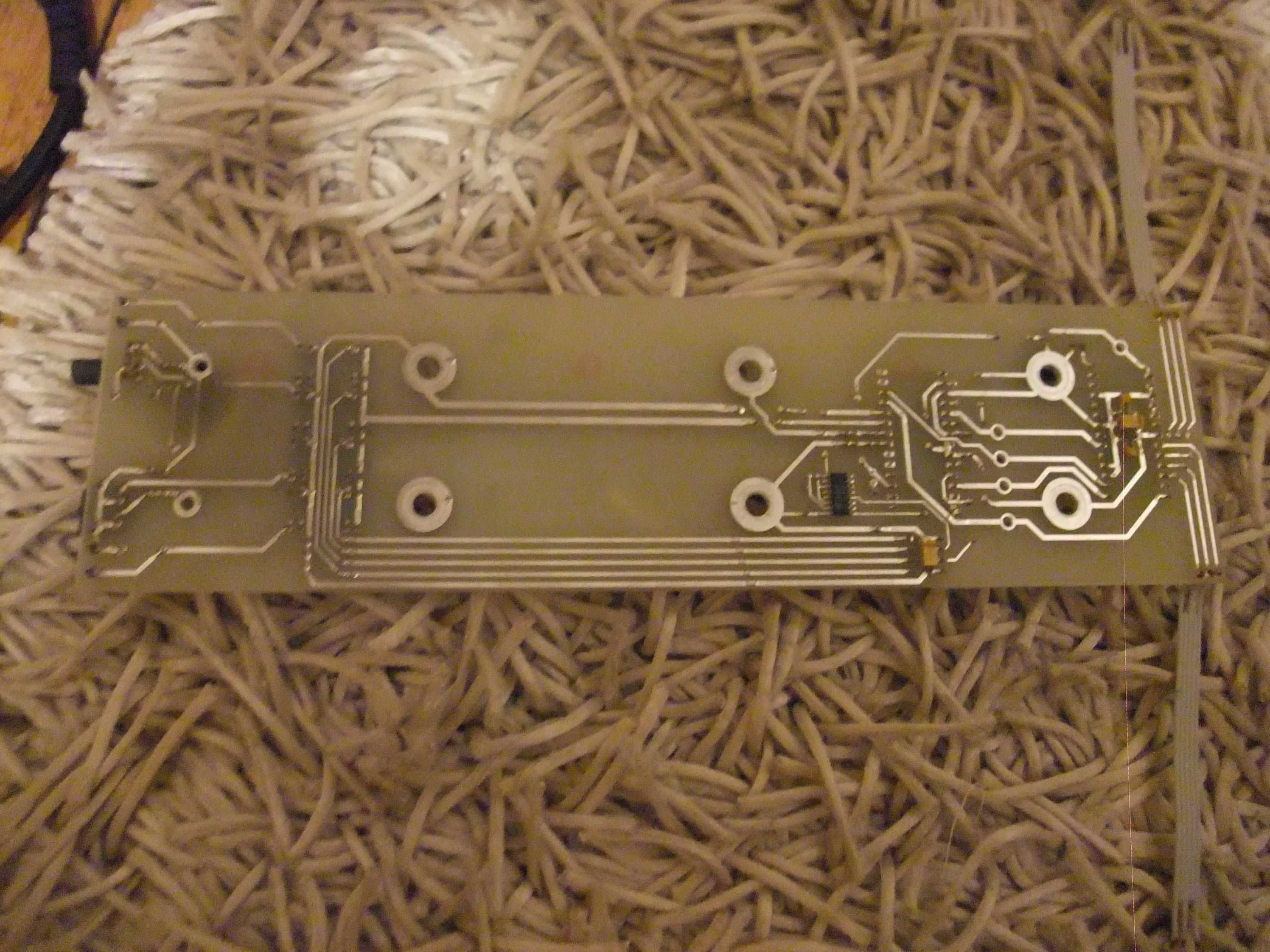

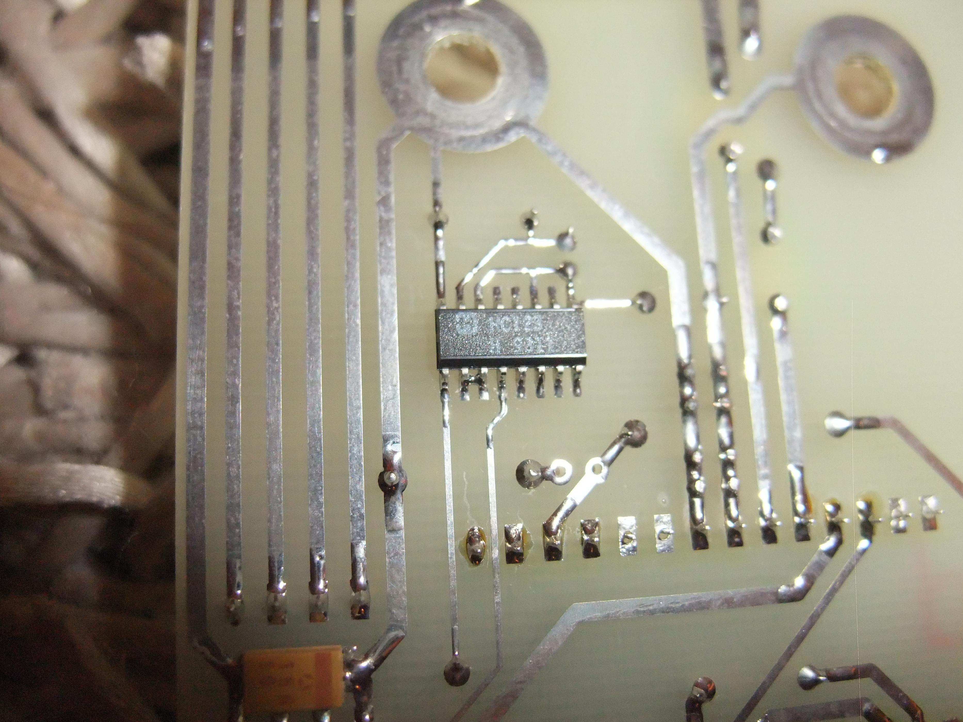

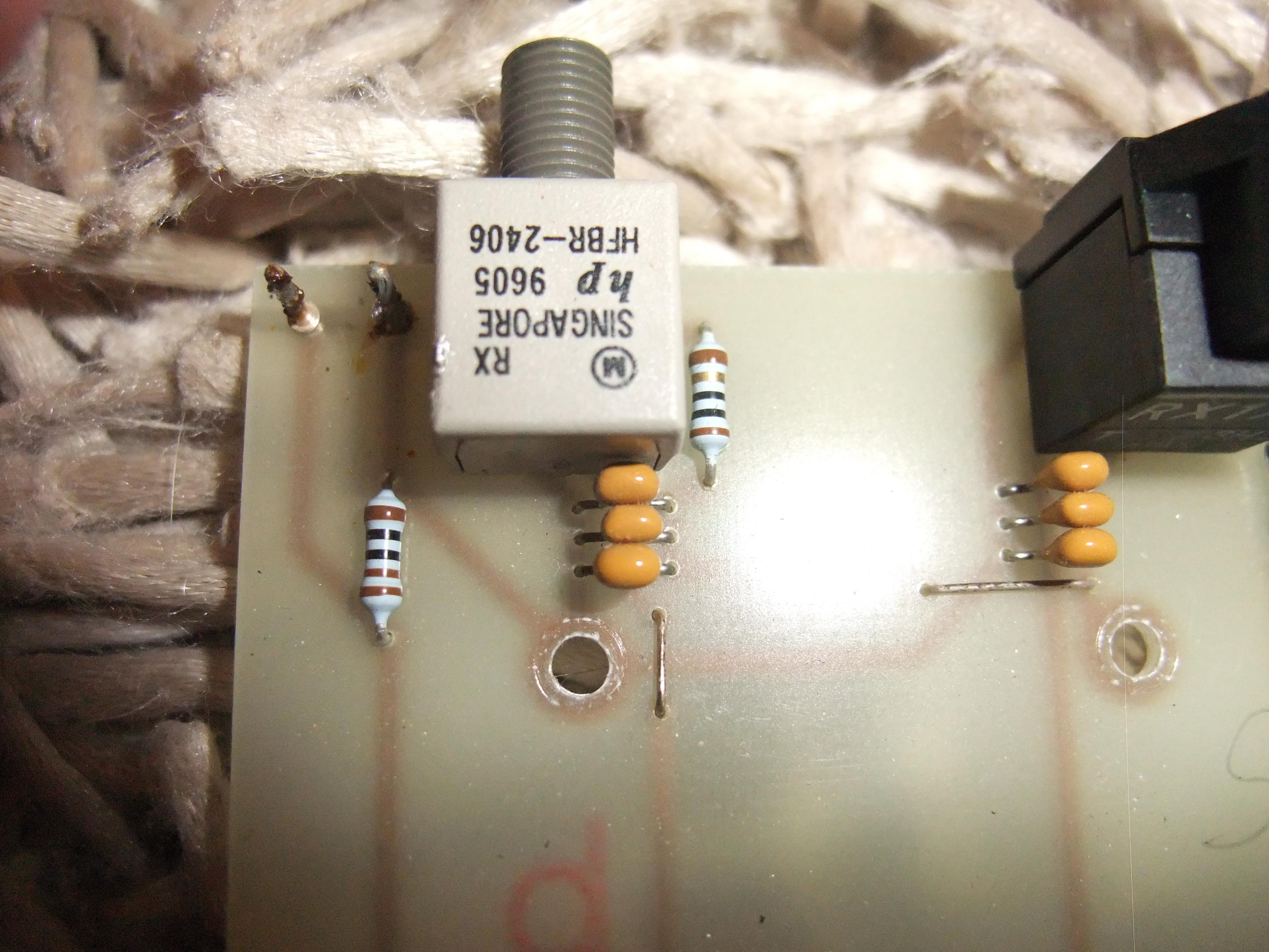

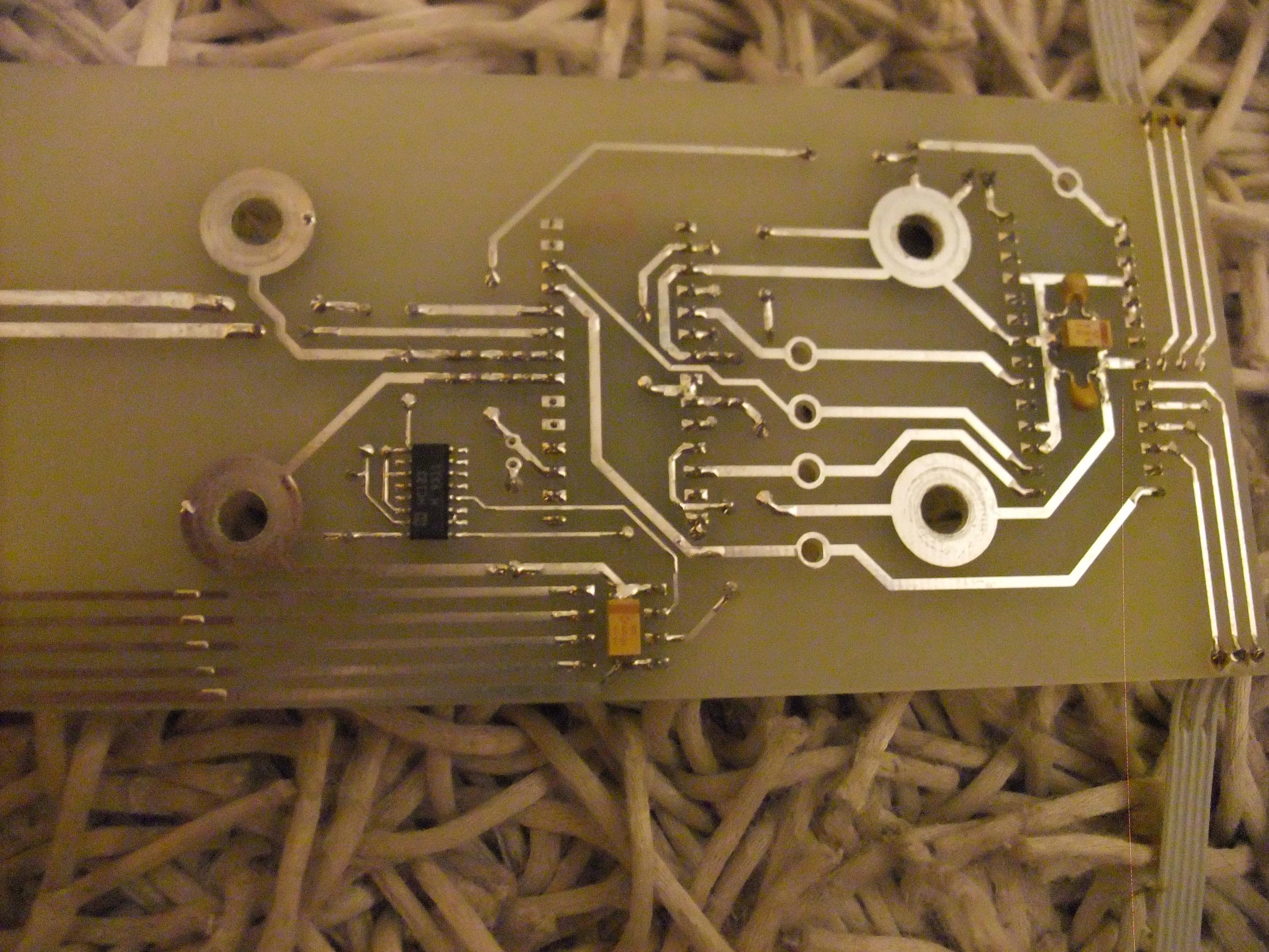

In the attachment several images and own create schematics. Please note - all IC types are just assumptions. Any other pin-compatible versions from those days could just as easily be used.

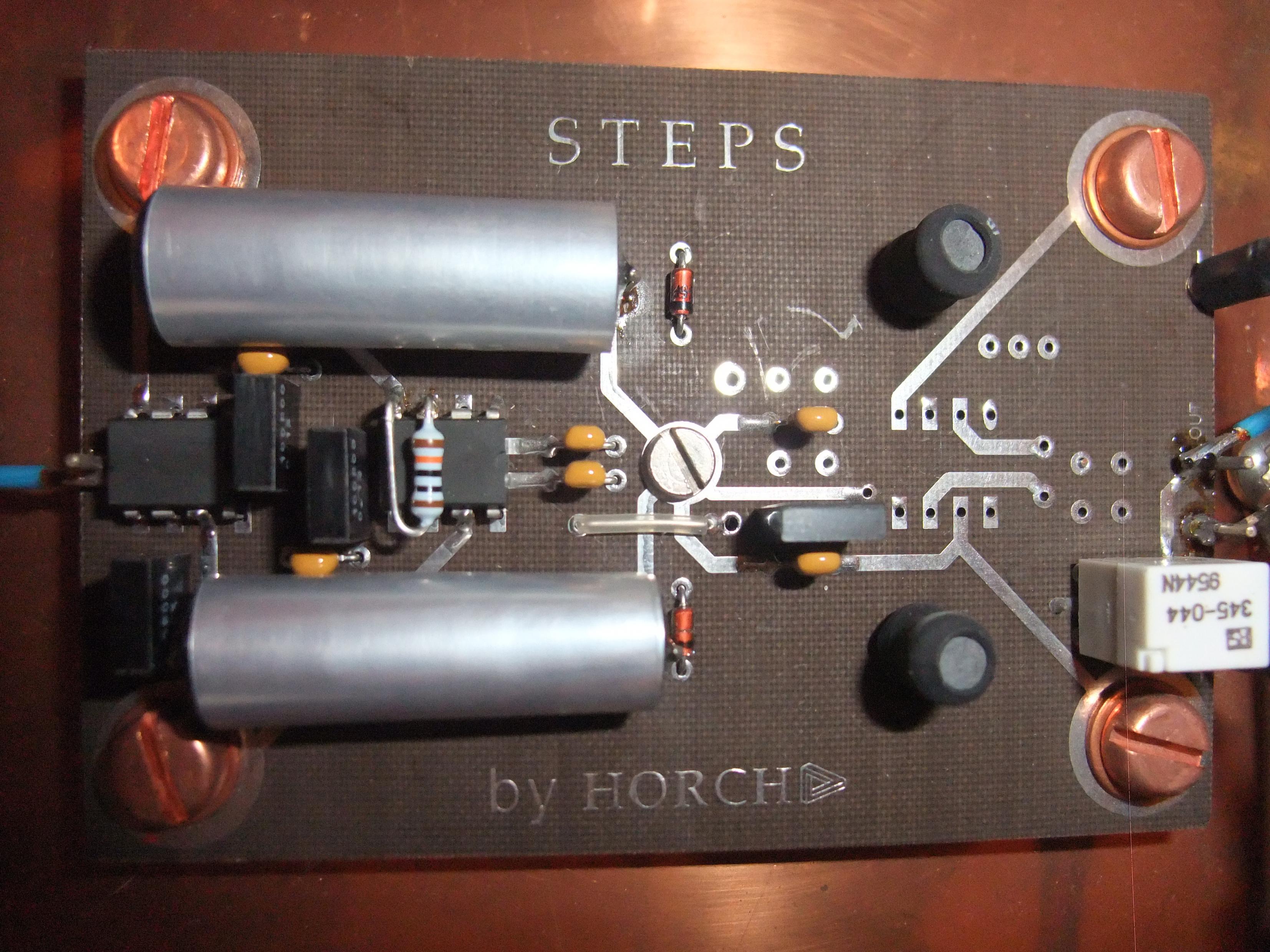

Horch D/A Converter Model STEP - DAC+I/U Board Schematic

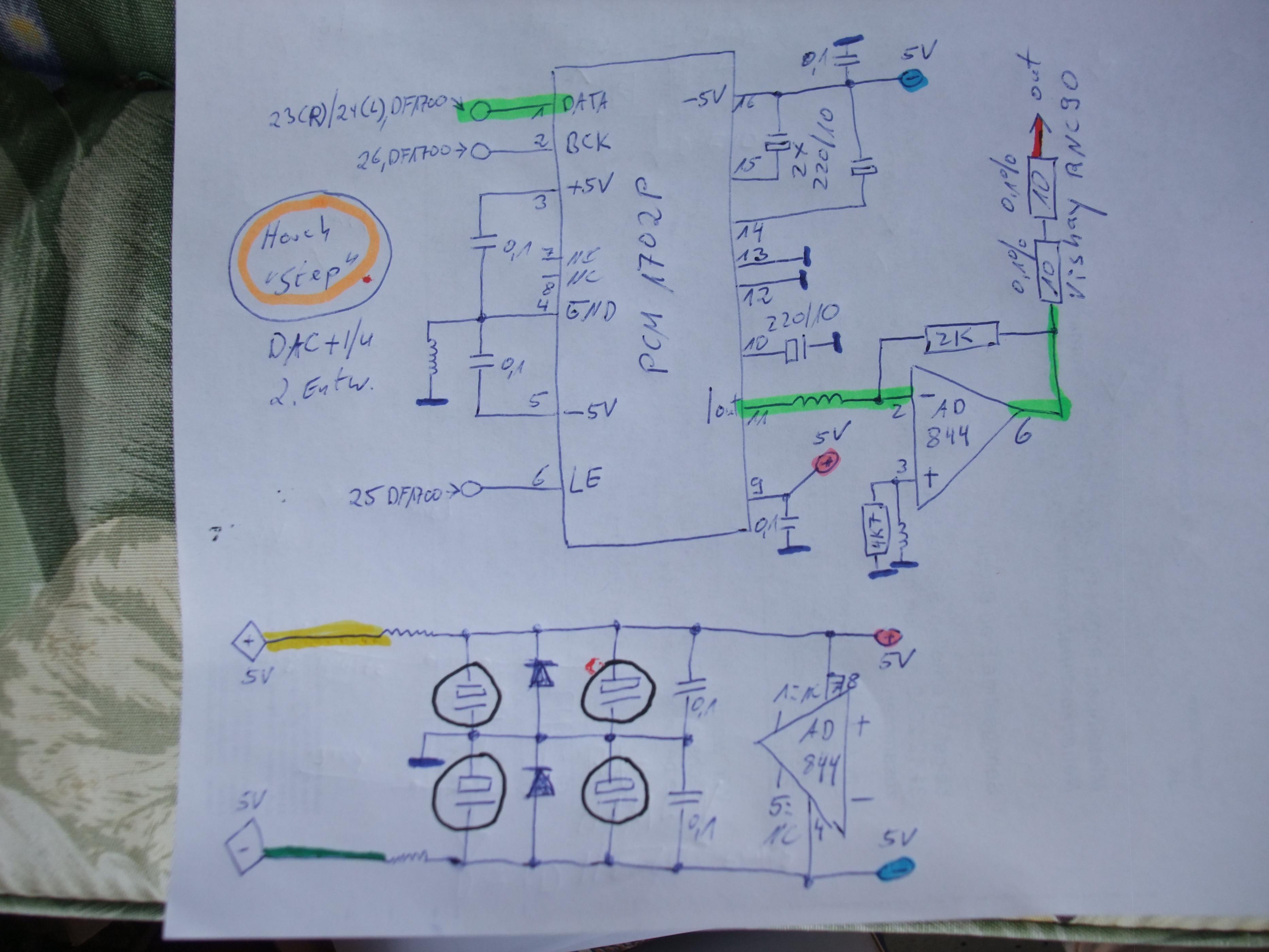

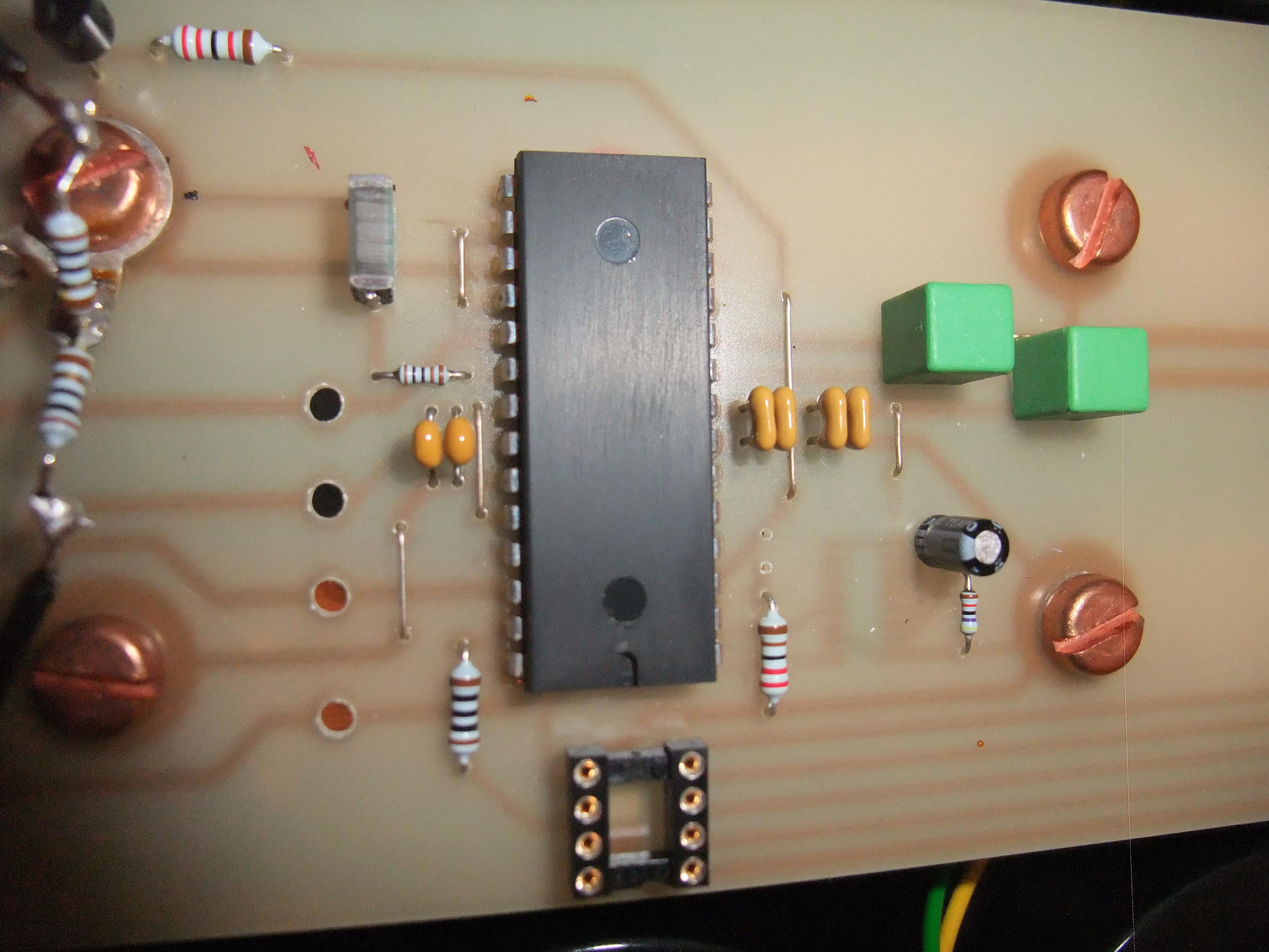

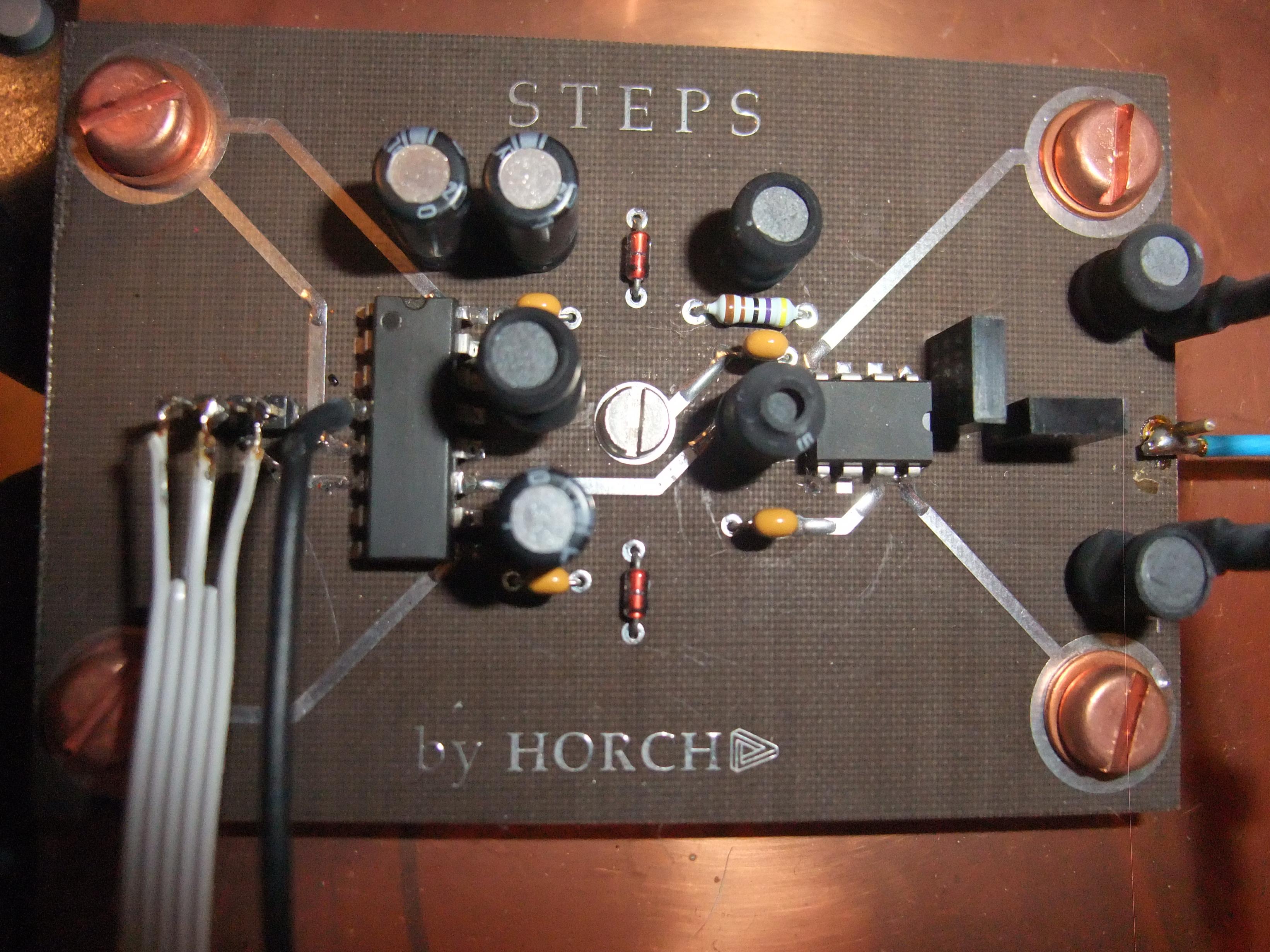

How many pin compatible versions exist from DAC-IC "PCM1702P" and operational amplifier AD844 (60 MHz, 2000 V/μs or better) ?

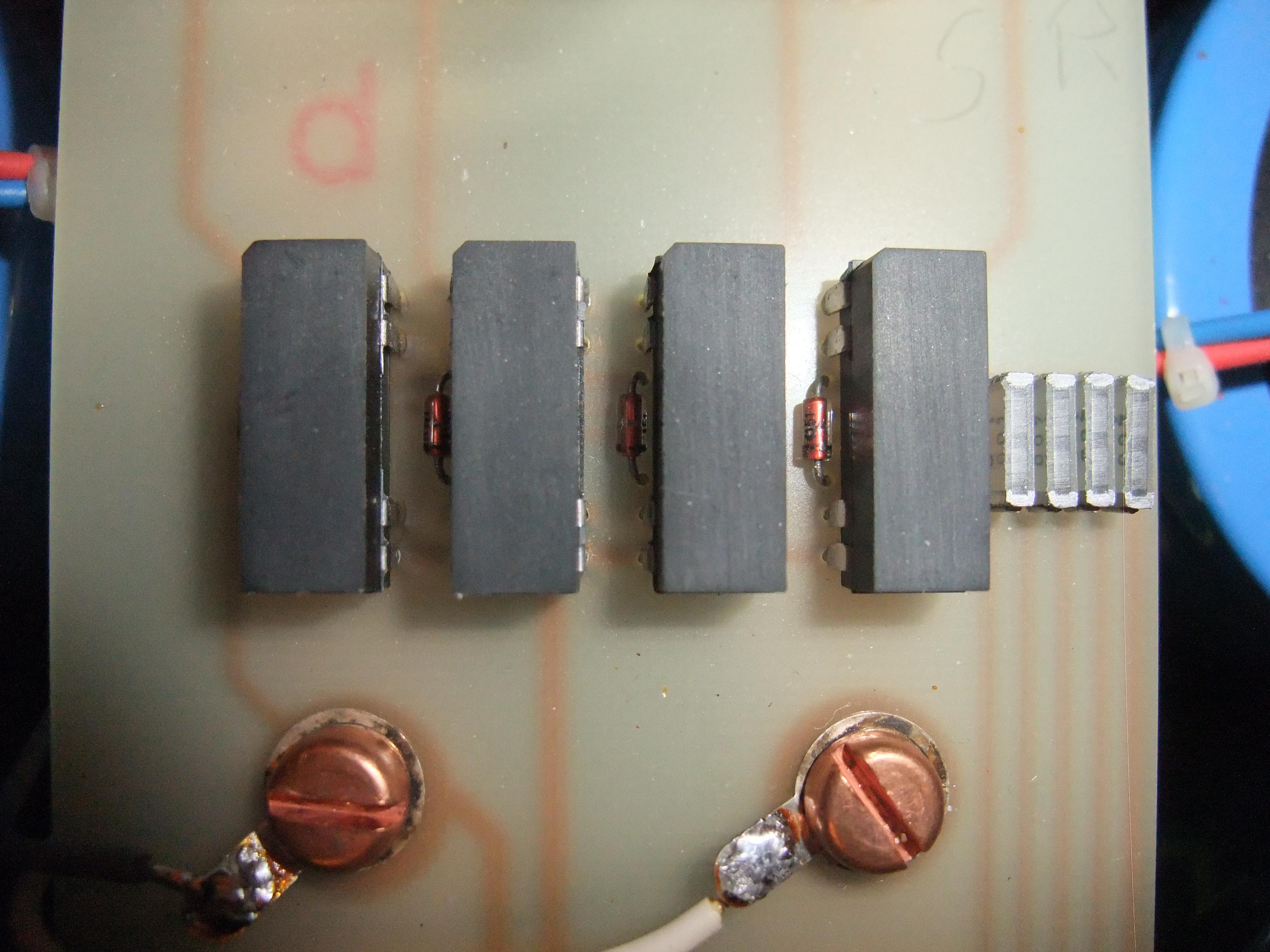

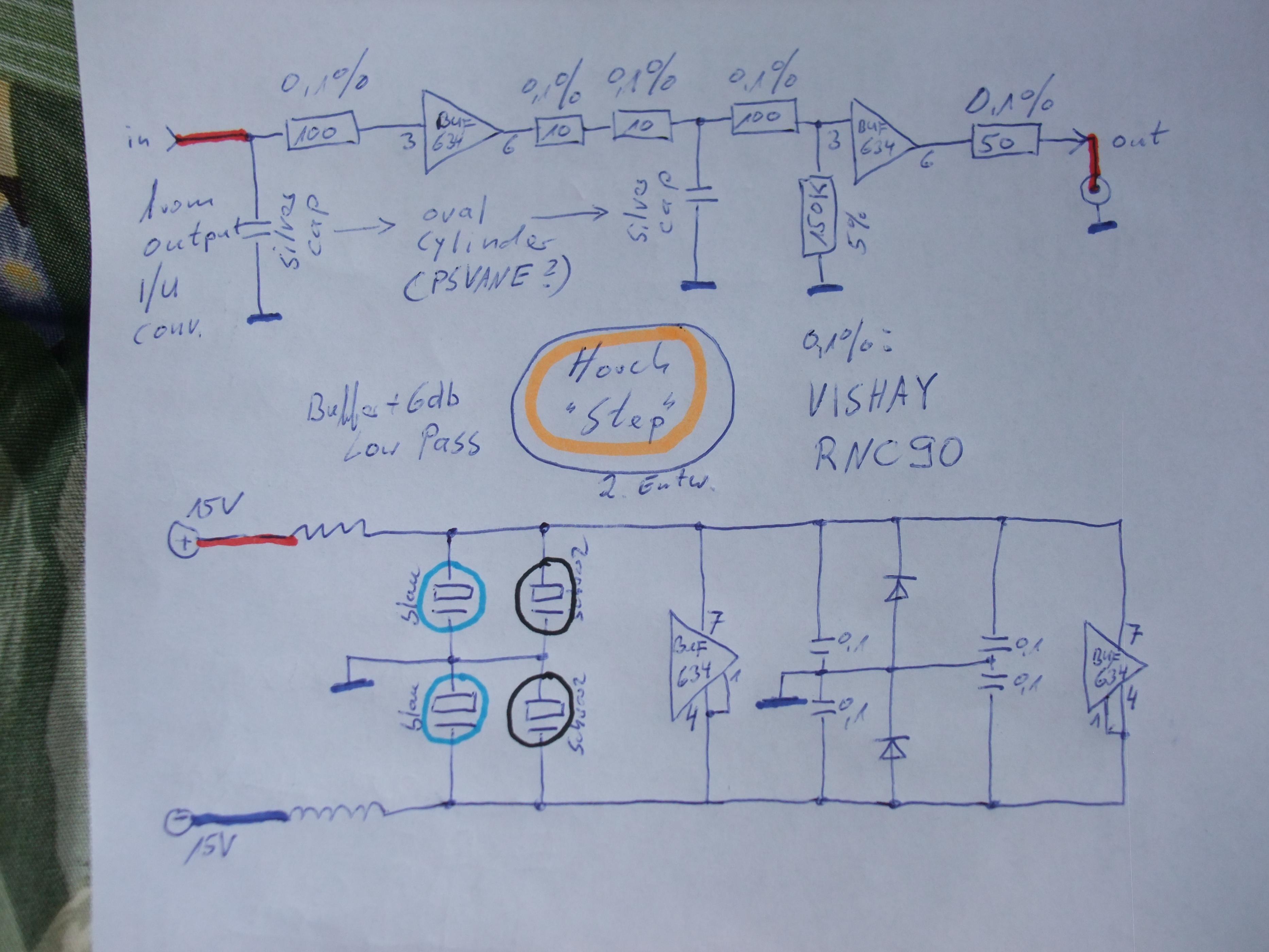

Horch D/A Converter Model STEP - BUF/Low Pass Board Schematic
How many pin compatible versions exist from BUF634 (pin1 for confiruartion of the bandwidth and not for offset adjust) ?
IF it is AD844 then You can check pin 5 with scope?
Did You fix the issue with one channel?
Must be BUF634.

Why PIN5 ?IF it is AD844 then You can check pin 5 with scope?
Yesterday I have find out the the part causing the fault. It is the PCM1702 (PIN11 death).
I have order a cheap DENON DCD755 in used condition. Here I get out a PCM1702 for temporarily test. If the DAC work I will replace again by a high grade version with better performance.
Because pin 5 in AD855 is different from most of other single OPamps. Please refer to AD844 internal structure in pdf?

PIN5 of AD844 is the node of VAS-output resp. buffer input. There was no signal in the defective channel. If PMD100 provide better results - I don't know. DC-offset I haven't check. Maybe separate digital bus coax cable (RG179 e. g.) provide better result through reduced jitter level, but this I don't know exactly.

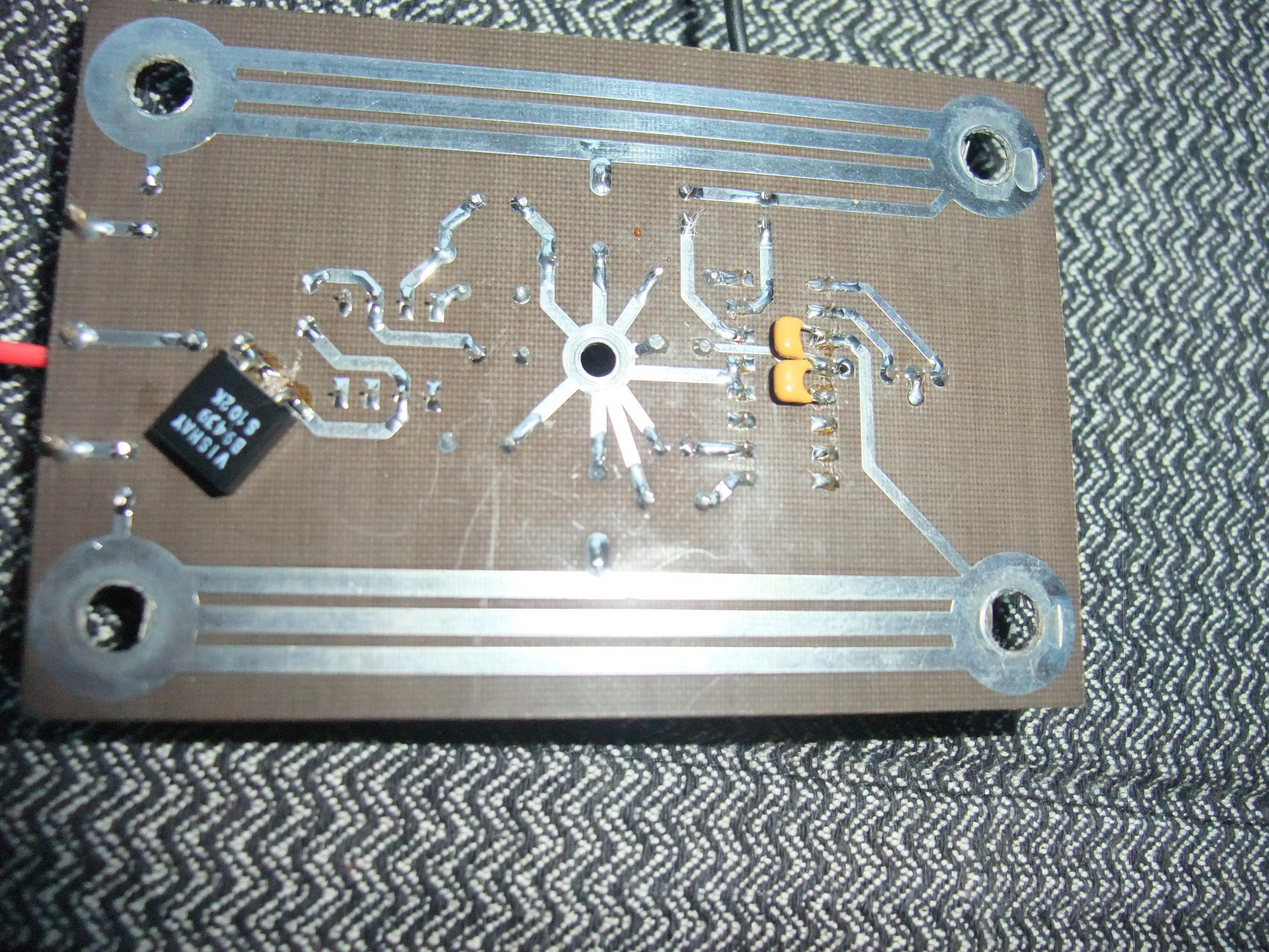

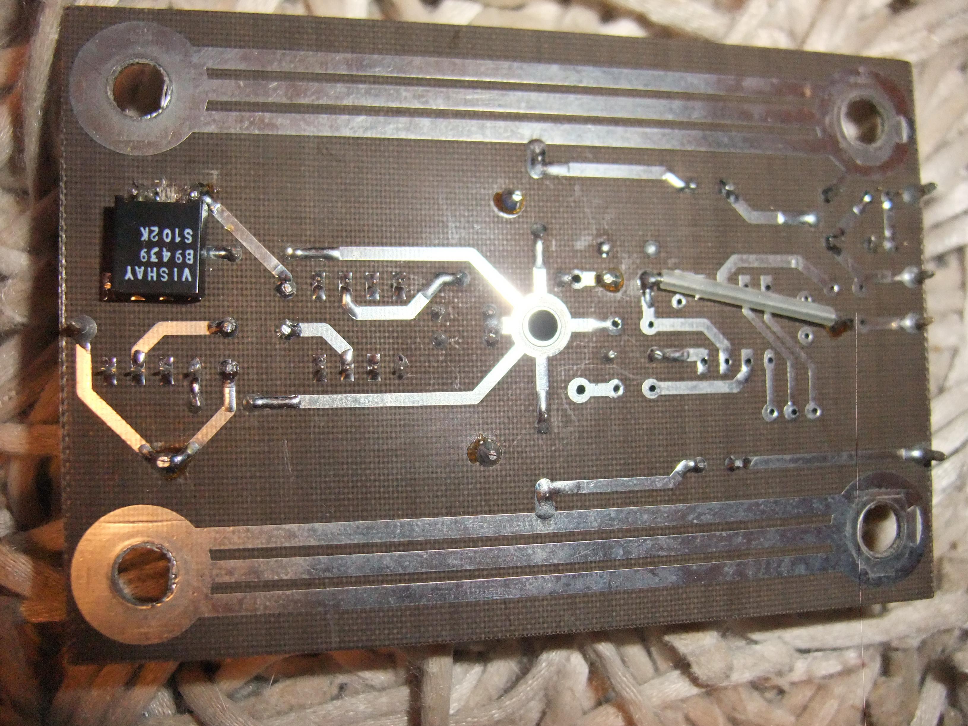

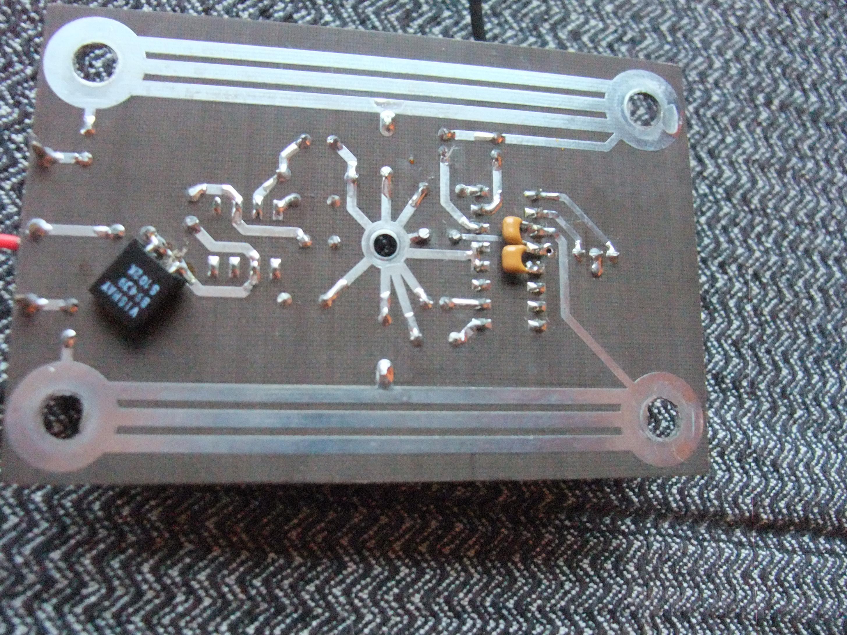

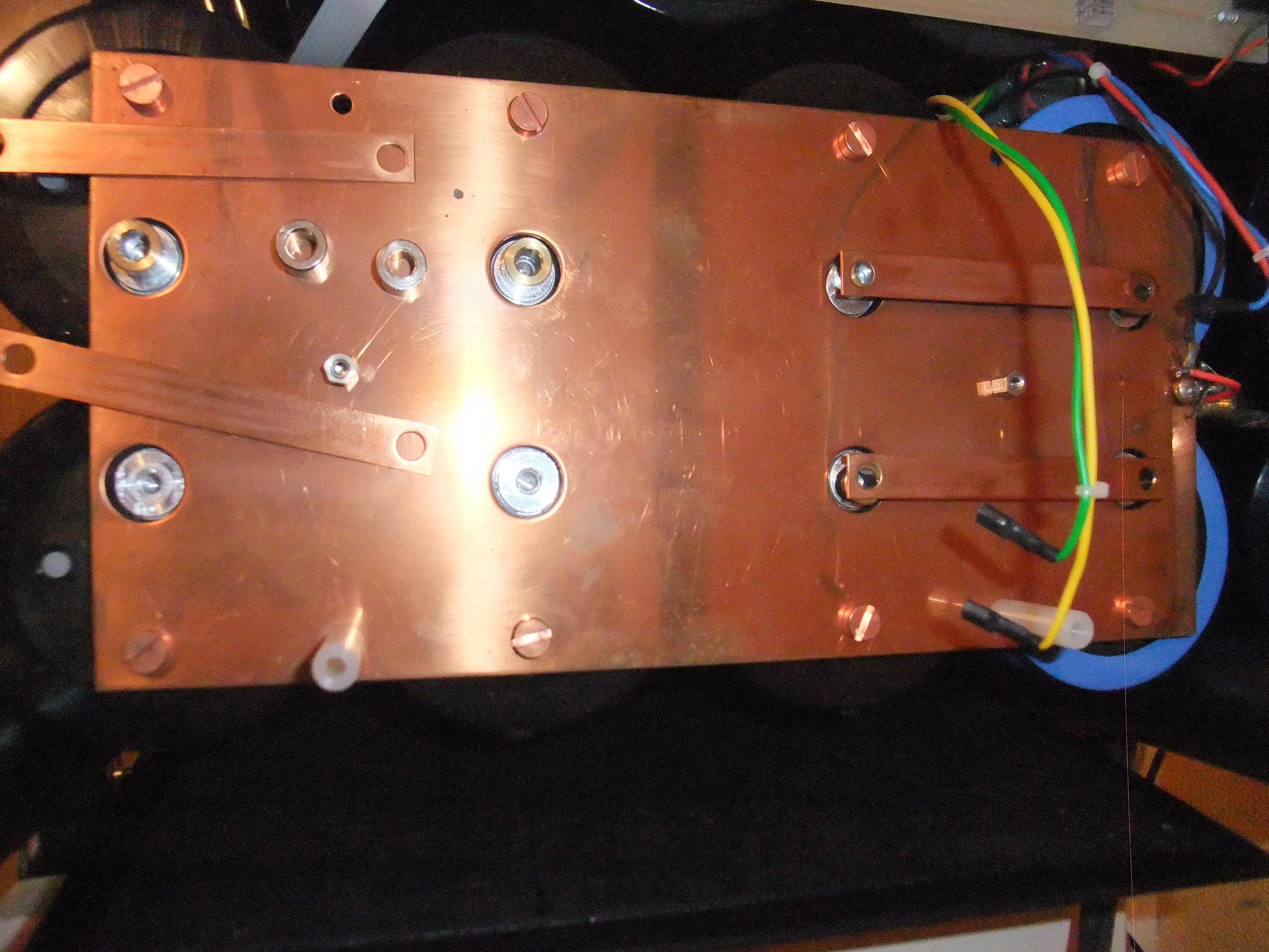

In the attachment additional images.

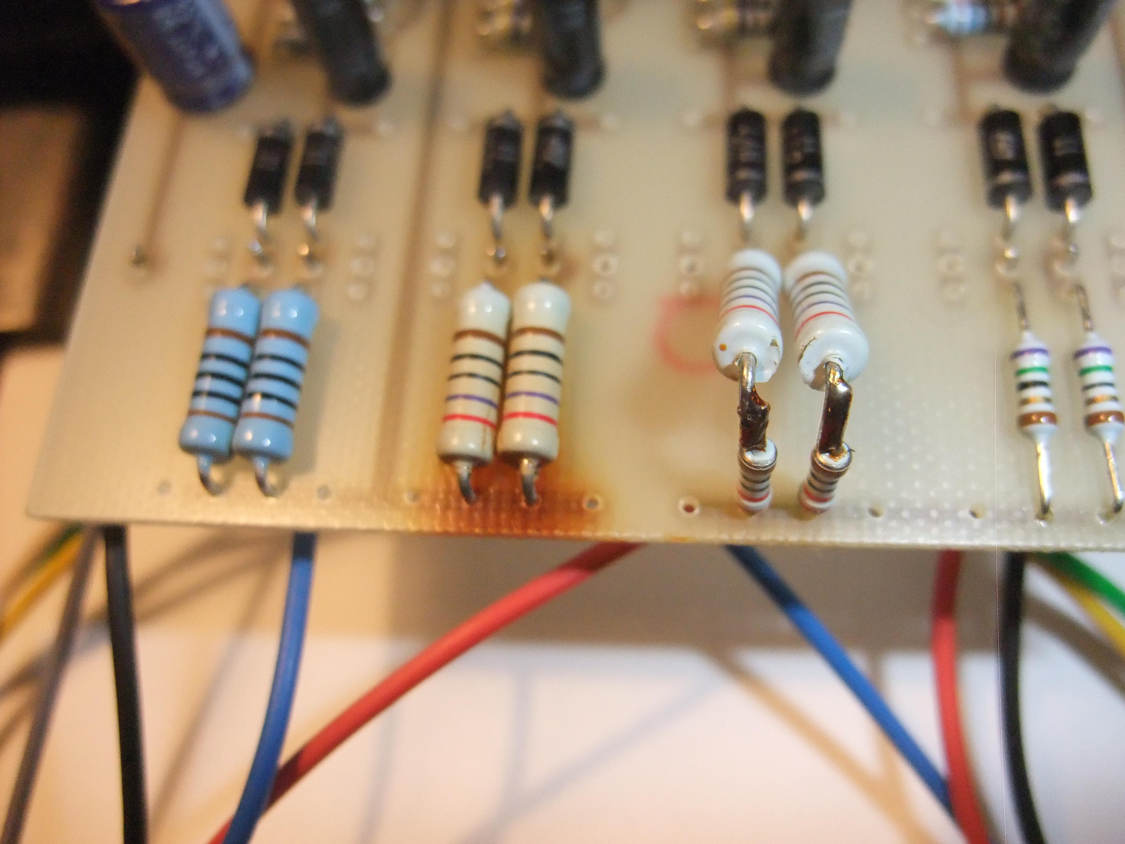

PCM1702 was fault. I have desoldering this PCM1702 and those from an old DENON cd player. At both places now are sockets for an easy replacement.
After exchanging these ICs the issue was to observe on the DENON - that's the evidence, these PCM1702 is clearly defective.

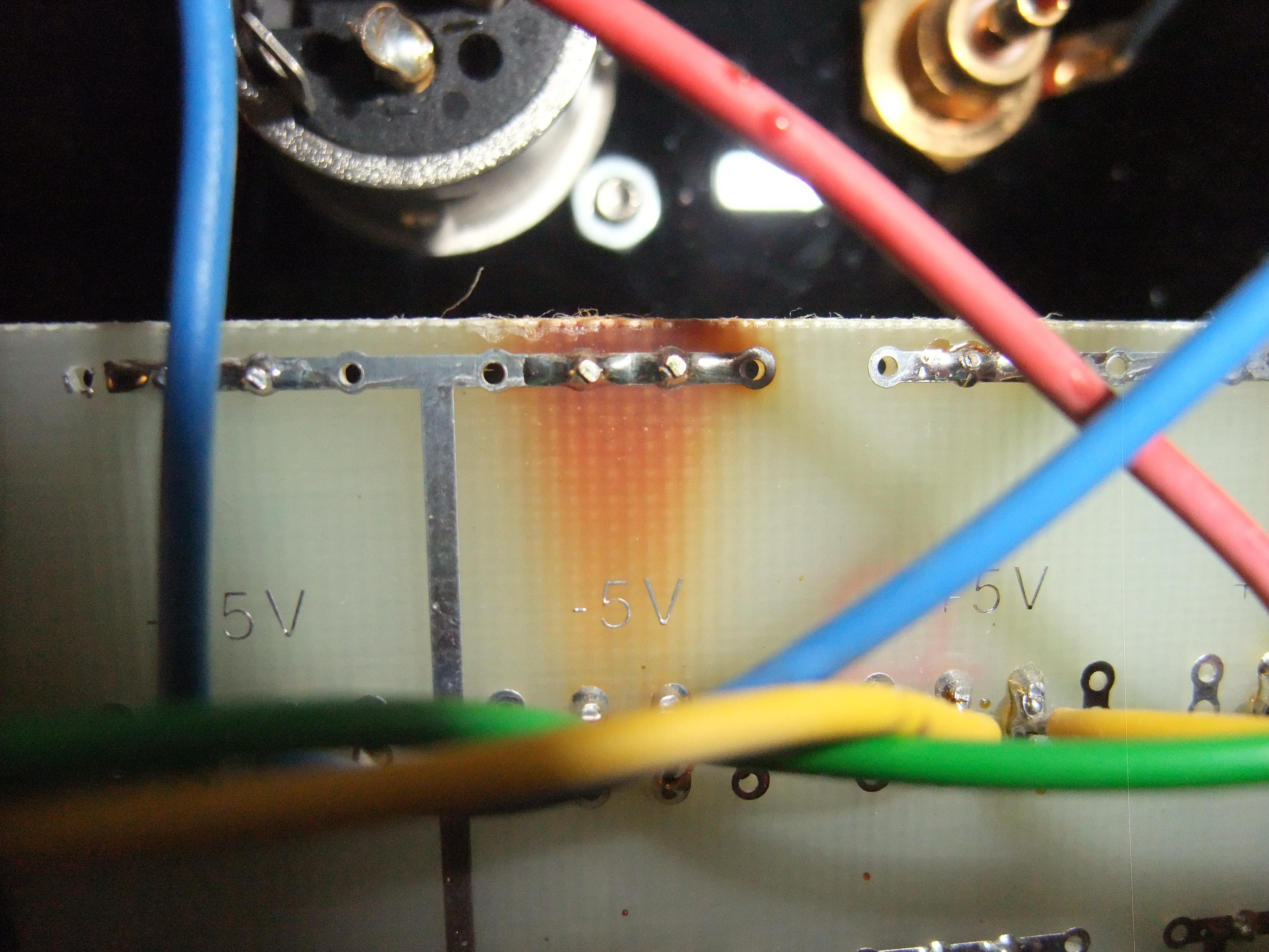

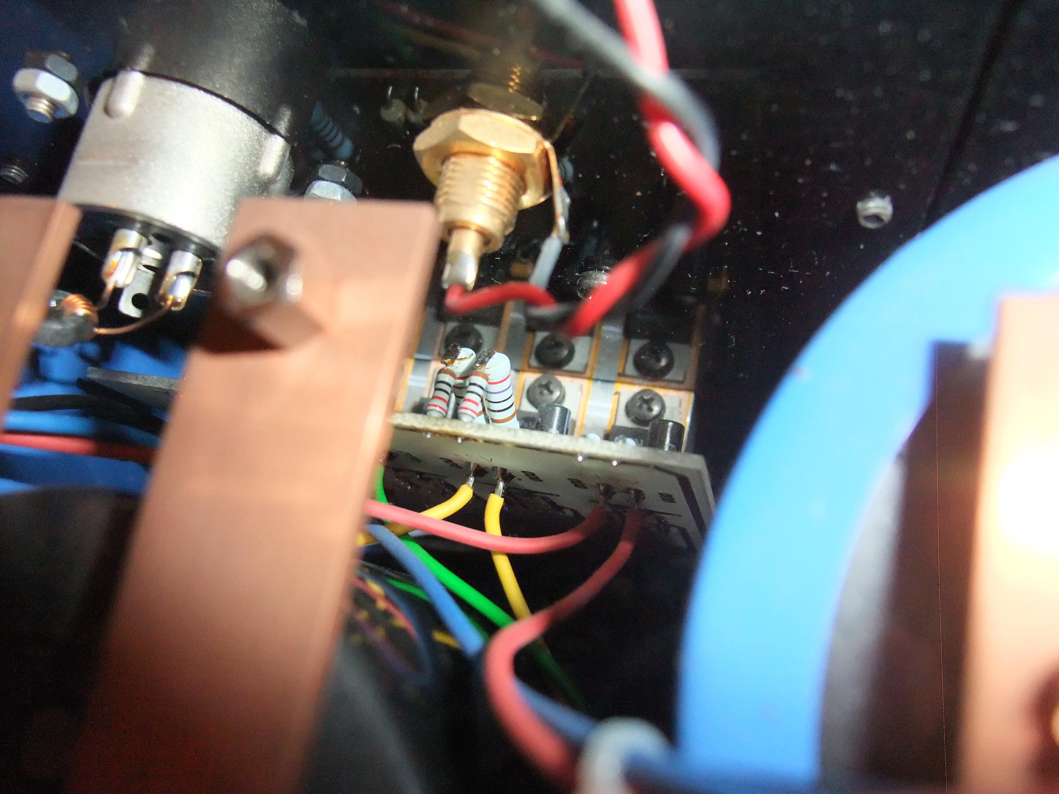

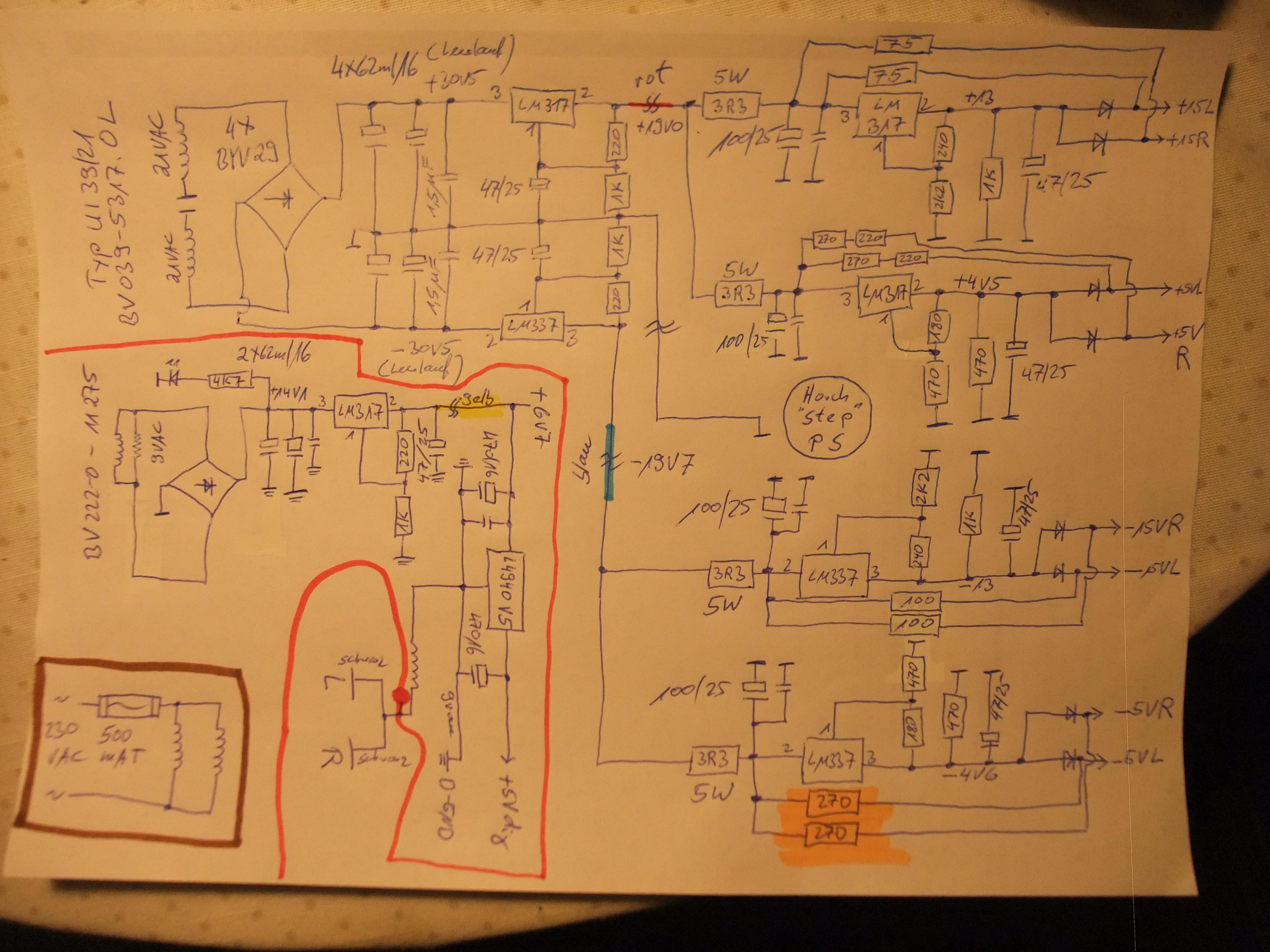

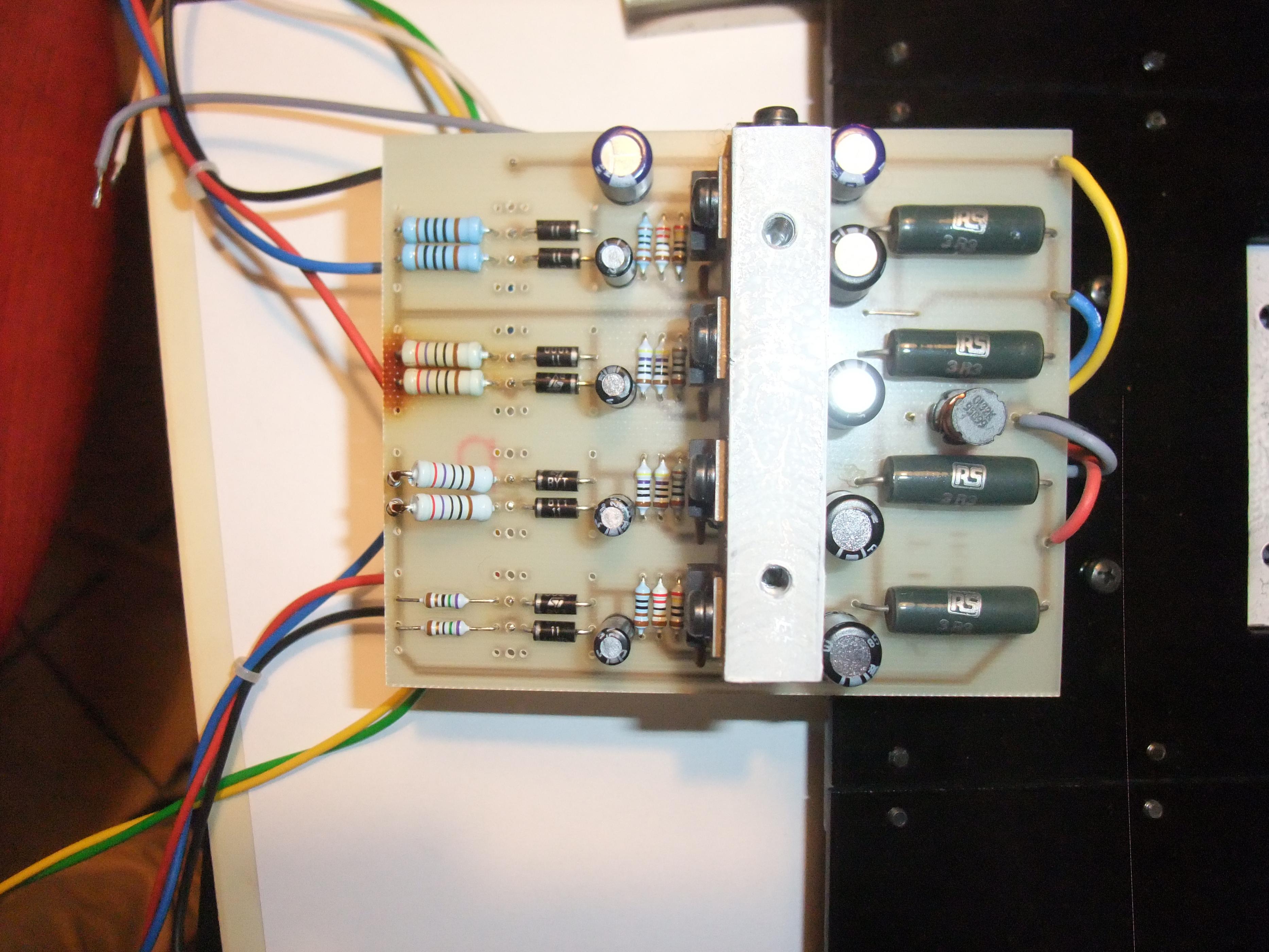

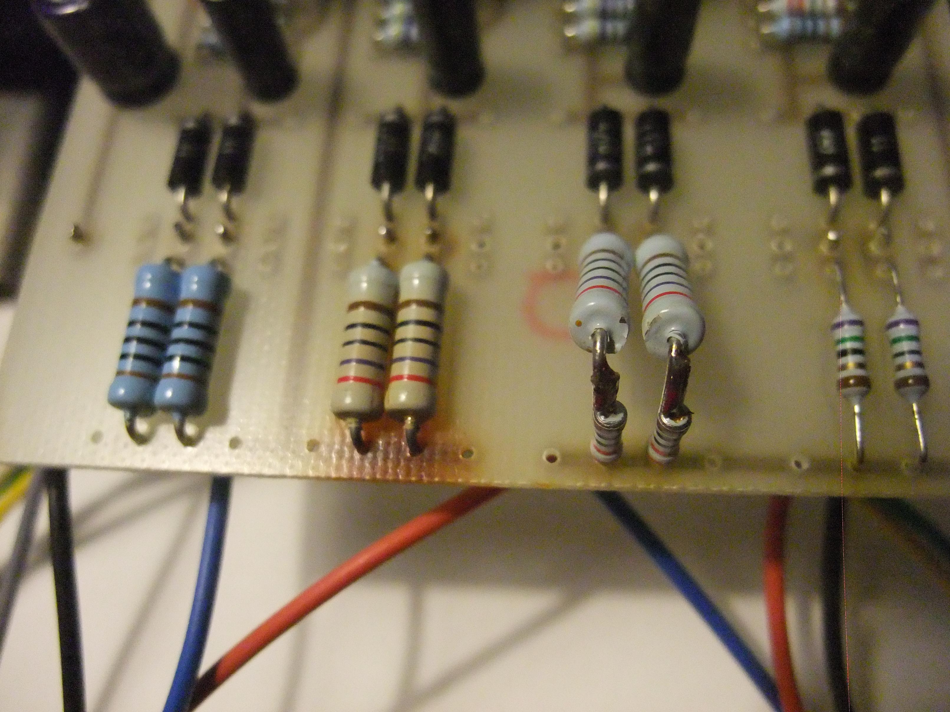

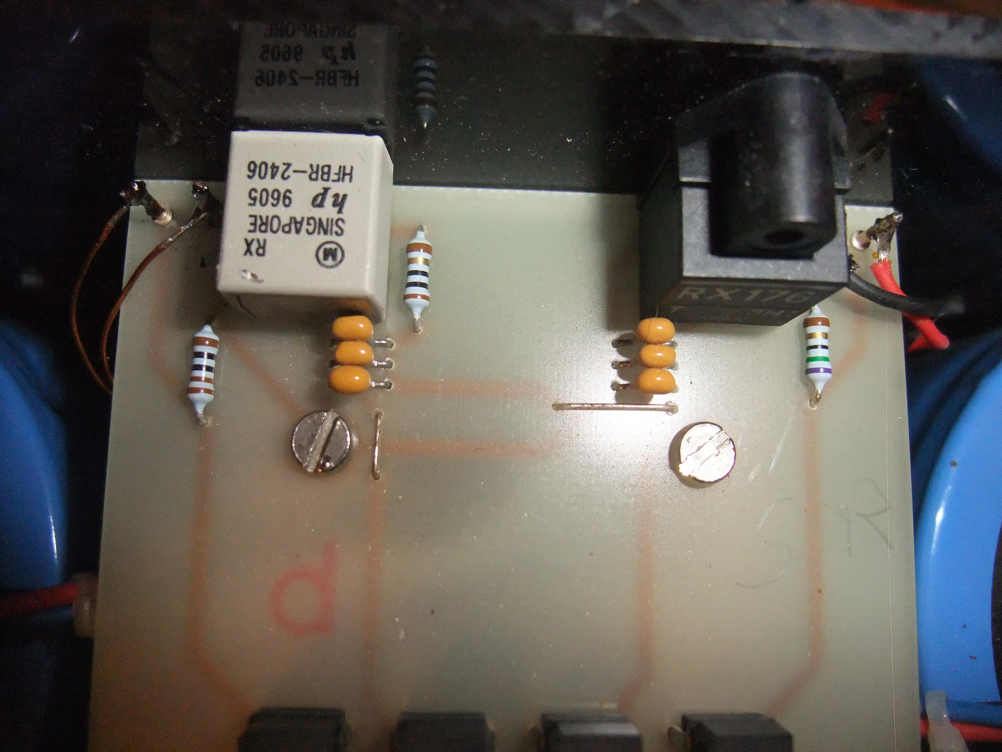

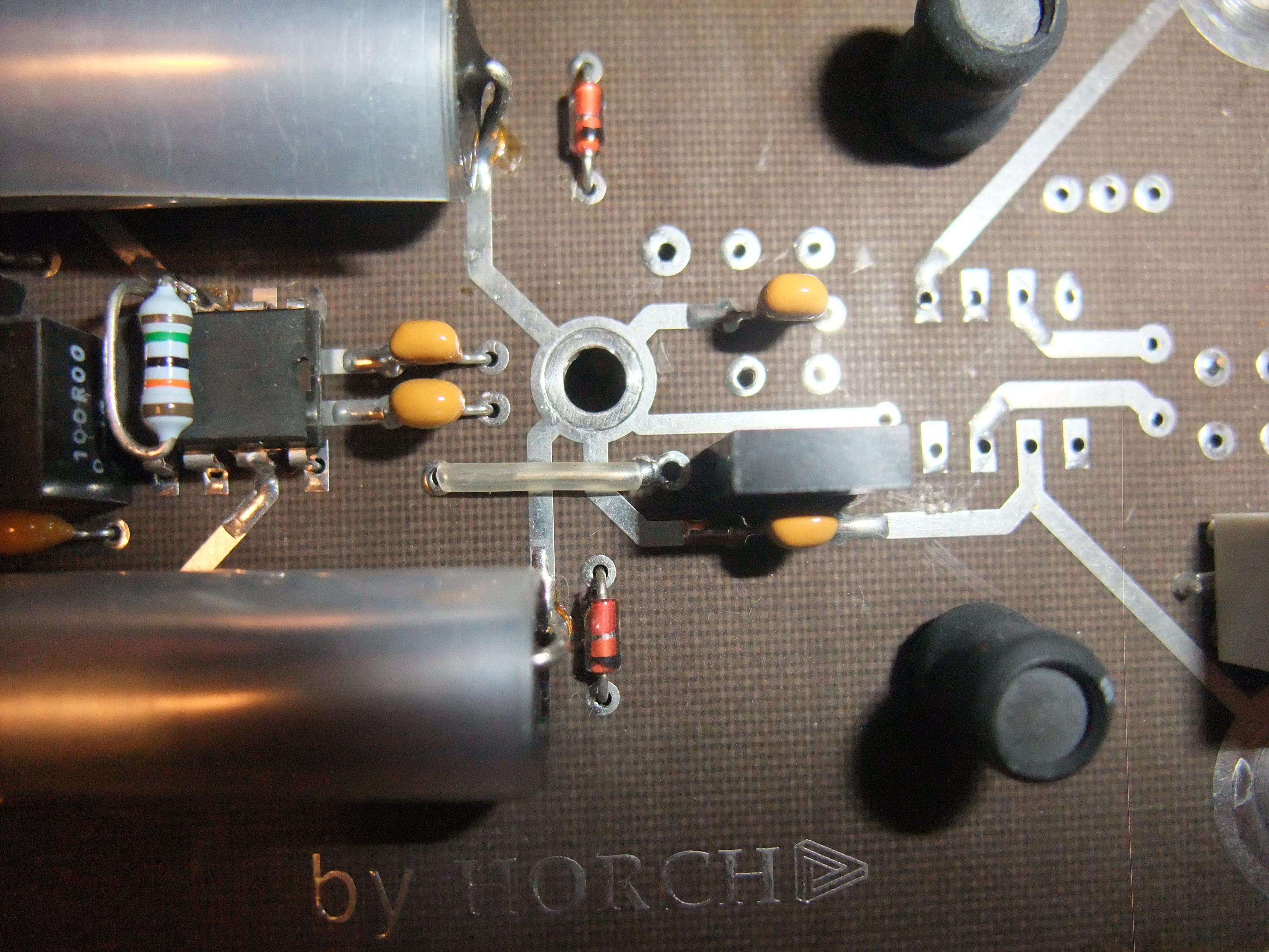

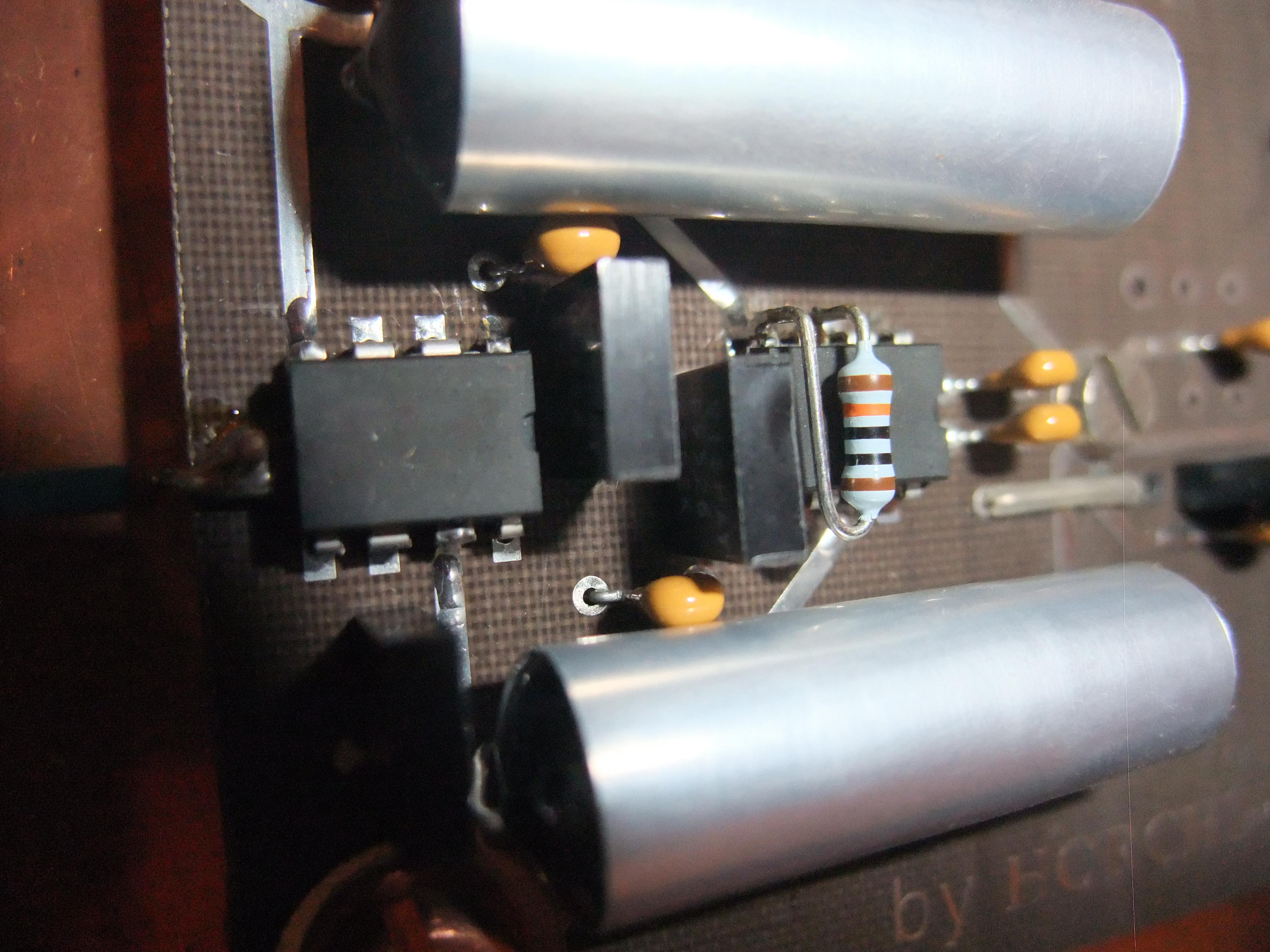

But I can't check the DAC because I observe gross deficiencies on the voltage regulator PCB - go to the attached pictures. After creating the circuit diagram one can see, whats happened exactly for the reason of burned resistors.
I have never seen before this approach of voltage regulation - it confuses me. Basically, there are two series regulators connected in series. The second series regulator generating a stabilized voltage that is below the desired values - go to the attached circuit diagram.
The desired values are obtained by connecting resistors of a certain value in parallel to the second voltage regulator, which are adjusted to the individual power consumption both of the DAC and high pass filter/buffer modules.
The marked 270R resistors are overheated but not defective.

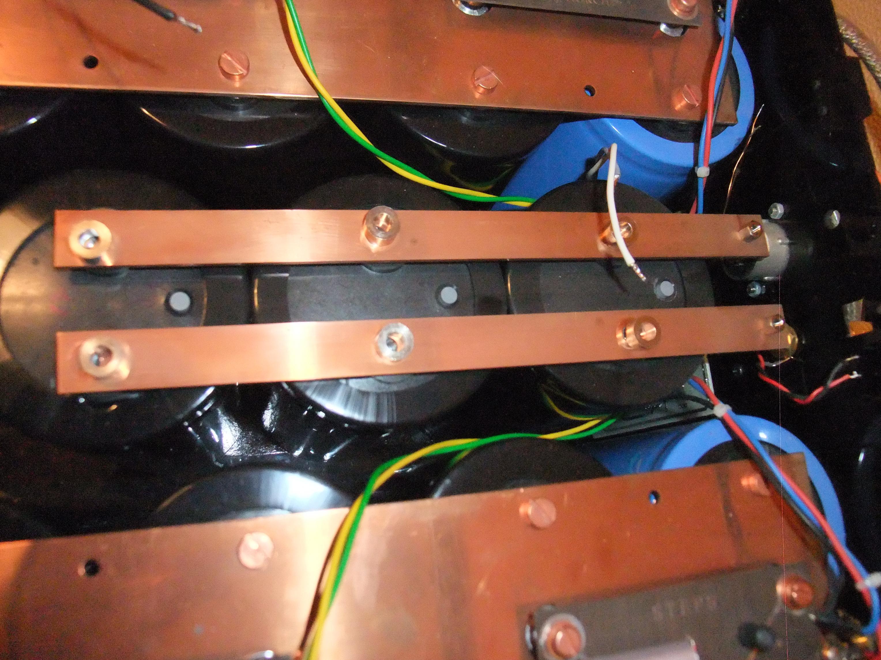

The series diodes prevent voltage from flowing back into the output of the second regulator, unfortunately not in the first regulator because of the resistors connected in parallel to the second regulators (please note - behind the output of the second regulator stages are connected very large capacities of approximately 400.000µF/each rail - outside of the capacitors are nothing to read).
I want to create a parallel regulator resp. shunt regulator concept.
What needs to be considered here ?
Thanks for an advice and calling the appropriate topics here on diyaudio.
