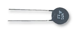

Was looking out for thermistors and found this rated at 5ohm max current of 5A. This would be fine yeah? Its a bit pricey being S$2 each
How many would we need? Say 1 for channel and 1 for power supply bring total to 4+1?
Farnell(sg) catalog number

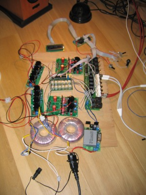

Finally my p1.7 is coming alive. Unfortunately one channel so far becouse i'm still waiting for the diodes for the second psu board.
Today I only made one really stupid mistake by connecting the psu board the wrong way around... stupid stupid stupid!!! (i had a bit to much to drink yesterday...) one smoking resistor and a broken fet.... lucky me i didn't connect the amp board.
Think adding a piece of coper (or whatever) to the fets isn't bad idea because they get really hot
Anyway this is what the pile of pcbs looks like so far

Looks good man! Mojo, Teake
And don't drink whan you'' re soldering or getting your stuff together. I learnt from that, it can destroy a lot, good listening

And we have stereo!!! and no smoke this time 🙂
I only need build a chassis now.. wonder if my metal working skills are on par.... Anyway, the amps sound nice so far, no hum, no weird distortion or whatever. it only needs a decent power amp 🙂 but f4 power is on it's way 🙂
