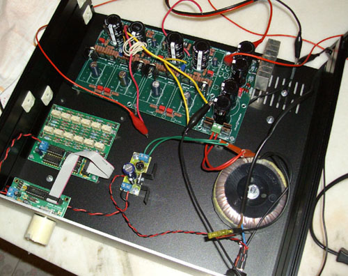

Probably I am one of the last to work on this pcb...
For now the caps in the signal path are Panasonic FC.
If all is going I will order BG N type.

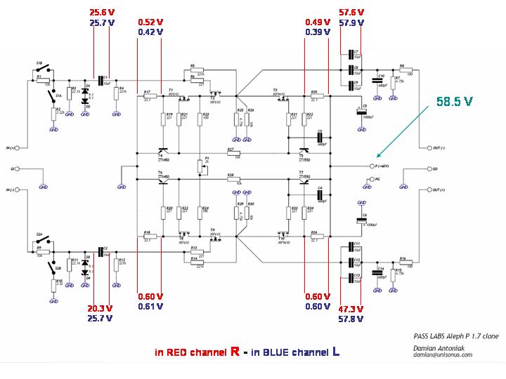

I am wandering if someone want to look the measure I did.
Suggestion for further measurements are welcome.
Thanks in advance 🙂
Peppe

Peppe,
I'm pretty sure the voltages across input and output caps look double what they should be. You should have 12-15V over the input caps and roughly double that (ie around 30V) on the output caps. I've got 50V BG's on the outputs and they would be toast with the voltages you list.
I'd be checking all components for correct orientation for a start. If you have used the ZTX transistors make sure they are right way round as the shape is a bit ambiguous.
cheers
Paul

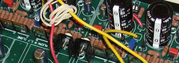

Hi Paul,
I will check the ZTX transistors orientation asap.
Actually I am not at home for working reasons.
I remeber the ambiguous shape of transistors and I am quite
sure I used attention before soldering them. (picture helps?)
Did I was wrong 4 time on 4 chance?!
I appreciate your suggestion, hope to update information asap.
Thanks 🙂
Peppe

From the pics the ZTX appear to be correct, so cross that off the "to check list" 😉

Hi Peppe
how did you measure the voltages? did you ground the input before measuring?

Peppe,
C2 on both boards looks like it's around the wrong way. Positive should be oriented to inputs. The inputs are Positive (+) and Inverted (-) Signals, not +/- voltages.
edit: check the orientation of the output caps too... Same thing: cap positive towards the inputs for all caps. it looks like you have (-) Inverted output caps reversed.

spzzzzkt said:From the pics the ZTX appear to be correct, so cross that off the "to check list" 😉
Yes Paul, and I remember I checked all transistors (with the tester) before soldering them and I chose the ZTX with closer values as well.
Check your input gain switch settings too... There are three switch combinations that work, and I had a few problems when they were in fourth "illegal" setup.
I tested the output with an old headphone and there was audible music in each rail. I switched different combination as veteran indication (I got the scheme at home) and the music was more or less loud as expected by the scheme.
No, I did not ground the input.
spzzzzkt said:Peppe,
Ok, here there was my big doubt. So I did different test:
input cap + oriented to (+) input and
input cap - oriented to (-) input
output cap + oriented to (+) output and
output cap - oriented to (-) output
than
input cap + oriented to (-) input
output cap + oriented to (-) output
and last configuration
(not in picture but that one I reported the measurements)
input cap - oriented to (+) input and
output cap - oriented to (+) output and
In ALL those configurations the measurements were the same (plus o minus 0.5 Volt) .
Arg... I am in trouble....

So next check will be:
input cap +oriented to (+) input and
Is that right, Paul?

Peppe said:So next check will be:
cheers
Peppe
That is definitely how I would have the caps installed. cap + should be oriented to signal source.
