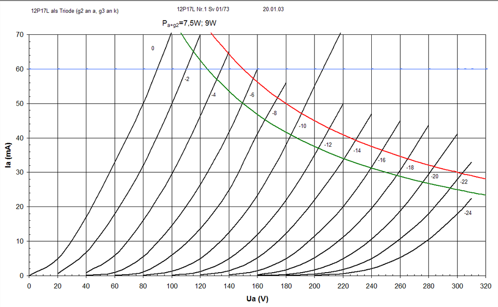

Hi Ale;
do you have them? I expect them to be almost like for 4P1L except on higher negative voltages on control grid.
Thank you Svetlana. It would be nice to see the whole picture, including positive voltages on the control grid, to be sure that it is very close to 4P1L.
Hi Ale;

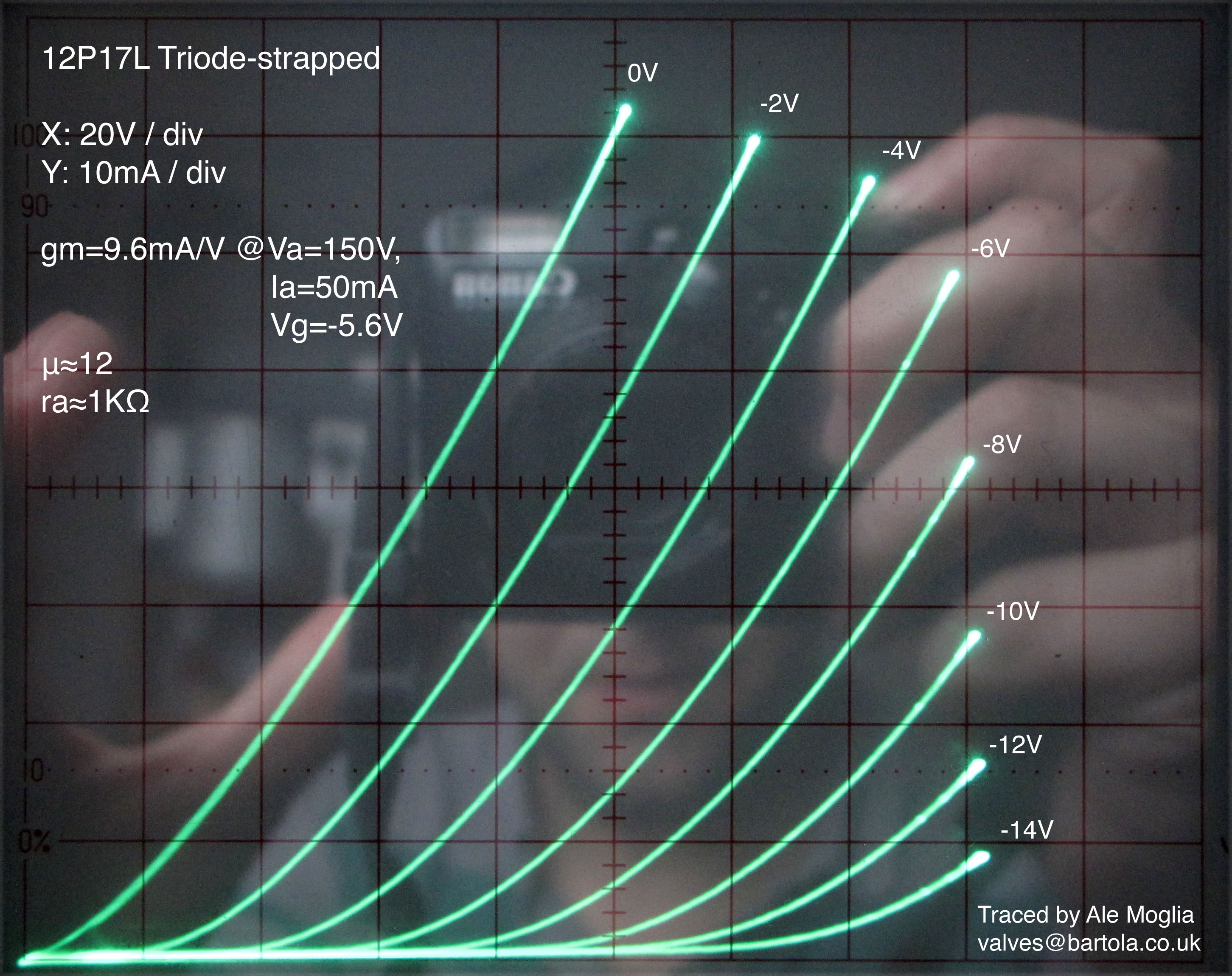

Anatoliy,
Long day at work, so tried to do my best in the short time available for this.
I think I got a very nice set of curves (in left handed triode mode only) and a very accurate SPICE model:

Thank you Ale;
it is very similar to 4P1L. I would expect very similar curves on positive g1 voltages as well.

THD at 50mA/Va=150V is not impressive: THD=0.35%@Vo=+22.22dBu.
However is very interesting to see that there is an H2 cancellation point around Ia=20mA and Vg=-2V producing THD as low as 0.013%!:
