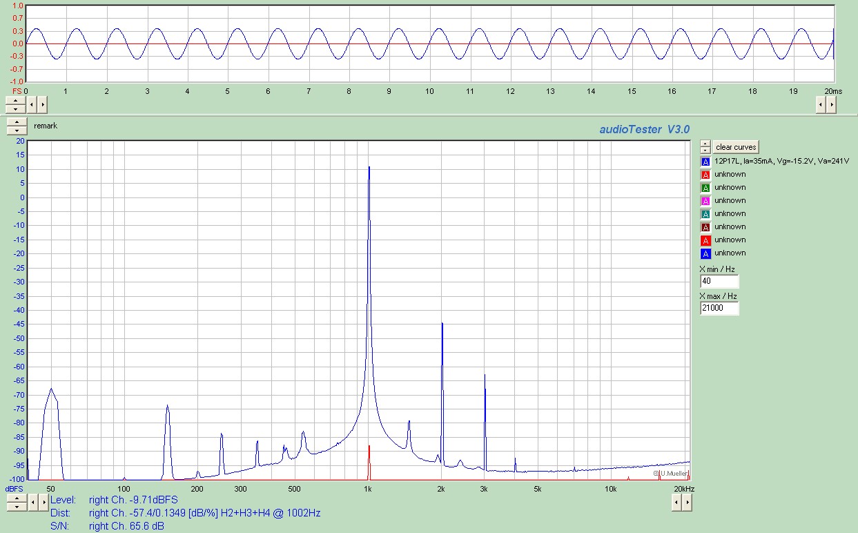

Found an optimal distortion point if this valve needs to be run at maximum power. With Ia=35mA, Vg=-15.2V, Va=241V, you can get THD to 0.13% (Vo=+22.22dBu). Yes, it will be at the edge of its anode+screen power dissipation:
http://www.bartola.co.uk/valves/wp-content/uploads/2012/06/12P17L-3.jpg
Keen to see where people have actually biased this valve and are happy to test this point?
