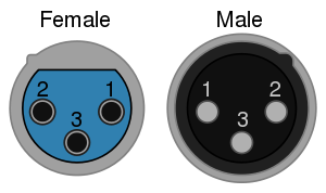

By the way, here is a rear panel: speaker outpurs, 4 switchable inputs in the left corner, and in the right corner inputs for MC and MM, with a switch between them. I decided to use a 5-pin female XLR for MC input. MC input will be balanced.
Do you know if some standard for XLR inputs for MC phono exist?
Pin Function
1 Chassis ground (cable shield)
2 Positive polarity terminal (hot)
3 Return terminal[4] (cold)

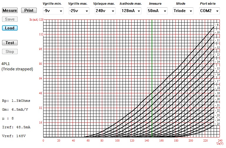

I've traced the 4P1L triode strapped anode curves (see attached).
What is the bias point in your design?
220V A-K, -17V G1-K, 50 MA per tube. 5 W from paralleled pair. They are easy to parallel due to linearity and consistence.
Edit: sorry for late answer, I was in Az, at Grand Canyon then, and have not seen your posting.
May I add your graph to my page?
Hi Anatoly,
Sure, no problem and let me know if you the resolution is low. Thanks for your response. I'm very tempted to work on a similar design once I complete my current 45 SET.

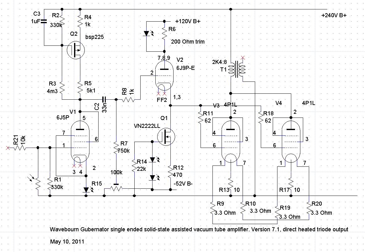

This is my SE 4P1L & PCC88 Siemens & OT Hammond 125FSE & Interstage transformer Hammond 124B. I made it for very short time /but adjustment was about 2 weeks/ and
I participated in DIY meeting 2011 in Goteborg - Sweden. I'm glad that people
interested and I showed my schematic to some guys, that liked my SE.
Hi Azazello,
Can you share for me schematic of 4P1L & PCC88 Siemens? I intend to DIY 4P1L SE and I am looking for schematic.
A couple of questions:-
1) More or less what RMS drive-voltage is required to drive a parallel 4p1l output stage with edcor GXSE15-6-2.5k trafos into 6 Ohm speakers to max power please?
2) I am thinking of using a mosfet source follower as a driver, direct coupled to 4P1L outputs. I think it will be cheaper, easier to implement and easier to get good results with than a cathode follower. Any comments?
