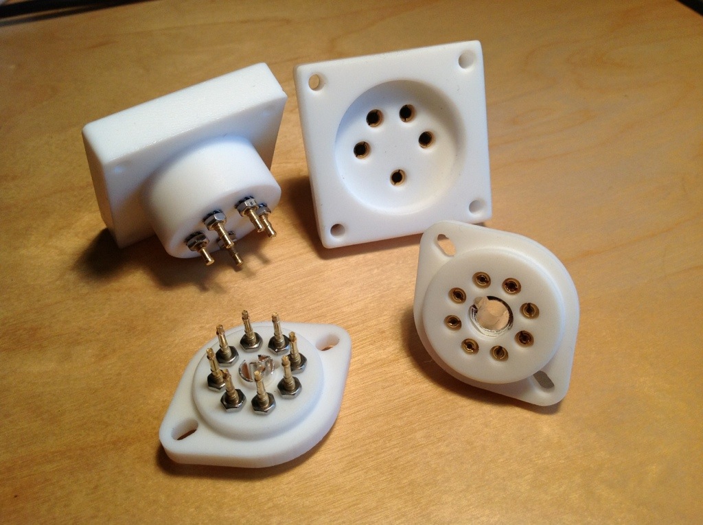

Be careful of teflon loctal tube sockets. Teflon is very slippy. What happens is that the inner part comes up when you pull the tube out of its socket. At least it does on mine. I've stopped using them.
And of course, with loctal sockets you need to open up the bottom of this inner part where it locks the tube pin or you'll have hell taking it in and out. Use a thin nose pliers for instance.
Thanks for advice Andy, BTW Ale teflon sockets looks very nice and don't seems to suffer the same problem like yours.

Damn - those are nice! Quite different from the usual teflon types. That central part, however, might still start to slip if it isn't held in pretty securely by the construction. I can't quite see if they lock or not. These days, locking is a just a pain and quite unnecessary.
They are very well made. Get in touch directly with Jakeband if you are interested, but they are not cheap as are handmade and by order.

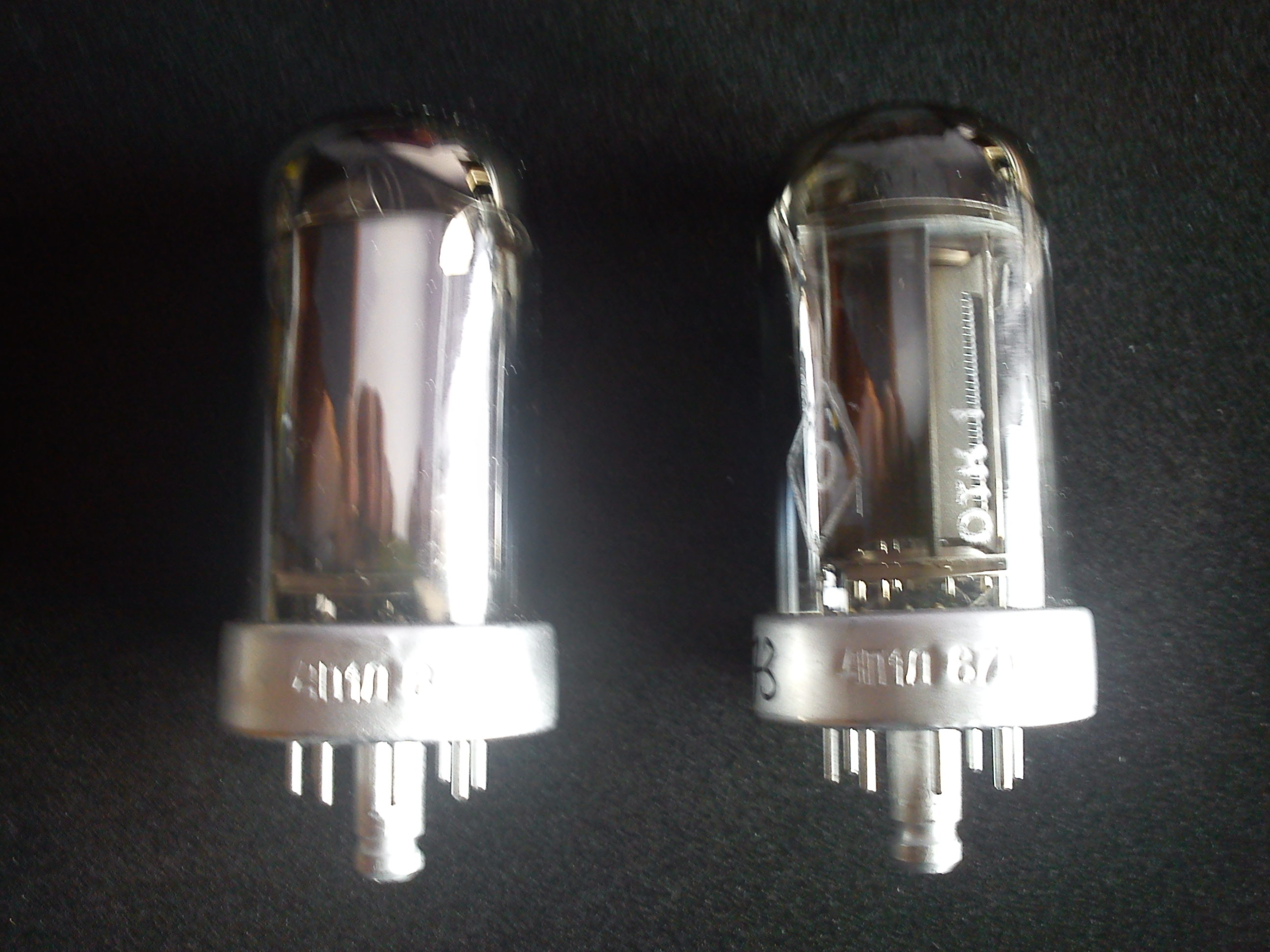

I don't know if a 4P1L goes into a shielded socket, and I'm even more unsure of how you'd get it out except by pushing it from the bottom!!!

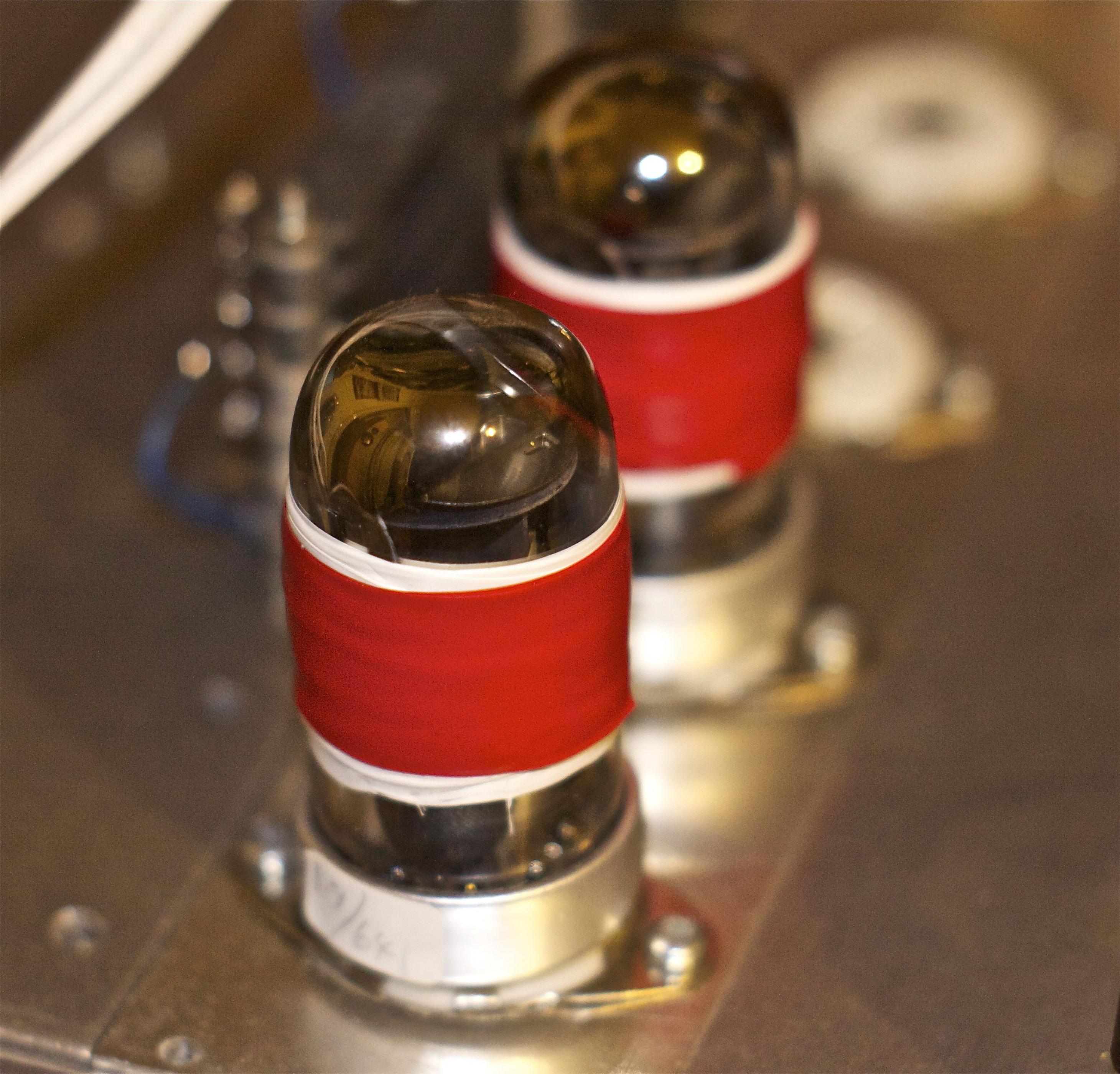

Changing the subject a bit, have any of you guys used anything like dampeners around the bottle of the 4P1L? It's about 28mm diameter. A friend suggested this very cheap and useful box of O-rings. They include 25 x 3.5, 26.5 x 3.5, 28 x 3.5. For a preamp this looks useful:
419 PIECE RIC RUBBER O RING SEALS SET PLUMBING TAP WASHER ORING PLUMBERS | eBay
I've been using teflon plumbers tape. I'll see if I can upload a picture.
I bought a 10 pack of 3mm x 26mm viton 75 high temp o rings, nice tight fit, didn't make much difference, they still sing along!
